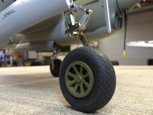

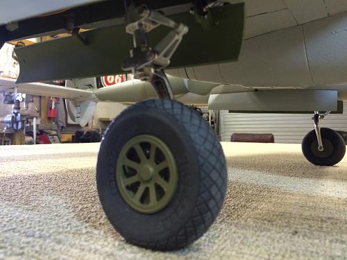

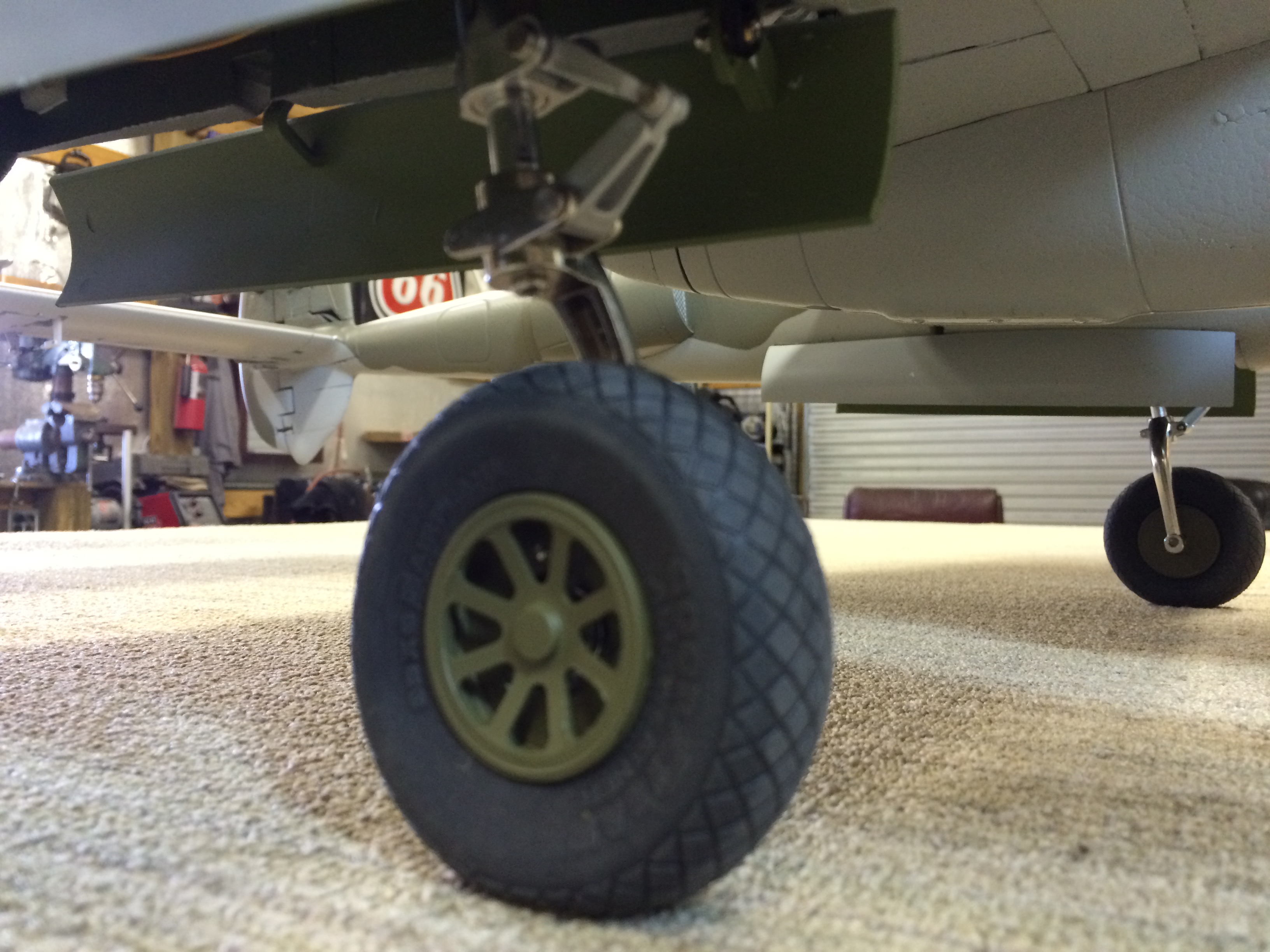

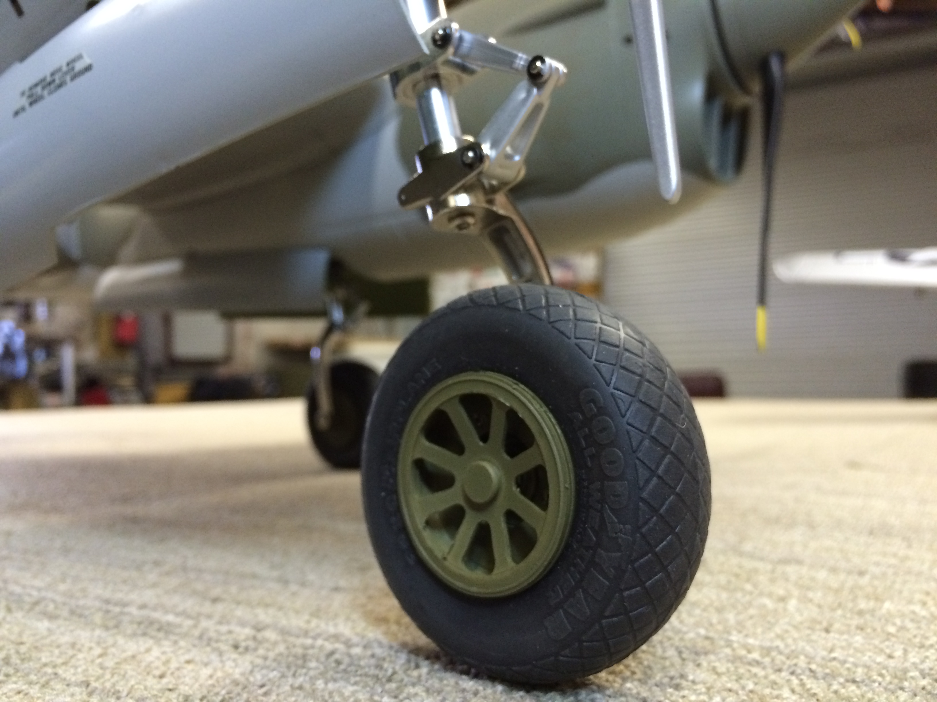

                              • I finally finished the strut swap and after trying several different wheels I have decided on the Robart 2.75" on the mains and the 2.5" on the nose.

                                • That looks awesome! Did you do the nose gear with the strut as well?
                                  • Originally posted by Ryan@Motion/ryramZ View Post
                                    Yes, the top picture is the nose gear...the mains are a direct bolt on other than changing the wheels.
                                      Doh, I didn't look hard enough. Man that's awesome. Have you flown with them yet? Looks like two lefts and a right. Smaller wheels for clearance I assume.
                                      One more question, ok maybe two. Did you use the FW p51 strut pins that came with the struts? What about nose steering? C clip?
