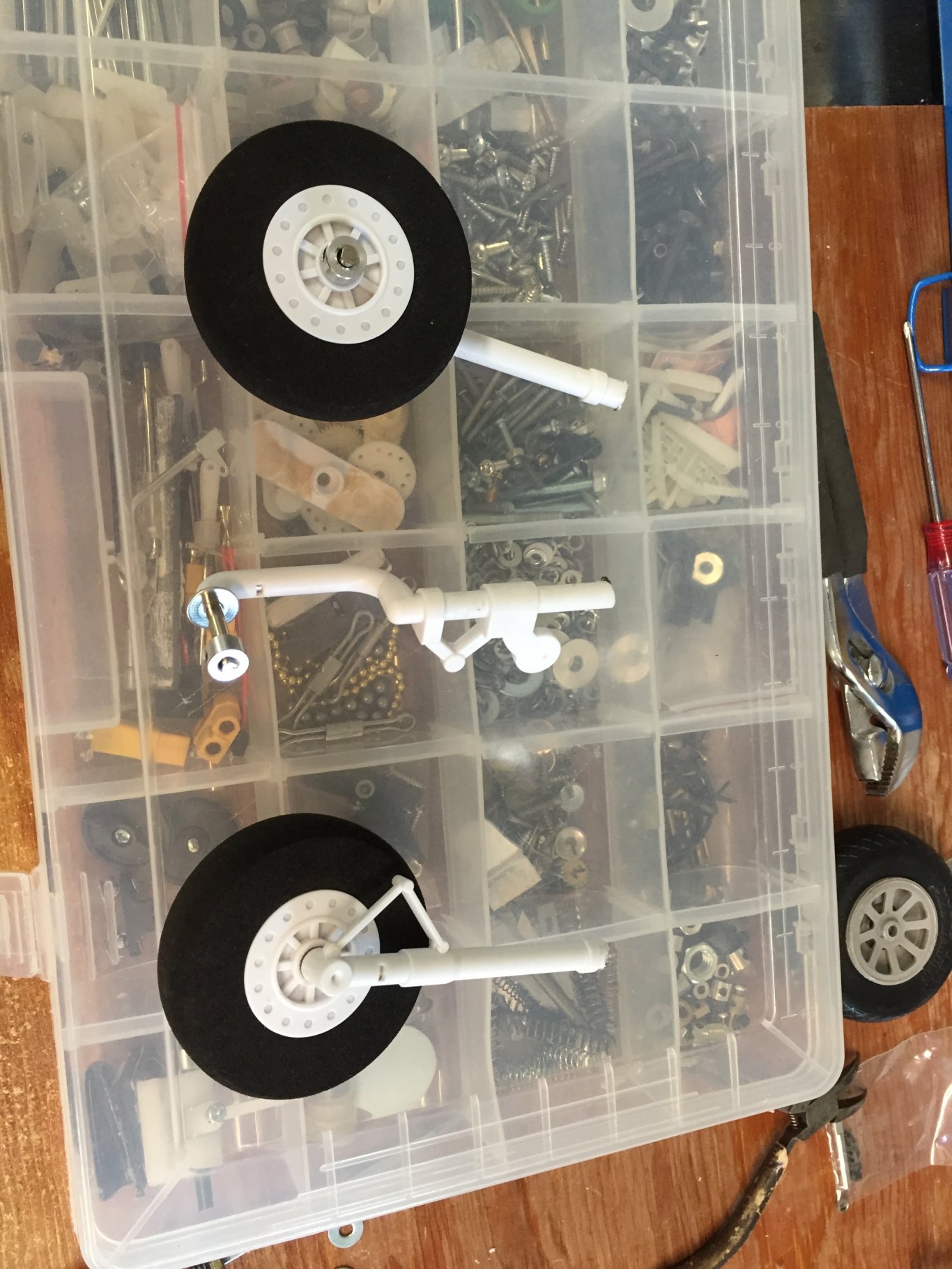

                Had a "First" this morning on my initial flight. Powering up on take-off, up elevator, nose lifts up, mains clear the runway..."What the heck is that??!!" I see as i'm doing a scale takeoff, my front wheel rolling straight down the runway! "Awww nuts!" I leave the gear down, circle around for final approach. I land mains first and keep the nose up as long as possible. And come to a "Scraping stop". No damage except for some modification of the bottom of the strut from grinding on the concrete(Castle CNC Strut)
                I walk the runway..there's the wheel axle....there's the wheel. With in 10 minutes, fixed and back in the air. Phew!! Yes, obviously..the grub screw holding the wheel axle had come loose.
                See photo of the damage on the bottom of the strut.
