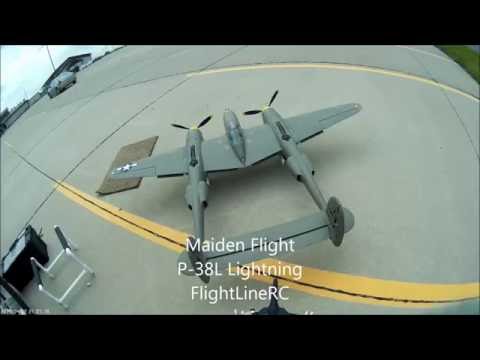

                        Did the Maiden on my Allied Green 38 this morning. What a great flying plane!!
                        Lon
                          • 2817
                          • Arlington, TX
                          #2152
                          Nice flying and congrats on the successful maiden Lon!

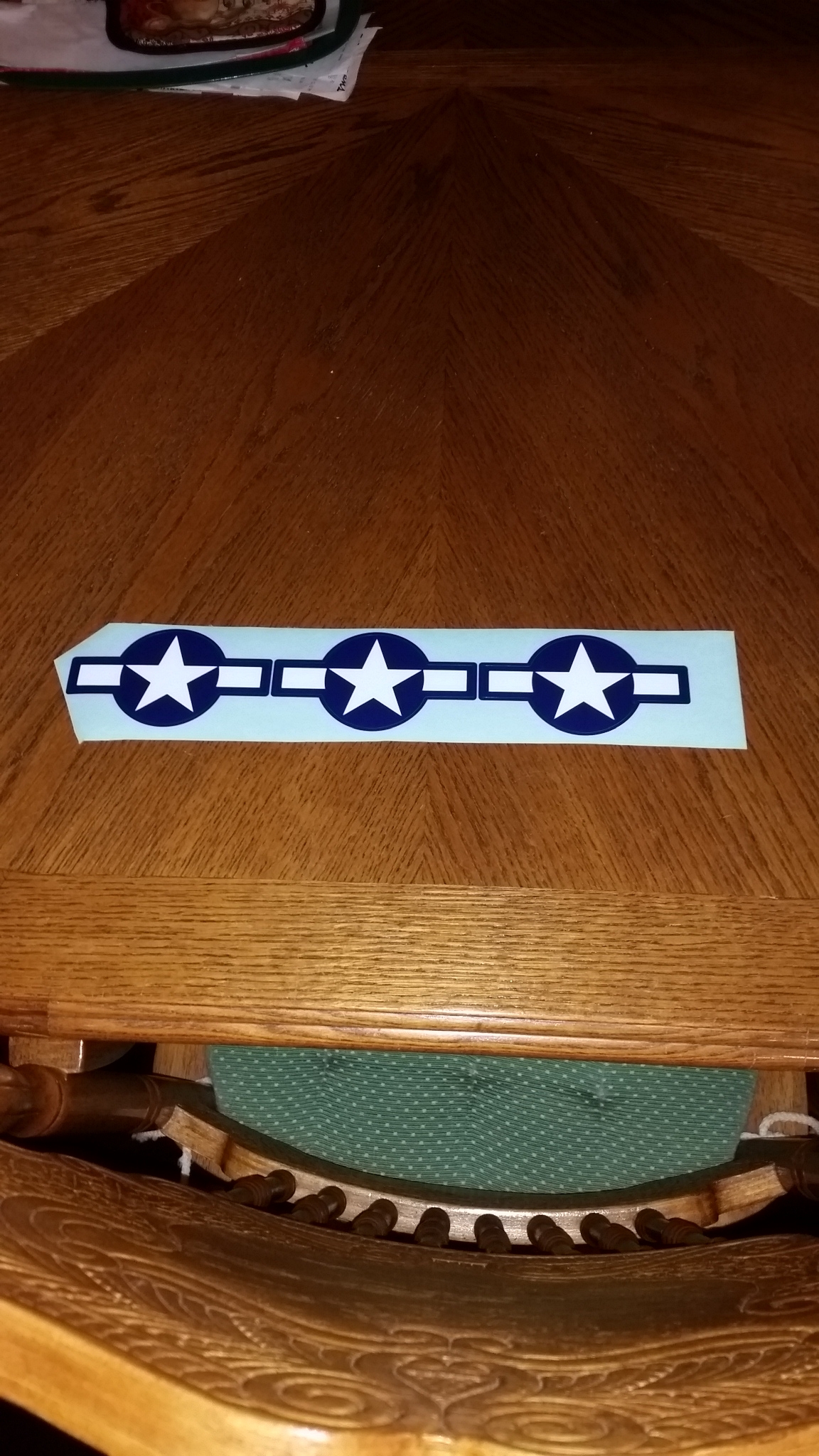

                                  Check your sticker/decal bag carefully folks. I just opened mine up to start applying and find one of the wing/fuse stars is missing. You can see in the attached photo that it's been clearly cut away. Right out of the bag, no less!!:@
                                  Bob Duncan
                                  The only real helicopter is the CH-47 Chinook. The rest are just sling loads!
                                  • BadBob
                                    • Jun 2016
                                    • 155
                                    #2157
                                    Never mind. I see that one of the stars as well as the "no step" decal has already been put on. Didn't expect that. My bad! A closer detailed inspection would have caught that.

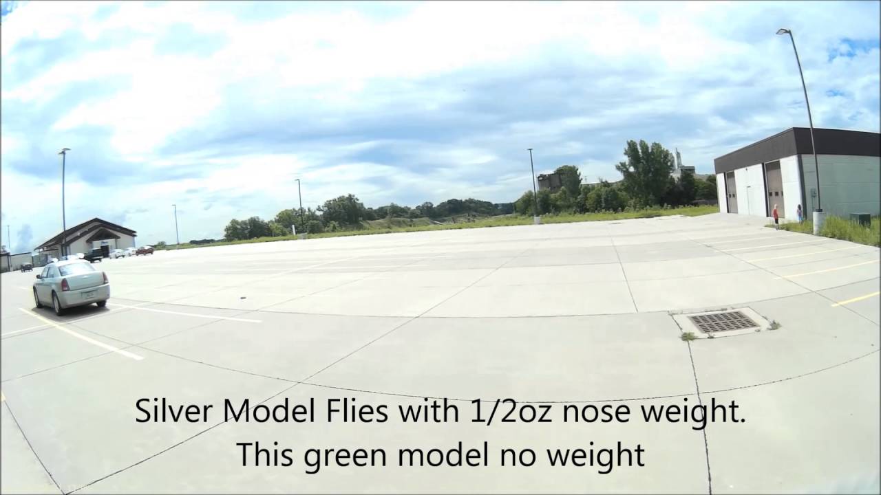

                                        I don't know if you have seen this. But i come accross this video on the 38.
                                        Maybe i'm the last one to see it!!
                                        Very informative....
