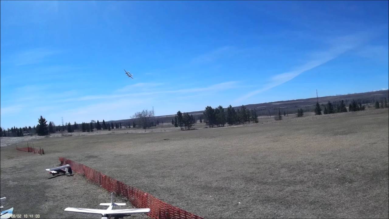

This is the only video I have of my P-38 flying. I've posted it before but this time, pay particular attention to the last bit (the landing and taxi back in). Even the beginning take off roll is quite telling of just how bumpy our field is. The landing was not too bad till it hit that ridge and launched it back into the air. Then the taxi back is just bumpity bump all the way. It was the next flight that one gear did not come down. Thankfully, the drop tanks took the brunt of the belly landing.
Since this video, the donuts appeared. Sometimes, we get there in the morning and there's some guy living in a tent on the runway and beer cans everywhere. It's just wild prairie grass that's been mowed and the thatch cleared away. It's federal native land and the leader does not wish to spend too much money on prepping the ground and as participants, the field can be taken away from us at any time, so nobody wishes to spend money or too much time dealing with it. We're just happy we can use it while we can. It'll shut down in the next year or two when a new road goes through.
