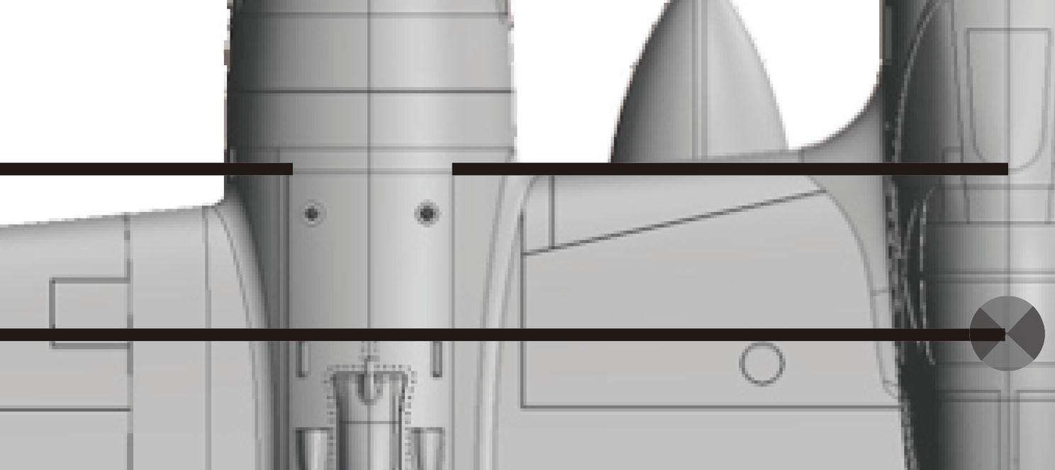

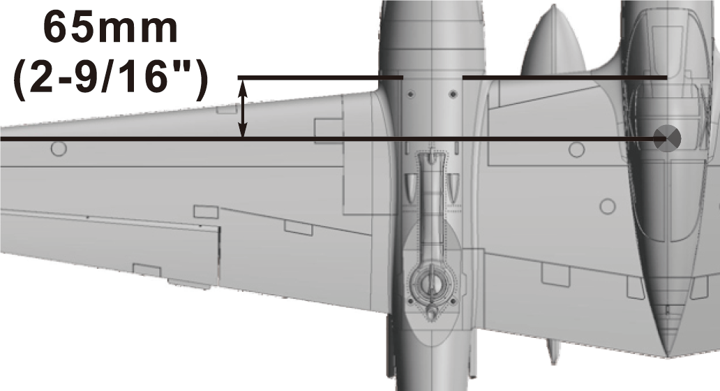

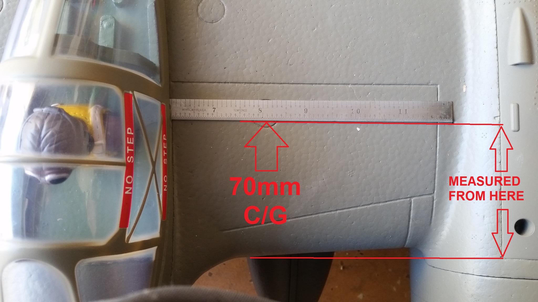

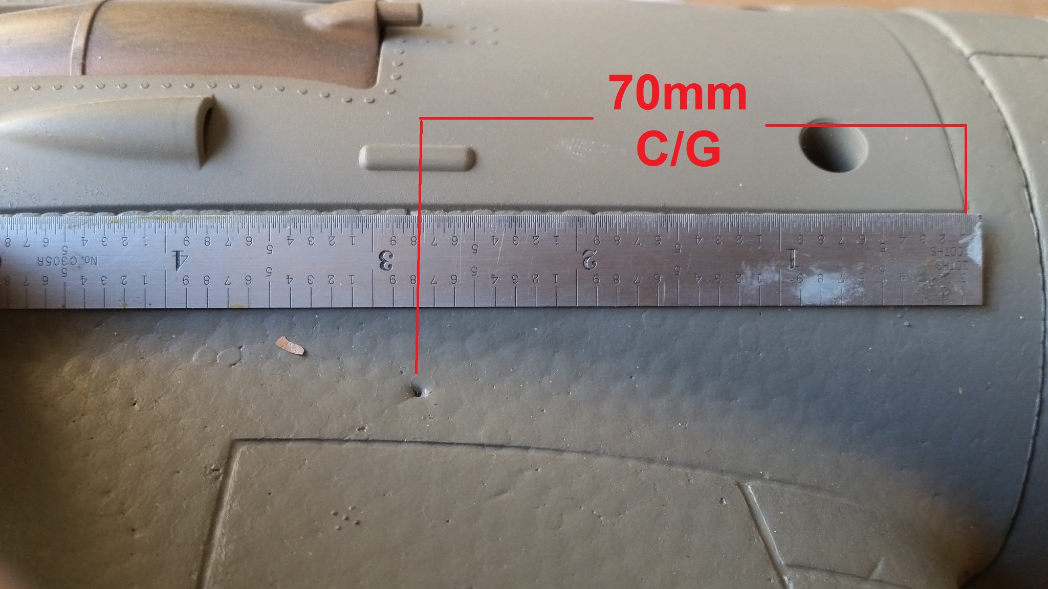

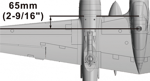

    Originally posted by F106DeltaDart View Post
    I see my problem now, I measured from the leading edge right after the fillet by the cockpit. That is a considerable difference in CG and required several ounces of nose weight to balance. The plane flew very nose heavy the first flight. The next flight, I removed that weight, and kept my 2 admiral 4S 3000s all the way forward and it flew great. Note to self, double check the diagram..
    From what I read and saw on the English version of the plans for referencing the CG...is that it's referenced from the front leading edge of the hard plastic plates on the top of each engine boom and then measured back 65mm. That gives a solid indisputable reference point to start from to set the CG to , even though most of us are using 70mm. that is where I measured my CG from, (the leading edge of the plastic plates on top of the engine booms)

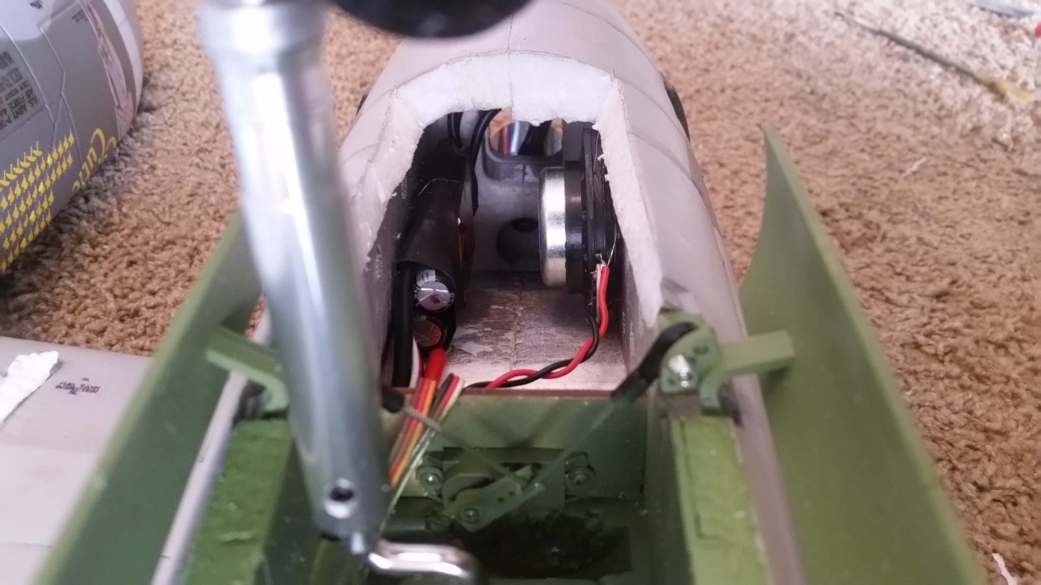

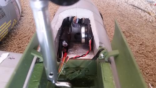

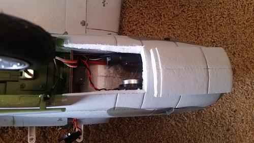

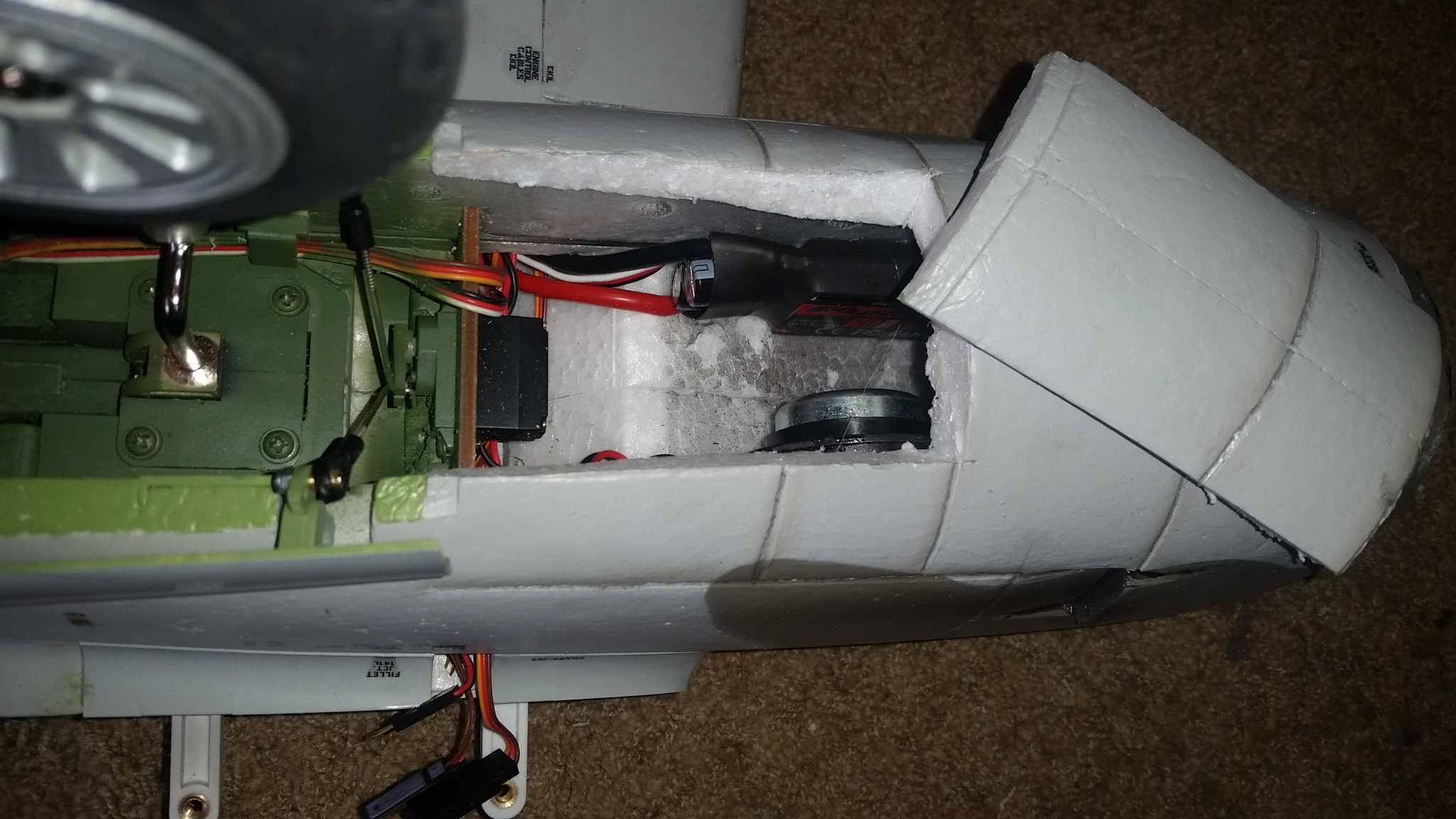

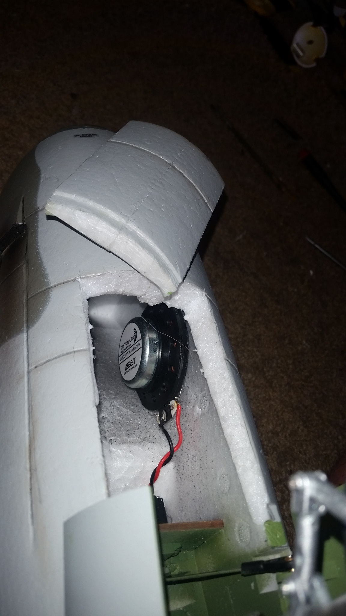

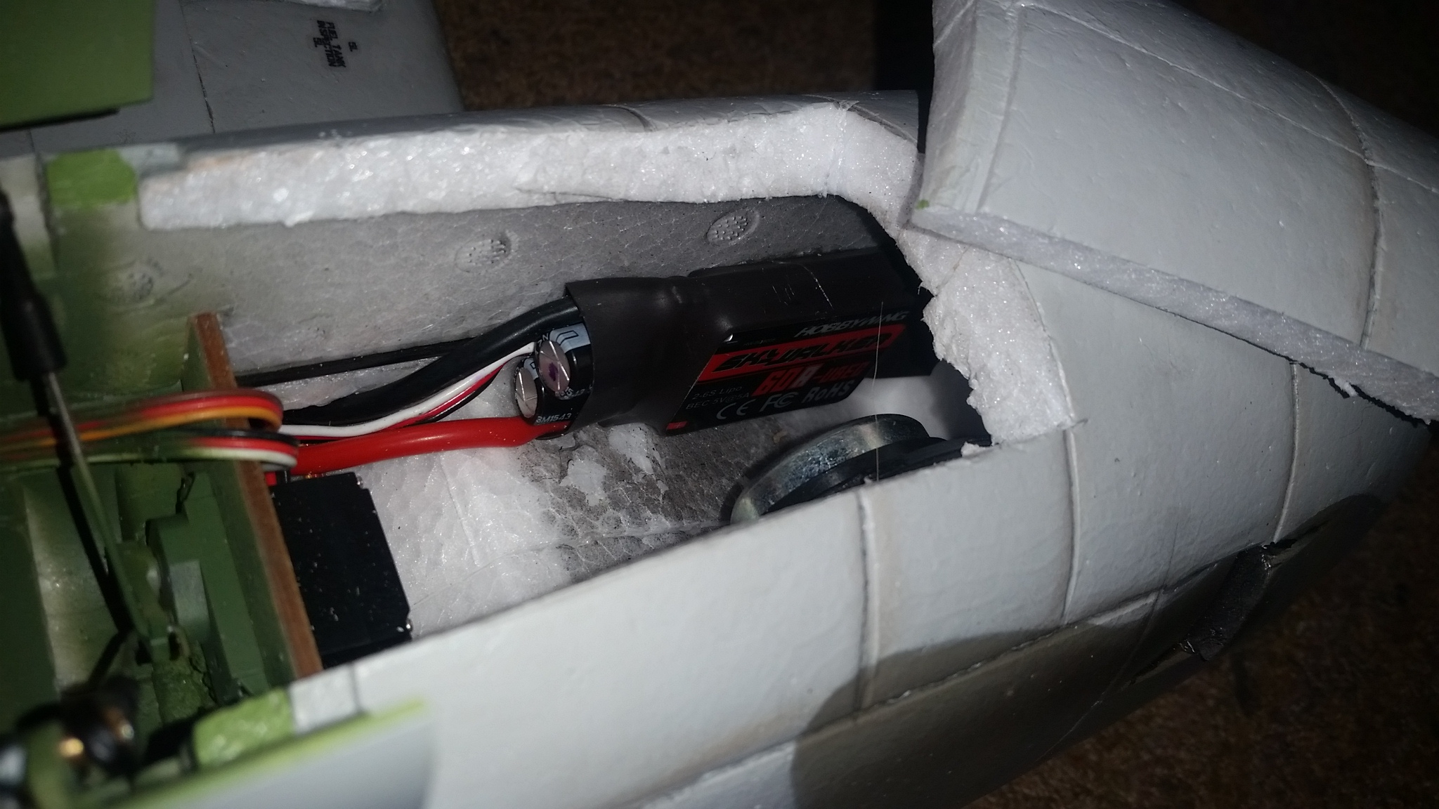

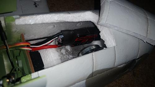

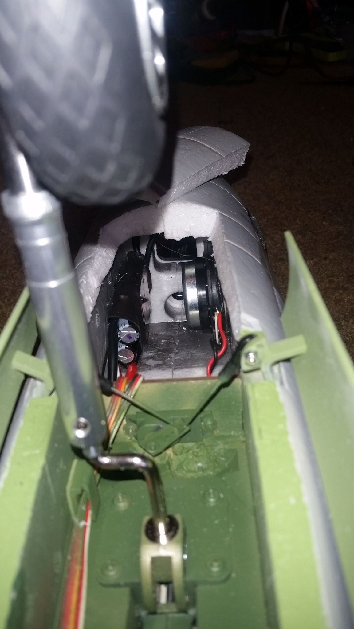

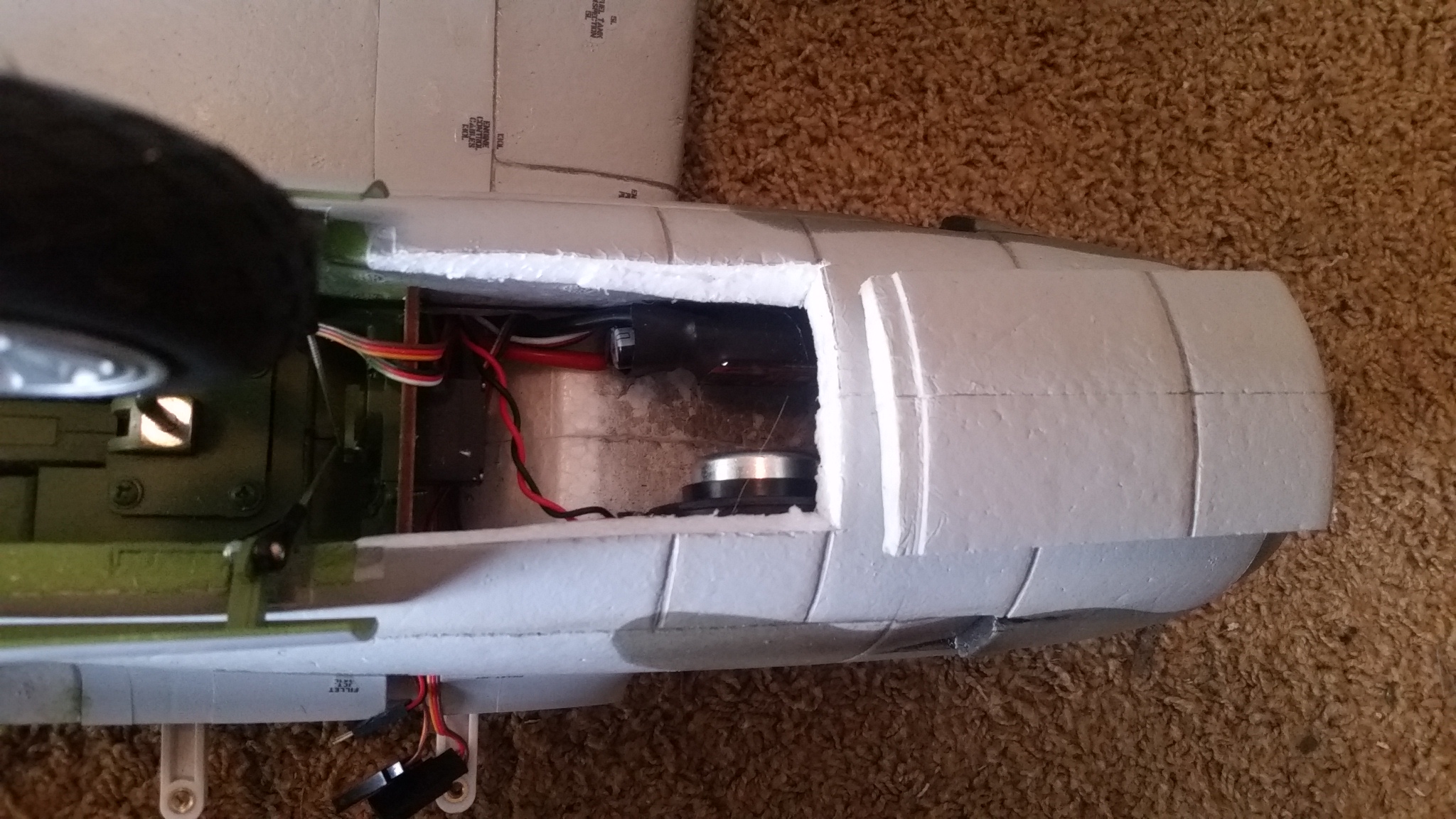

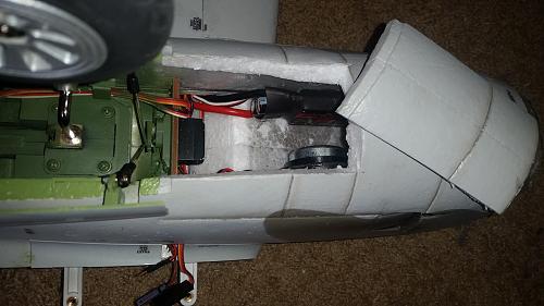

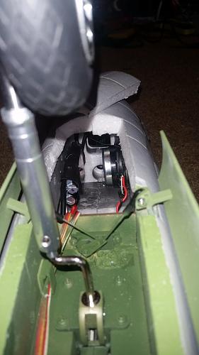

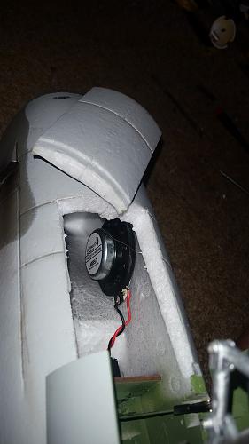

      • Have the TT25 speakers installed....just waiting on the new "Aspire" sound unit from Andrew Click image for larger version

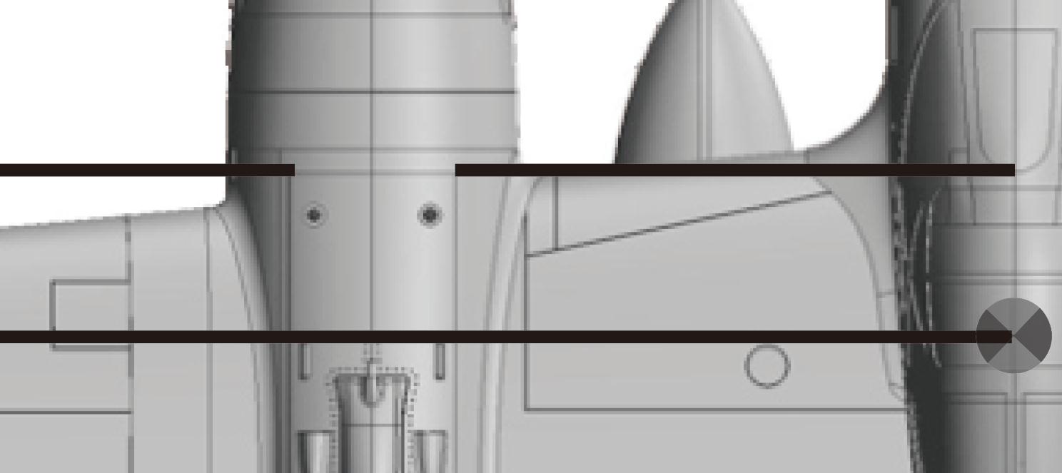

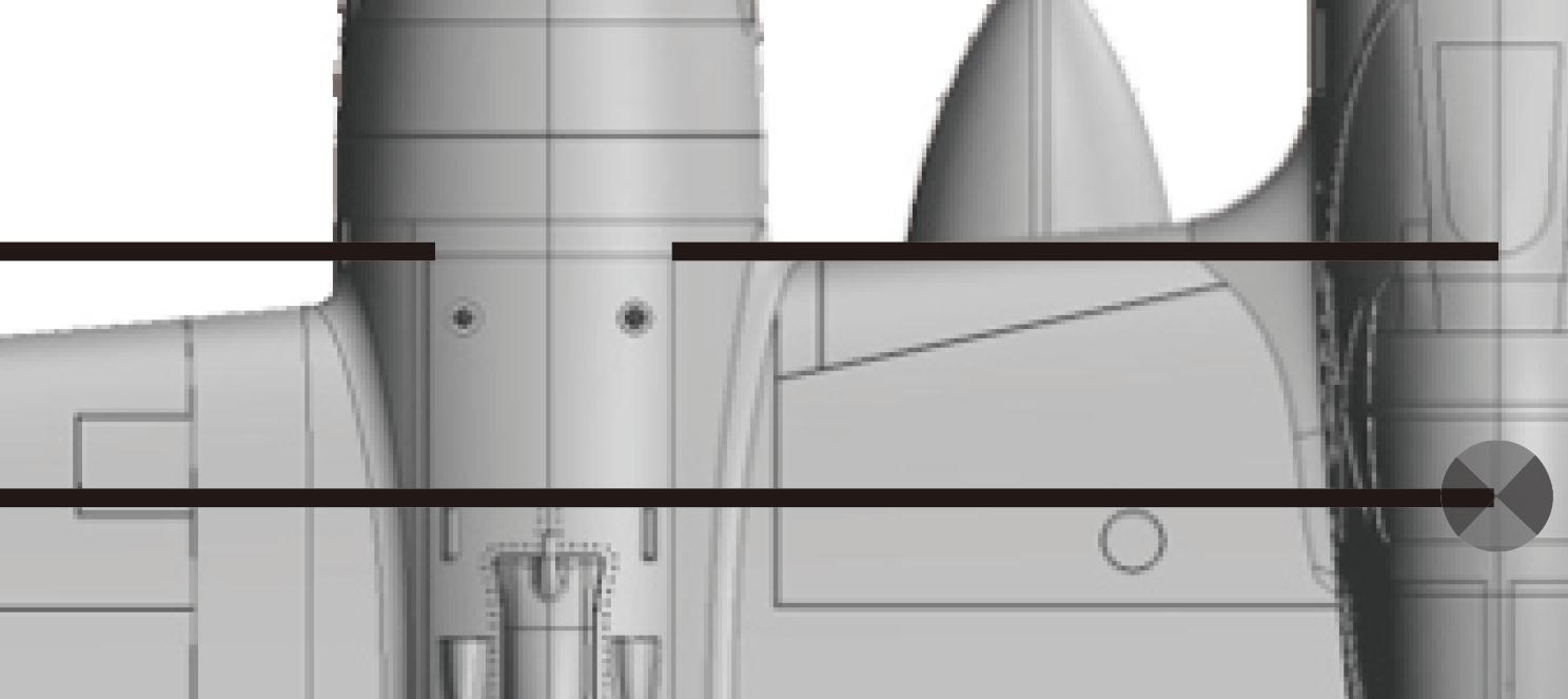

        • P-38 reference point for setting Per the Flight Line Manual. If you set your CG as Arros posted from the leading edge at the wing fillet...you're actually setting the CG @ closer to 65 or less Milimeters Click image for larger version

                                  • Looking forward to seeing your new pilot painted up Brandon, and love the sound addition! Thanks for clarifying the CG as well. However I am sticking with mine because it's flying great right now and I don't want to mess with it, lol...
