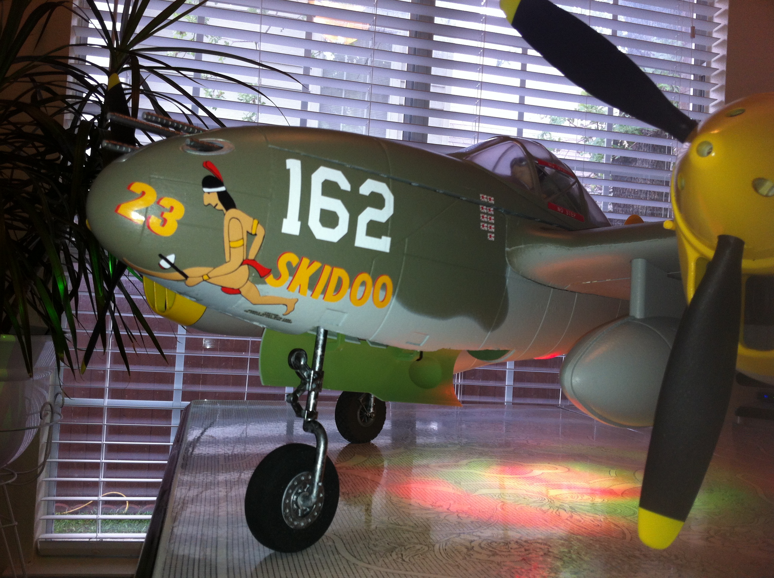

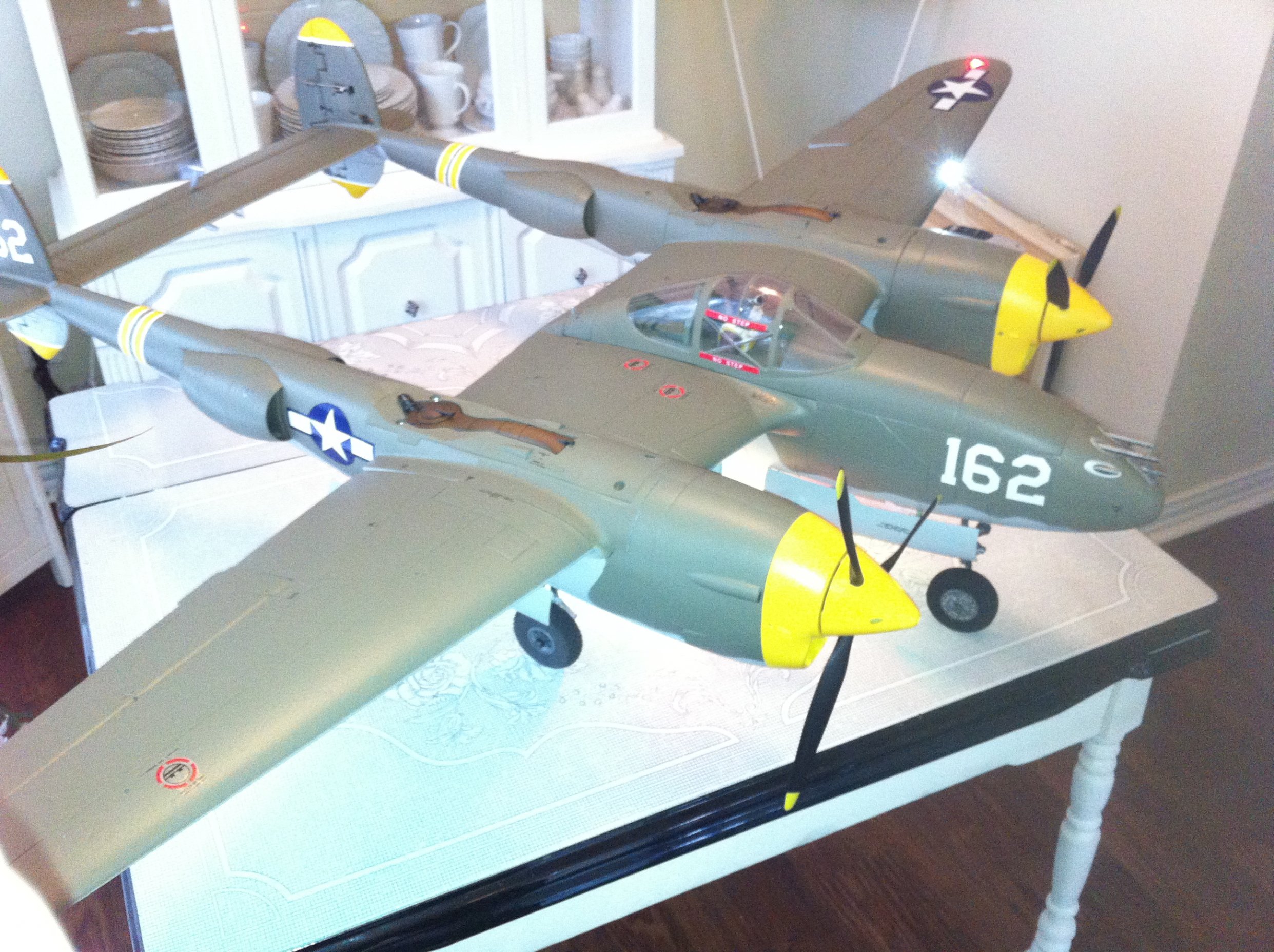

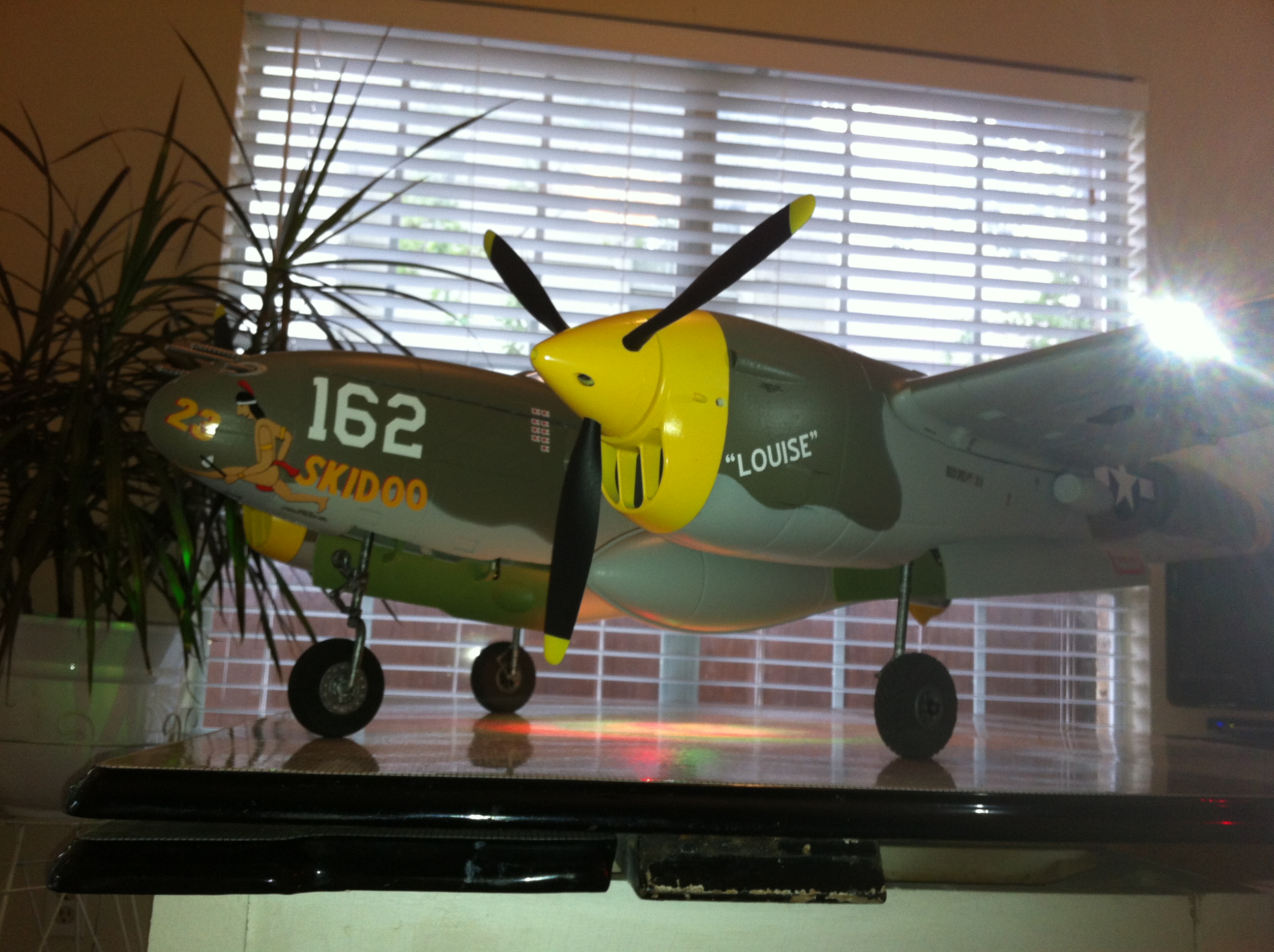

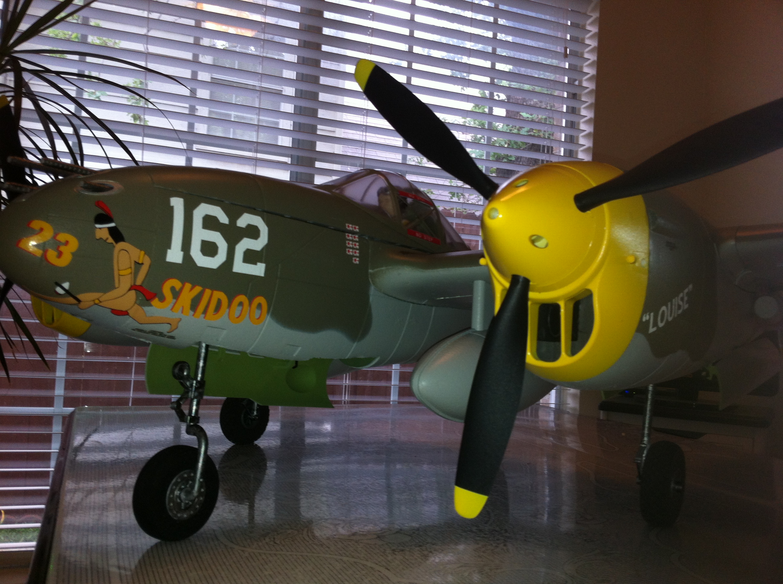

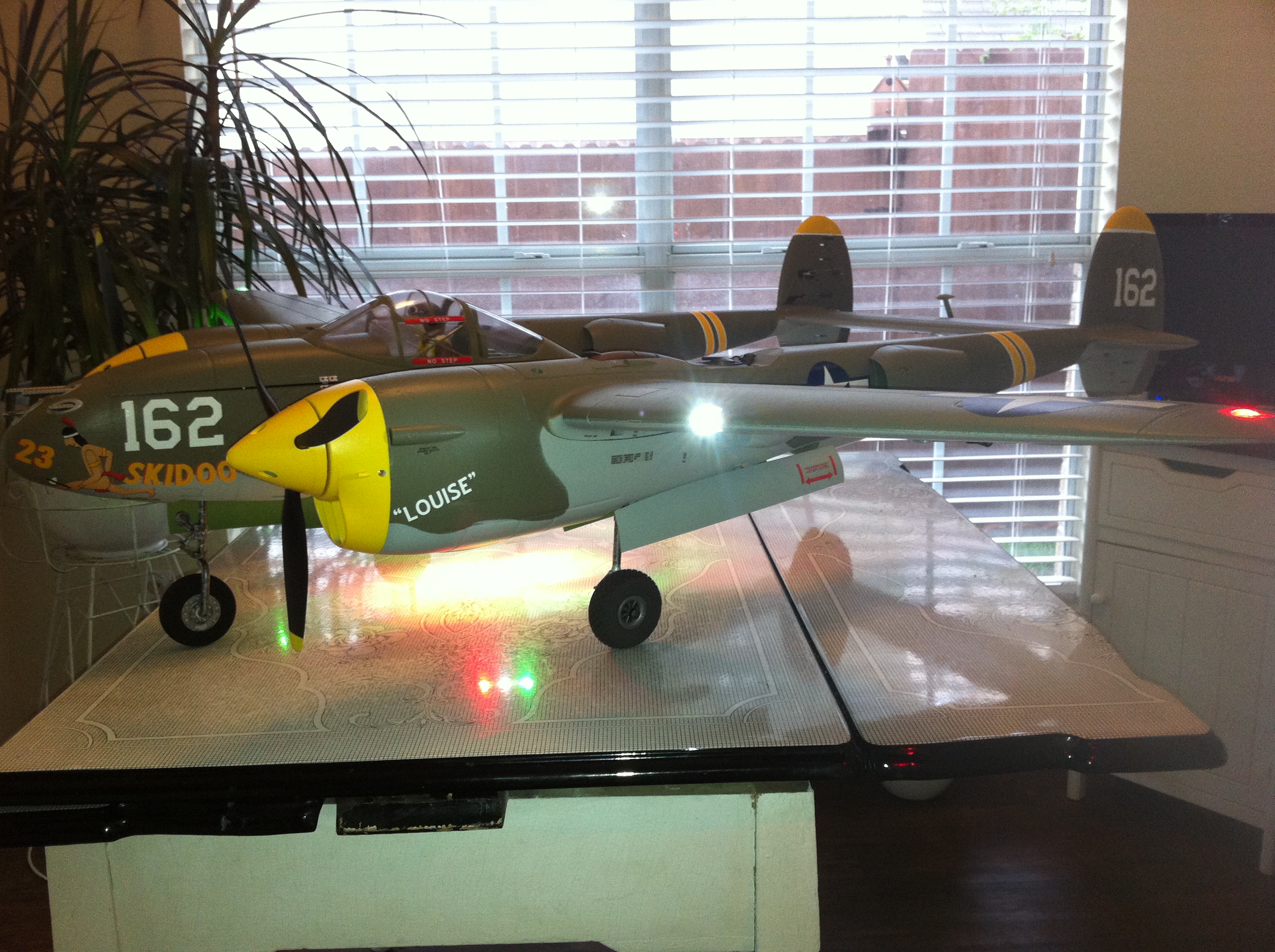

                        • It's been raining for days now in Fort Worth Texas.....even if it stops for awhile our club field will still be very muddy soft for a long time.....so I decided to follow through with setting up my OD P-38 for the Skidoo graphics I ordered from Callie Graphics......
                          I took the Canopy into Lowes Hardware for a paint match.....they nailed it perfectly with an eggshell finish Latex base. I spent a fair amount of time applying the stripes and back painting in the tail booms....then painting in the rudder tips with white pin stripes. By no means perfect yet represents very well. I might try to weather this airframe but a little apprehensive about it.......
                          I can't believe I tacked on all of the decals.....they add plenty of close up fidelity yet barely visible beyond 5ft.
                          I deployed the Du-Bro 2.75inch diamond wheels and moved one of the stock mains for my nose wheel.....now awaiting the rumored V2 landing gear modification package for the struts although I was prepared to customize all three as noted by previous builders on this thread.
                          I am pleased with the results of my build....and very excited at how smooth and straight the spinner and prop assemblies are turning.....overall this is indeed an exceptional foamy airframe.
                          ​TwistedGrin

                              • Arycon - the struts are the stock version for now....I painted them silver with an overcoat of gunmetal silver - then a shadow of silver again. Can't wait to see what the stock drop in version struts may be.....although the Flightline P-40B struts with the FMS wheels would still work just fine as others have vanguarded for us!!
                                23 Skidoo -
                                The plane, numbered 162, has the markings that Captain Dahl's plane had while he was with the 432nd fighter squadron. Captain Dahl was a WWII flying ace who flew a P-38 in the Pacific Theater. Five victories were needed to become an ace. Nose art is an American Indian brave, running with his tomahawk. Text on side of plane: "Pilot captain Perry J. Dahl / Crew Chief T/SGT Doyle Dowell". Plane is marked with 9 Victories. 23 Skidoo is a saying from the 1920s, and another way to say 'getting out while the getting's good.'
                                ​TwistedGrin
