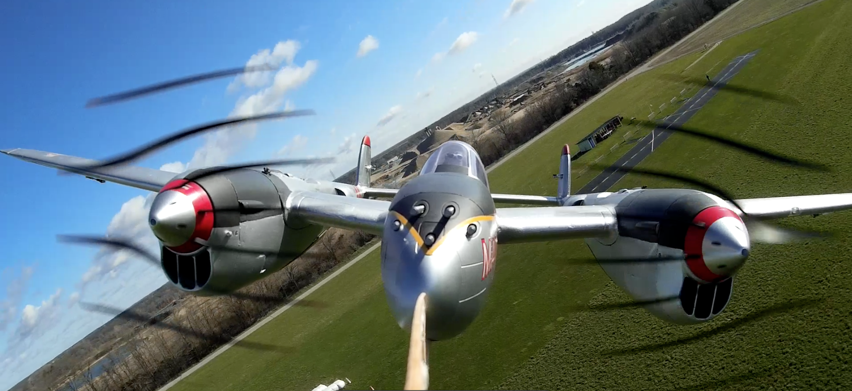

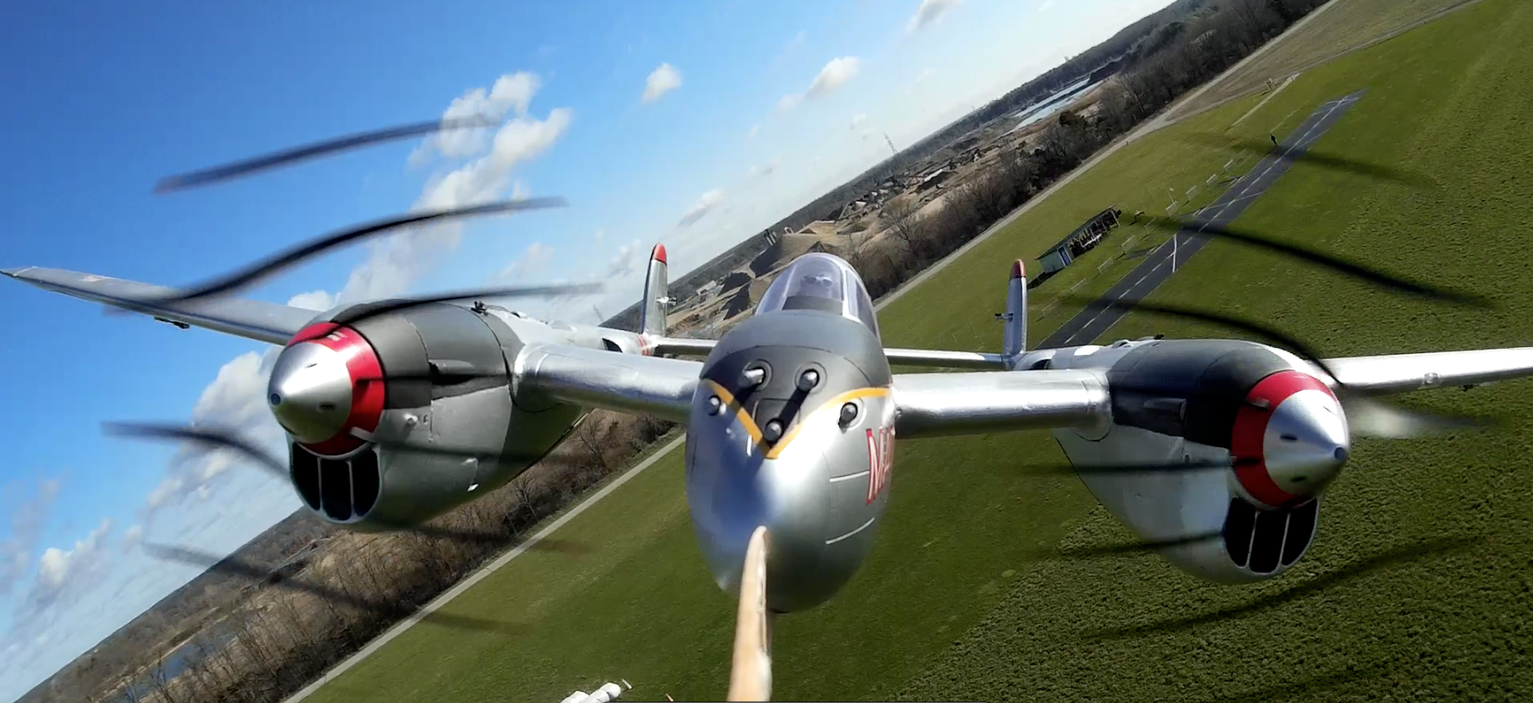

Name:	Screen shot 2016-04-12 at 10.26.54 AM.png
ID:	38348 Click image for larger version
ID:	38349 Here we go, I hope.
                      • ryramZ
                        Pilot Ryan
                        • Dec 2012
                        • 814
                        #1551
                        Here we go, I hope.
                          #1552
                          Nice looking bird there Pat!
                          Arycon, yeah 70mm is right in the pocket, same with the 4mm elevator up at neutral. Good luck in the maiden!

                                Nice shot Ryan! Glad we finally got to see it. Any videos coming soon?
