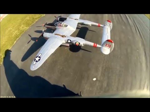

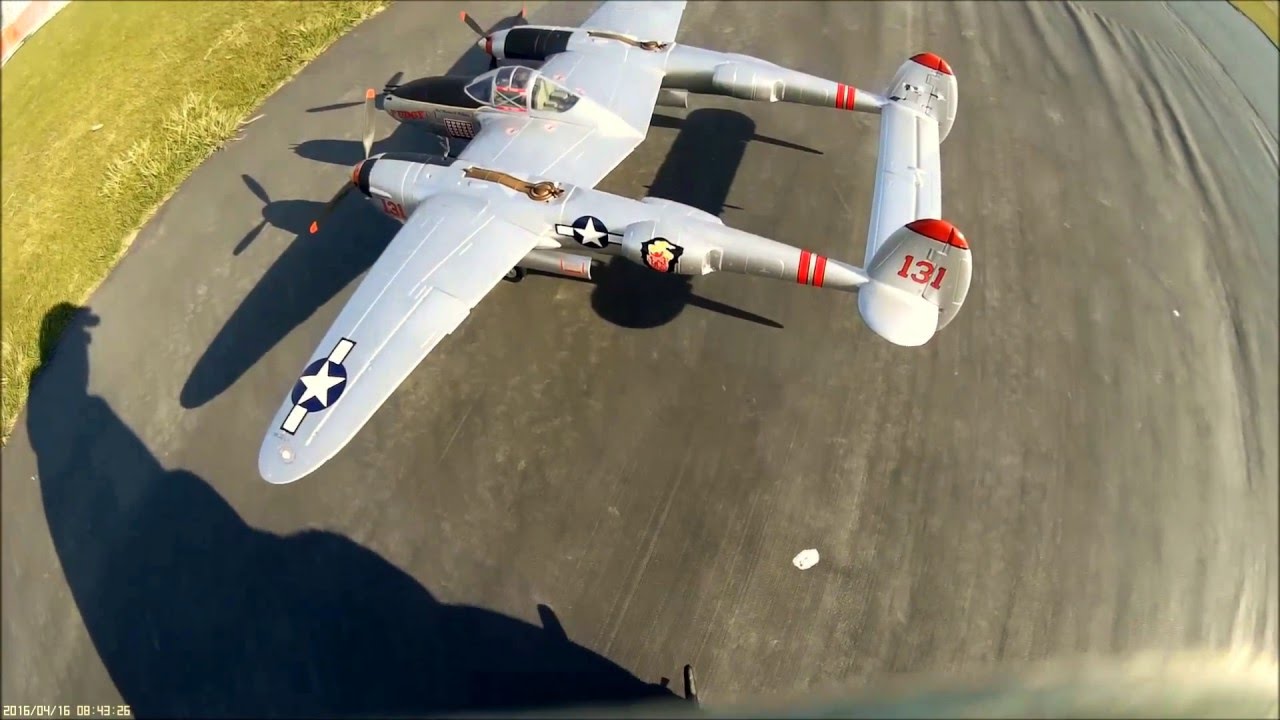

    Obviously, when downloading this video. I didn't get it done in 1080p. Sorry about the quality. But it was a great maiden. The pilot(me) flew the first few minutes with the flaps in the take off position...at least that was the worst thing that happened. I hadn't done any mix with the landing flap position...so had some ballooning effect. I've since got that mix pretty much dialed in. With the crosswind i missed our small runway, I was more concerned about all the other things, than touchdowning on the runway. She handles the rough grass very well. The stock retract system and wheels handled it very well, though after the 3rd flight while checking her out, i caught that the right strut was becoming loose. So a couple minutes spent tightening the grub screw on that one before the next flight. With the weather forecast for tomorrow, I will have her in the air again tomorrow morning.
    Here's a better quality of my maiden today.
    Last edited by Lon; Apr 16, 2016, 07:09 PM. Reason: Better quality video of maiden.
