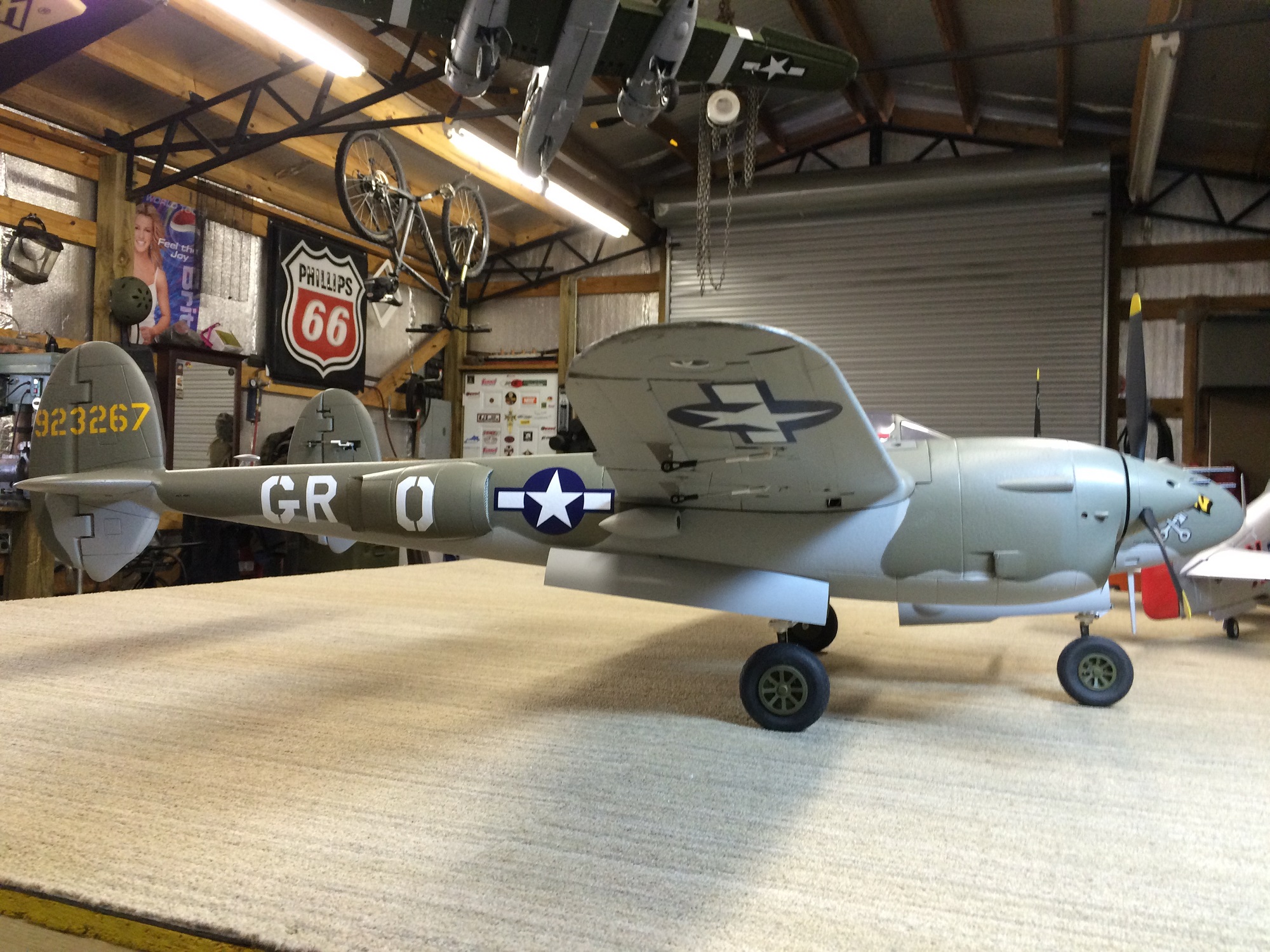

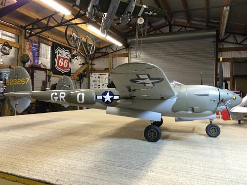

            Here's a few photos of Evelyn's P-38J in the 'Factory Fresh' scheme to pay tribute to the Women's Airforce Service Pilots.
            I still need to rack the gear, add the Robart wheels, tail numbers, female pilot figure, wire antenna and final details. I did not add the engine inlet screen, since the real 38's did not have them. Once complete, I'll get going on my allied green "special" scheme.
            Love the factory fresh tribute to Women's Airforce Service Pilots! How cool! However, I beg to differ on the engine inlet screens... ;)

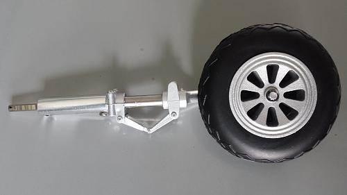

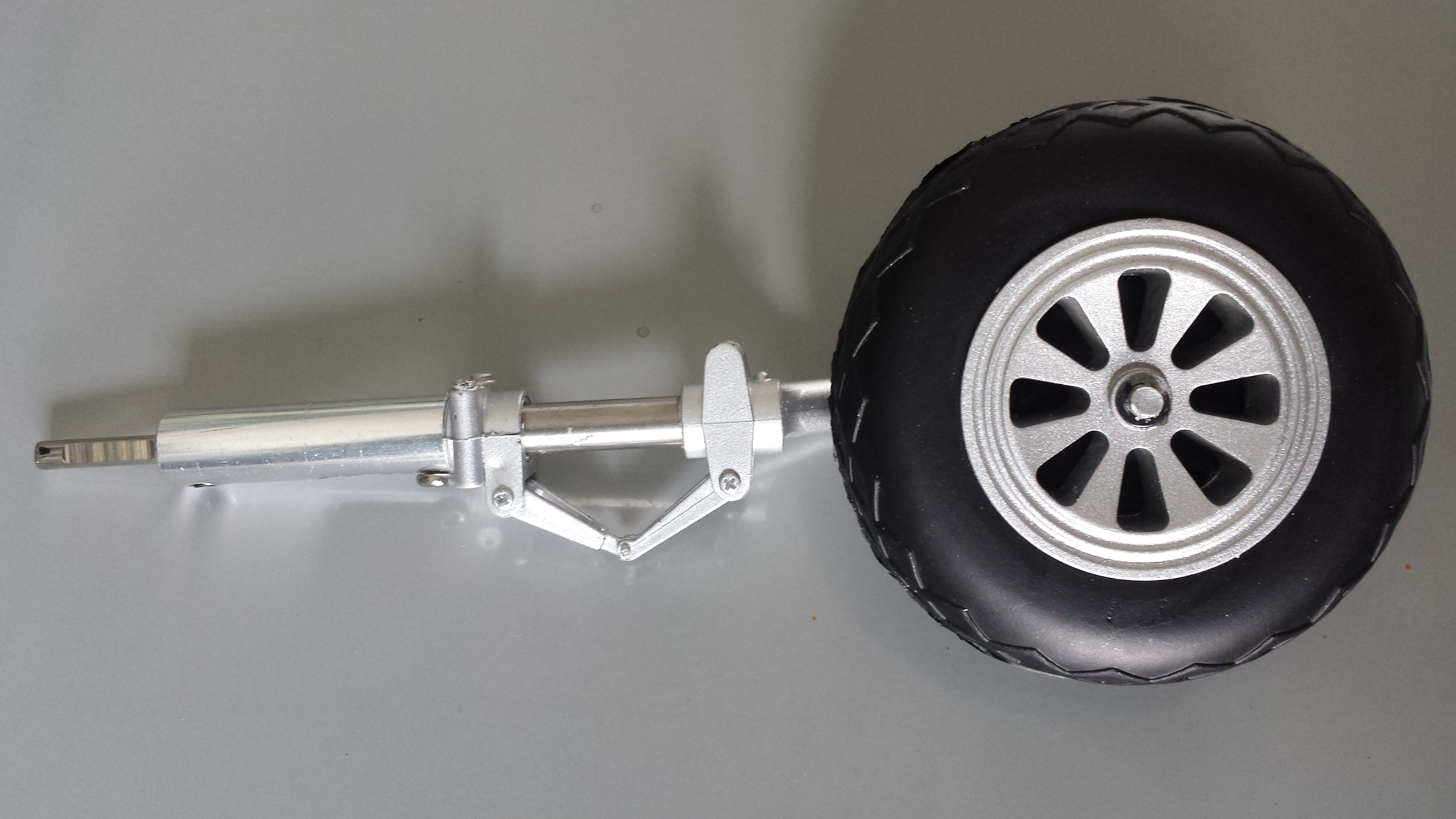

ID:	37667 motion shipped same day, 2nd day priority mail :D:D:D:D, struts are in :o)

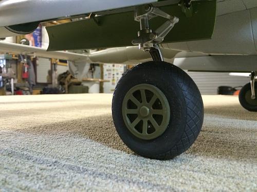

                • Hi there gang, Just got my pacific silver p-38 and starting the build. I have been following this thread for awhile to get a feel for it. Wow, what a wonderful amount of really helpful information by all the contributors! I particularly appreciate all the ideas on "tricking out" this model. Speaking of contributing, I did some research on wheel sizes for the real P-38. The nose wheel is 27 inches in diameter and the mains are approximately 37 inches. At the scale of this kit that works out to 2 1/4" on the nose wheel and 3" on the mains mas o menos. I,m going to order these sizes in the robart scale wheels and see how that works. I love having the wheel collars hidden on these wheels. Cheers

                    [ATTACH=CONFIG]n37667[/ATTACH] motion shipped same day, 2nd day priority mail :D:D:D:D, struts are in :o)
                    I noticed on Motion's website that this item is "out of stock"............ya think that all of us doing the gear mods on our birds has flooded the demand....??? :p

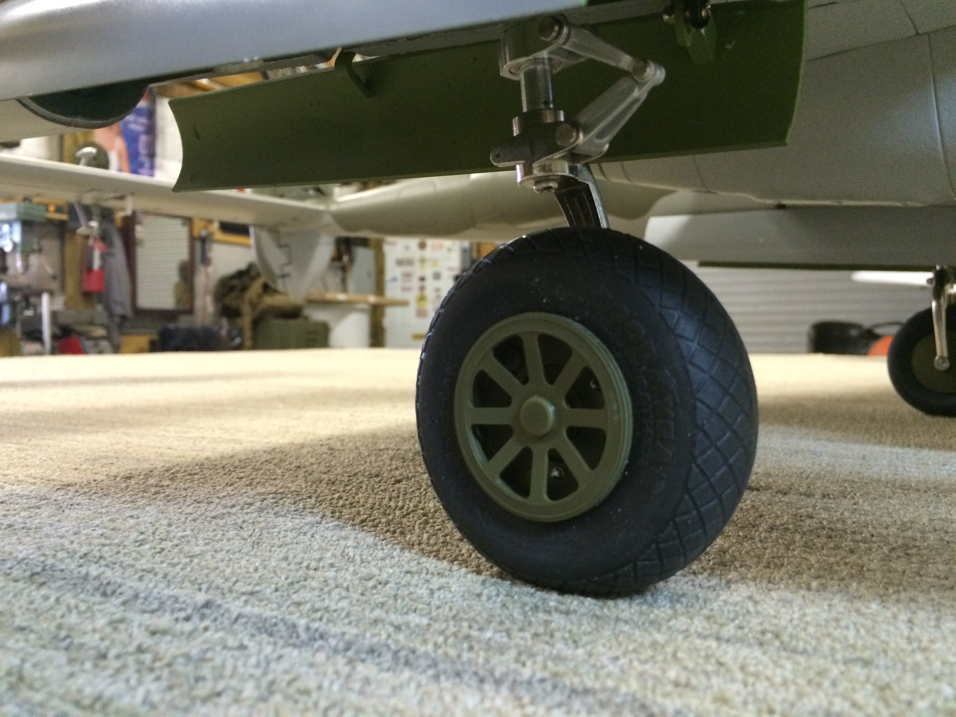

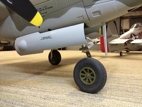

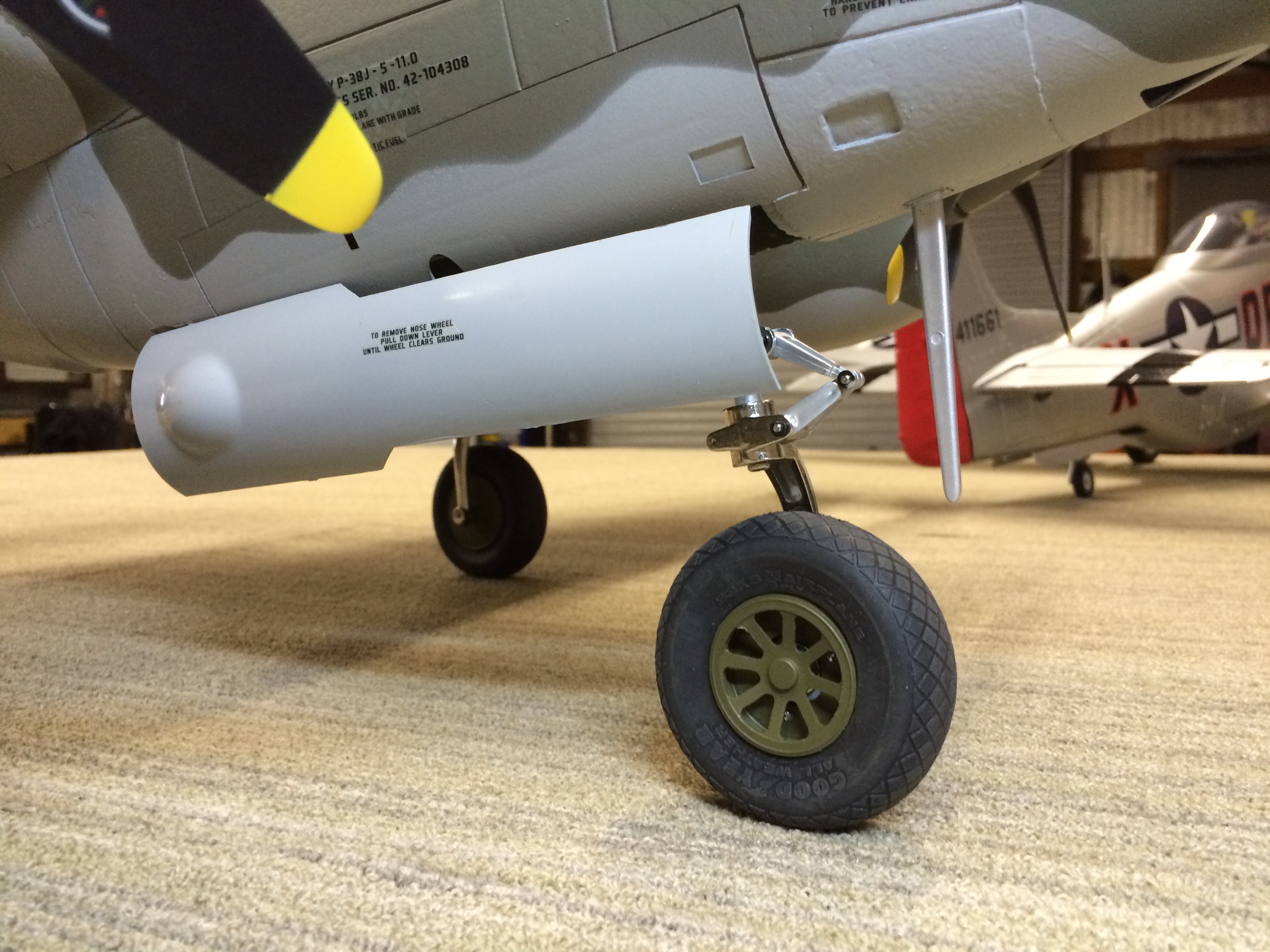

                      • I got the Robart 3" mains and 2.75" nose done today, I did have to trim a little. Be sure to test right side up as well, that's when I found they didn't clear.
