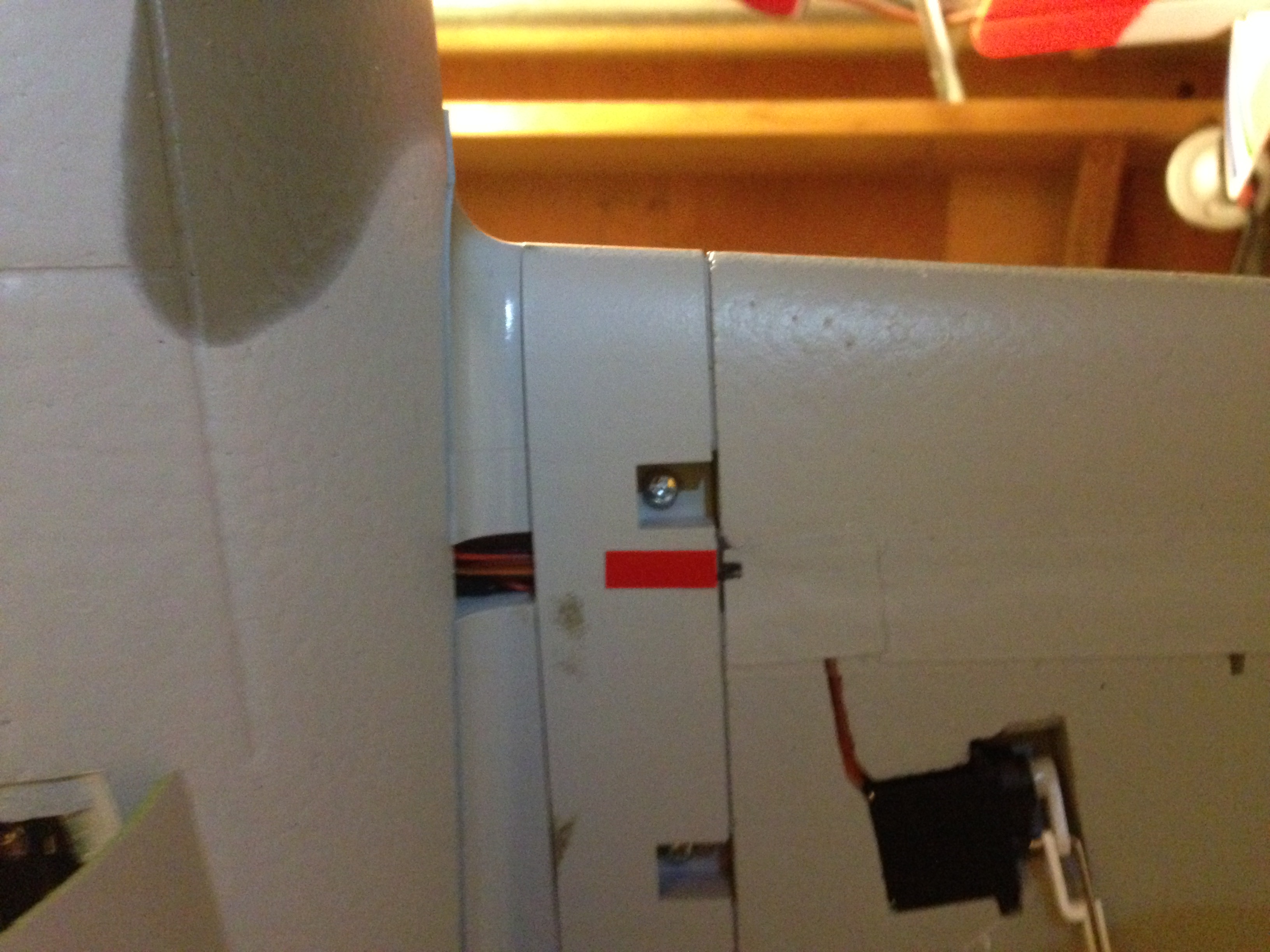

  • Here's a picture of my CG mark. The middle of the red tape is 65mm as per manual. I'll probably balance it at the 70mm mark like Aros.

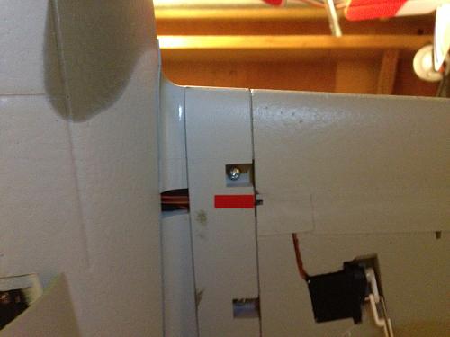

      Here's my CG location. 72mm which puts it at the leading edge of the inboard wire covering. A bit tail heavy with gear up (I have Robart wheels) but totally within limits.
      Perfect, thank you!

        • Originally posted by xviper2 View Post
          [ATTACH=CONFIG]n36875[/ATTACH]
          Okay, I'm either a complete idiot, or I'm missing something here. If I use your marks, and balance the plane, it comes in nose heavy. 65mm and nose heavy. When I balance at Aros marks, it shows tail heavy. 70 mm and tail heavy. 5mm difference, and the balance is shifting in the opposite direction it should be. Something ain't right...

              • Originally posted by FLTRI View Post
                Oh, I don't think you're an idiot. I think it's just the kind of plane that is really hard to support level. They say to do it with gear down and right side up. This is contrary to how I do most of my planes (except high wing planes). Due to the upward (dihedral) sweep of the wings and having the gear down is likely the reason why they want us to balance it right side up. Most planes I balance with gear up and held upside down.
                Some planes are just so finely weighted top to bottom (ie, CG near the central part of the wing root line), that holding it level can become difficult and the slightest tilt one way or the other will make it continue to go in that direction. In other words, no matter which way you hold it, it's heavy towards the ceiling. That makes any teeter totter hard to keep level. Personally, on a large plane like this, I don't think 5mm either way is going to make or break the plane (I hope). Sometimes, the placement of my battery in any particular plane can be off by 5mm and I've got a reference mark drawn.

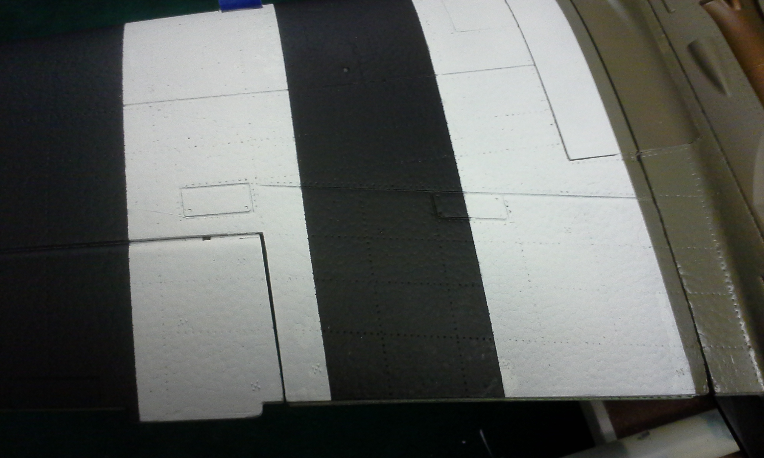

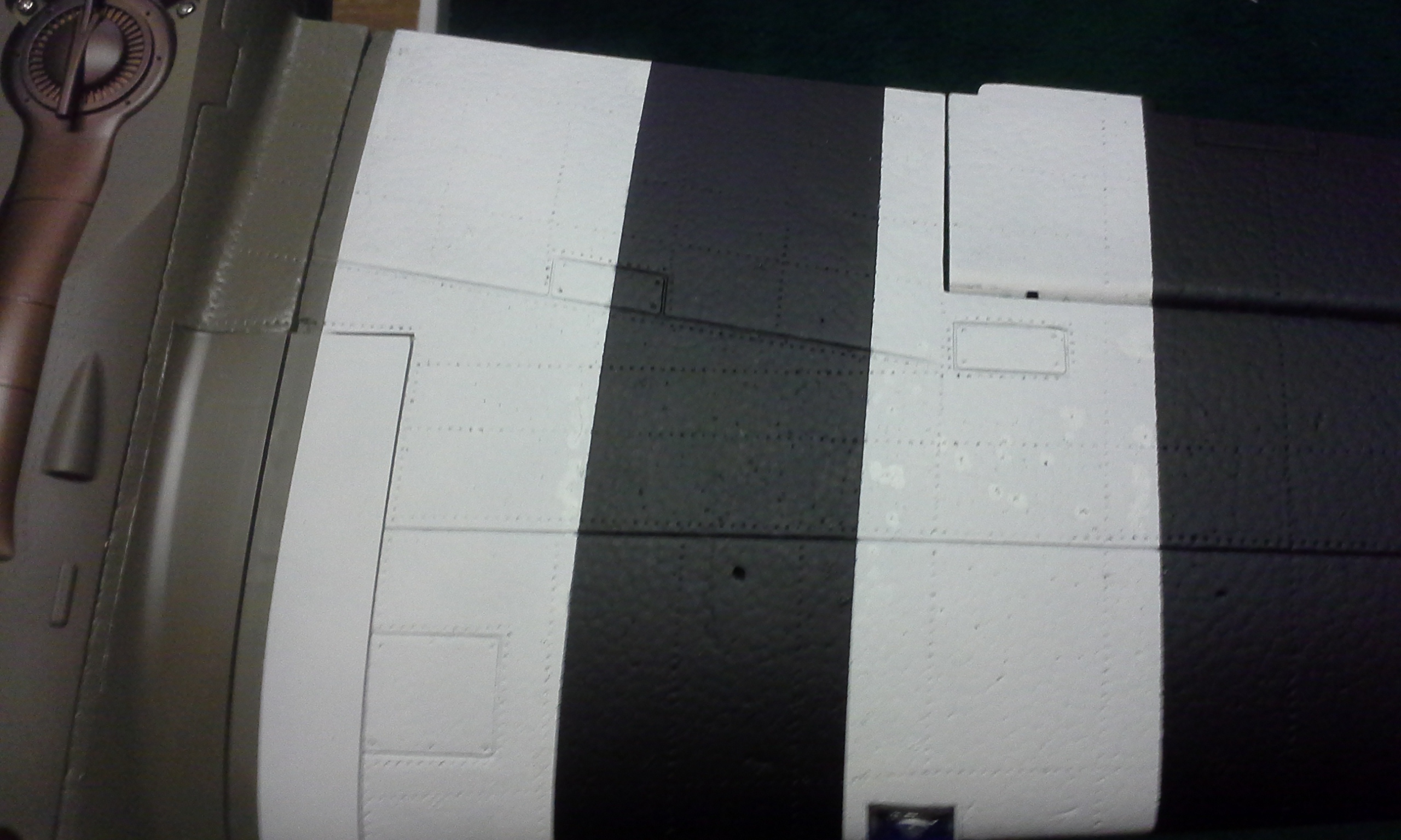

                        • Got back from the Toledo show and jumped back to building.

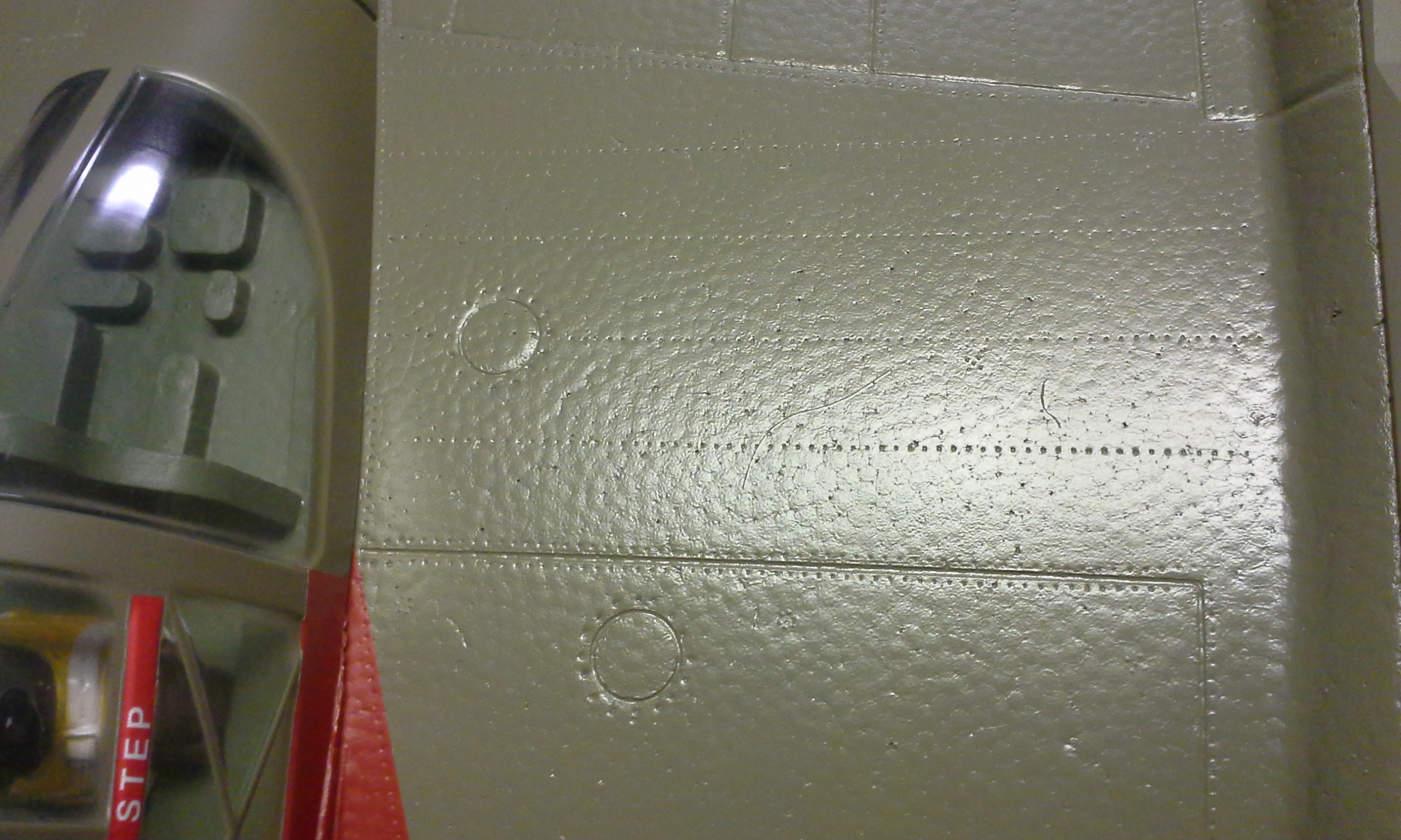

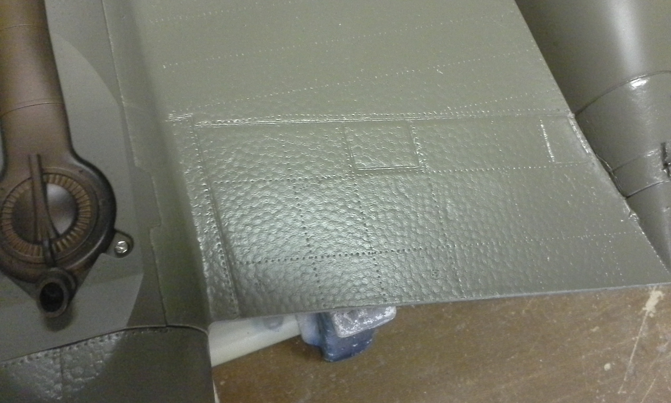

                          Did some rivet work on the wings last night. Though they're hard to see it does add to the effect.

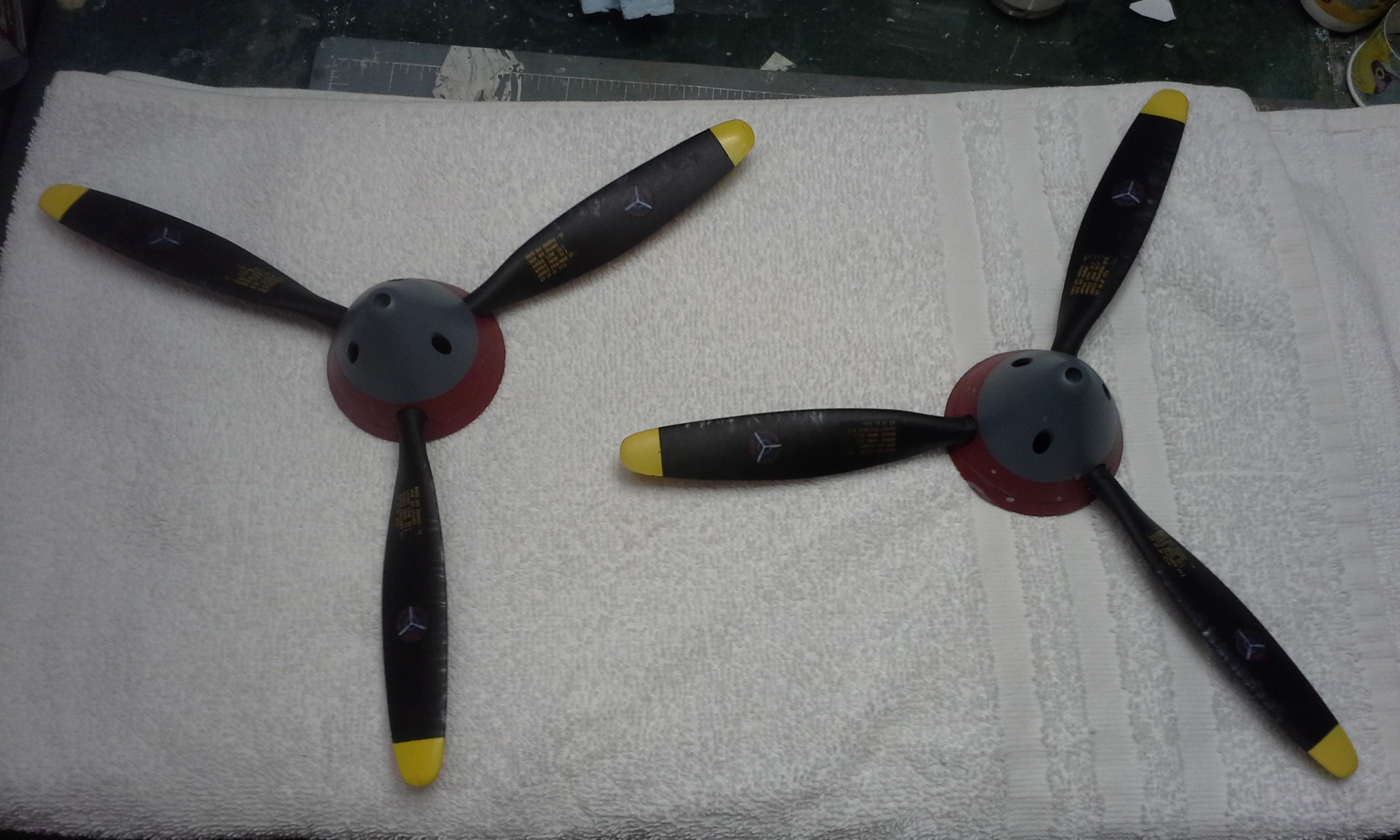

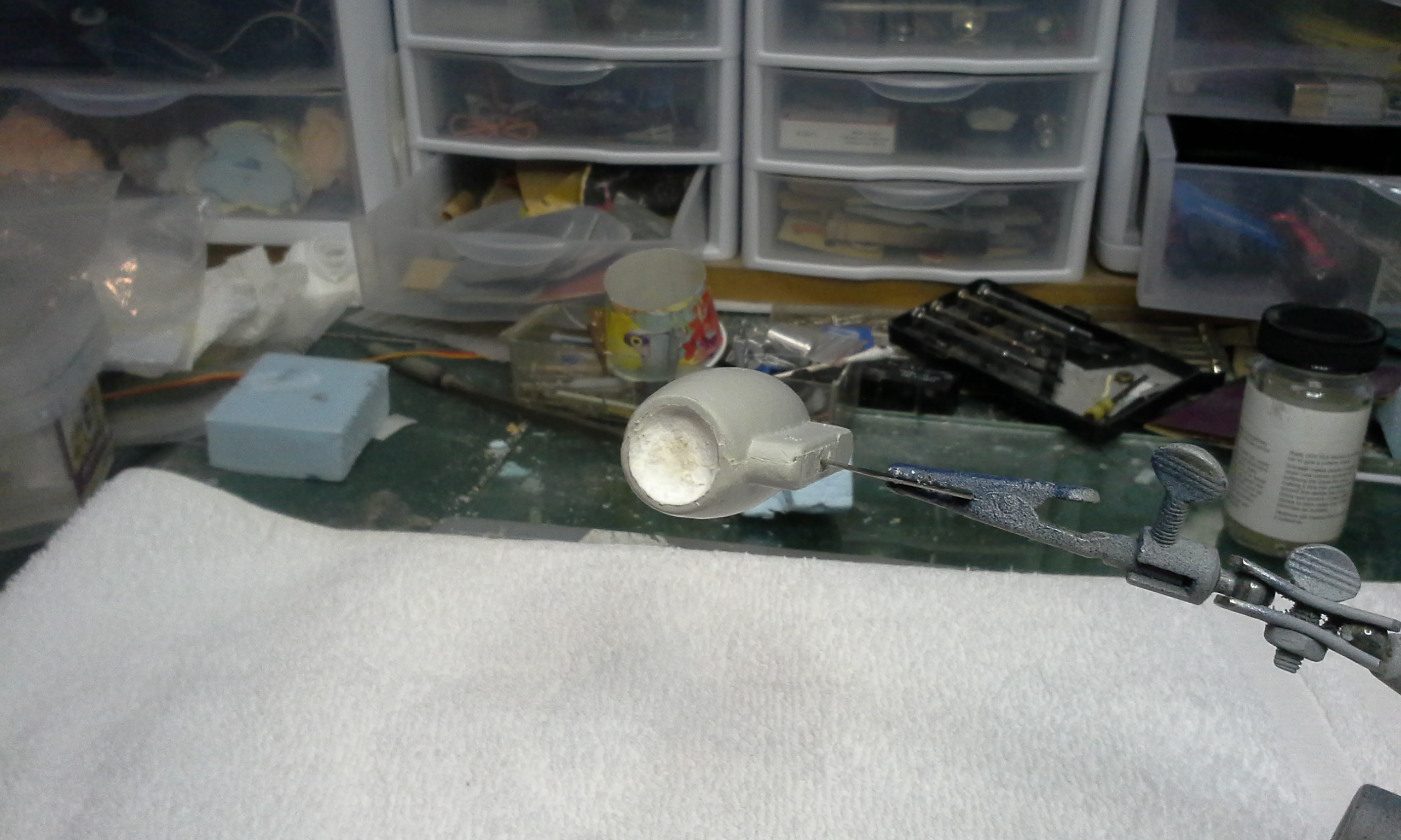

                          Today the props were painted and weathered. Tomorrow they'll be balanced then for all purposes " Little Pig " is ready to fly.
                          Did some work to the super charger intakes. They will be sealed and painted tomorrow. With major construction done I can now get to the cosmetics.
                          Tomorrow I'll add rivets to the booms and pod.

                                    • Aros...........THX. Doing the rivets isn't too bad. I'm using a pattern marking wheel used in sewing. Just follow a straight edge with very little pressure.
                                      Woody
