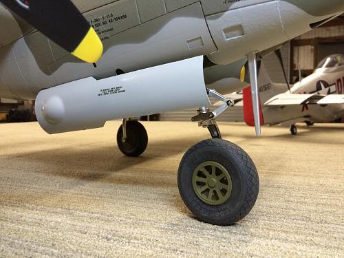

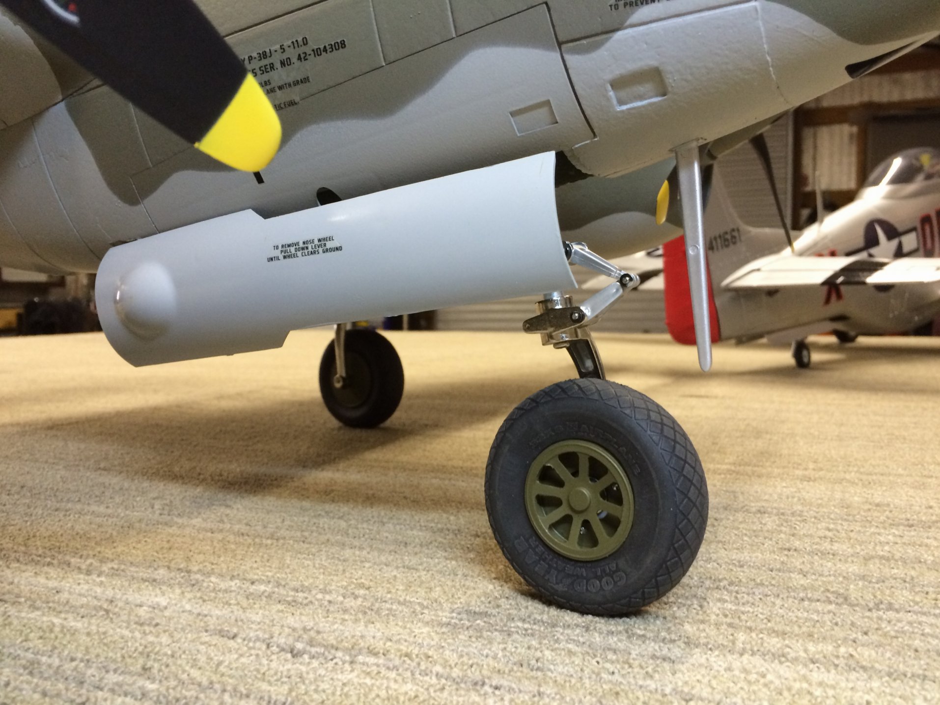

                            Here's some photos comparing the stock, RC Castle, and Flightline struts. My opinion with being able to have both upgrades in hand. Is that the FlightlineRC strut upgrade is the way to go. I'm thinking the spring tension with these Flightline struts is just right.
                            It should also be noted that the grub screws are the next size larger on the Flightline upgrade struts. Thinking this is a good thing.

                                Many of my Freewing manufactured struts have some play (aka slop) in them, some much more than others and that's straight out of the box. On landings, I'm very easy on my planes, so it seems having unwanted movement is just in the nature of the struts. On my new FlightlineRC struts, there is slop in them new out of the box. It's not nearly as much on the mains, but the nose gear has a good amount.

                                  Yes I have. In fact I don't think I have a plane with retracts that eventually doesn't get some play in them.

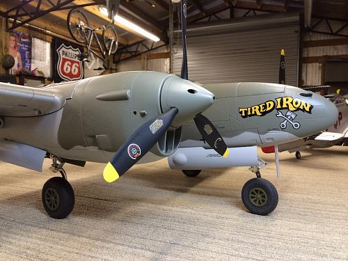

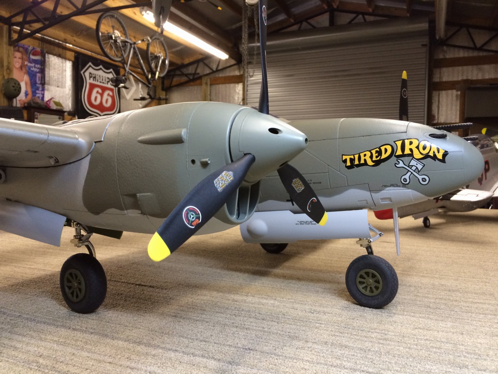

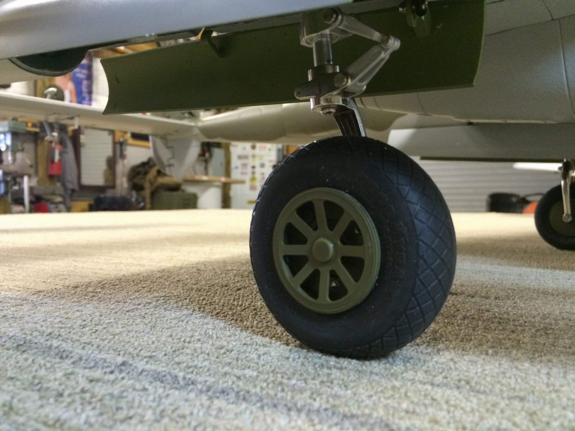

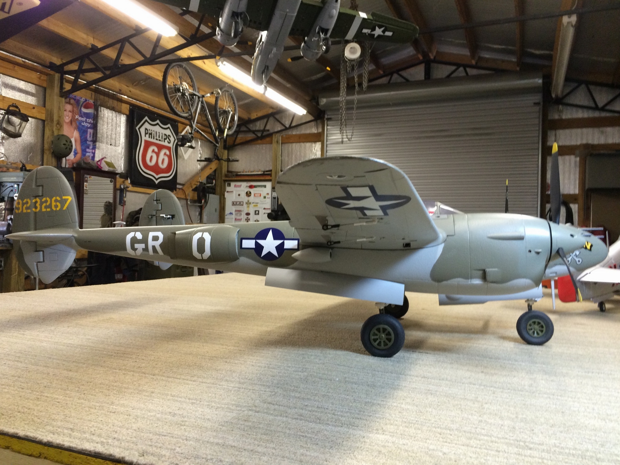

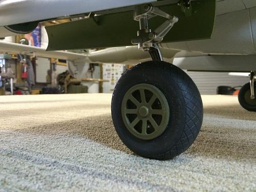

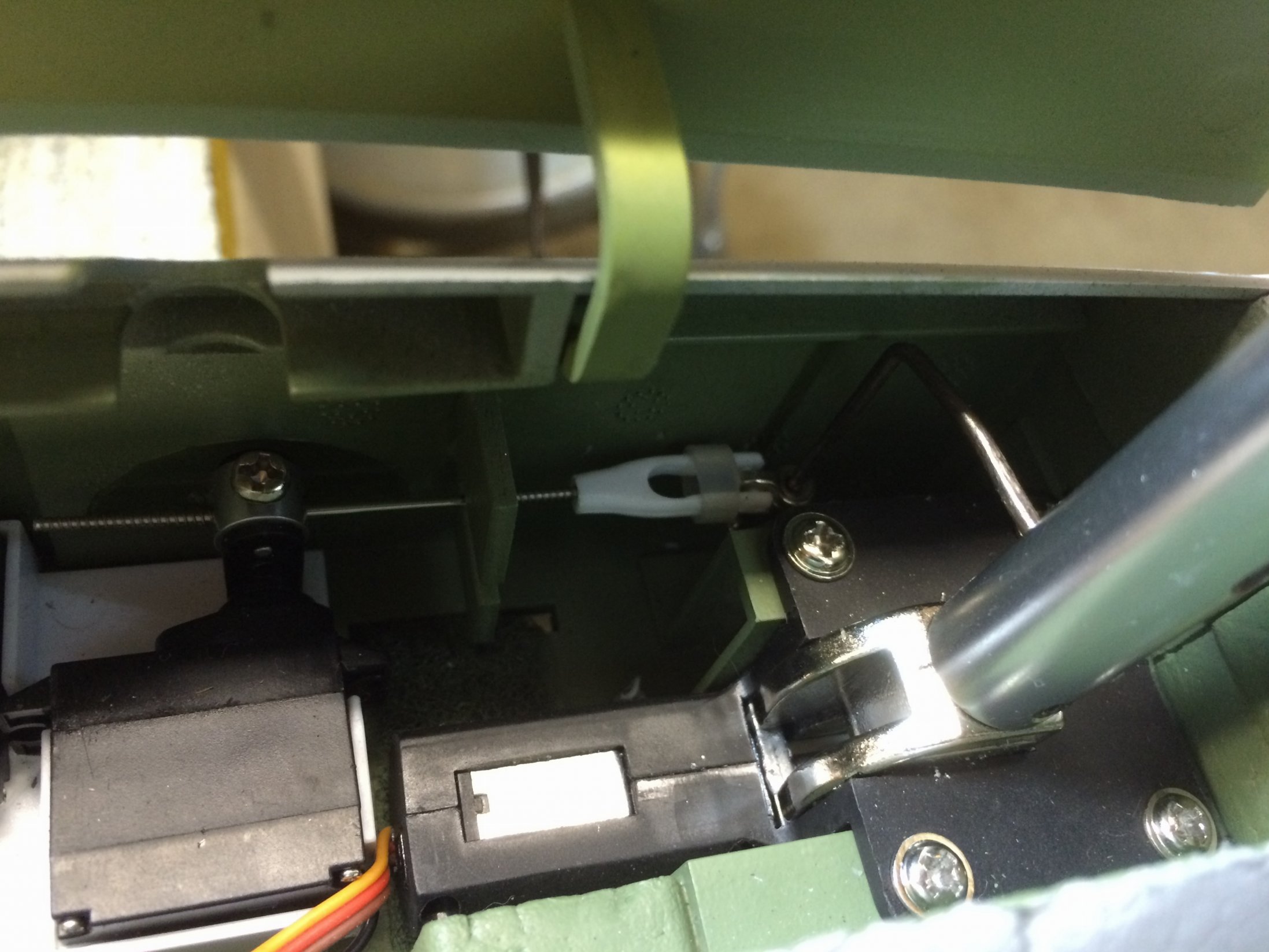

                                      One of the main reasons I did the first P-38 strut conversion was to get rid of the weak wire that bends easily on grass runways, mounting the strut right against the trunnion makes for a much stronger gear.
                                      Both of the aftermarket solutions still have the weak 4mm wire, other than the mains having the more scale straight legs I don't really understand why anyone would go with them rather than the FMS or Freewing struts.
                                      I like the detail much better on the Freewing struts.
