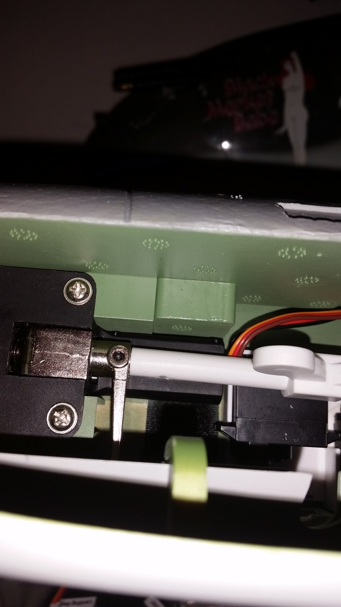

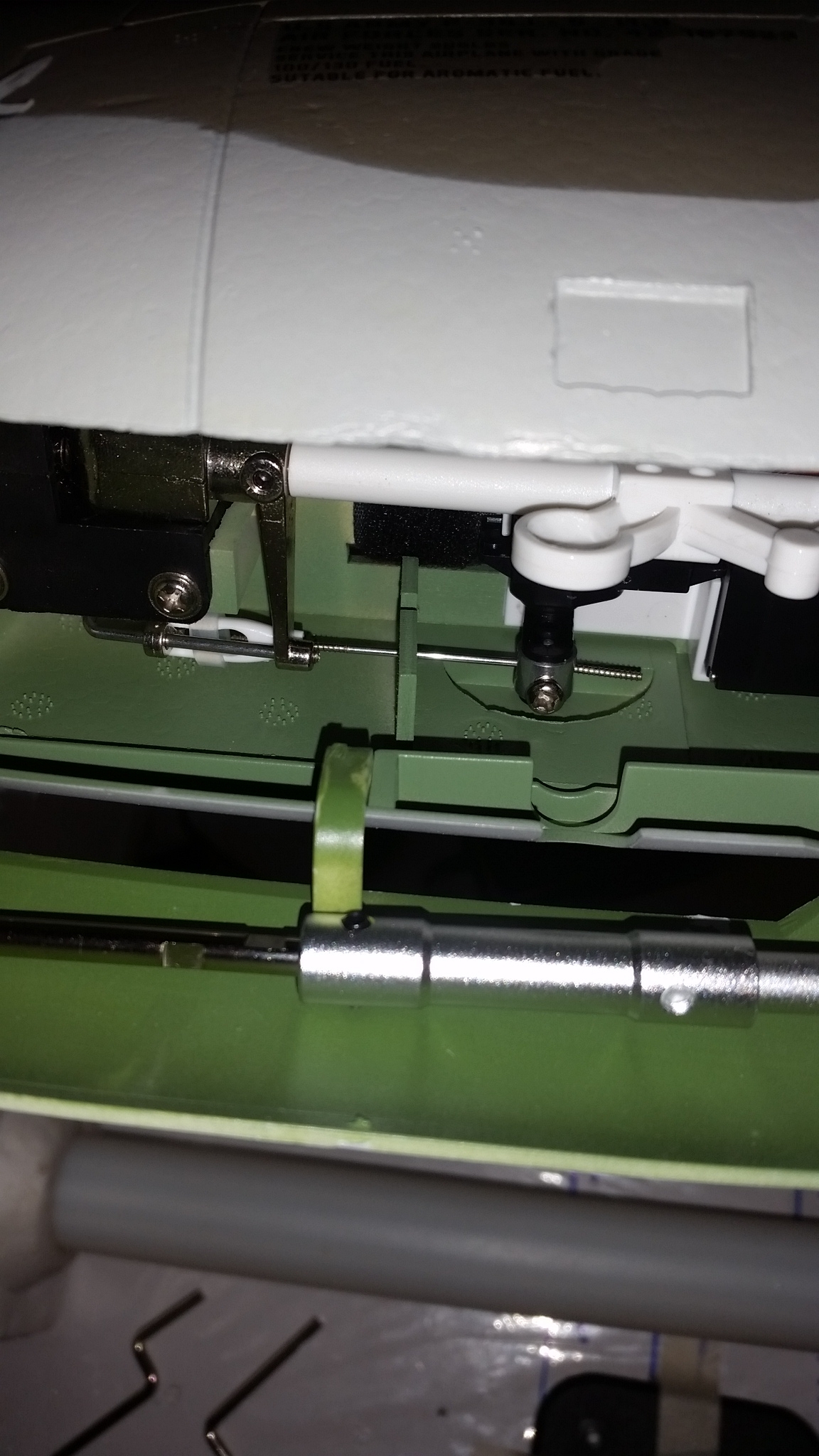

        • Something I just now noticed. When extending the nose gear, it works fine. But when retracting, there seems to be a glitch or catch somewhere as tho the tire is catching on the door as it retracts but I can't see any contact there. Wonder if this the servo. It's like the servo has a "hesitant glitch" when retracting. I'm using my Servo-Ciser from Electro Dynamics.

          • I also see that the nose strut from Castle has 2 set screw flat points where the stock has only 1 that I can get to. The other set screw position on the Castle is on the opposite side of the stock, where the stock doesn't appear to have an access to a set screw, just an indention in the plastic. See 1st pic, indention is at the bottom of the strut. 2nd pic (Castle strut) shows the second set screw on the opposite side of the indention on the stock gear. If I see things correctly, the whole landing gear and servo assembly must come out to remove the stock L/G wire and insert the Castle L/G wire to match up with the 2 set screws? What a pain! Click image for larger version
ID:	47898 Click image for larger version
