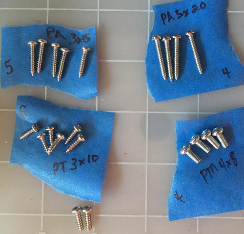

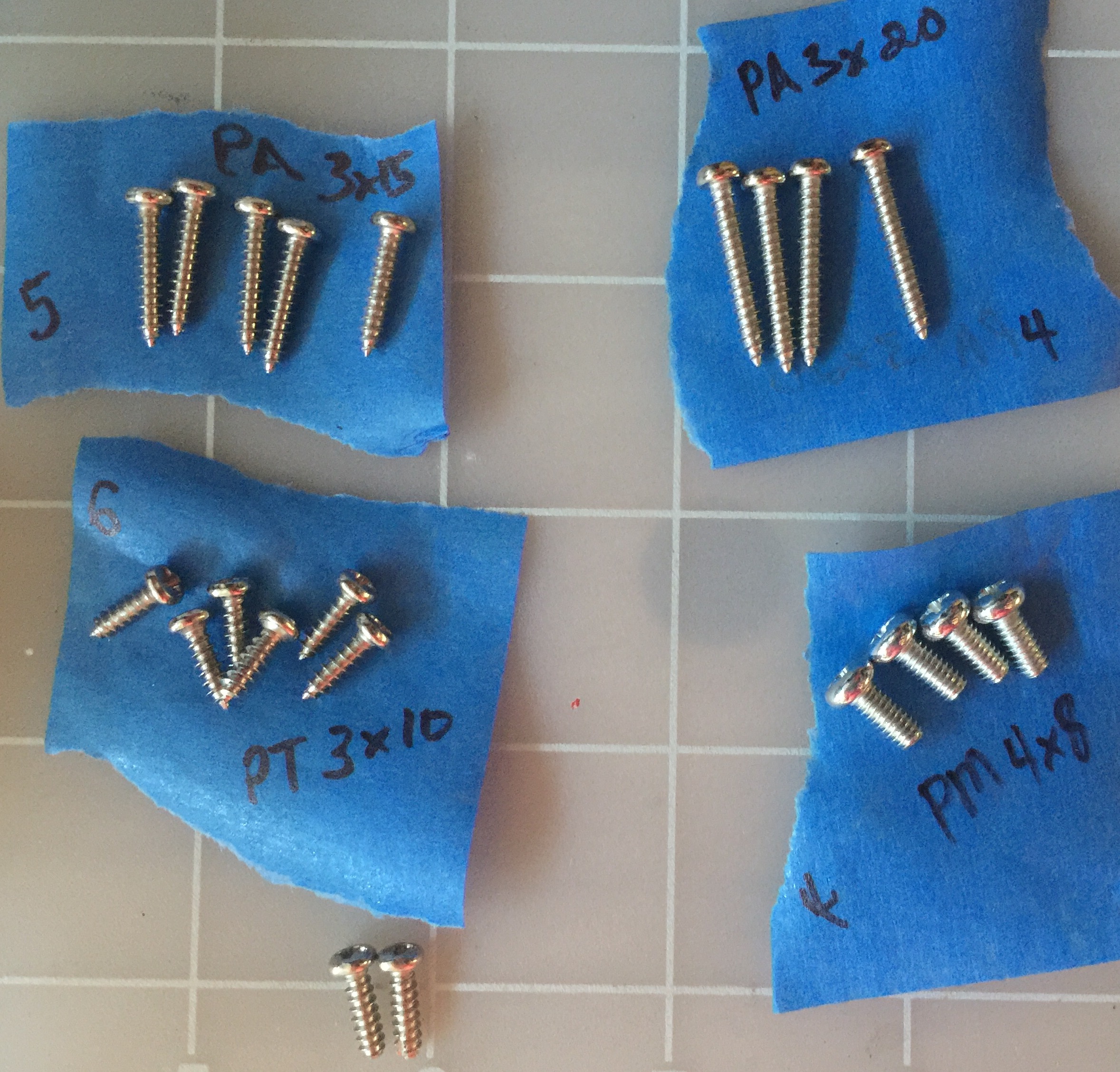

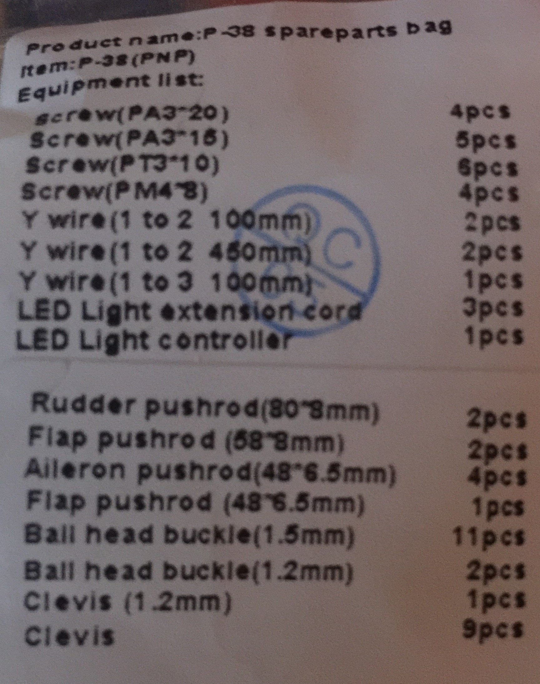

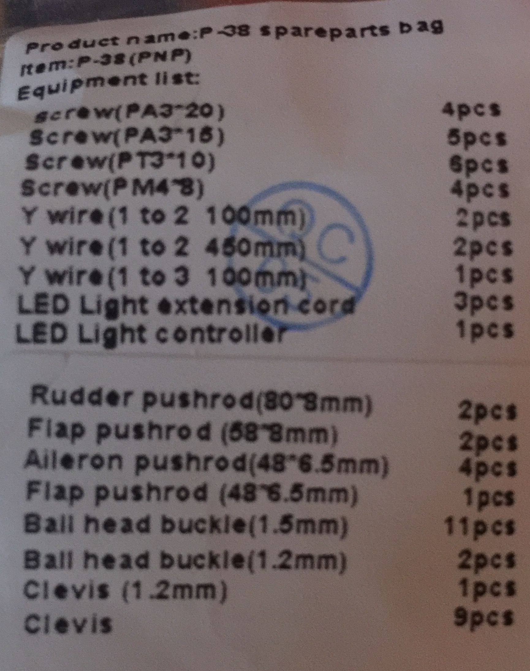

        Hmm, okay, now that I'm on to assembling this plane, the screws in the parts bag and the label stating how many of each it contains versus what the build manual states doesn't add up in the least bit. What's the deal? Ha-ha
        I have attached a picture below of the parts bag and what it says it contains. Mine has most of what it states (although some strange stuff like one of the screws is 2mm short of the rest of the same type of screw, and I have two left over screws that aren't even said to be in the parts bag and are of a different size). Once you folks look at the pics below, can you let me know if this is what you received as well?
        As you can see, I have the following screws:
        -Four PA3x20
        -Five PA3x15 (although one of the five is a PA3x13, go figure)
        -Six PT3x10 (not sure if these are PA or PT, as I don't know the difference between PA or PT, anyone know??)
        -Four PM4x8 (I measured them and they are actually 3x8)
        -Finally, two random screws at the bottom of the pic that I have no idea what they are used for, but I'll see later. These two seem similar sized to the PT3x10 but not pointed at the end.
        Now, what's tripping me up is that the manual and the video say that Eleven PA3x10 screws are needed and Four PA3x20. As you can see in my picture, I only have Six PT3x10 (just as the parts label bag states), but at least I have the four PA3x20. So, anyone know what's going on? Did I just simply not receive enough screws from the manufacturer, or is the manual wrong, or the parts label bag incorrect, etc? From the looks of it, the manual and video are incorrect, as those five 3x15 screws are probably for the center pod section.

          I had the same problem. Just like you, exactly, so I just ordered a complete hardware package from Motion, so I should be covered. Just have to figure out which missing screws that didn't come with the plane I'll need from the hardware package I ordered. Also have a lot of assorted screws about those sizes on hand as well. It almost appears to be that the folks in China created a generic packaging that was flawed and no one noticed. Like I said, my hardware package is exactly as the one you received. Very strange indeed!

            Thanks Bob. I did a search just now on RCgroups and on Hobbysquawk. What I found was that the the manual and video are incorrect. The five 3x15 screws are for the nose pod attachment. So, for the six 3x10's, I used two of the six pointed screws on the inner portion of the elevator attachment, and then the two oddball blunt ended screws in my picture that are 3x10, I used on the outmost portion of the elevator attachment points. So, the left over four 3x10 screw will go to attaching the tailbooms to the center wing section (two 3x10 on each forward portion of the center section) along with their four 3x20 counterparts (two on each side on the aft portion. That should do it and get us going in the right direction. The four PM 4x8's (though they are really 3x8) should attach the two outer wings.
            Hopefully I have that all correct? Someone chime in if I'm wrong, please ;).

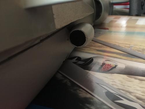

                #2247

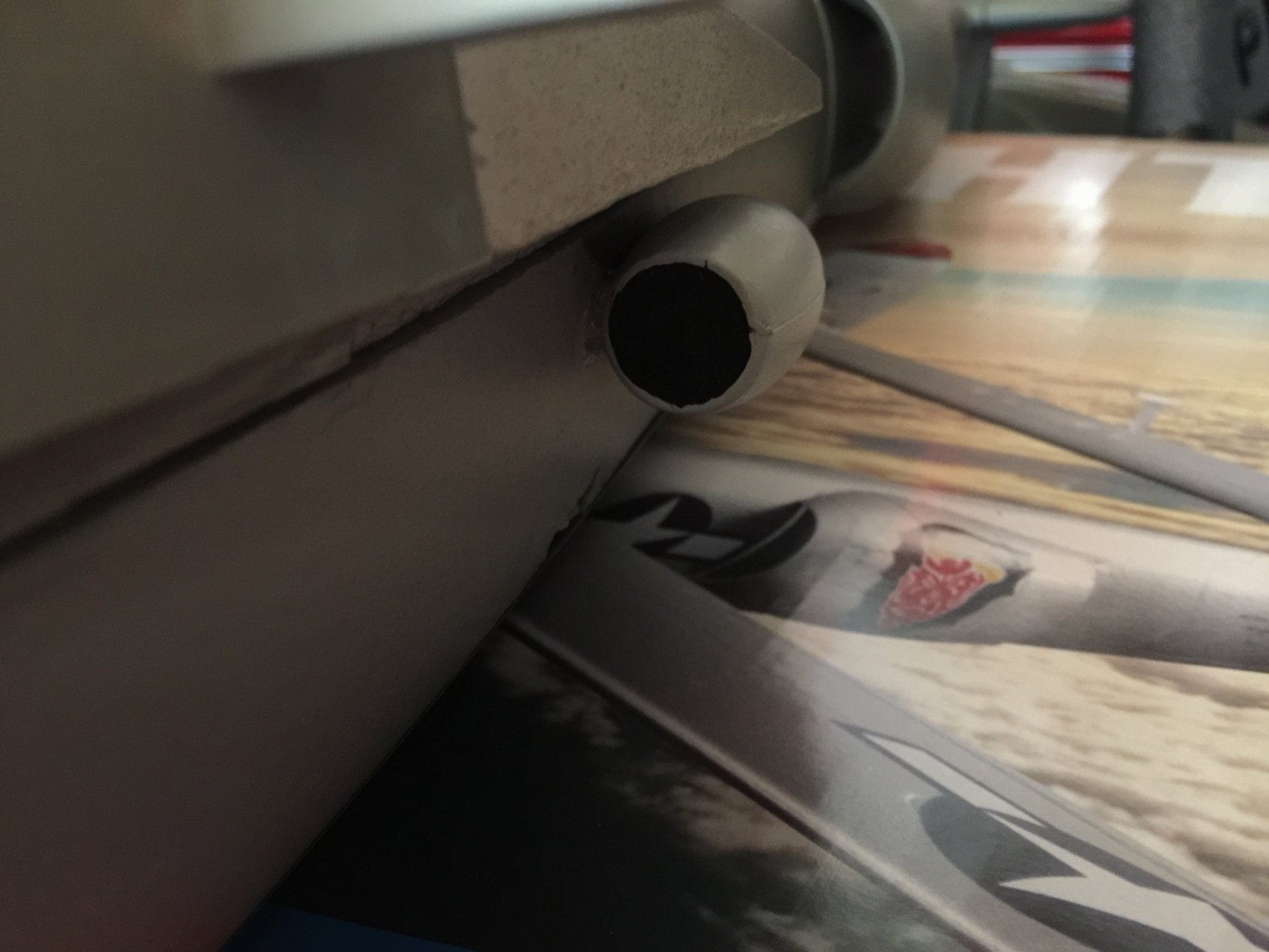

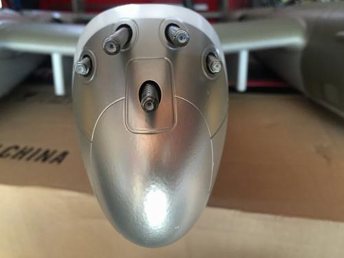

                I took a hobby knife and spun it around the center of each gun barrel carefully and left the white plastic on the inside. I also painted the charger intakes black in the center for some depth, as the all gray color clearly doesn't do the charger intakes any justice :p. Also, what I found cool was that the foam behind the motor cowlings were already painted flat black. Love it!

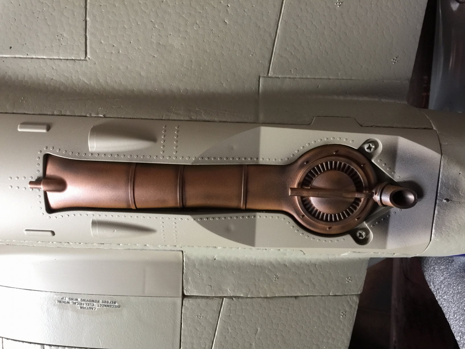

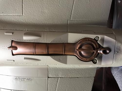

                                          My plane is officially ready for its maiden flight. I'm really looking forward to it.
                                          I did some more small mods today:
                                          1. Added more of the scale decals, primarily the larger ones and too many of the smaller ones I just didn't want to deal with, but may later. After applying the decals I brushed over them with polycrylic and going past the edges of each to ensure a good seal to the paint.
                                          2. Painted the plastic wing tip light covers just around the LED so the plastic part is hidden.
                                          3. Painted the elevator servo's a matched green, as well as the servo keepers to blend them in a bit with the rest of the plane.
                                          4. Airbrushed (with reduced opaque black water based paint) the turbocharger/cover area for a more scale appearance. A couple minutes of work and it really makes a cool and fun difference.
