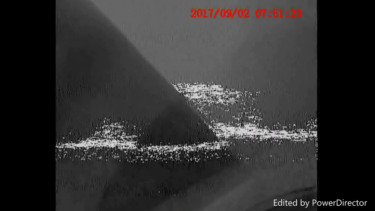

                              I'm planning a simular setup for a carbon z t28 my buddy here is letting go to me. And of course I will do the same frame cutout as I did here. Here's a word about trying to keep the glass closed in front of the camera. It never works well for a clean view. Here's an example...

                                I see what you mean ,does the servo moving create static interference ?
                                Lol.....the first vid. ,I thought it was coming from a flight simulator!...
                                  #3256
                                  No not really, I feel like the main issue with the static was at my Bastrop field we have a high powered wifi system in the building just west of the bus barn, and on my property, the static comes from the high voltage lines that run near my pond I fly from. Also even a little wind can cause small amounts of static in the feeds.
