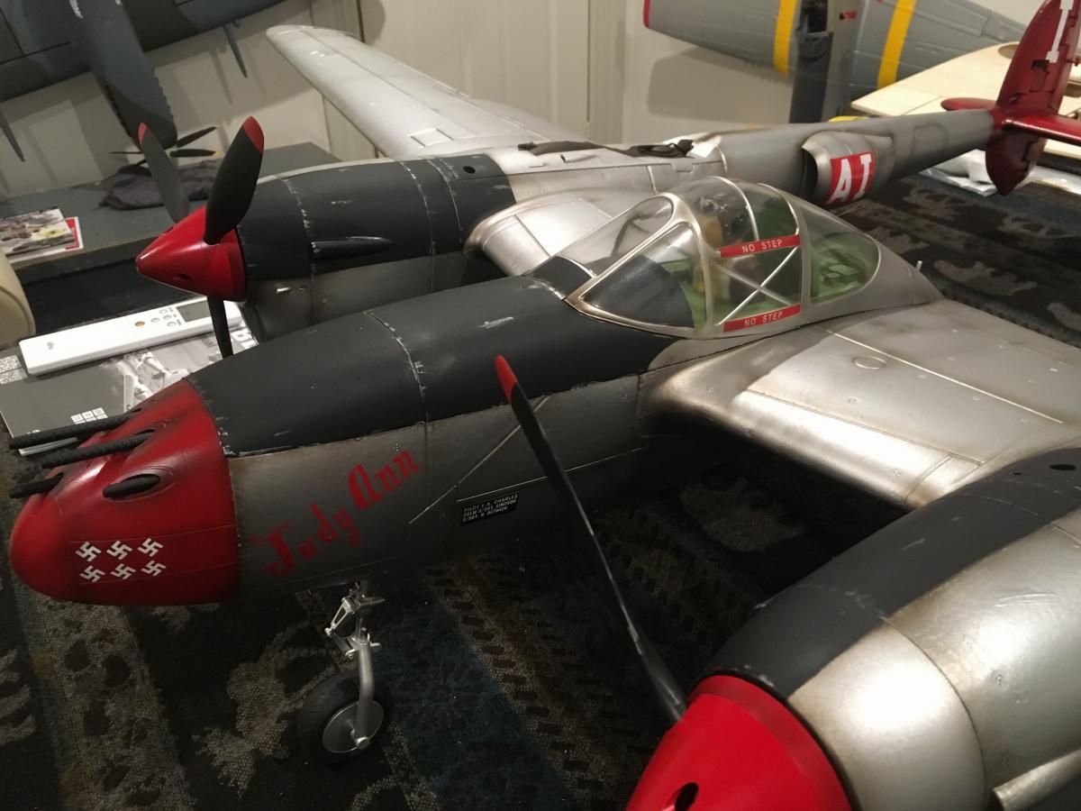

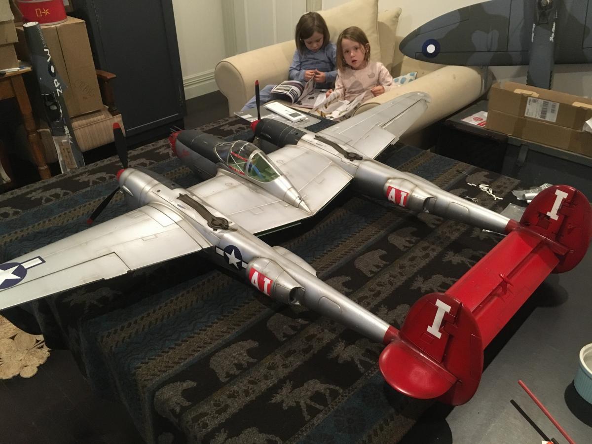

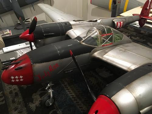

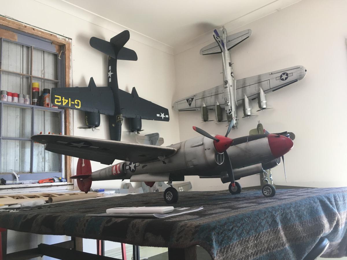

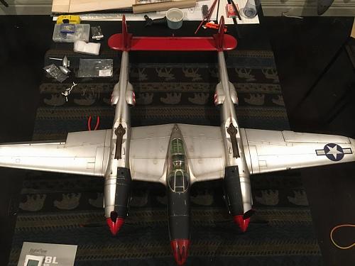

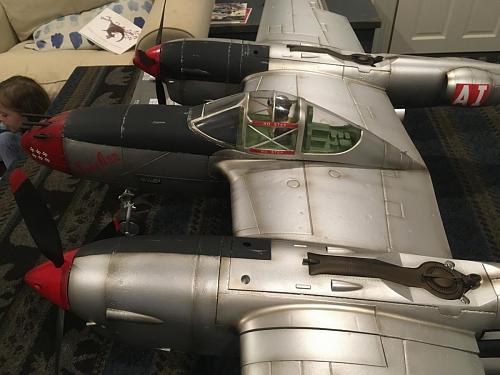

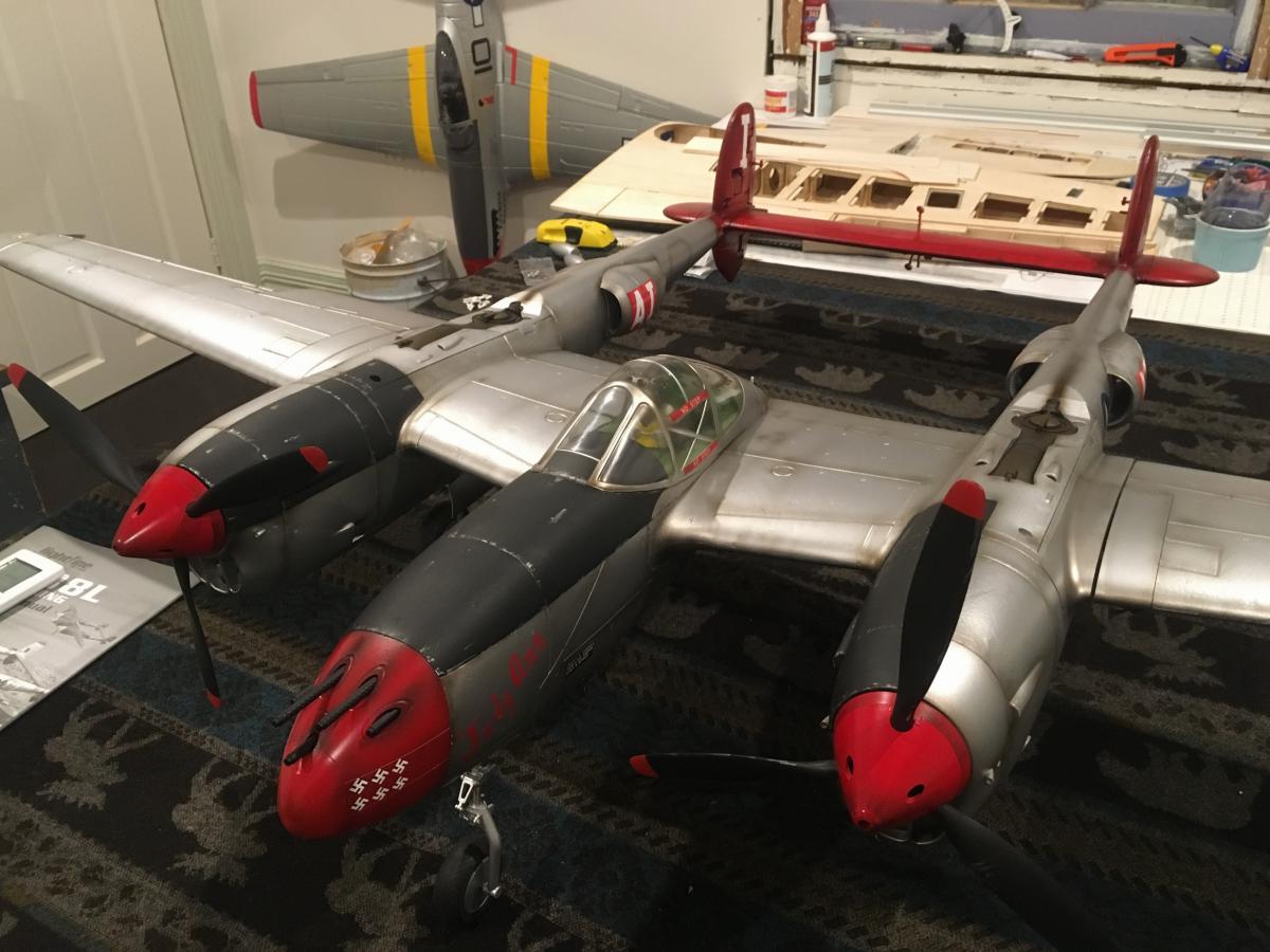

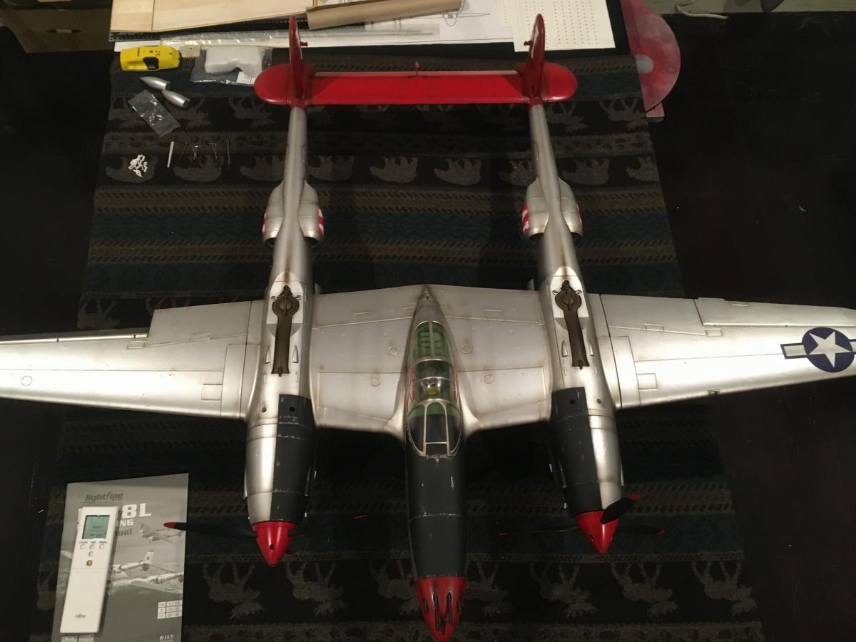

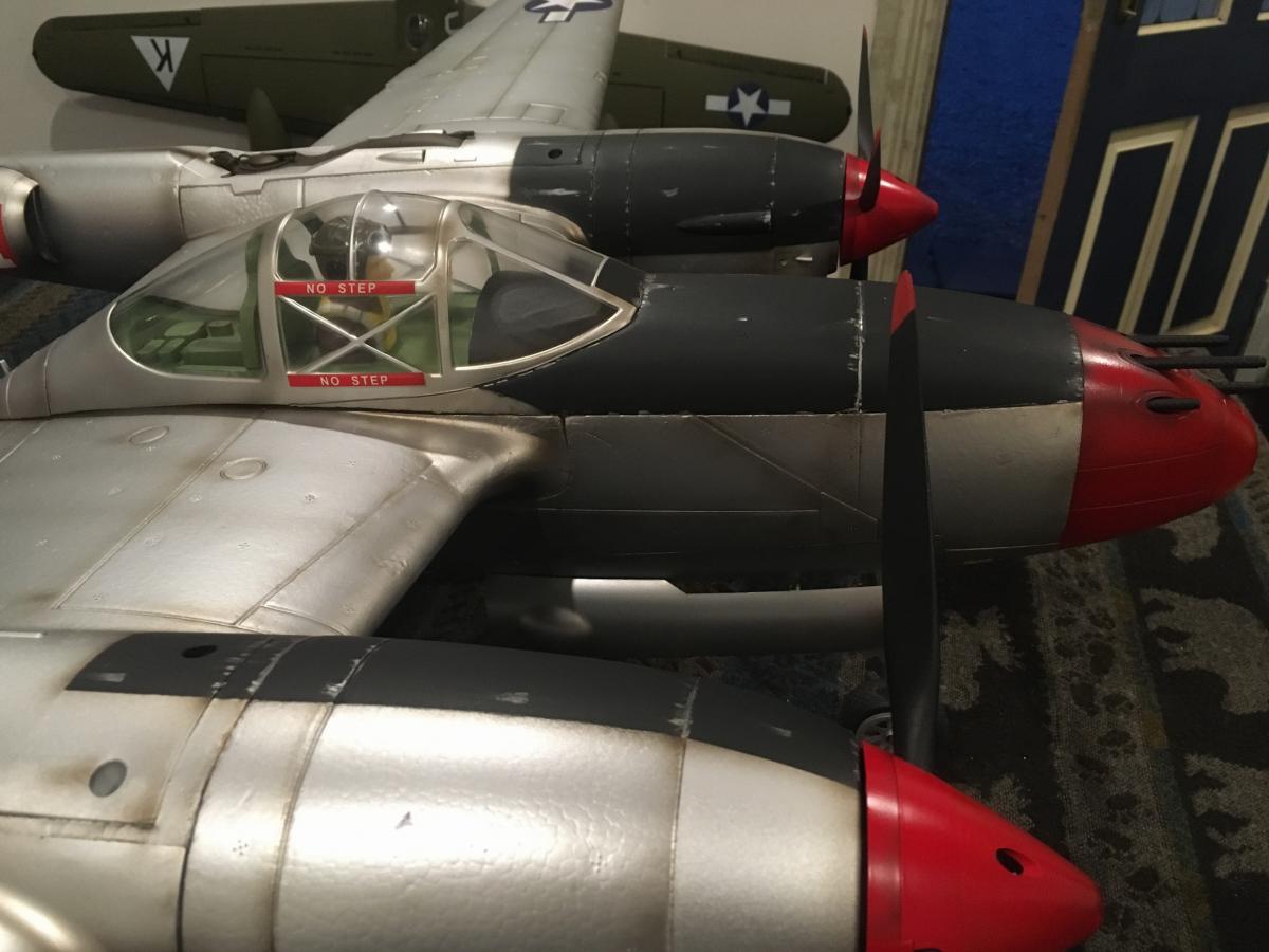

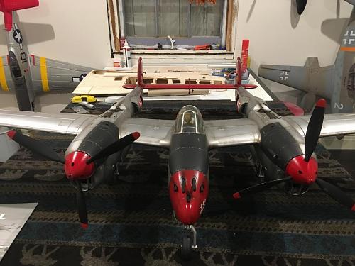

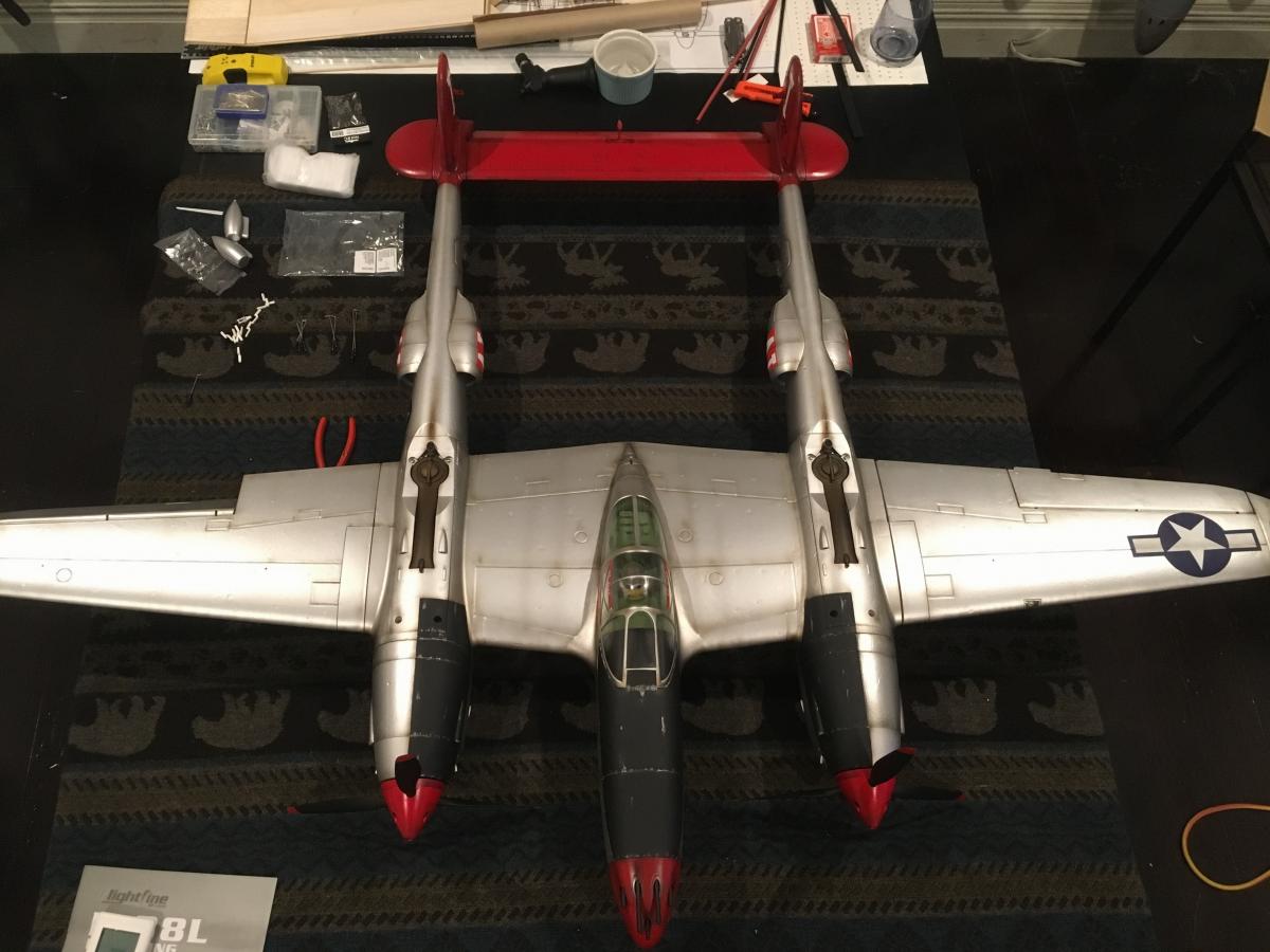

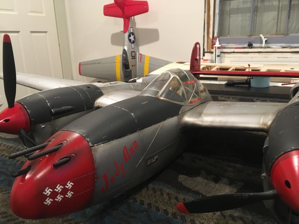

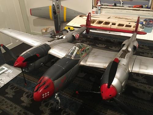

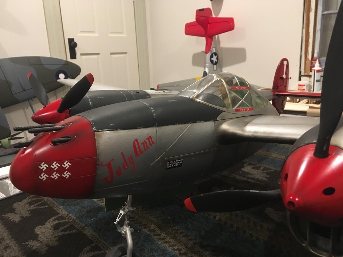

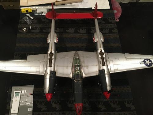

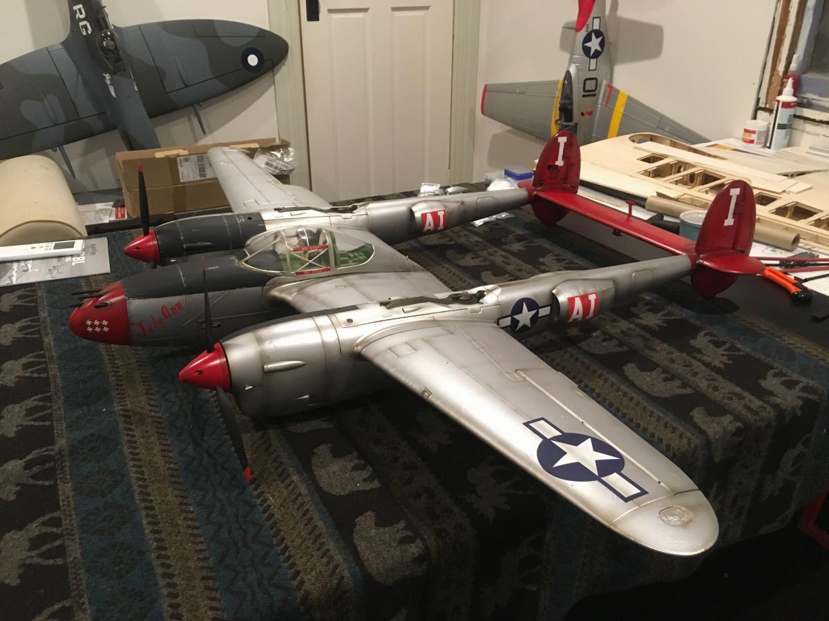

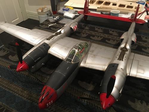

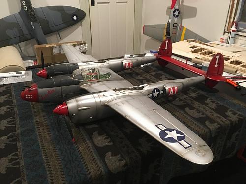

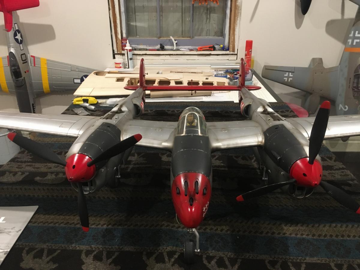

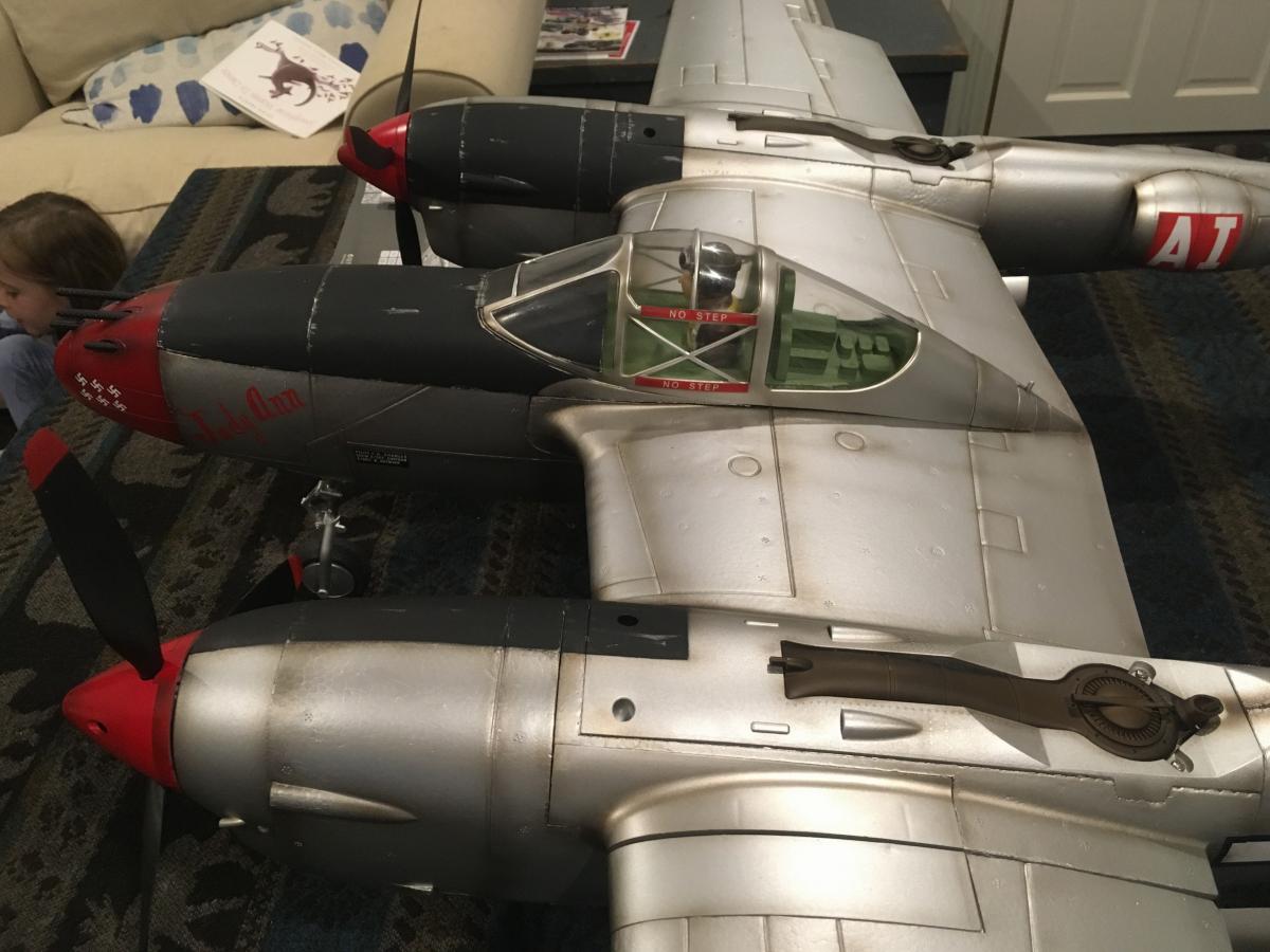

                              • Sadly the worlds biggest tree decided to jump in front of "lil Buckeroo" RIP..... (it's amazing how fast trees can move..lol)
                                I was getting twitchy missing my favourite twin :Sick2:
                                thankfully "Judy Anne" is nearly ready to go.....

                                  • Great job Wes, you will have to do a fly past in memory of little Buckeroo.
                                    a wee bit higher!
                                      • Just wow! :-)
                                        • Beautiful weathering!!
