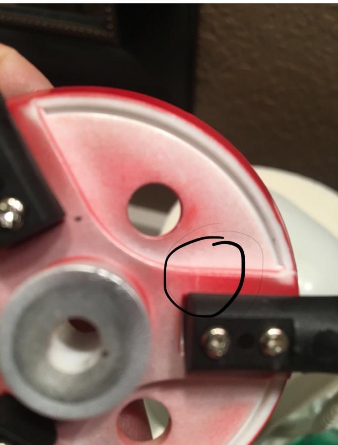

            • I haven't replaces mine in 3 years.
                How many flights in 3 years, as that is the key for the fatigue equation?
                For me...3 years would be over 2,000 flights on the P-38 based on recent experience. The hubs won’t likely stand the stress of 2,000+ flights without cracking.
                I suggest looking closely at the base of each prop in a bright light. The tiny cracks are hard to see.
                After 300 or so flights....begin checking often. Once cracks are found...do not fly any more until replacing the hub. Prop slinging time is close at hand.
                -GG

                • Probably around 1100 give or take a few.
                    That’s VERY good results. No doubt prop balance and flight profile impacts the formation of cracks as well as temperature.
                    My assumption: Lots of full power flying with less than a perfectly balanced prop and cooler weather would be worst case conditions for the initiation of crack formation.
                    Back to my original reason for bringing this up was....cracks happen, so be wary and make it a habit to inspect periodically. ESPECIALLY if you notice any change in the sound as she flies by.
                    -GG

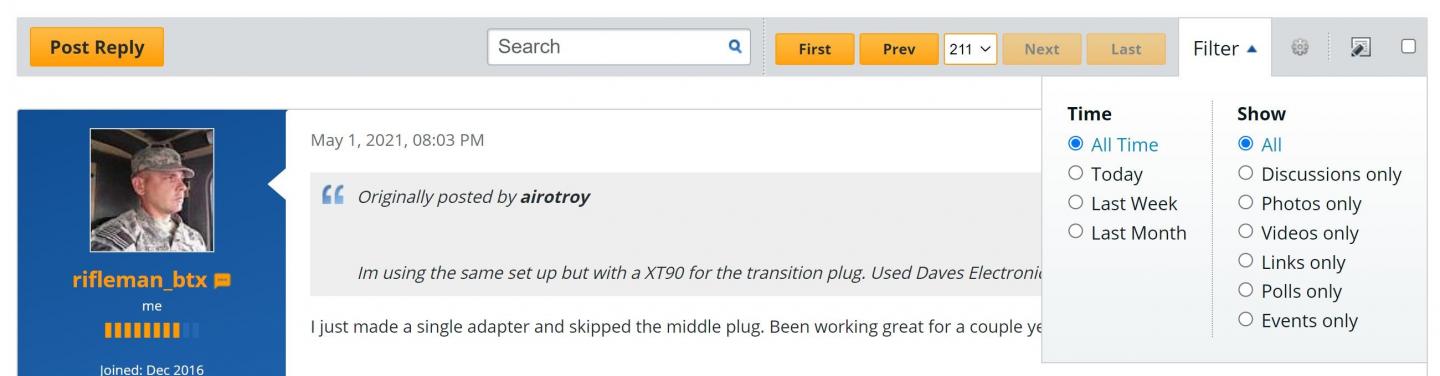

                                    • All
                                      I'm having trouble navigating pages here.
                                      RCG allows you to choose specific pages,
                                      Can't seem to find that option here.
                                      Any help is appreciated.
                                      • Hi marwady, at the top of each thread you will see the ability to search in a thread, select pages by number, or first, previous, next and last. You can also use the drop down filter to select a time frame or show by video, photo, discussion, poll, links or events only.
