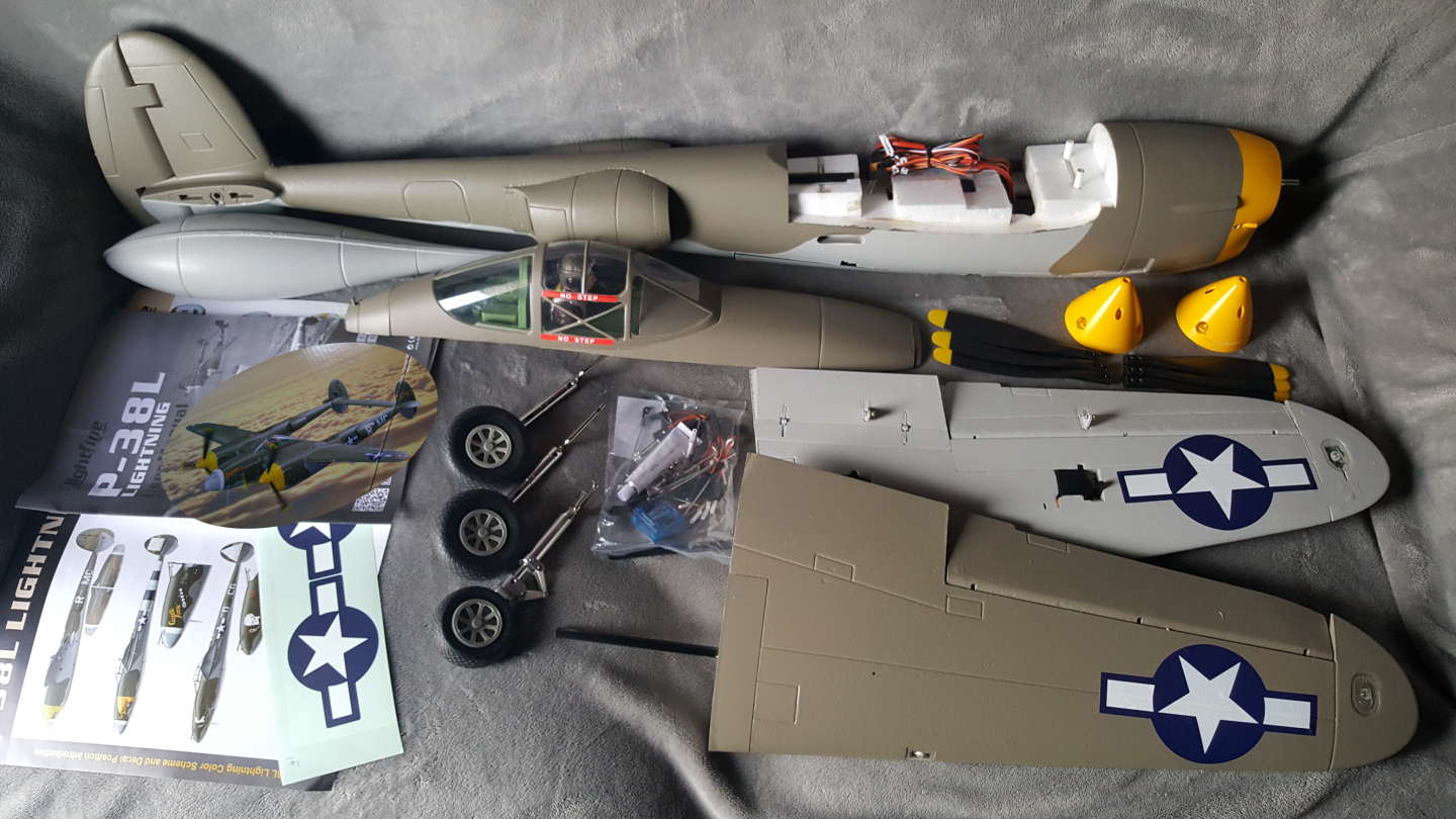

                • Hello, I am a new-comer to ownership of this P-38. I have read through many pages of this forum, but still have a lot to go. A couple of my friends want me to stream my building of this plane. While reading through this wealth of information, it crossed my mind that some of you may be interested in watching me go through the steps of my first RC plane build. I've taken the plane out and put it back in the box several times, lol. I recieved the plane two weeks ago, but I'm waiting for appropriate batteries to arrive before diving in. I'm fairly patient, but this has been testing it for sure!
                  I will be starting the live stream of me building my Flightline P-38L on the 27th of May at 11AM Mountain Standard Time
                  (MST is UTC-6, convert to your time zone here: https://www.timeanddate.com/worldclo...T11&p1=80&p2=0)
                  If you are interested and would like to watch, keep an eye out, as I will post here again shortly before I go live. I will be streaming to Youtube for sure, I will also be Streaming to Twitch ***IF*** I can figure out how to stream to both at once.
