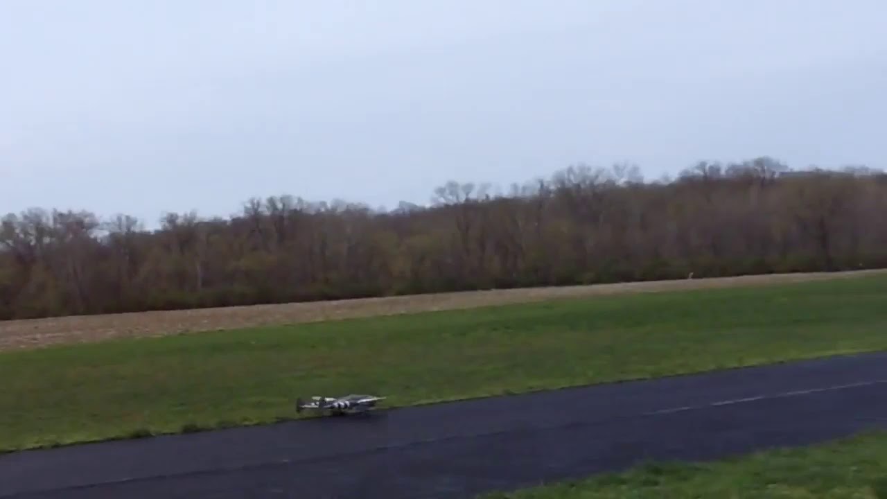

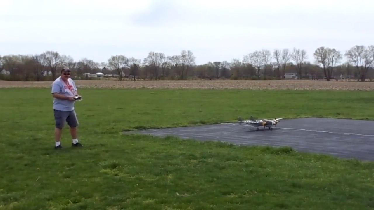

                      • Today I finally got to do the maiden flight on my P-38, WOW.
                        Cannot believe how nice it flys. Did not have to trim anything all was spot on. The sight and sound was amazing. Used a pair of 3500 Admiral Pro
                        -Brad
