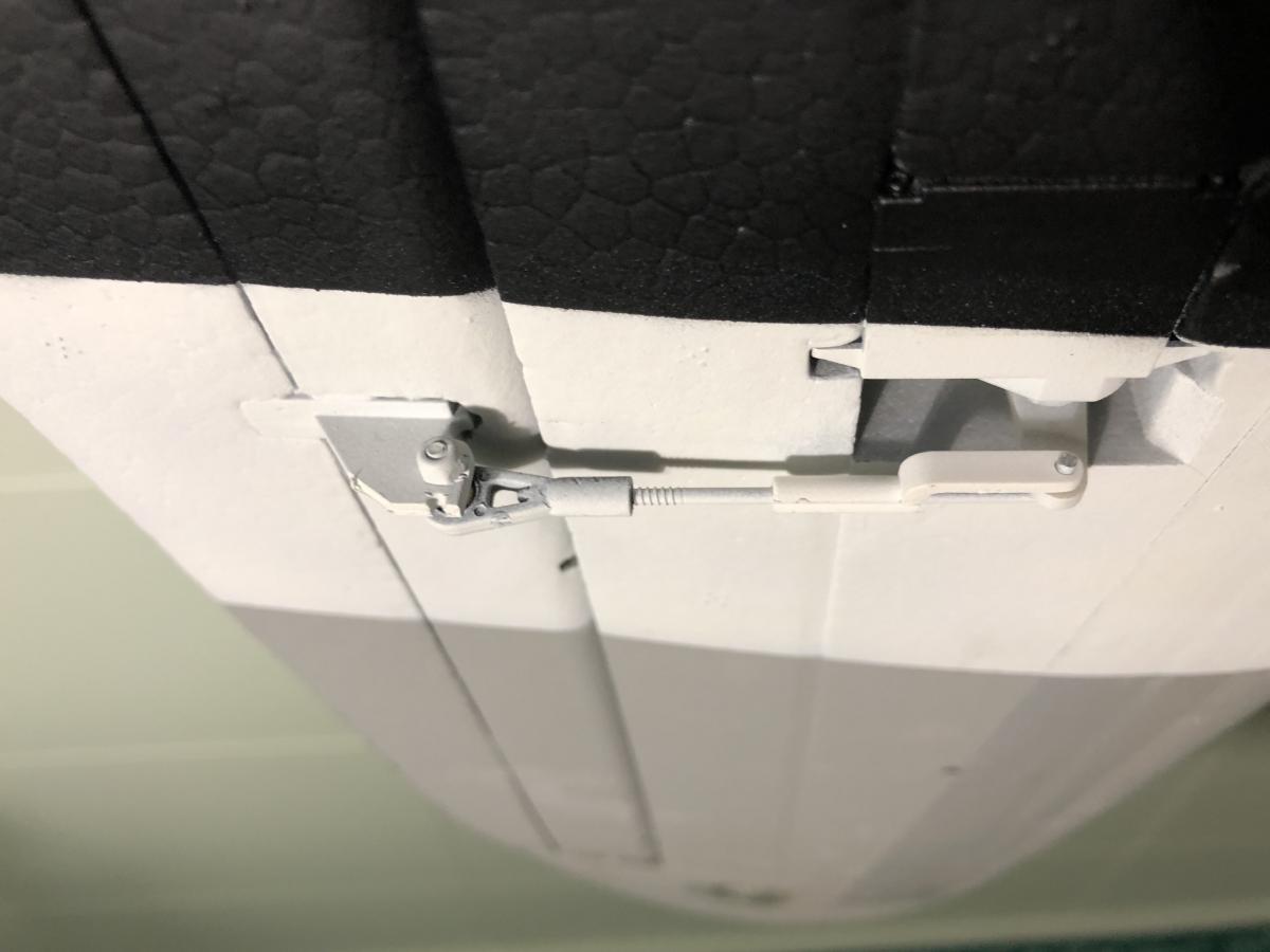

                  Has anyone had a problem with the clevis completely coming off on the flightline P38 Ailerons? and if so, what did you do to fix it? I glued it back and hoping that should be the end of it. It is like a plastic clevis that sits in a recessed plastic mount. Not sure if it snaps in or just slides in there but was worried about it coming off in flight so I glued it.

                            #3854
                            Hi Wallace,
                            I think your referring to the control horn that is attached to the aileron. I’ve never had any issues on the P-38 but have on other foam models. I’d probably just make sure it’s clean and glue it back on with epoxy.
