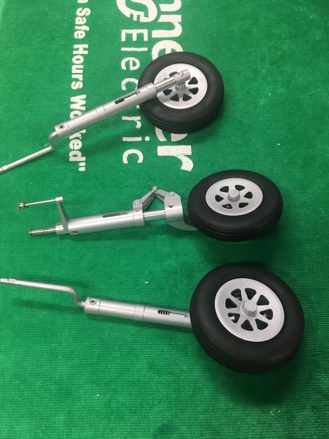

            Hello fellow P-38 pilots. Received my green P-38 two days ago. Unboxed and inspected and began assembly today. I have received the P-38 version where the outer starboard and port wings have a green junction board and then attach with a ribbon cable to the center fuselage. I also purchased the upgraded landing gear struts. I had an issue with the Starboard outer wing attachment ribbon cable. After connecting all ribbon cables and extensions, I discovered that I had no power to the starboard wing; flap, aileron or the two lights on the starboard wing did not work. I troubleshot it down to the green junction board in the starboard wing. Anyone have issues with these green junction boards? I called MotionRC and spoke with Wayne. MotionRC does not stock these green junction boards as of yet, however, he offered me two options: 1. He could take a green junction board off one of their inventoried P-38's or 2. He could send me servo extensions to bypass and eliminate the green junction board. I opted to bypass the green junction board. Great customer support over there at MotionRC HANDS DOWN!!!!
            Suspension Gear upgrade: Has anyone come across an issue after installing the suspension mains that they do not fully collapse leaving the gear doors partially open? Anyone have to cut foam out of the gear bay doors so the mains fully retract? Any help guys would be helpful before I start cutting the main retract bays.
            Thanks, Joe

              #3806
              Joe, the upgrade gear should be a drop-in replacement for the stock gear and should fit perfectly in the gear wells, without any mods.
              Regarding junction boxes... they're all suspect, mostly due to bad solder joints. I've gotten to where I bypass all junction boxes for critical functions, such as ailerons, elevator, and rudder. I'll let gear and gear doors, and flaps, run the junction boxes/sequencers though.

                        #3811
                        Oxotnik, Thanks for the input and I will by pass the green junction boards. As for the drop in suspension mains, mine are not sitting well in the gear bay on both Port and Starboard gear wells. They are hanging up on the elbow of the strut in the gear bay. I verified that they are installed correctly via MotionRC's upgrade strut video. I'll figure it out. I hope!!! LOL!!!

                                      #3818
                                      Loosened the strut on the mains and pulled them out about a 1/4 inch then re-tightened screws on the flat spots. Mains now retract all the way in the retract bay. I'm hoping MotionRC will have a resolve on the green junction board issue Monday.
