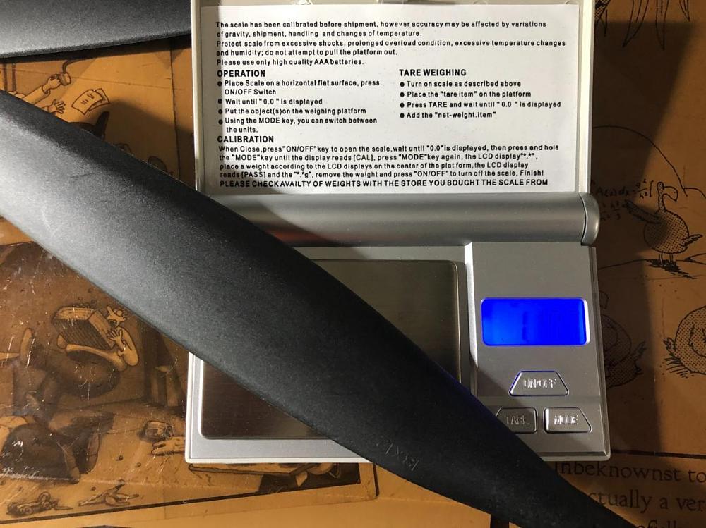

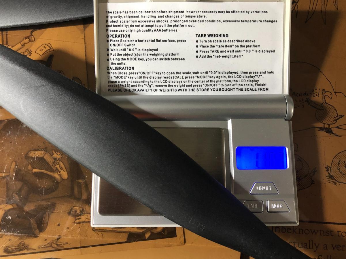

    I never flew mine on the stock 3 blades. I installed the upgraded motors n props in the initial build. It is without a doubt the fastest FlightLine warbird I own. When I feel the need for speed, it’s the bird I fly, much more like flying an EDF than a warbird as the two blade props do not slow it down when throttle is reduced. I also have a long narrow aging paved runway, about 10 foot across by 250 foot long. Landings routinely eat up 150 foot on the roll out.
    On all my FL three blade props, before the unit is assembled, each blade is first cleaned of flash around the edges, then each is weighed on a jeweler scale. All blades are then sanded to lighten them to match the lightest blade. That way the rotating mass of the unit is a match. I then assemble it and use it as is and this has never caused any issues. All my FL warbird props are finished that way, 2 Spitfires, Tigercat, and the massive 18 inch F4U-1 Birdcage prop. No vibration on any of them, smooth as silk. I’ve always followed APC’s recommendations in balancing electric props.
    Balancing Propellers
    A significant amount of effort is put into making sure that all APC propellers are as close to being perfectly balanced as possible before they are shipped. Therefore, it is unlikely that a balance correction will be required. The following procedure should be used to check the balance of a propeller.
    We recommend that the drilled hole not be used for checking balance since it is sometimes not as straight as it should be. Instead the user should check the balance of all APC propellers using the precision molded hole at the back side of the hub (see illustration below). The tapered part of the balance cone should be used on this side. A pin that is smaller than the through hole should be used to prevent any interference with the drilled hole. Finally, a washer (or the flat end of the balance cone) should be used to secure the propeller at the forward face of the hub. Similarly to the way it mounts to the motor.
    If your propeller requires a balance correction, we recommend that material be removed from the upper and lower surfaces at the tip of the heavy blade. A piece of clear tape can also be added to the light blade, recommended for electric applications only. Click image for larger version

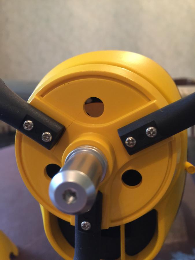

                                  Just discovered this during a routine post flight inspection!
                                  There hadn’t been any prop strike or damage to the prop blade, and the whole assembly had been balanced.

                                    A crack like that can develop if the screws were tightened just a bit too much or if Loctite was use. Although the whole assembly may have been balanced, was each blade weighed and equalized? Was the assembly without the blades balanced? A complete assembly, with blades may be balanced but if one of the blades were a bit heavier or lighter than the other two, there can still be a harmonic developing.

                                      Not guilty as far as the Loctite is concerned, and the crack didn’t originate from, or even go near, any of the screw holes, but I did only balance the whole prop assembly as one item on a prop balancer, so that might be it.
                                      Very relieved that I caught this issue before the prop broke up in flight, this is one of my favourite planes.
                                      Thinking back to yesterday’s flights, I heard a slight but noticeable buzzing noise during a couple of low passes that that I don’t remember hearing before, I think that might have been a clue that all was not well.
