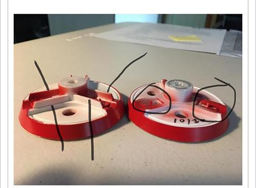

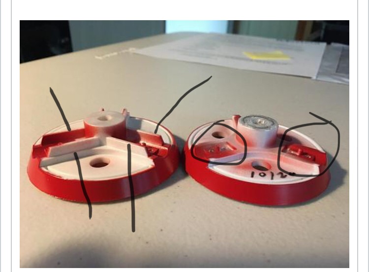

            But….it is a VERY good idea to begin using the “new” reinforced hubs. I used to find hub cracks about 3 months of use (lots of flying). The new versions are much more stress tolerant.
            Differences shown in the photo below.

                6) Install the upgraded “newest” prop hubs. These have reinforcement channels. See my prior post #4285 above with photos comparing the old and new hubs. The old hubs develop cracks over time, and you will sling a prop (instant death roll-over).
