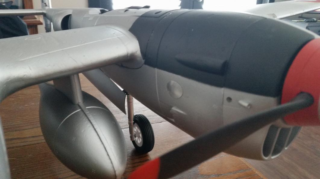

                                  • Alpha, Am happy that you never had problems with your retracts. My experience has been a bit different. Long story short, I have installed the sprung Oleo Upgrade, but also replaced the stock retracts with e-flite 25-46 Tricycle set after multiple failures of the stock gear. Took a bit of surgery for the nose gear, but the model design made it easier than I expected
                                    Gear door sequencing now has me at a loss. When the gear is extended, the doors close on the struts and then won't close when the gear is retracted. Somehow the sequencing is out of synch. I tried unplugging the gear and LG doors in various sequences, battery on/battery off...reversed servos, etc. but cant get them back into sequence with the stock electronic mixer. I have just added an aftermarket Turnigy Gear and Door sequencer with the same results.
                                    I am hoping this is a simple fix but haven't come upon the correct procedure to put the sequencing back to normal. Any suggestions? Perhaps a new "little blue box"? PS: Just ordered one, just in case.
                                    I am extremely happy with the model, with exception of the inop retracts. BTW, Motion RC has already replaced one unit very quickly.... great customer service. I called later regarding the sequencing problem and the rep couldn't help me.
                                    Would certainly appreciate some guidance regarding gear and gear door sequencing.

                                      Hello Kato and welcome to the Squawk,
                                      You may not get a response from Alpha for a while because he's been rather busy over in China but there are a lot of folks on here that are knowledgeable of many things. ;)
                                      I suspect the culprit is the e-flite retracts internal controller board being 180 out from FL/Freewing type retracts.
                                      SImple check.....hook the FliteLine's back to the gear sequencer control board and I'll bet the doors will work properly.
                                      If that is the problem and your set on using the E-flites then a servo reverser to the door servo's controller will be required.
                                      PS...the reason for my suspicion is I mixed FW nose retract with FMS main retracts on a VQ P-39 project and I had to add a reverser to the FW retract to get them to operate together
                                      • Thx, OV10, will give that a shot. Awaiting Fedex and USPS for my Turnigy servo signal reverser to dig into your proposed "Fix". Appreciate the tip, will let you know how this turns out.

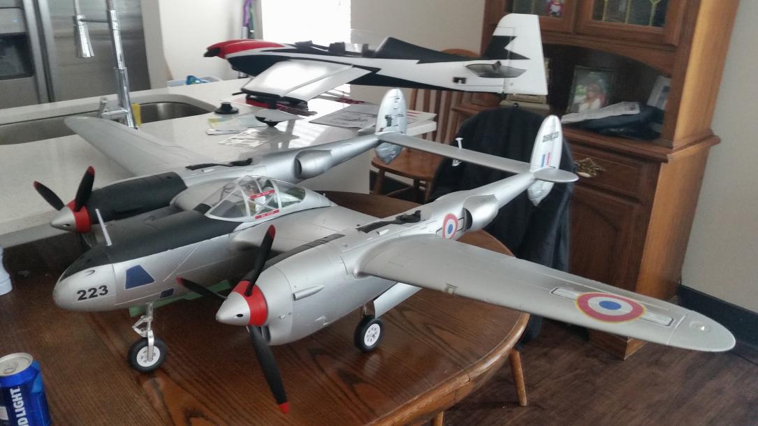

                                        Pics below show her as an F-5B (photo recon) in French AF livery, serial #268223, flown by Antoine de Saint-Exupéry, the day he went missing, 31 July 1944, off the coast of Marseilles. Nacelle mirror borrowed from bottom of a Red Bull can, coated w/ clear nail polish.
                                        Last edited by Kato742; Jul 13, 2017, 04:47 PM. Reason: follow-on response with photos
                                          WOOOOHOOOO, OV10 ! Thanks for the tips. Solution was a new gear/gear door sequencer AND signal reverser from Turnigy. After a few initial disappointments, I finally bit the bullet and did a flow analysis sheet on the Boolian logic (something I had not done in 30+ years). Sequencer plugged into the Motion "blue box" with the signal reverser on the GEAR servo lines instead of the DOOR lines. Success is sweet, bittersweet because it's pissing down rain here in Nashville at the moment.
                                          Saint-Exupéry will be back in the air as soon as the ducks quit drowning.
