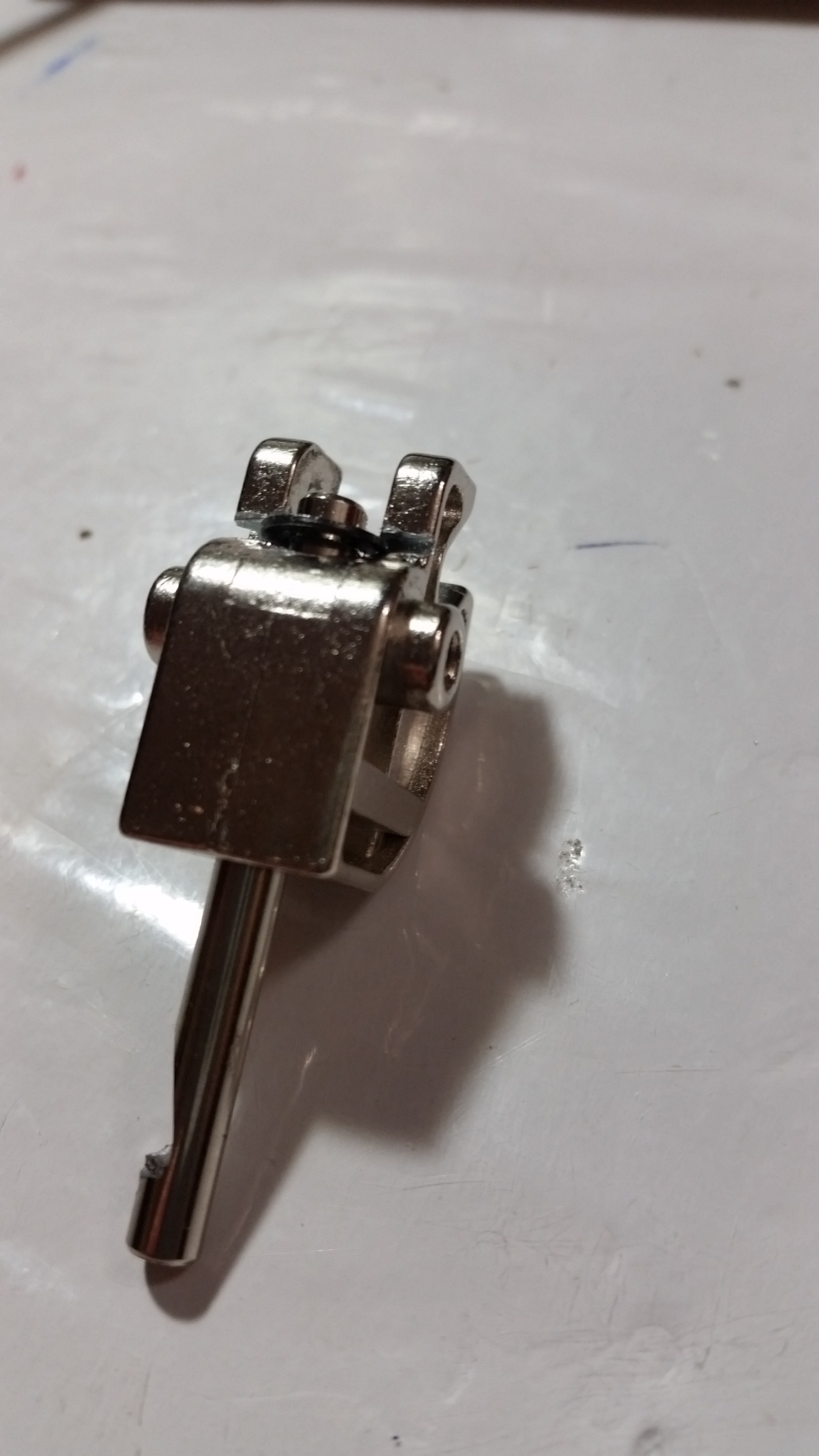

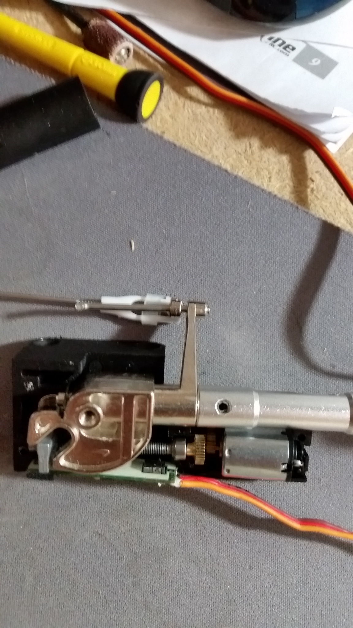

                              • Trying to get that c-ring out of the stock nose strut is definitely a challenge. With my old eyes, I can't see anywhere to get the smallest flat head screw driver into a slot to pop it off. I don't foresee a need for it anyway, as the new Castle strut has it's own C-ring, so I'm considering cutting it with my dremel.

                                • Originally posted by BadBob View Post
                                  Hold on! Before you cut that C-clip off, wait till you try to put the Castle unit in. You may find that the C-clip on the Castle unit is too big to fit inside the stock retract piece. Until you decide what to do, you might not want to destroy something that you might need later. I gave up on the Castle unit and cut off the top section of the stock strut. I needed the old C-clip.
                                    My 1/16" socket screw driver works for me. Also, I notice that the Castle gear main axles will not insert completely into the strut with the stock tires on. The width of the tire rim is 20.14mm and the length of the axle where the tire will fit up to the strut is 17.96mm. I haven't gotten to the nose yet to see if that's the same issue there as well.
                                    I'm using the FMS P-51 tires but same problem here. 1. I dremelled off a bit of the lip around the axle hole so that part is flush. 2. I dremelled a new angled flat spot on the axle that goes into the strut so the hex screw would have something to bite on.
                                      AAHH, to late! By the time I did get it off, there wasn't anything left to keep. I ground a slot on the retract whoswasit down where the c-clip should be so it can still spin freely and then sna pping it back on there. Seems to work fine.
                                        [ATTACH=CONFIG]n48474[/ATTACH] [ATTACH=CONFIG]n48475[/ATTACH]
                                        I sincerely hope that won't weaken that piece. The front retract can sometimes hit pretty hard. That part on another of my planes cracked and broke off on a rough landing (and it was completely intact to begin with).
                                        • Originally posted by xviper2 View Post
                                          Yeh, I thought about that. Hope that doesn't happen. I thought about dabbing a bit of Vaseline around the c-clip and the gear wire just to make sure I still have enough spin play for the c-clip and applying a bit of JB Weld in the slots I cut. Just a bit of reapplied reinforcement I hope. I'll give a thorough stress test before I put in.
                                          I'm just wondering about all the others that have replaced the retracts with the Castle or otherwise and haven't weighed in on this. If they're not having any issues with installation, I would love to know why. Are we the only and hopeful ground breakers? LOL.
