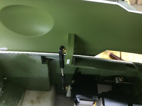

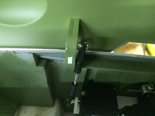

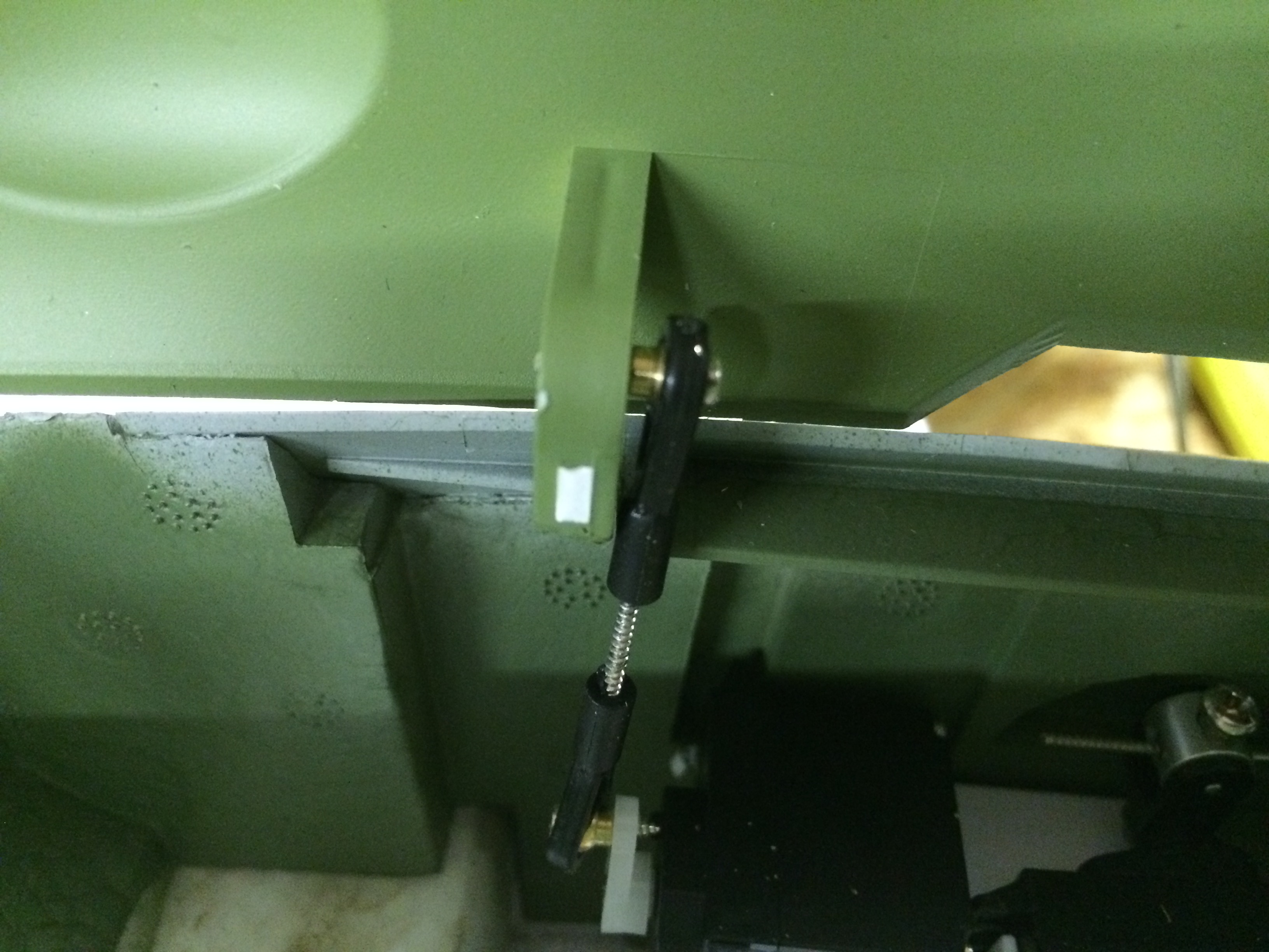

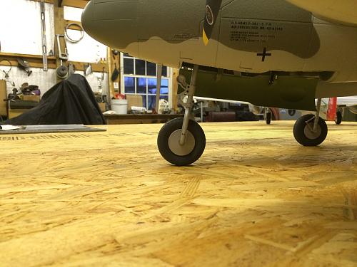

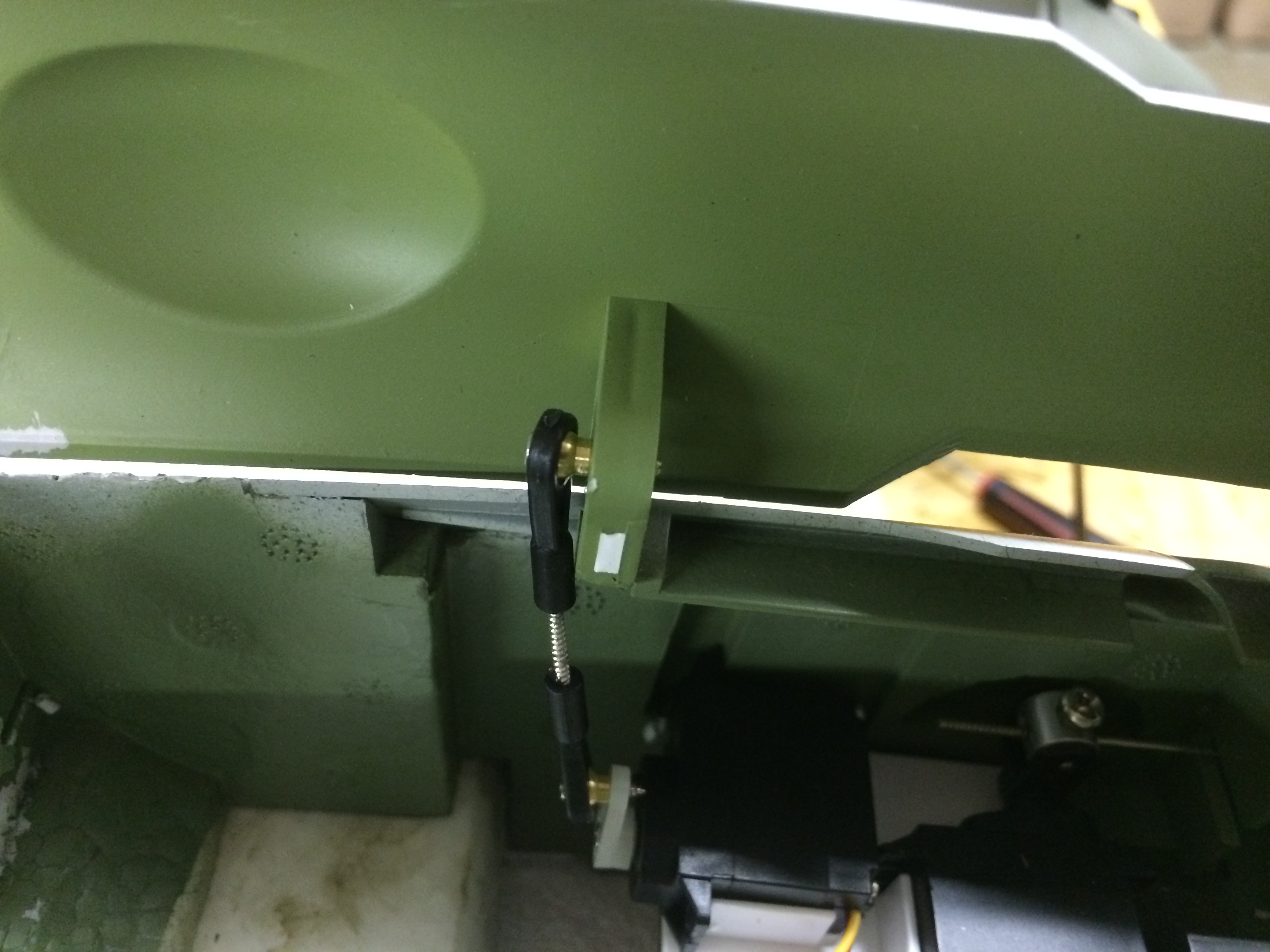

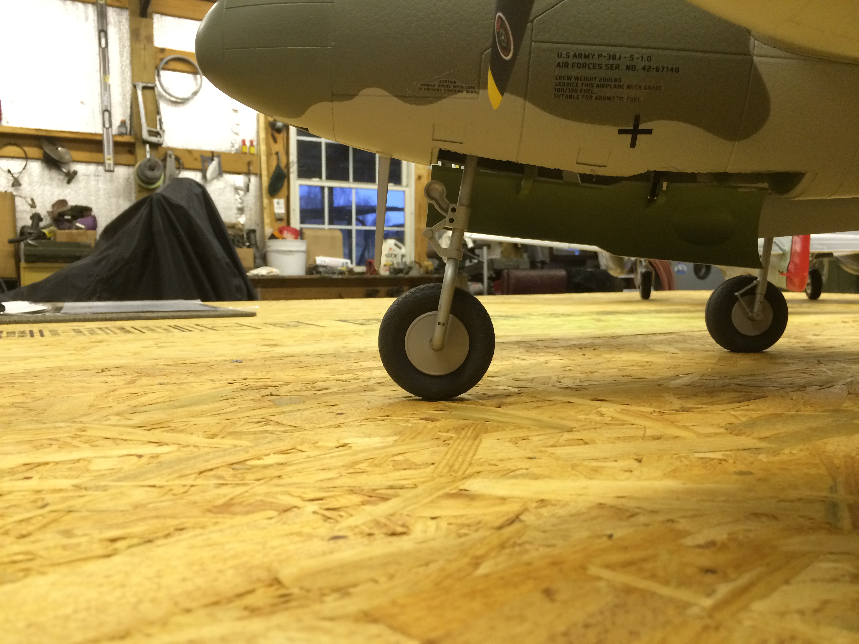

    I started some detail work of my own this evening. Used washers to gain close to scale raking in the nose and main struts...Looks much better! The nose is 105 degrees like the full scale but the nose gear door won't close as the wheel is now in the way. It strains the servo so I have two choices to make. Either keep the nice scale look of the forward 105 degree rake in the nose strut - which would mean cutting out a rectangular section in the door so it will close all the way - or go back to a less-than-scale rake and save the door.
    I am leaning towards cutting the door. I know it's not scale but you don't even notice unless you flip her upside down. Photos below. Let me know your opinions if you don't mind.
    I found a solution for this, if you move the door pull rod to the other side of the mounting tab it will allow the door to shut.
    Stock position.
    New position.

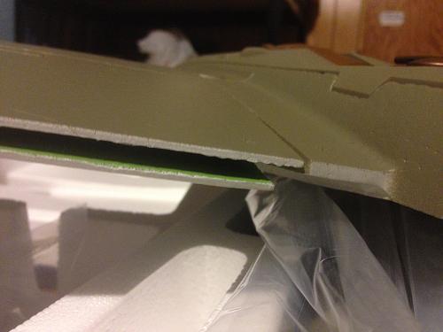

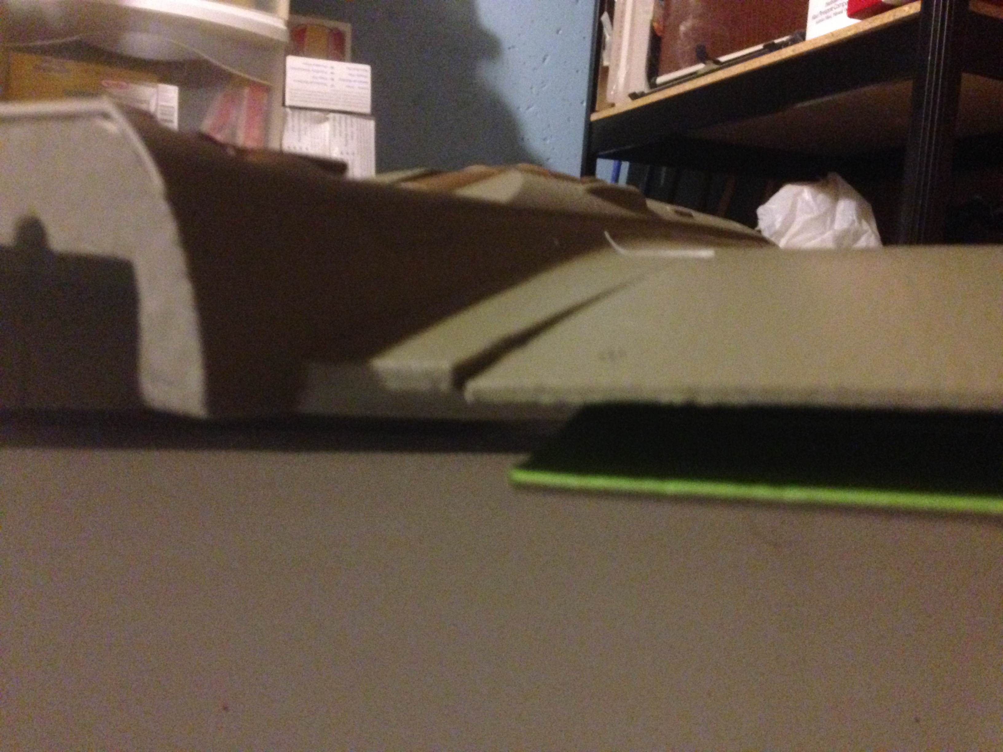

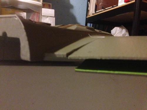

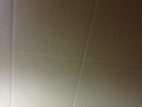

                    Misaligned Trailing Edge Solved:
                    I had let my plane set for 24 hrs with a shim under the middle of the outer flap of the trailing edge that was misaligned. I used the foam parts that protected the wing in the shipping box to support the sagging wing panel. This morning it looks like the EPO took a set and the misalignment is gone. I hope to fly again after work as the weather this afternoon is supposed to be perfect (62 deg, sunny, 4 mph wind).

                            Just did the forward rake mod on the nose gear. Relocating the gear door ball link to the other side of the mount worked great. Thanks for the tip TiredIron!

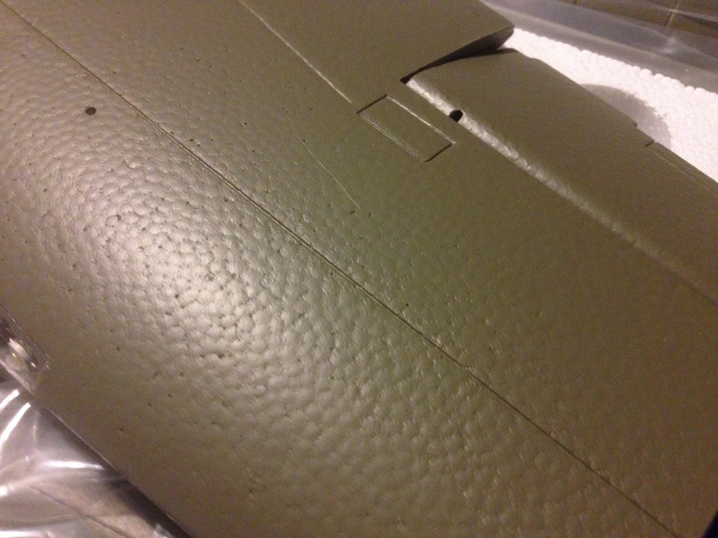

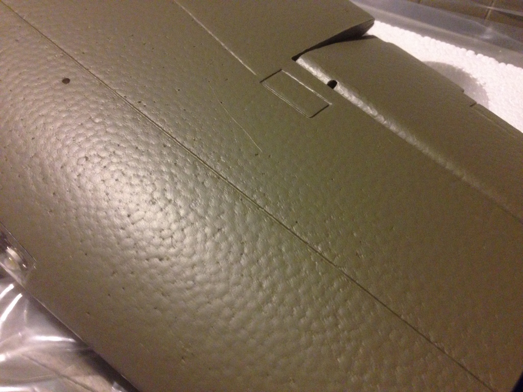

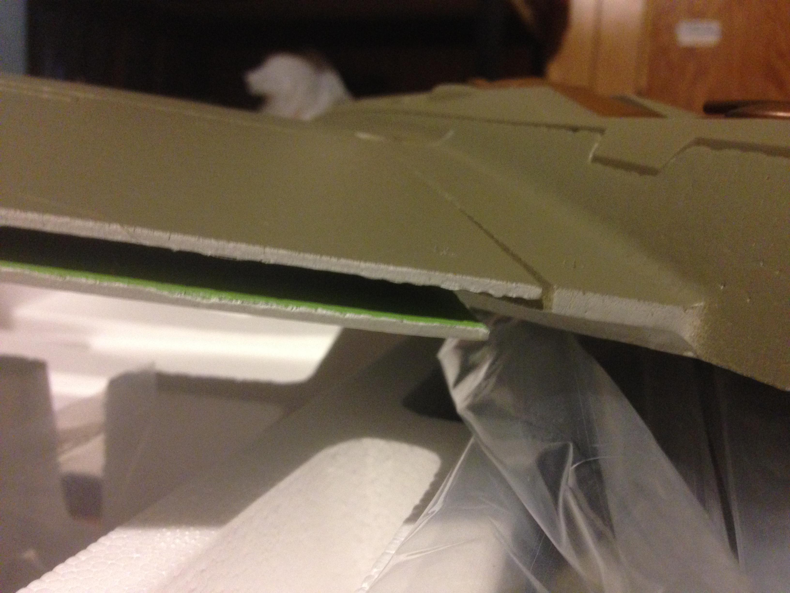

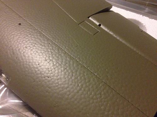

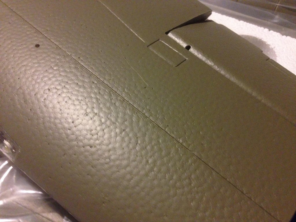

                                          Mine finally arrived about an hour ago. My excitement was quickly dampened when the UPS guy handed me a bill for another $78.00CAN. Even the delivery guy was noticeably embarrassed. Having already paid UPS shipping of $78.49US at the time of order, needless to say, this additional amount was a bit of a turn off. This is by no means any negative feedback on MotionRC, just the reality of buying cross-border. (For other Canadian customers ............ note that the original purchase price of $349.00US + shipping amounted to a converted total of $618.31CAN, bringing this plane to a final cost of $696.49CAN. Just as an experiment and for comparison, I also purchased a Freewing 90mm "high speed" F-16 from RC Castle, which should arrive sometime tomorrow. That one is coming by air parcel post. OK, I won't dwell on this any further as I'll start a new thread after I get the F-16 as a comparison of the brokerage and miscellaneous fees for the 2 planes.)
                                          Just managed to find some time to unwrap the main center wing section and the 2 outer wings and took some pictures. As you'll see in the pics, this so-called "alligator skin" is present on mine as well, however for me, this is not a big deal as I am more interested in how it flies and looks in the air. Nevertheless, I took an even closer picture of my Durafly P-40 for you to see the difference. As for the trailing edge of where the wing flaps meet up with the main wing section, on one side it was quite even but on the other side, there was a noticeable "step". Again, this doesn't mean much to me so long as it flies well and from all accounts, this slight misalignment doesn't affect flight characteristics much.
                                          I'll get to the build slowly in the next few days. I'm not nearly in as much rush or excitement as some of you fellas. The UPS guy took care of much of that.
                                          P-38 wing:
Name:	wing (1024x768).jpg
                                          Durafly P-40 wing:
                                          Left side "step":
                                          Right side "step":
