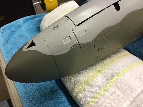

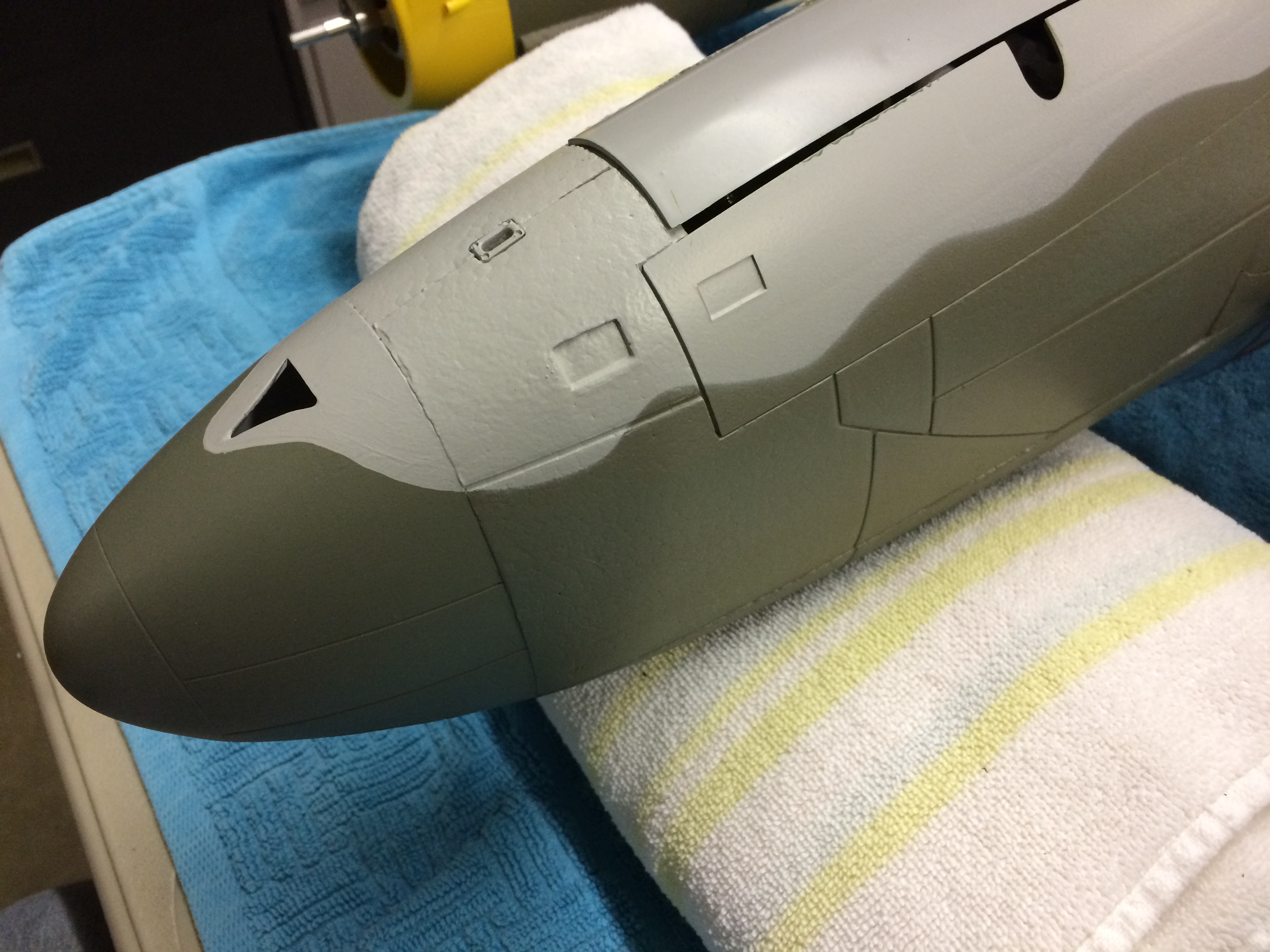

                                • Been doing a little detailing waiting on my HotRod pinstriping guy to come do my nose art...
                                  Painted the nose, haven't decided what to do with the spinners and cowl.

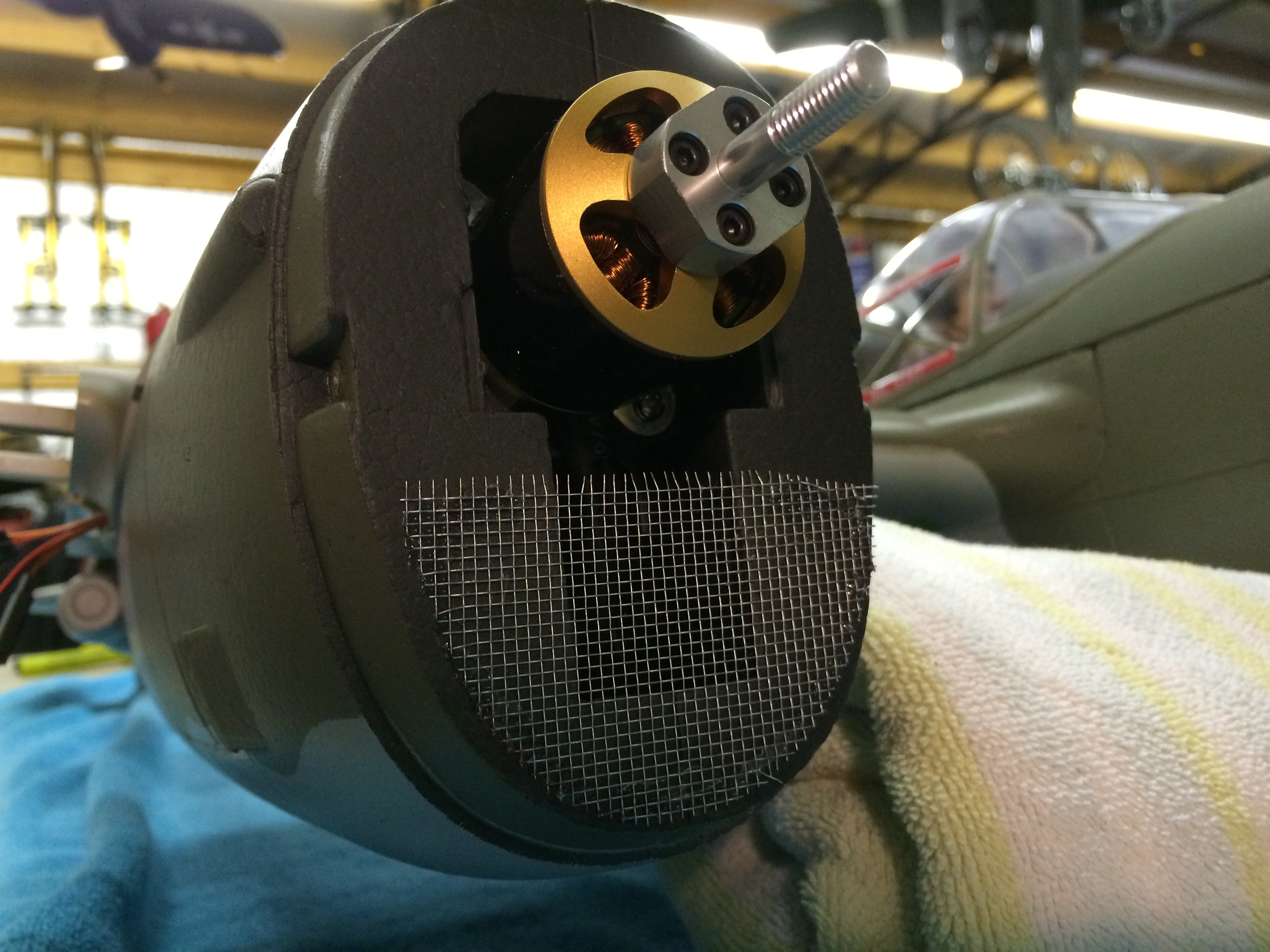

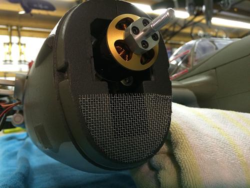

                                  Cut some aluminum screen for the cowls, will probably do some for the rear air intakes as well.

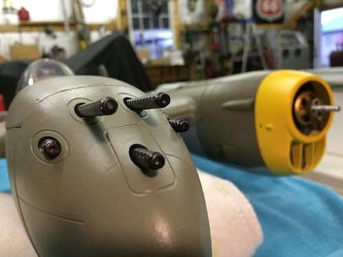

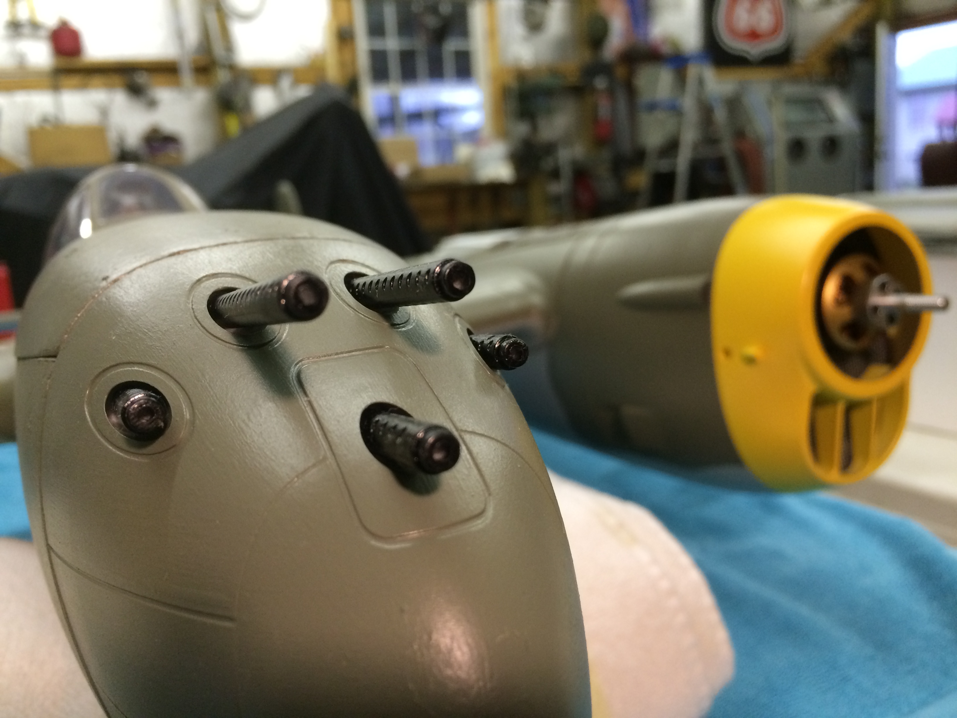

                                  Like most kits the guns come with solid ends so I drilled them out.

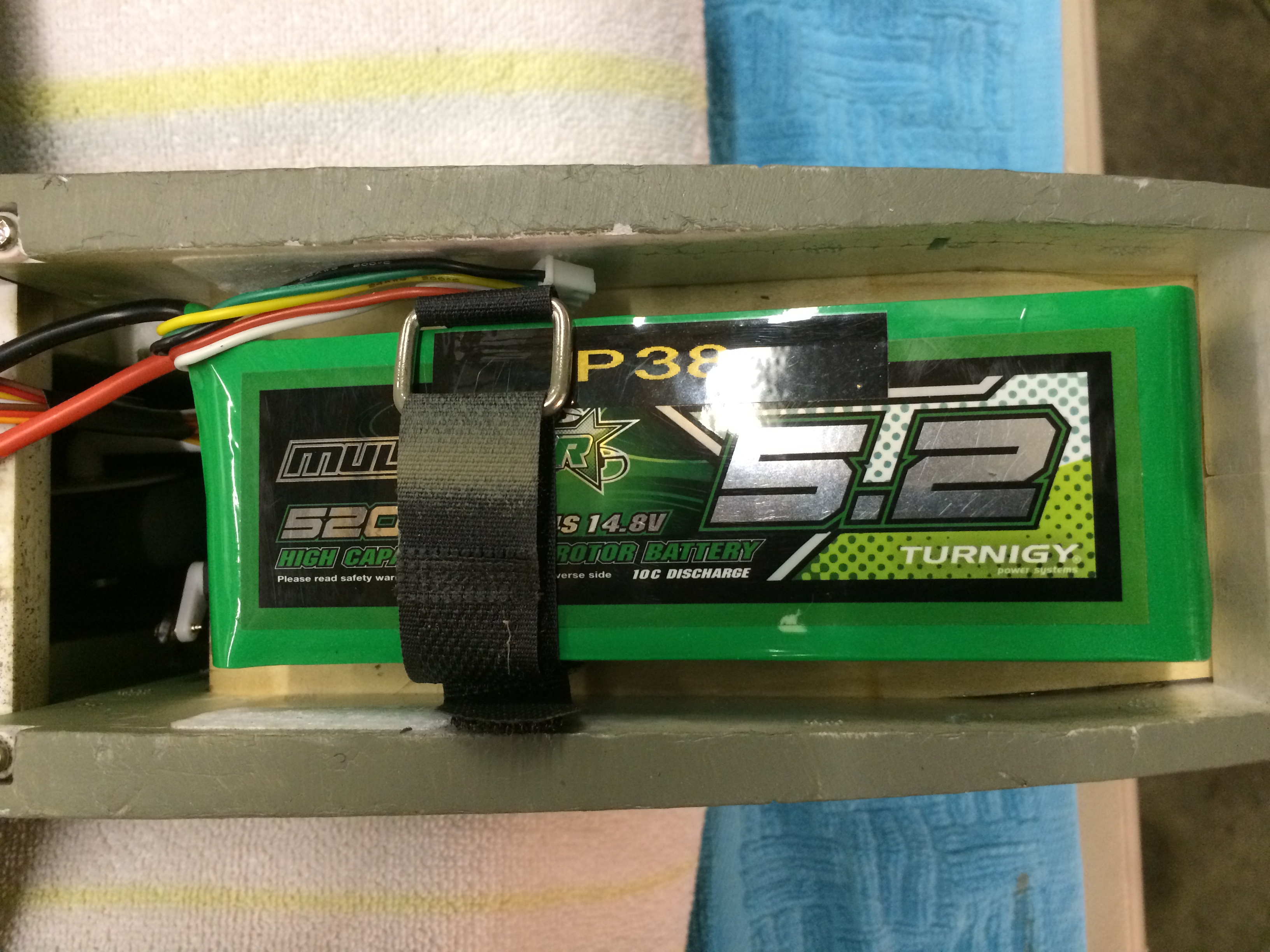

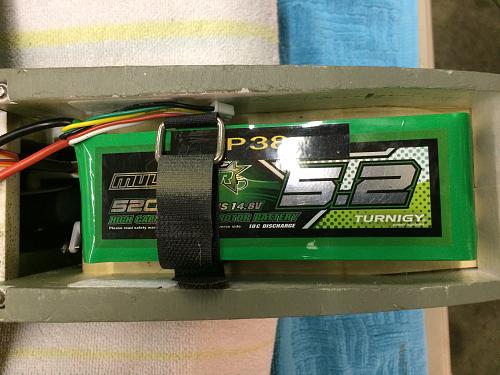

                                  Nice fit.

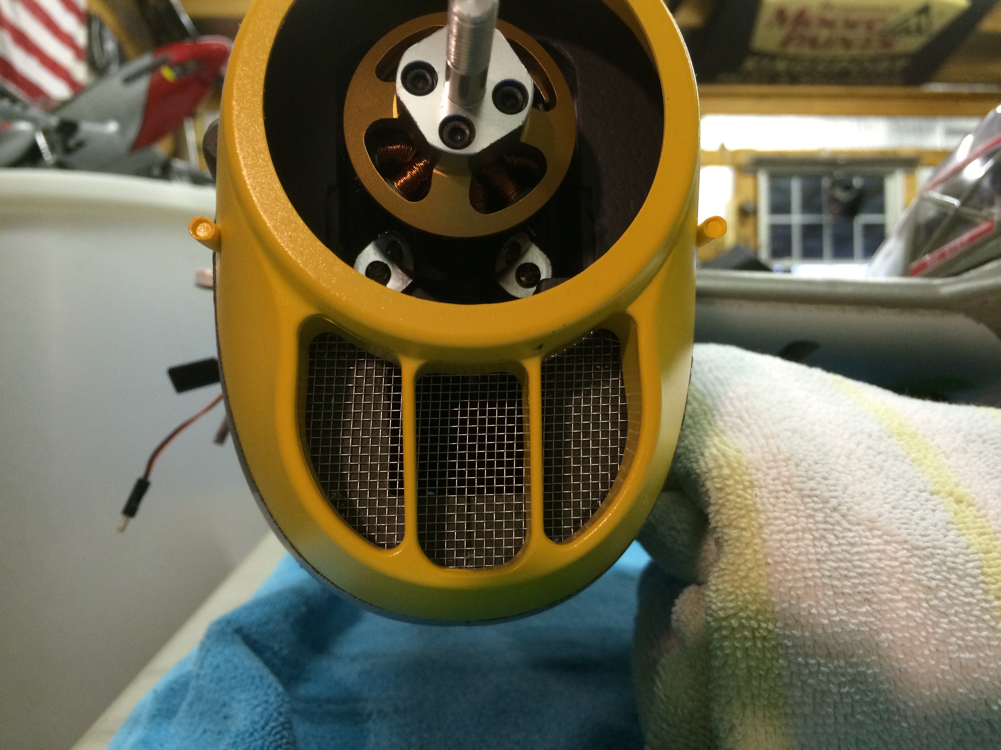

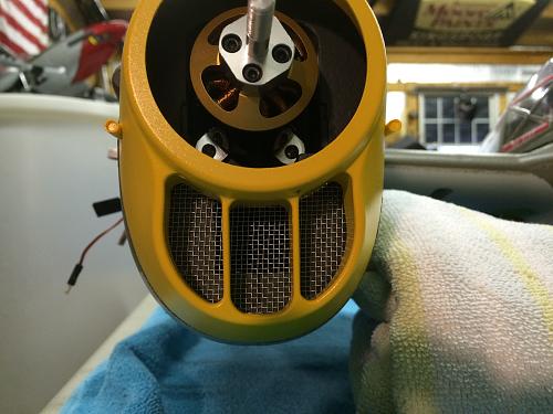

                                  • A man after my own heart, putting screens inside the cowls! That is what I did to my Legend Models P-38 and was planning on doing the same with this one. Nice detail work! Bravo.
                                    And yes do the radiator intakes too! Don't short change me now! LOL
