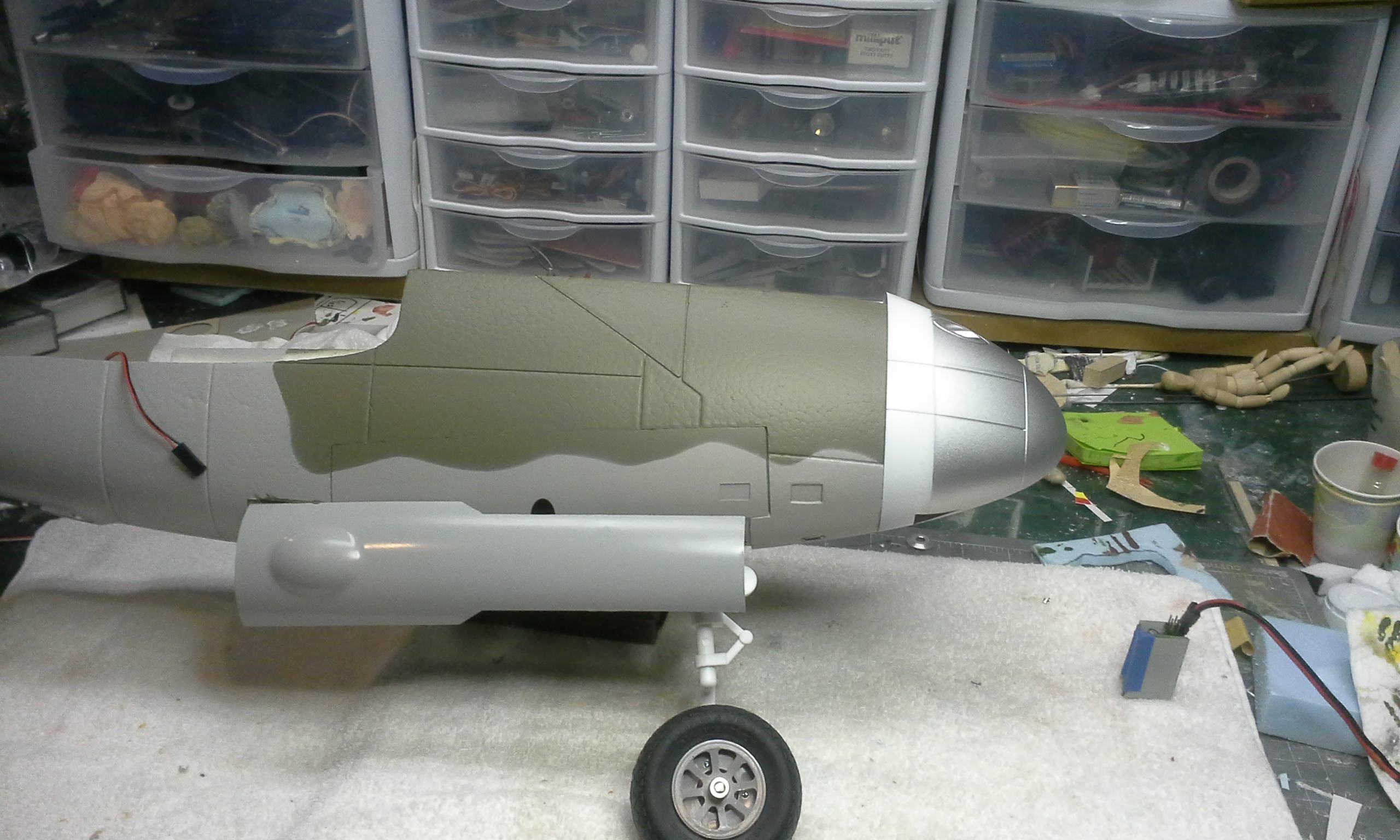

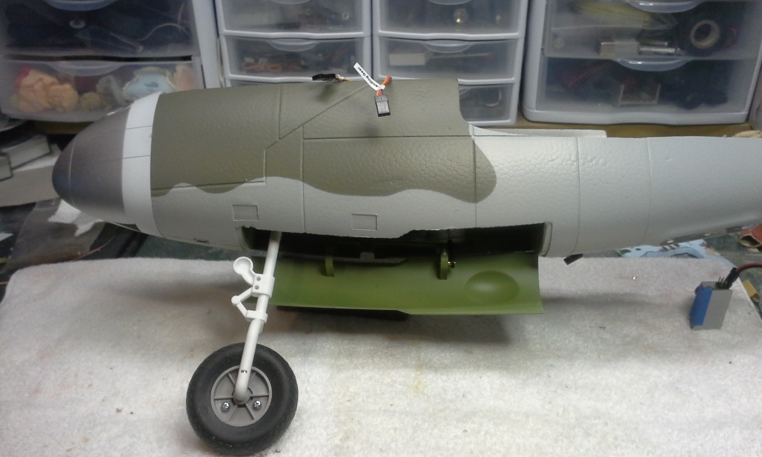

    Heres the Robart wheels mounted...same size,but think they look better..had to cut about 1/4" off the strut wire. wish the plastic gear leg had been at least molded in grey or silver..wouldve been better than white..but my airbrush will fix that later

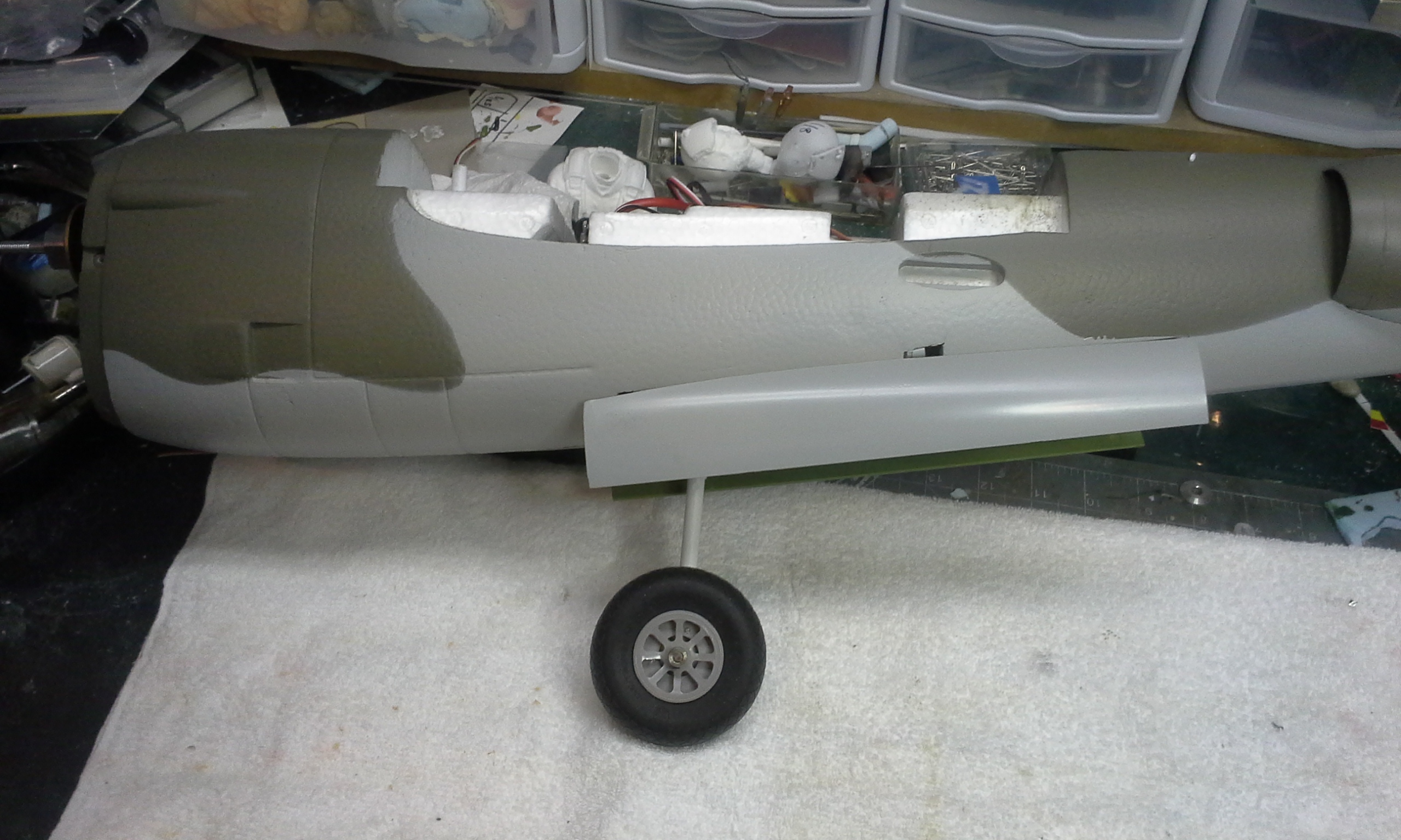

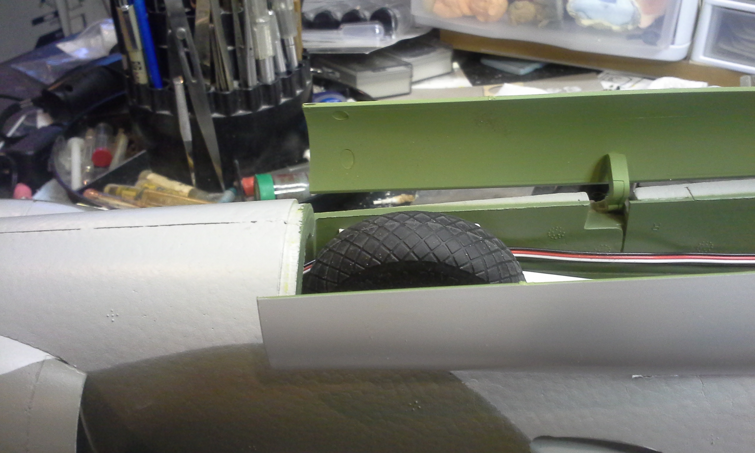

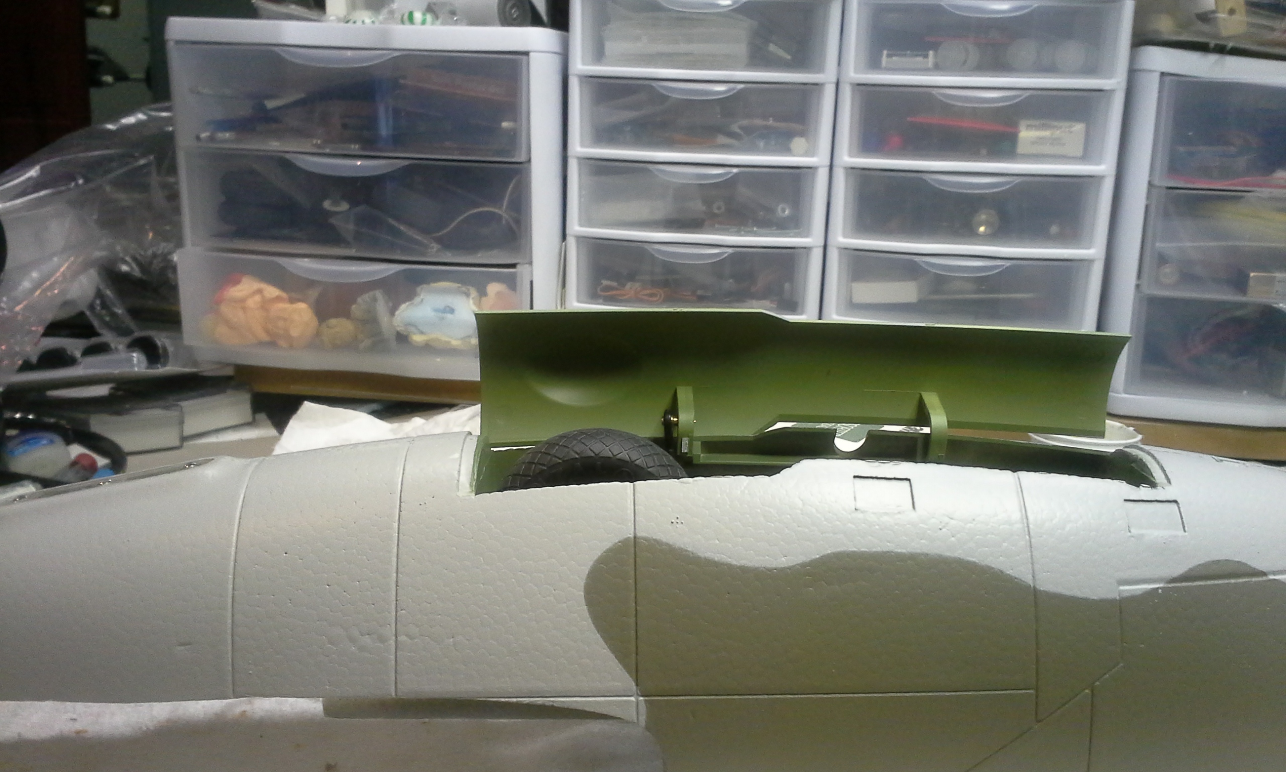

          The wheel mod is done using Robart low bounce diamond tread. 2 3/4 " for the mains and 2 1/2 " for the nose.
          Thanks to MotionRC's testing and posting their findings, everything kinda' fell into place. I added small washers to each to increase the forward rake. 2 per rear set of screws for each retract.
          Next I'll detail and paint the struts.
          " My Little Pig " is what I'm shooting for.

                    Nice job on the forward raking struts Woody! All done by washers alone?

                                THX Tony. :shy:
                                Aros.MotionRC: yes, the forward rake is accomplished using #4 steel flat washers. Two per side are placed on the back end of each retract.
