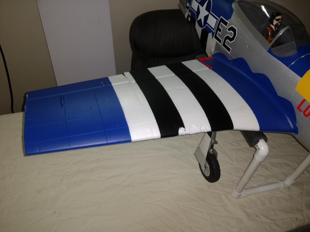

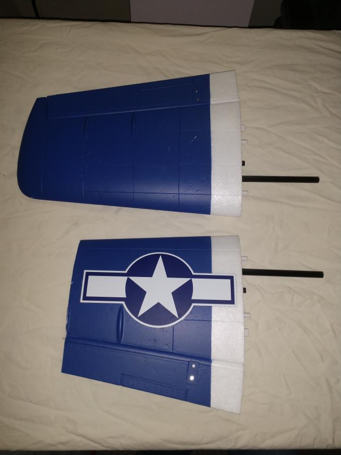

                                    Last night I also clipped the wings on this bird!! I took 4 & 1/8th" off each side. It now has a wingspan of 1295mm / 51inches. I'll be testing how it fly's today. If all goes well I'll be painting this up as the precious metal p-51 Reno Air Racer!!
                                    I'll post up flight results later this afternoon hopefully.

                                      Well got out to the field this morning. It was windy, but I had to try things out. Turns out the plane flys amazing regardless of wind!!! the clipped wings made almost no difference in stability at all. Roll rate and over all handling are almost identical to what it was stock! I was completely shocked by that. Here are a few quick pic's
ID:	287728Click image for larger version
                                      Now it's time to clean up the cuts and get it ready for paint. I'm going to smooth everything out and paint it up as the precious metal reno air racer (Chrome & Yellow).
                                      I'm super pleased with out clipping the wings turned out.
