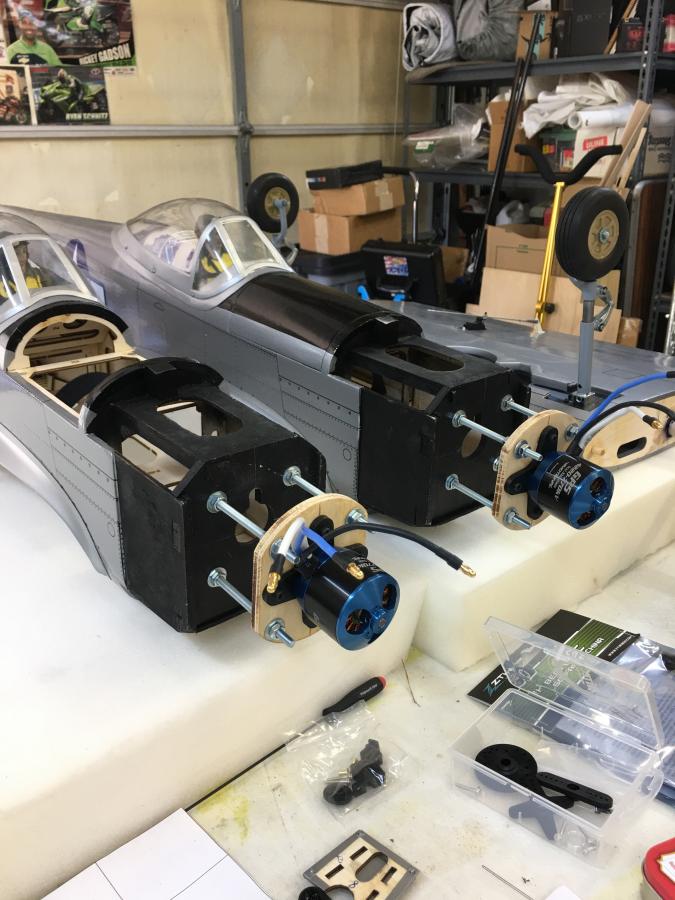

                                    Building one now. A few hiccups but nothing that is a show stopper. Motors mounted but NOT adjusted for proper spacing yet.Click image for larger version  Name:	14723C03-53EC-4D70-ACAA-307FD57E01CC.jpeg Views:	0 Size:	89.6 KB ID:	275812

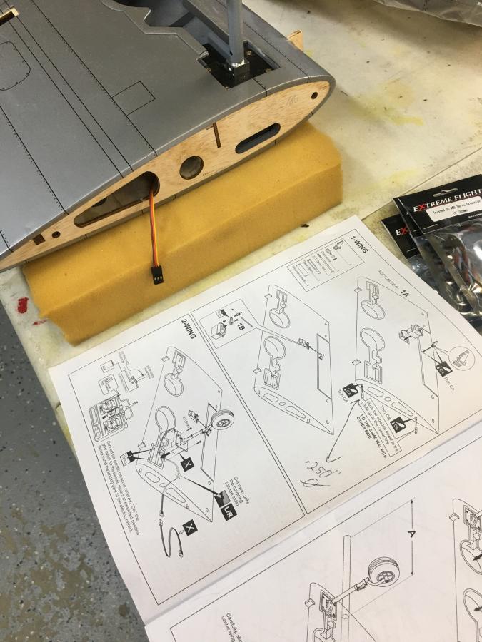

                                      Click image for larger version  Name:	6EAF1619-0DB7-4D3E-BFC3-99C8FC95E011.jpeg Views:	0 Size:	89.7 KB ID:	275815 1st step in the instructions, insert the wood dowels into the wings. There were no dowels. But a trip to home depot for some 1/4" dowel rod fixed that.

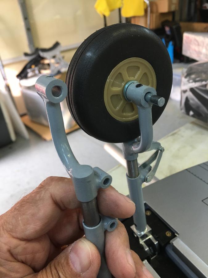

                                        Click image for larger version  Name:	475754BB-1073-487D-9E0F-78E303706562.jpeg Views:	0 Size:	61.6 KB ID:	275817 The struts were so tight and grabby upon compression, I had to dis-assemble, polish the barrels inside and out and then grease the inside of the tubes and remove burrs from spring.and grease with some Super-Lube. Now they are sweet.
