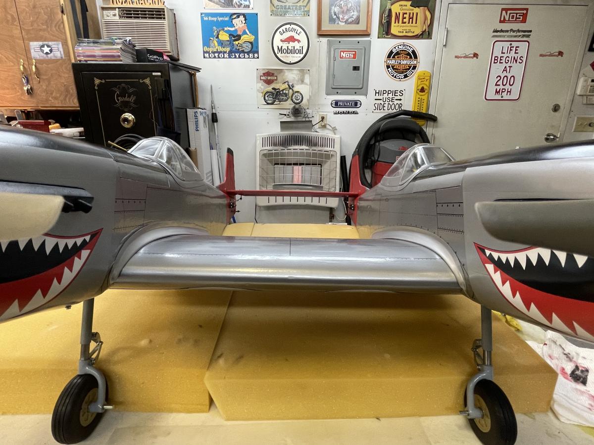

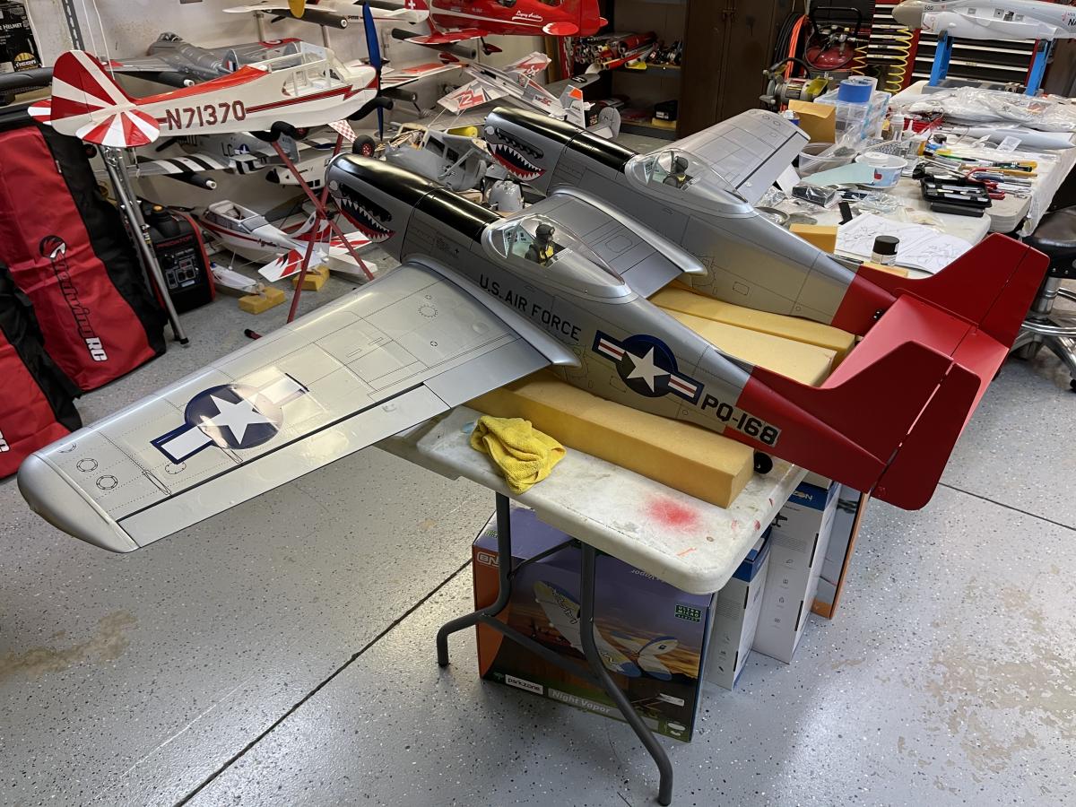

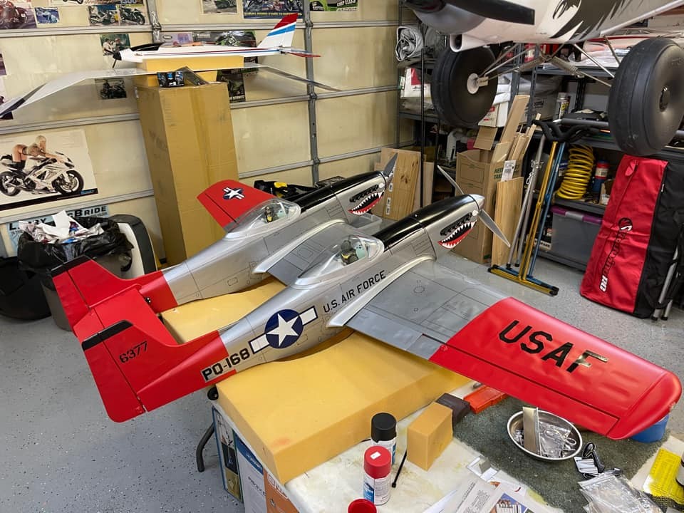

          Just wanted to post a few pics of my F-82. We're going with the Alaskan Air Command colors. Still have to paint wingtips and fine touch-up the front of the cowls. Everything operational and zero'd out. Now the tedious stuff. Verify every screw is tight and all e-clips have foam-tac on them. Double check all control arms, servos, DR's, throws and finish up motor wattage measurements.
          Click image for larger version  Name:	547434FD-1EEA-484A-B9BA-02778942BF71.jpeg Views:	0 Size:	182.7 KB ID:	292192Click image for larger version  Name:	3489DB36-E3F0-4814-B049-7259B36F37B7.jpeg Views:	0 Size:	199.8 KB ID:	292195Click image for larger version  Name:	A5E8E501-1390-49D5-ABE5-C9EE1BC25255.jpeg Views:	0 Size:	162.5 KB ID:	292189Click image for larger version  Name:	31FB43CA-4390-4958-8B59-A4B605708743.jpeg Views:	0 Size:	156.2 KB ID:	292190Click image for larger version  Name:	851F0B84-9027-4E4E-9579-8C65718F9346.jpeg Views:	0 Size:	191.1 KB ID:	292191
          Click image for larger version  Name:	3489DB36-E3F0-4814-B049-7259B36F37B7.jpeg Views:	0 Size:	199.8 KB ID:	292194

            Very nice!
              #46
              Guy.Caputo@bex.net Well Done! Looks much better than the Betty Jo livery.

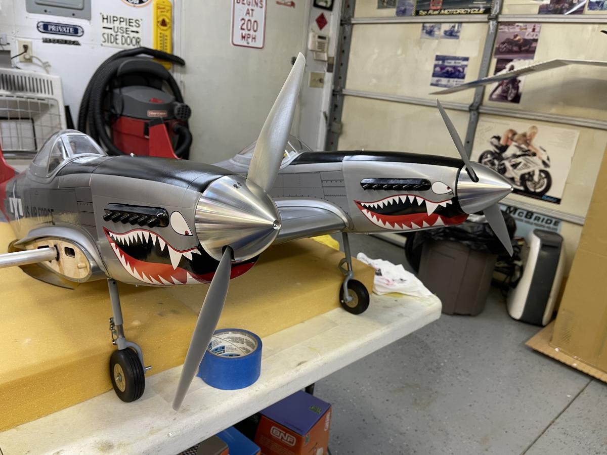

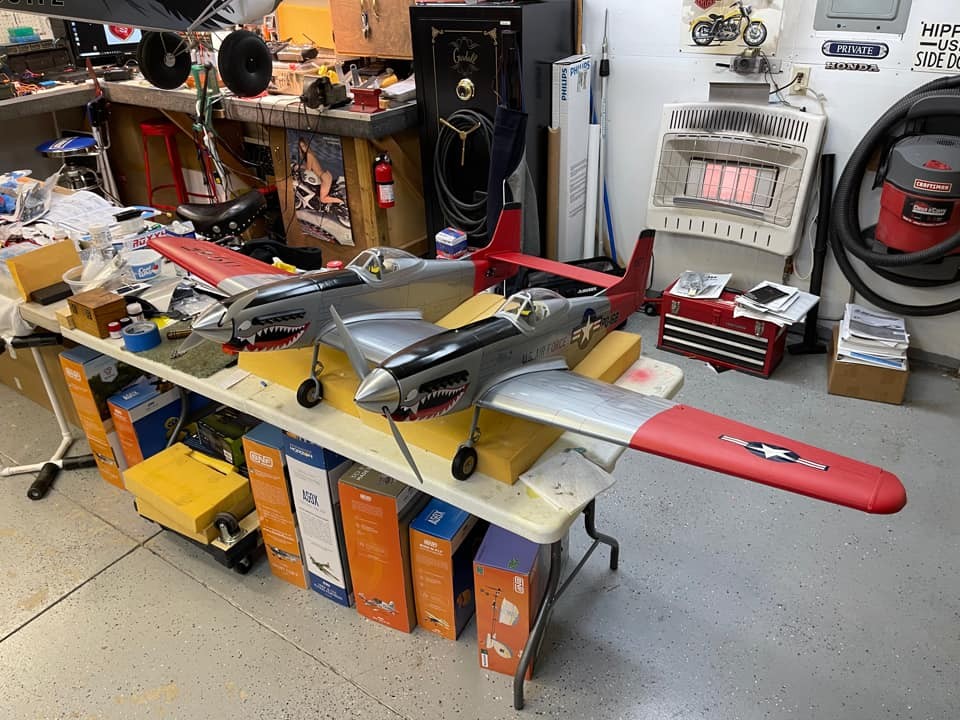

                Click image for larger version  Name:	image_66251.jpg Views:	18 Size:	131.7 KB ID:	292634 Click image for larger version  Name:	image_66272.jpg Views:	3 Size:	180.6 KB ID:	292722Click image for larger version  Name:	f82_4.jpg Views:	0 Size:	140.0 KB ID:	292723Click image for larger version  Name:	f82_5.jpg Views:	0 Size:	165.2 KB ID:	292720 A couple more.

                  There are 8 implanted mystery clues to what this aircraft was in the Alaskan Air Command. You can find more clues at the Motion RC Community Facebook page. https://www.facebook.com/groups/motionrcfanmedia

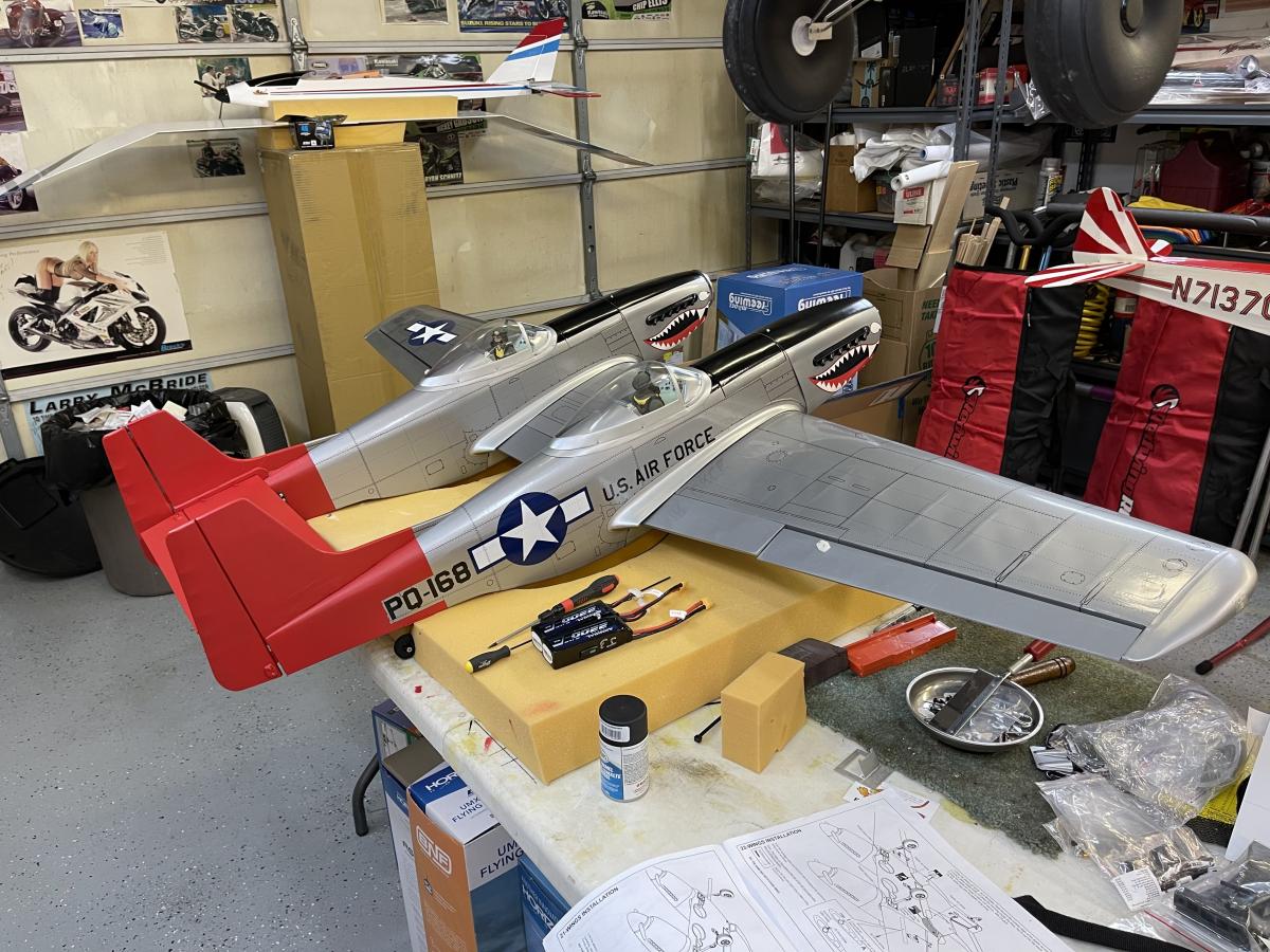

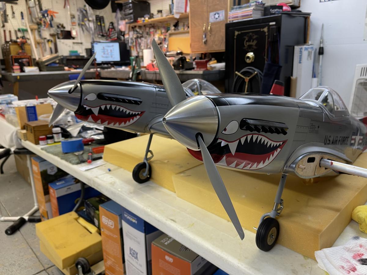

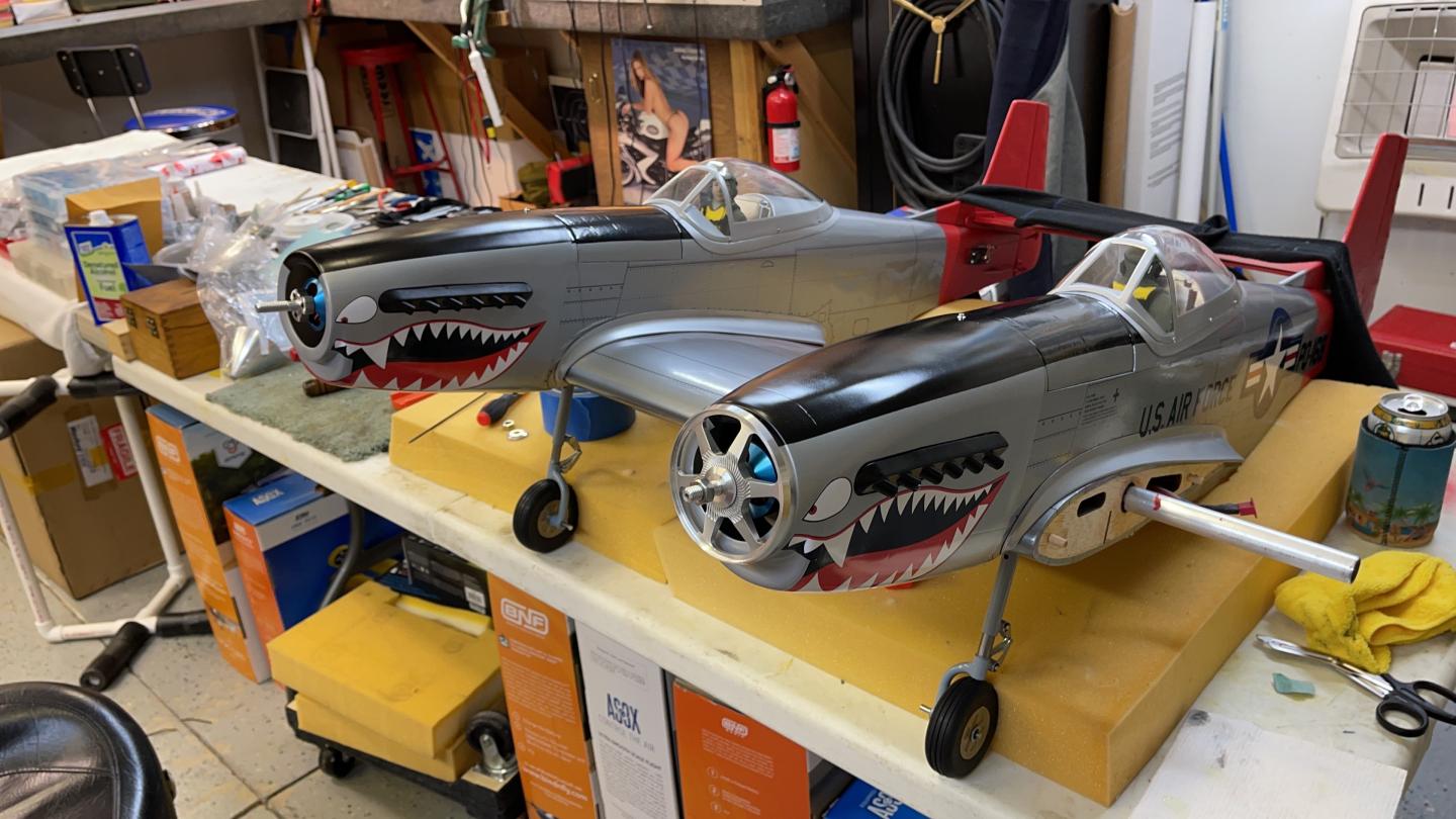

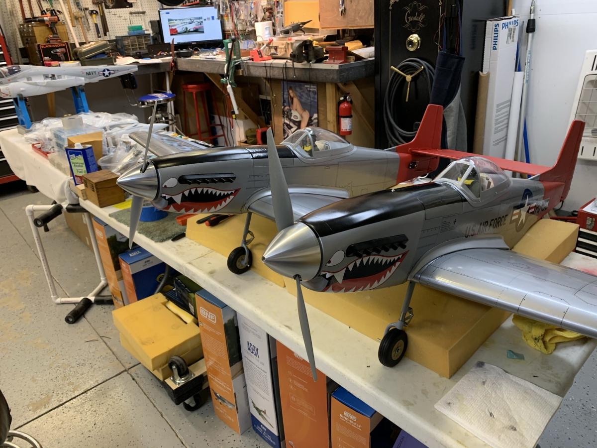

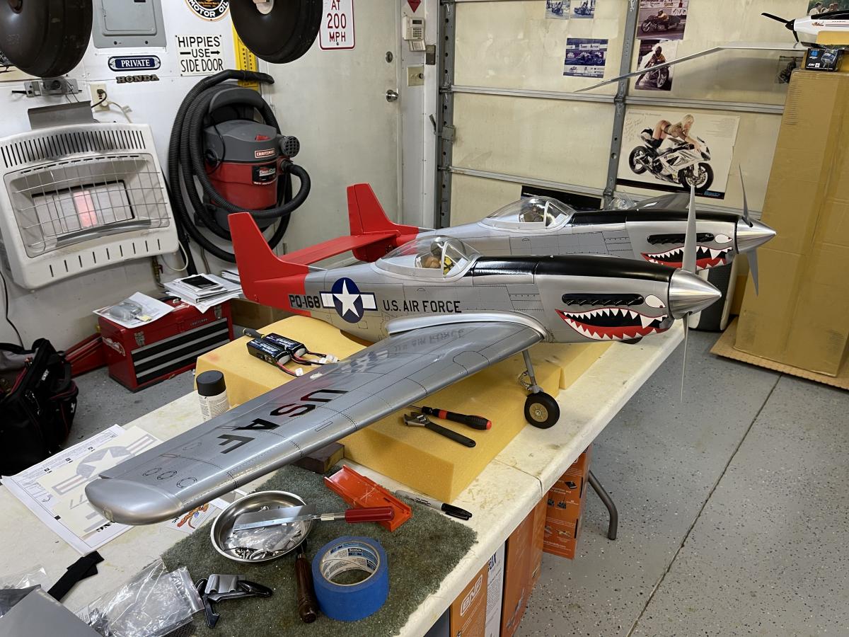

                                    The F-82 is now on the bench. My builds usually take a while but, I'll update as I go along.
                                    Since this is a "fun scale" project, I think I'll go with a fantasy livery. The cowls, rudders, and wing tips will be yellow. It will also be sporting invasion strips.
                                    I'm looking for a name for the nose art. I'm looking to highlight the twin/double fuselage aspect. Something with twin, double, two etc.... in the name. Suggestions are more than welcome.

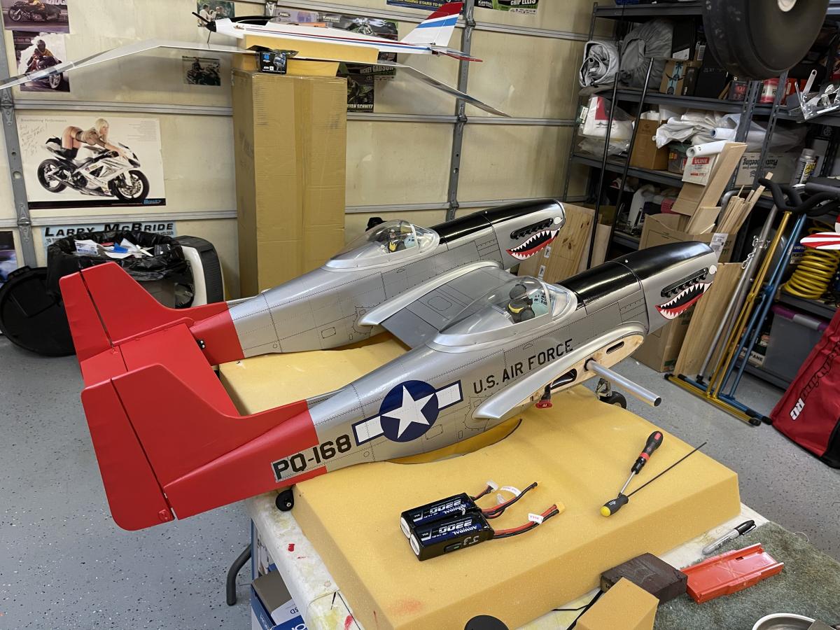

                                      Double Trouble...
                                        #59
                                        Double Trouble...
                                        That was kind of my first thought too. It was used on several different planes during WWII with different artwork.
                                          • 5426
                                          #60

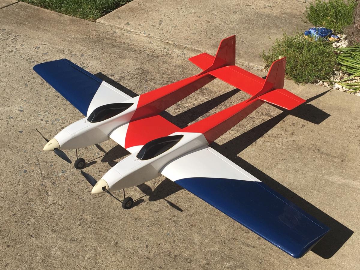

                                          Plus other planes. This is my Double Trouble, a twin Kaos if you can get the correlation.
