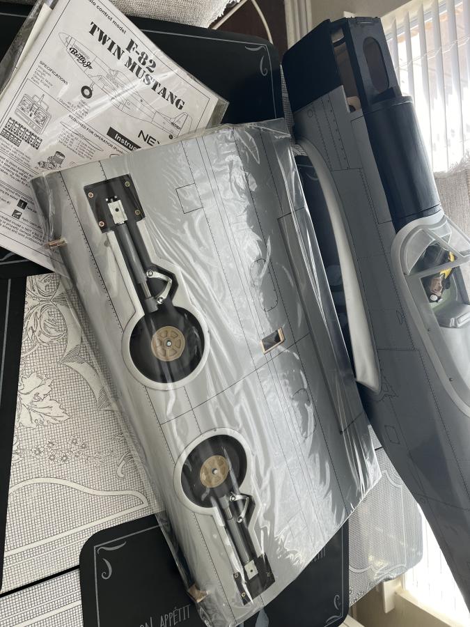

                                #95
                                ADVISORY ALERT:
                                The NEXA F-82 delivers equipped with Retracts and Landing Gear Pre-INSTALLED.
                                Contrary to the list of equipment "Required" on MotionRC WebSite:
                                Retracts are not required via separate purchase
                                Landing Gear Struts are not required via separate purchase
                                Advisory Complete
                                TwistedGrin​
                                Also Noting: The model is delivered with pre-hinged and glued control surfaces.....Aileron, Flap, Elevator are Dubro Nylon Flat hinges / Rudder hinges are CA
                                  #96
                                  The supplied retracts and struts work great, zero issues.. The struts are sprung perfectly for the weight. I did lube the pistons with silicon and work them a bit to smooth their movement out.

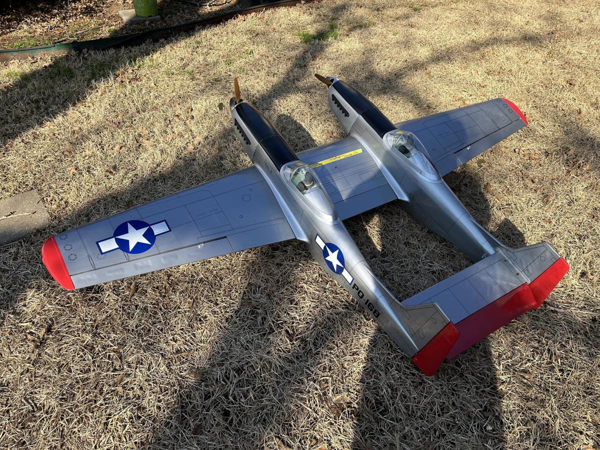

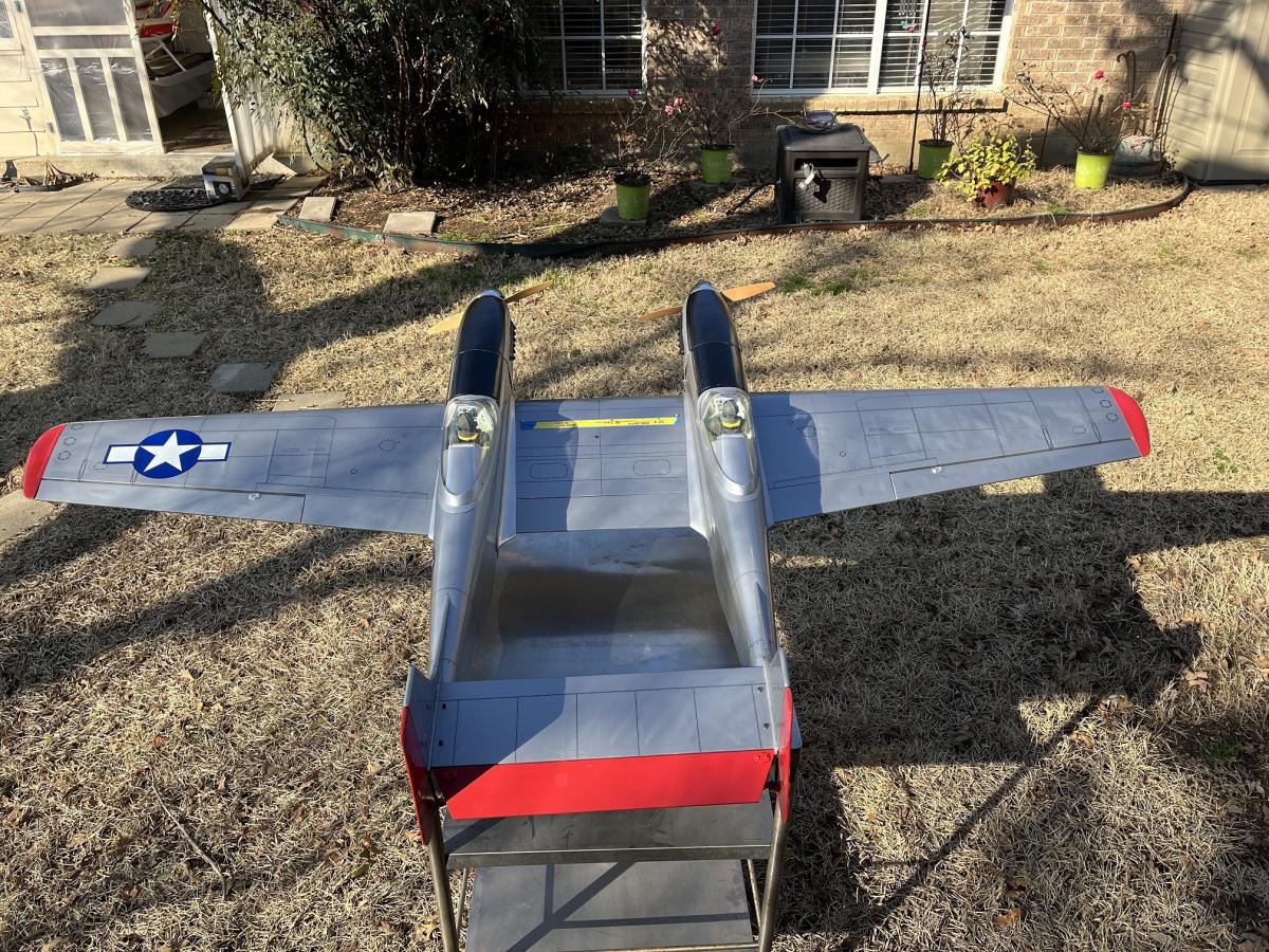

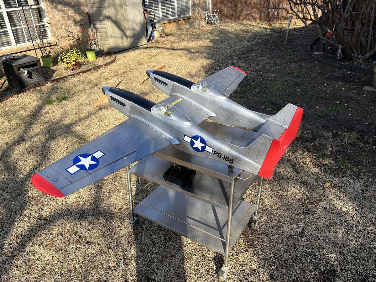

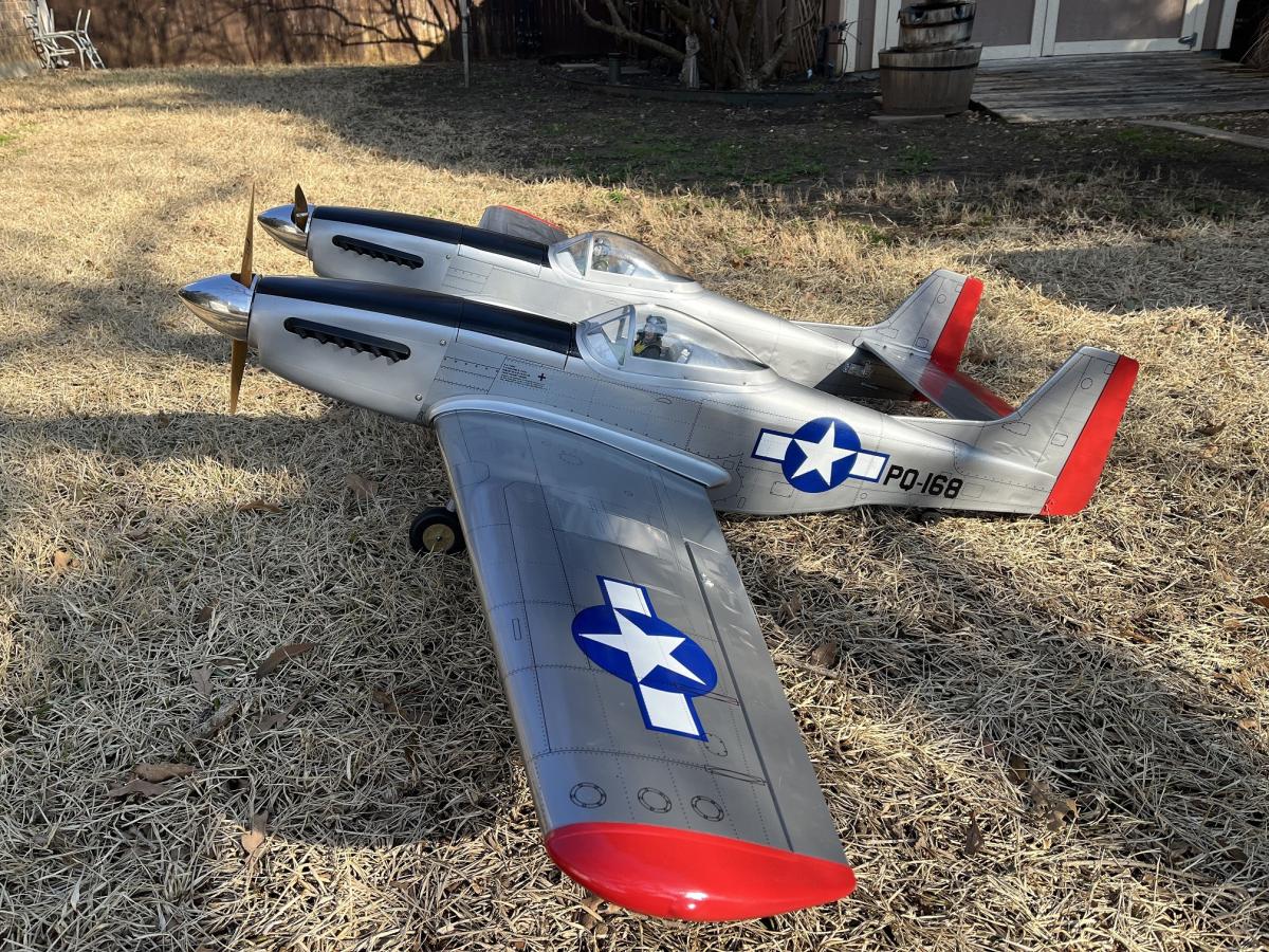

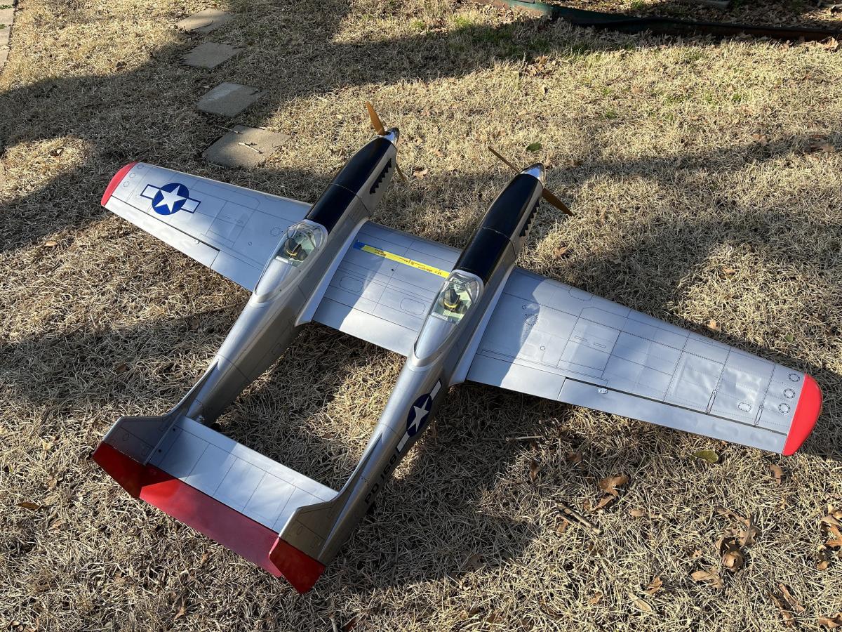

                                      Nearing the completion of my assembly:
                                      Notes:
                                      I needed 350g nose weight to achieve 96.5mm CG (inverted wheels retracted)
                                      This leaves me "some" room to move my batteries forward if needed
                                      I also needed to deploy the battery tray at the very bottom of the fuselage cavity
                                      Supplied plastic spinners warped (Unusable) - Deployed ZYHobby 3.25in Aluminum Spinners
                                      ZTW 85amp ESC's mounted inside motor boxes
                                      ZTW 18amp BEC left side fuselage pulling power from left side 6s 50c 5200mAh flight battery
                                      Aura8 Stabilizer Brick mounted to left side center wing
                                      ElectroDynamicsInc 3pin quick connects for each fuselage
                                      ElectroDynamicsInc 2pin quick connects for each wing
                                      Hitec HS D645MW Servo for Aileron, Elevator, Rudder
                                      Hitec HS 85BB servo for Flaps
                                      My right vertical stabilizer was biased with an inboard warp....managed to get most of it out during epoxy cure. I still wound up with some inward angle which now translate to a slight curve in the horizontal stabilizer.....washers on top of the wood elevator tangs help mitigate most of the curve.
                                      Both cowlings had issues mounting evenly to the right fuselage.....the left fuselage cowling mount is easily perfect. Larger cowling screws were used to secure each side.
                                      I noticed there are left and right control horn slots for each flap - I managed to get one of them on an opposing side of the other two - forcing me to deploy a servo reverser for that servo.
                                      Used 3mm socket bolts for the wing spar....tapped the spar for 3mm bolts for Left-Center-Right wings
                                      Aura8 Stabilizer control brick mounted to the center wing underneath left fuselage with two Spectrum Receivers to which the right receiver is mounted inside the right center wing for DX8 Radio
                                      I chose not to run a parallel battery loom....mostly for weight savings and the XT90 dual connectors would also encumber the batter compartment and I would still need a RX power supply somewhere.
                                      To add a little color variation I opted to paint the elevator and rudders and wingtips red. I found the plastic wing tips needed sanding and primer coat for the "Valspar Project Perfect" rattle can red to adhere.... I think the plastic caps still had some release molding residue I could not remove !! Figured I'd fly this color splash and see how it looks to me before painting some more.
                                      Tuning the flap servo's it is mechanically impossible for the 85BB servo short arms to reach the 35mm deflection....I am installing longer servo arms and also flipping the control rod connectors to the tops of the servo arms.....otherwise the angle from the flap horn will also bind up.....I am not too confident the power of the servo's either...time will tell
                                      The tailwheel control arms prevent full range of rudder servo movement if you attempt to use the outer hole of the rudder control horns.....therefore the inner most hole of the rudder control horn may be the only means to get the full range for the suggested manual 35mm rudder travel.
                                      At the moment I plan on storing and transporting with the twin fuselage and tail section fully assembled.....separating the two outer wings for quick field assembly.
                                      I use eCalc with excellent results in my other models......eCalc is showing the smaller 12x8 props on my 6s LiPo and 85ESC combo is a sweet spot.....172watts per Lb / 85mph WOT / 9min flight duration at 72% throttle / 62amps at WOT
                                      My total all up flying weight is heavy at 16.04lbs and if I used the correct wing area number 50dm2 this could have a wing loading at or near 47.7oz/ft. This explains the stall speed at or near 36mph......I usually try to fly at less than 41oz/ft....so this bird may have to land a bit faster than I am used to.
                                      TwistedGrin​
