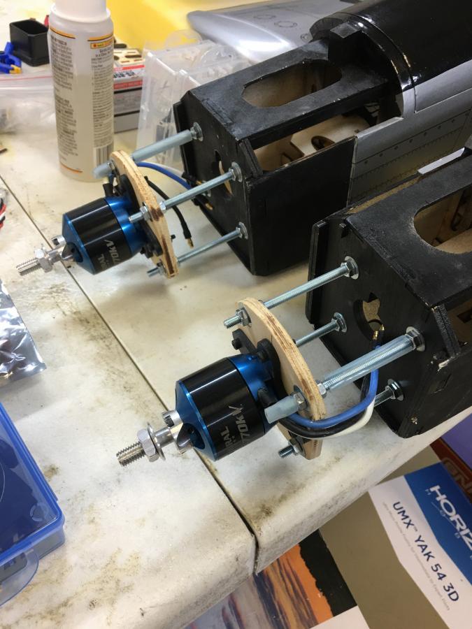

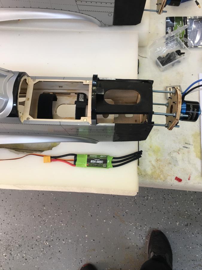

          Adjusted motor space from firewall at 112mm per the manual. Way too short once cowling was fitted. Had to move to 117mm to get proper spinner/fuselage spacing. Maybe because of the dimensions of the recommended motor from MRC. The Admiral GP5-770kv motor. But all is well.

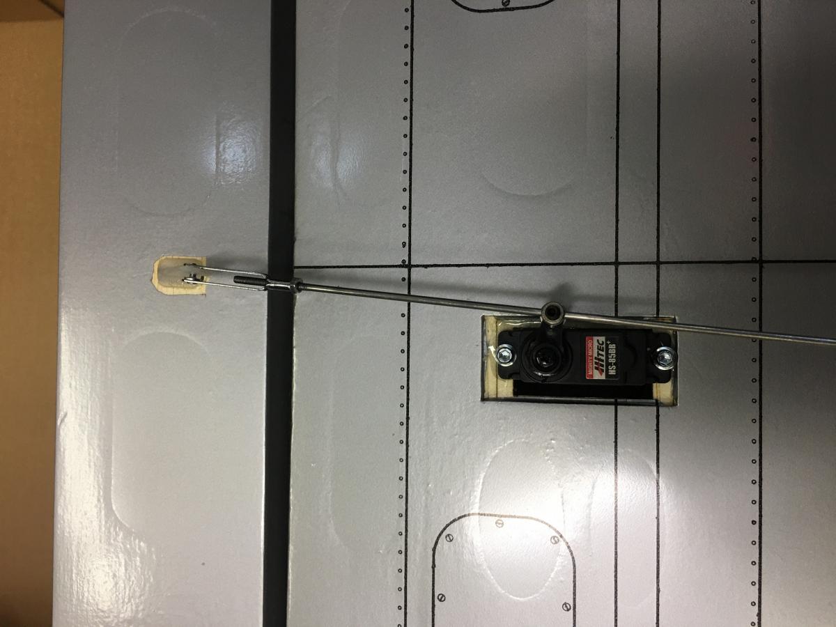

            And the center wing flap servo arm is not acceptable positioning. Will fix this as well for all flap servos. Using the recommended HS85BB

              That does seem like odd placement for the flap servo.

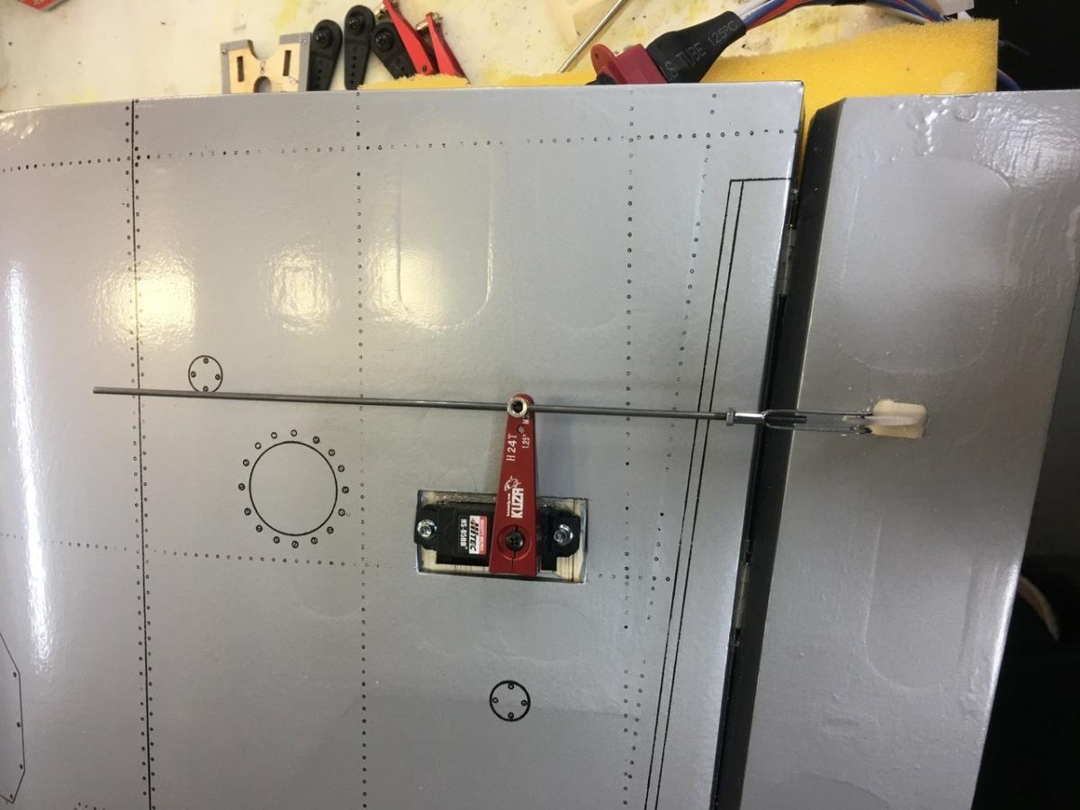

                      Using some servo arm extensions and then reset end points of servo. Using flap switch and the throws are perfect for a 3-position flap. Up, Take off and full.

                          While that is a decent micro servo putting that arm on it and reducing the throws in your radio may be too much for that servo to supply. Big surface, small servo, poor mechanical set up.

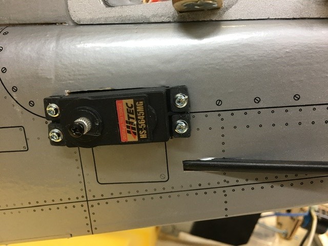

                              After removing the covering off the elevator servo mounting position, I found it cut to fit a small servo so I was wrong in assuming it also would be a 645mw. Does anyone know the required servos for the elevator positions on the left and right fuse ? HS-85BB ?

                                With the importance of the elevator why not open the spot and use the larger servo?

                                  The elevator is powered by 2 servo's. Would not using the 645MG's be way overkill? The openings are 16 x 31 mm I'll look to see what's out there. Thanks

                                    The way I look at it is if I was building this from scratch what would I do. Thinking this is a fair size plane capable of some good speed. Critical surface, probably most critical. I do think that the micro probably has enough torque and speed but remember the larger servo gets you a larger mounting footprint and larger geartrain.

                                      I agree. Opened the elevator servo mount hole to 20x41mm to fit a couple HS-5645MG servos. Just a note here, You have to reverse of one your servos because they are opposing. You can accomplish this a few ways. However you choose to do that is builders preference. I chose a reverser from Daves RC Electronics, but I understand you can program some Hitec servos to do that as well.
