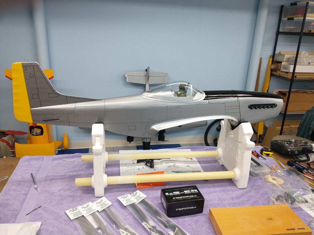

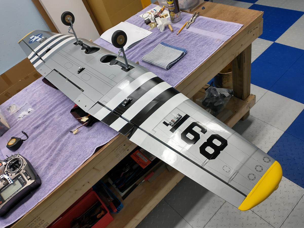

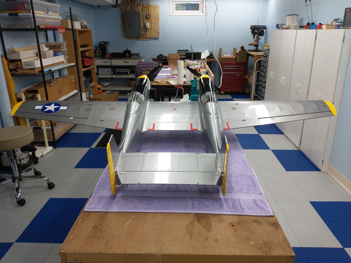

      Got the invasion stripes on bottom of the wings and the tips painted. The wing servos are mounted and wired.
      The wing sections are together on the wing tube. I wasn't a fan of the screws supplied to fasten the wings on the tube. I went with slightly larger diameter screws. I discovered that the factory had installed small copper sleeves for the screws to pass through in the wing. As they were a smaller diameter, I removed those and installed CF tubing guides/supports.
      The instructions call for only two screws, one in each outer panel. There is also a place to install a screw in the center panel. I drilled and installed a screw there as well. Better support for side loads.
      The retracts seem to work good and are pretty beefy. I will polish the inner struts up a bit. I'm also installing Robart diamond tread wheels.
      The graphics have been ordered from Callie and should be in next week. I ordered two sets of the P-51 nomenclature, larger tail numbers, and the nose art. I found this version of Double Trouble thought it would look great. It was on a B-24. I did mod it a bit by removing the dark blue circle and cloud. So, it's just the two ladies and the verbiage.

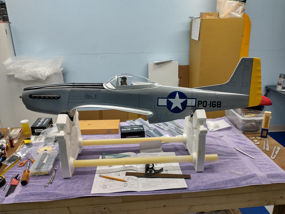

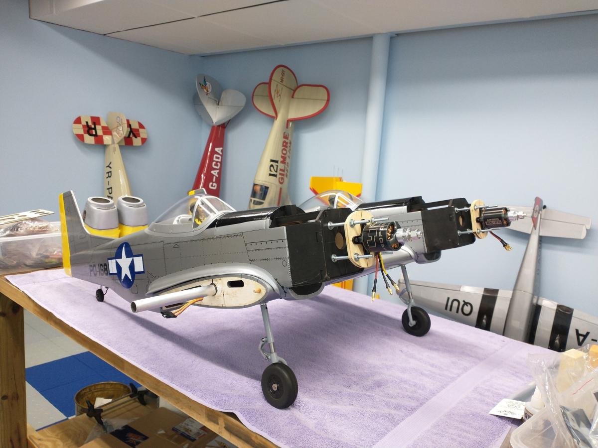

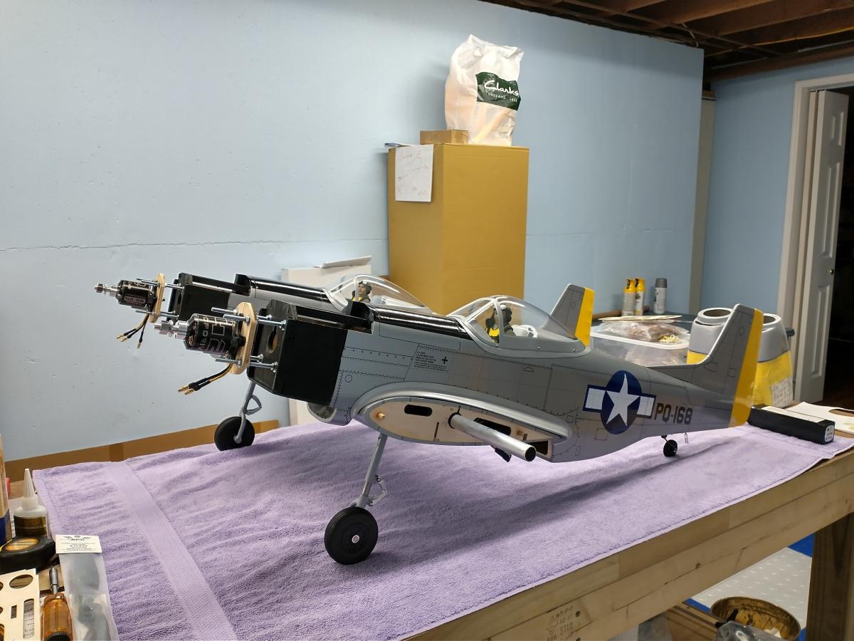

        Left fuse started. The motor is mounted. It was pretty straight forward. There is a slight right thrust built in.
        When I mounted the motor, I went with the 117mm from firewall to prop plate someone suggested. After placing the cowl on, I found the 112mm mentioned in the instructions is correct.
        Also fit the vert stab and rudder.

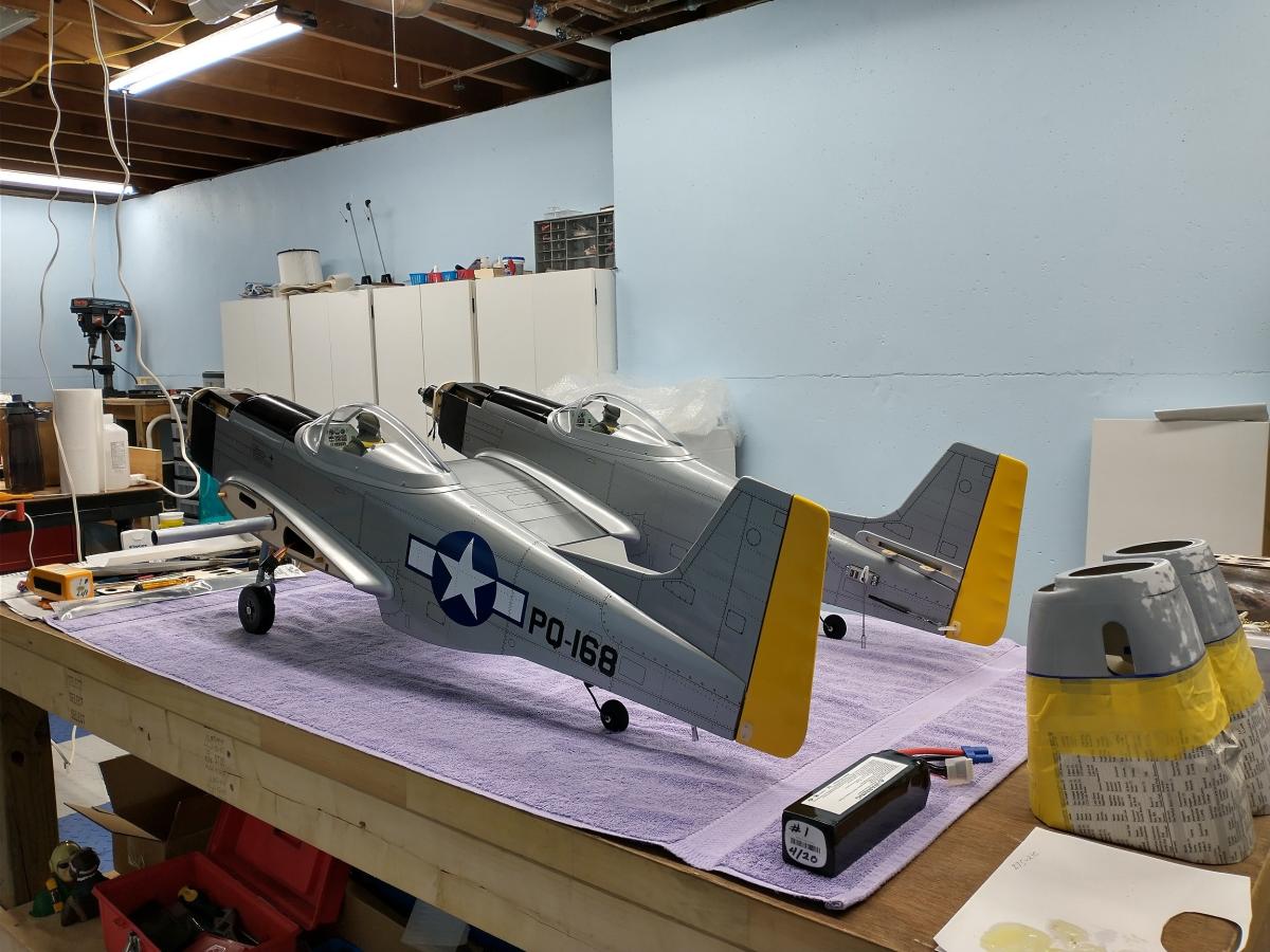

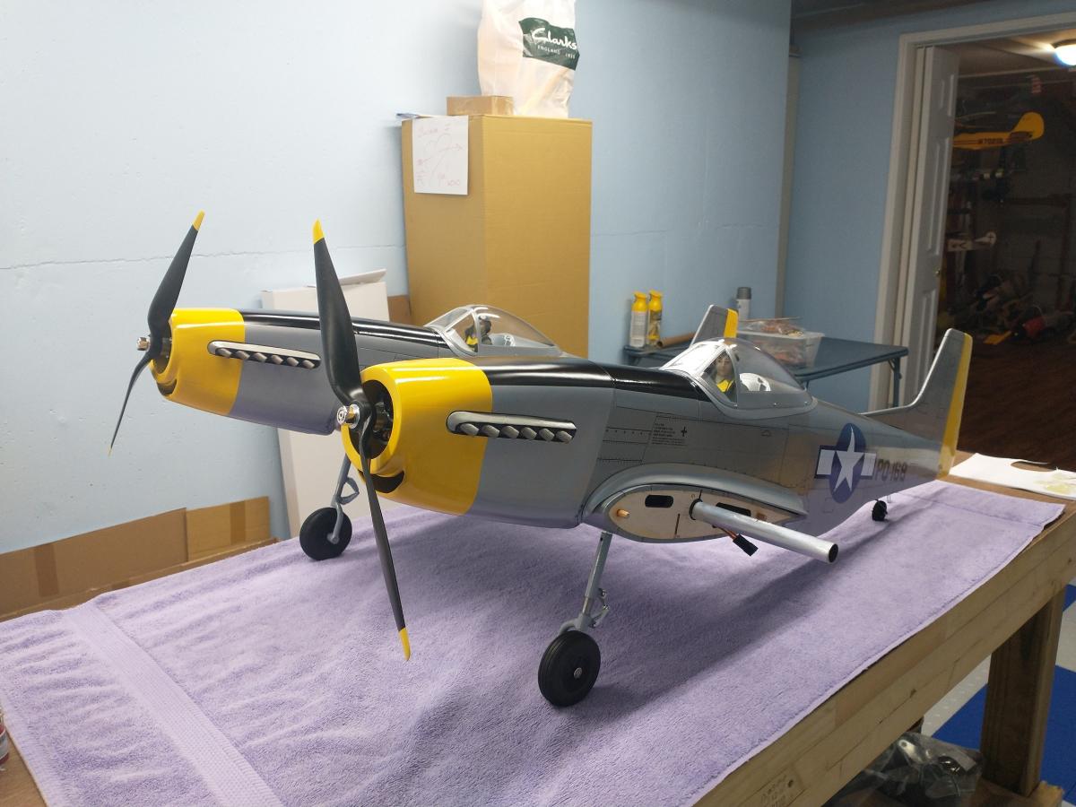

          First time up on the gear. Time to do more fitting and checking.
          All of the servos are in and set-up. All of the linkages are ready and/or connected.
          I was going to use Robart 3" scale wheels, but they are a bit too tall for the strut. Filing the bottom of the strut for more clearance isn't a good option due to how the lower end of the strut is attached to the lower piston.
          The cowls are ready to have the front ends painted yellow. The exhaust stacks are a separate piece and are glued into the cowls at the factory. Mine popped out very easily. They'll be glued in much better after they are detail painted.
          I was going to paint and use the stock spinners. While the backplates ran true, the spinner cones did not, so can that idea. It looks like Tru-Turn 3 1/4" P-51 spinners will fit the cowls fine.
          Before gluing in the supplied battery trays, check your choice of batteries to make sure they will go into the hatch with the tray in the stock location. Mine would not. As some have found that more weight may be needed up front, I'm moving the tray forward and down lower in the compartment. This will allow my choice of batteries to go into the hatch easily.
          I see that these are back in stock at the U.S. warehouse now.
          Update: I found that Hangar 9 makes a 3 1/4" aluminum P-51 spinner. As a plus, they already have lightened back plates. Not only lighter, but allows air to get to the motors. Don't forget to order Hangar 9 adapter kits for you motors, so the spinner bolts up easy.

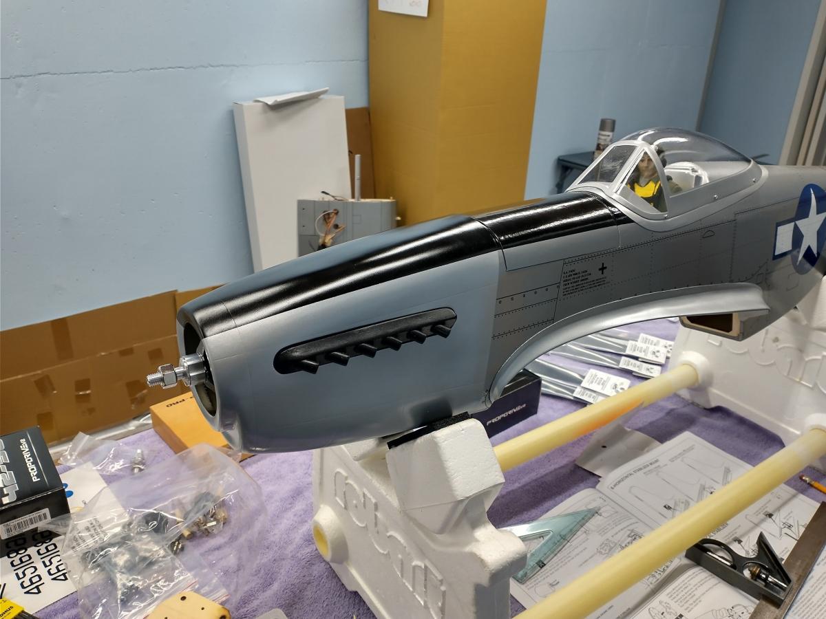

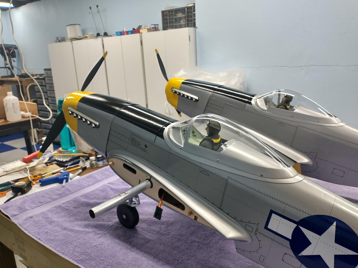

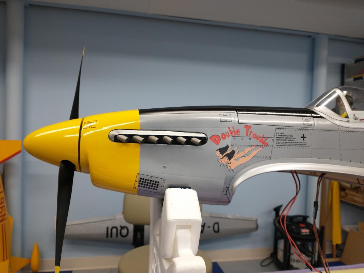

              A little cowl work finished. Painted the fronts yellow. Painted the exhaust stacks and reinstalled them in the cowls. Also opened up the chin scoops for air flow.
              I chose the APC 15x8 black props and painted the tips yellow. The Hangar 9 spinners should be here early next week, along with the graphics from Callie.

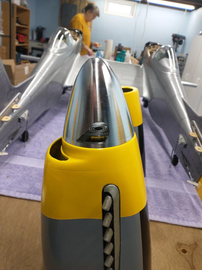

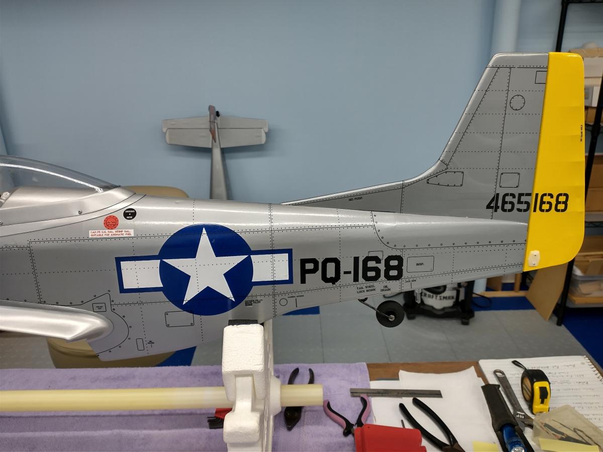

                    The spinners are painted and fit the nose well.
                    Also got the graphics from Callie. The nose art turned out great. There's one on the outboard side of each fuselage. I also got a couple of 1/8 scale nomenclature sets for the P-51. They may not be all scale but, they add to the fun of the the fun scale plane.
                    Once it's all assembled, I'll get the airbrush out for some weathering.

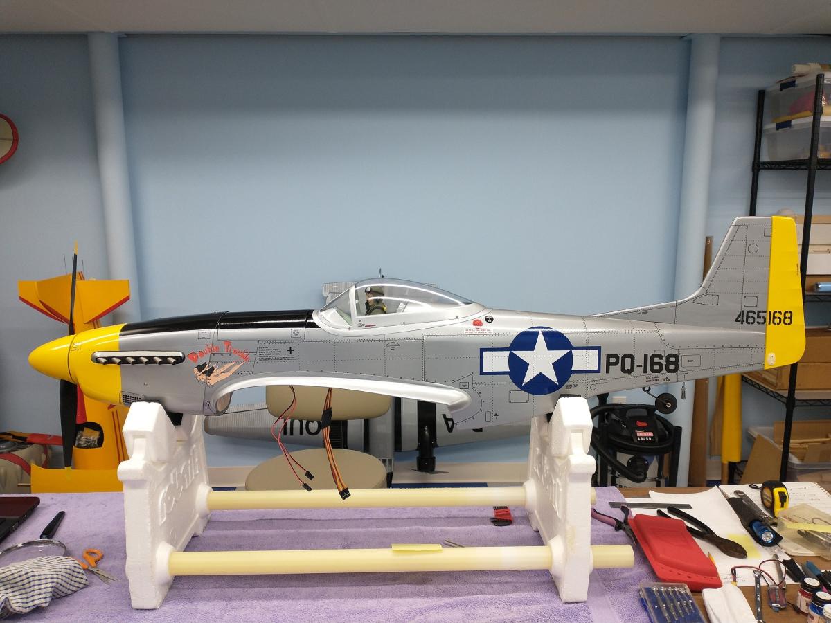

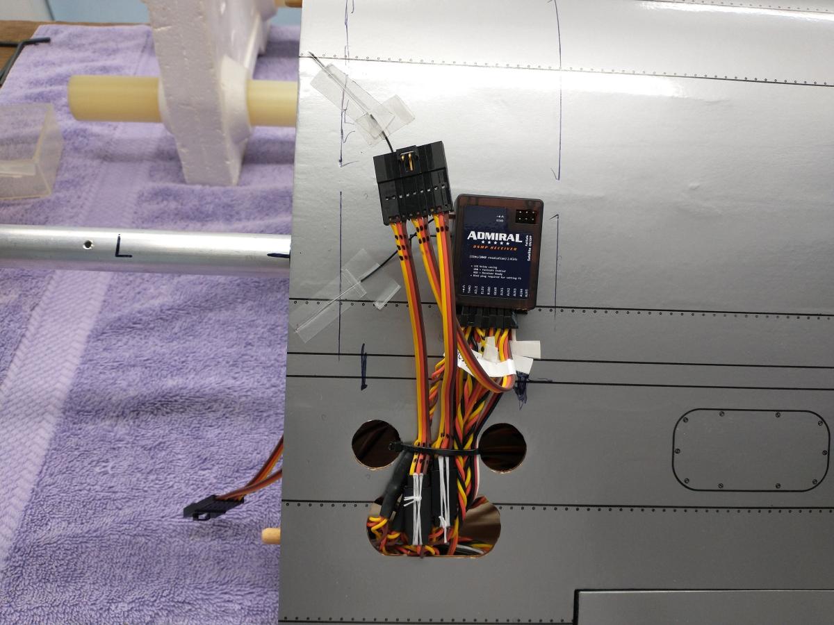

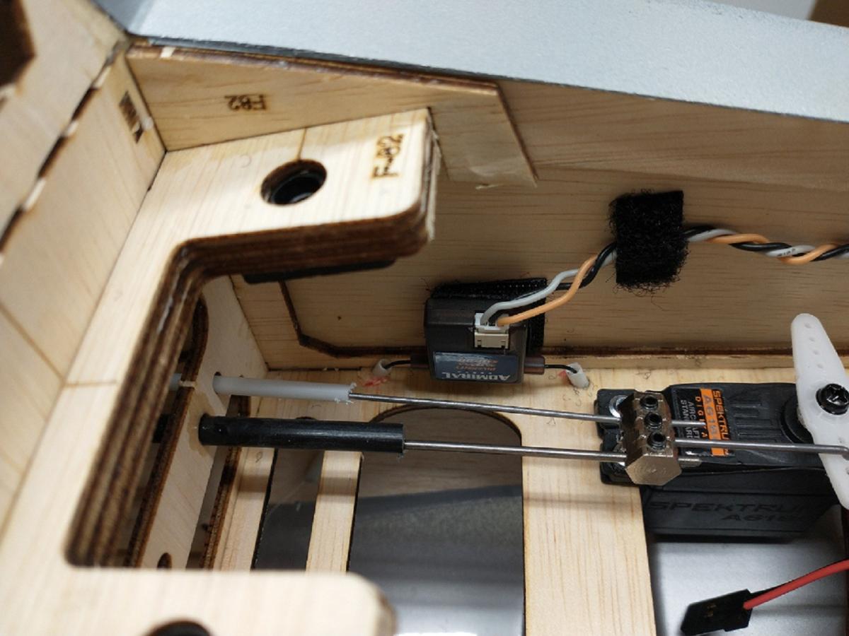

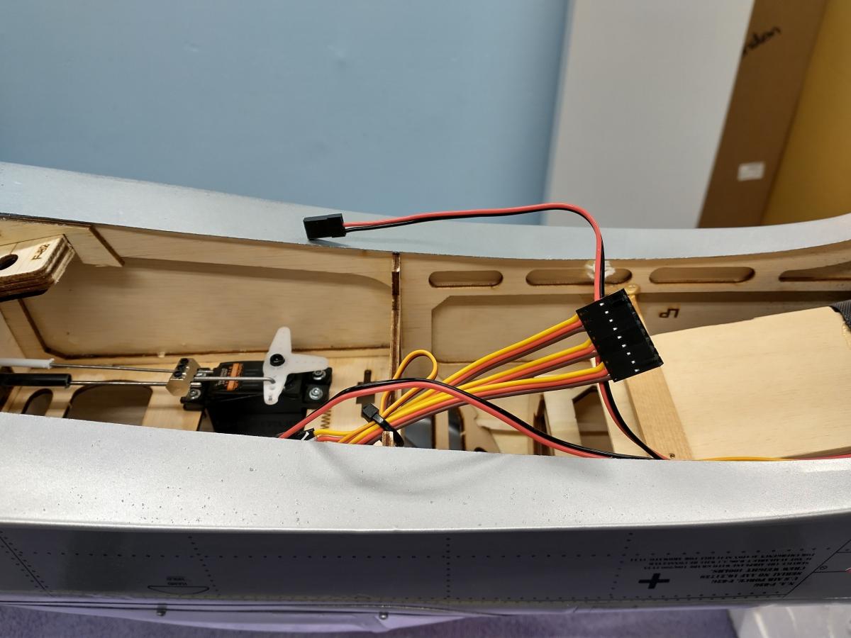

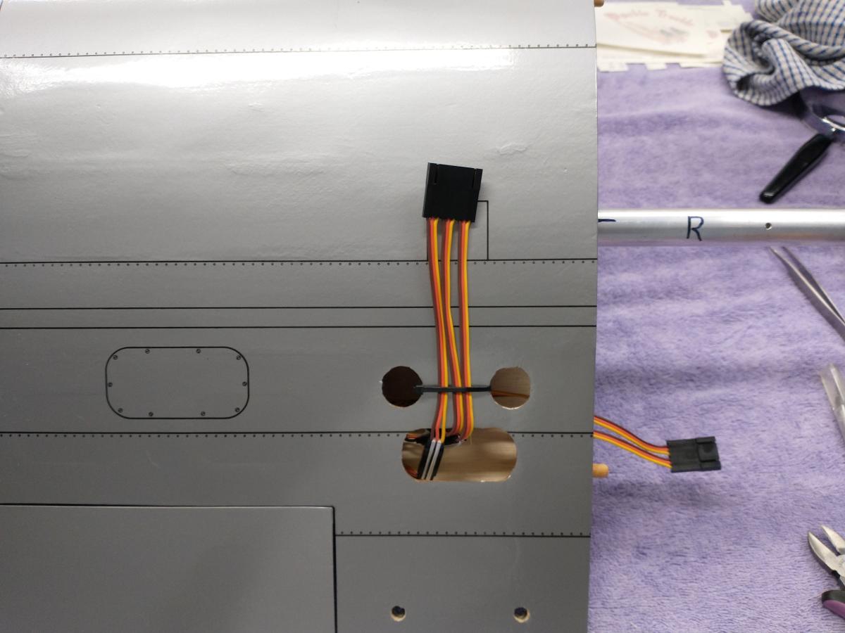

                          Got the receivers and wiring ready to install the fuselages onto the center wing section.
                          The main receiver is mounted to the wing under the left fuselage. The center wing servos are connected directly to the receiver.
                          The left and right wing panels each connect to a two servo multi-connector.
                          The right fuselage connects to a three servo multi-connector (throttle, right elevator and right rudder).
                          The left fuselage has the sat receiver, BEC and another three servo multi-connector(throttle, left elevator and left rudder). Each connects to the main receiver at assembly time.
                          I use a lot of the multi-servo connectors. They sure make take down and set-up easier at the field for most birds. Helps prevent plugging servos in with reversed polarity or the wrong servo.
                          Here's where I get them: https://www.rcgroups.com/forums/show...-Servo-Harness

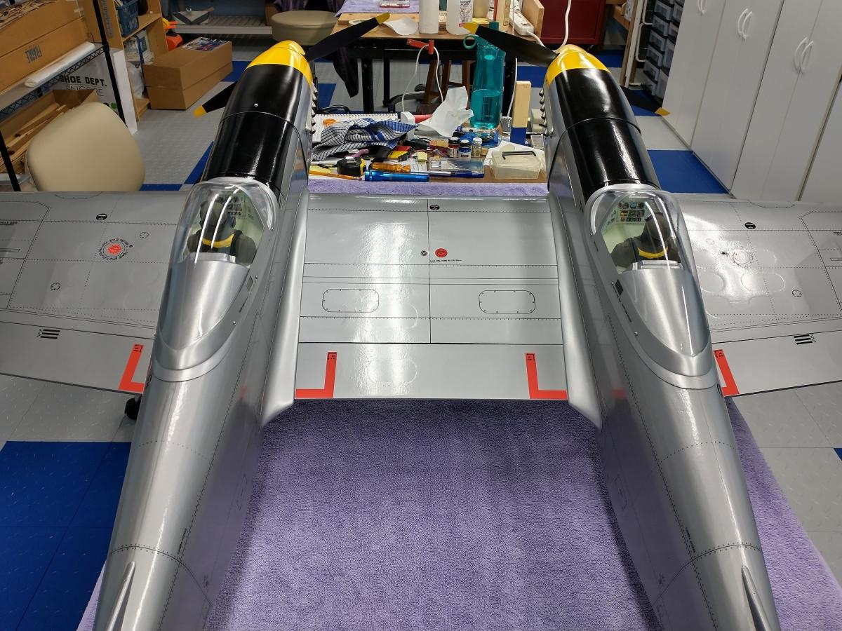

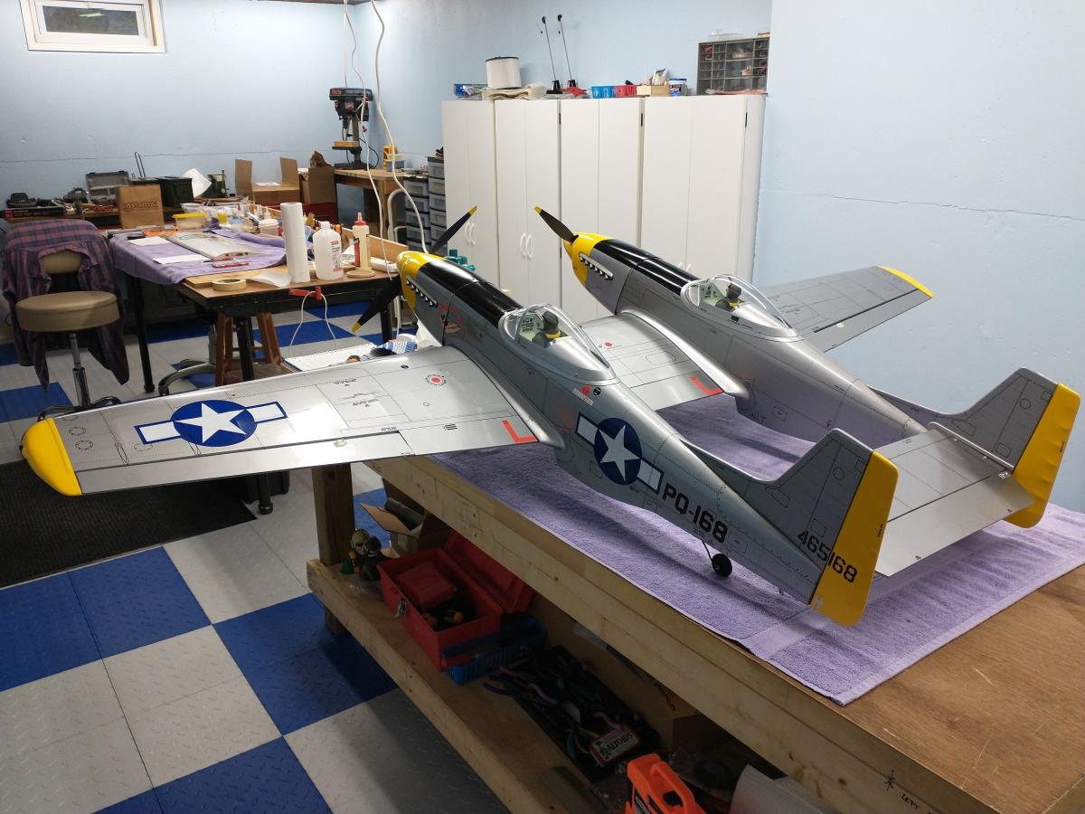

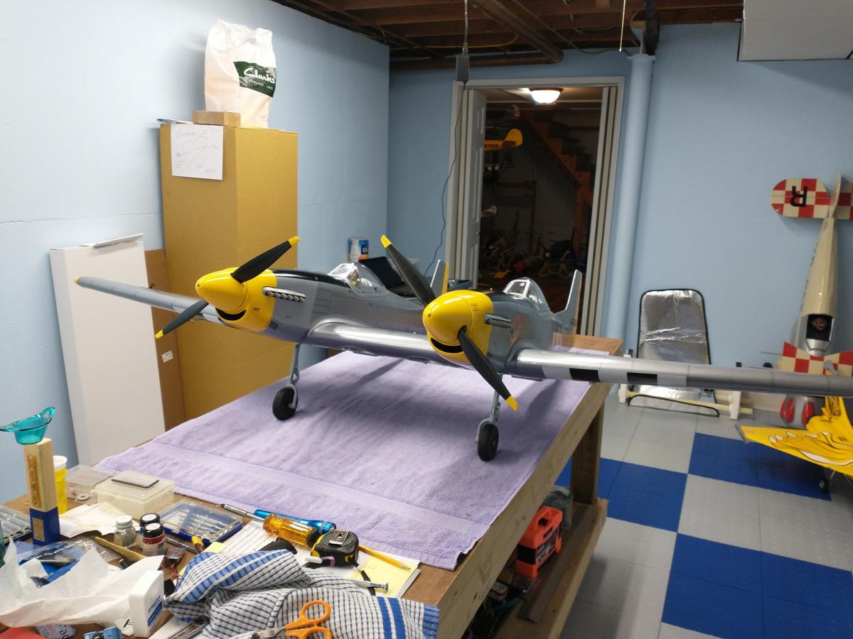

                              The custom fantasy scheme, Double Trouble, Nexa F-82 is nearing completion. Everything powered up and is moving the right direction.
                              Need to add some of the detail and final bits, set the final control throws and CG.
                              While waiting for spring, we'll get the airbrush out for some weathering.

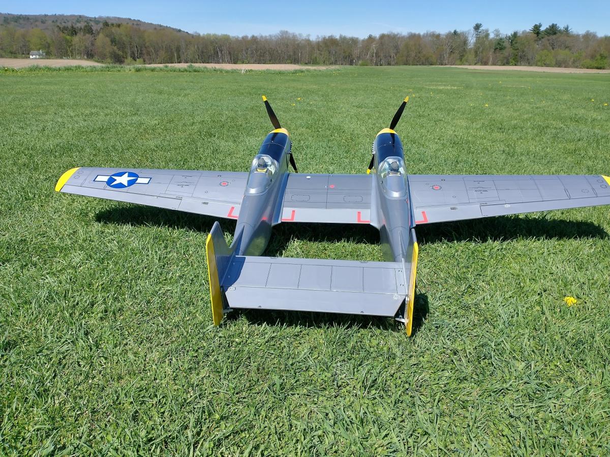

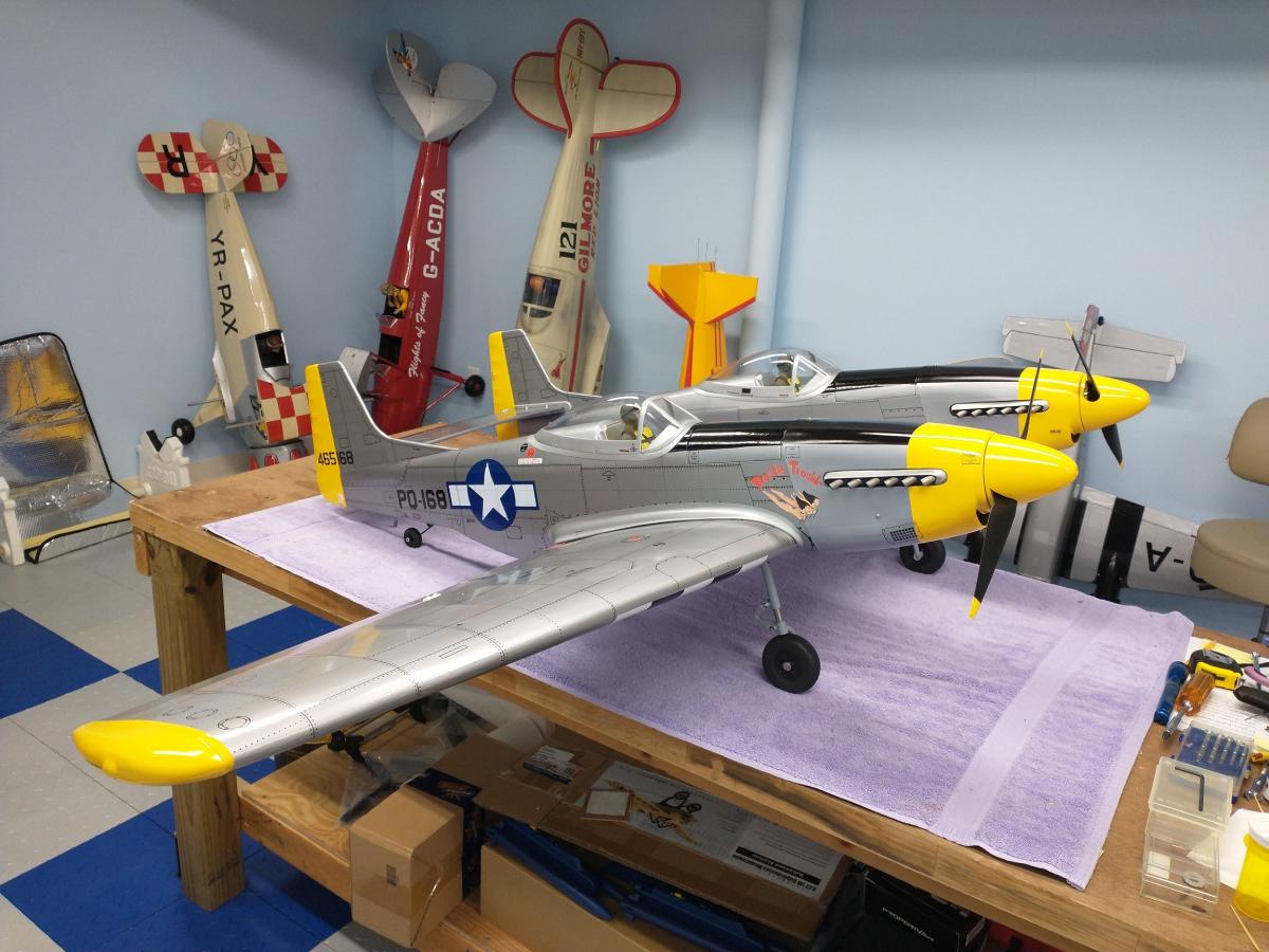

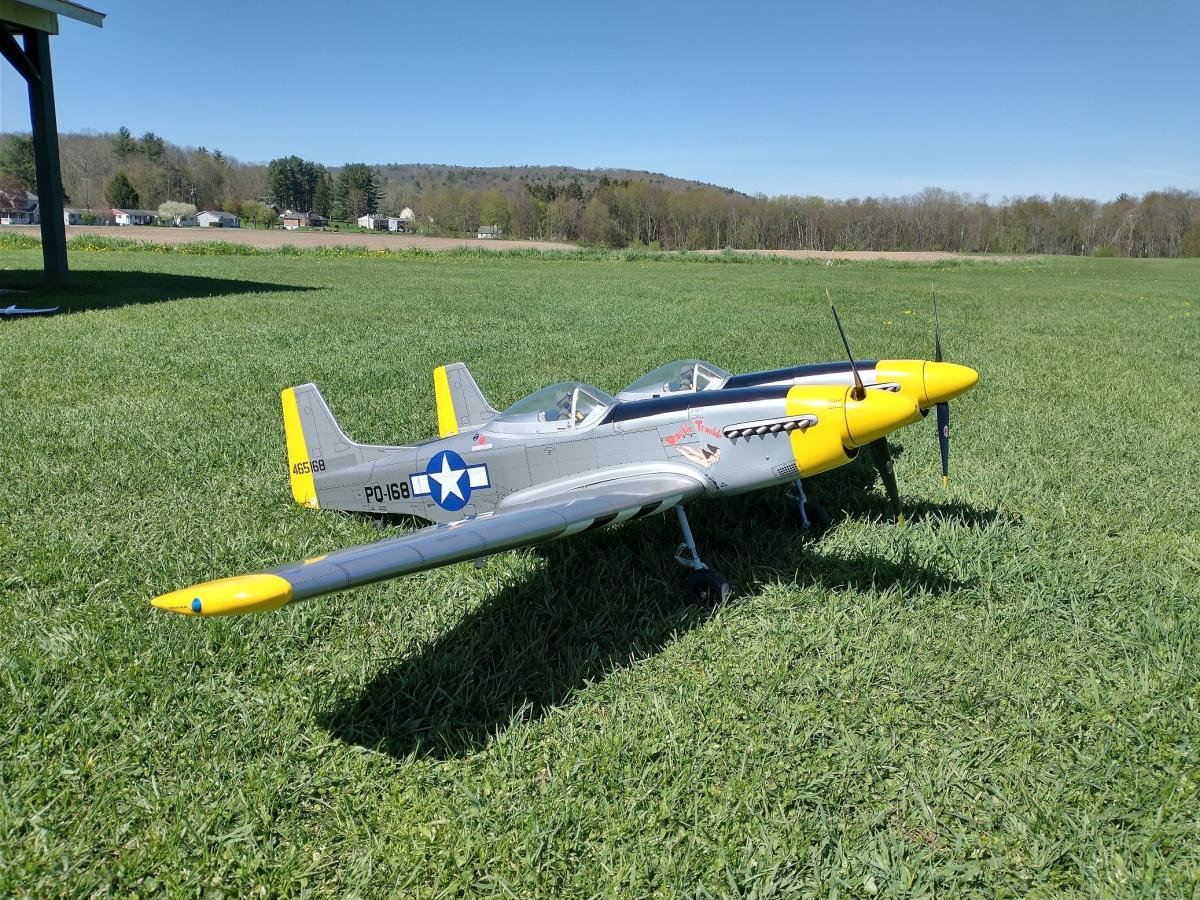

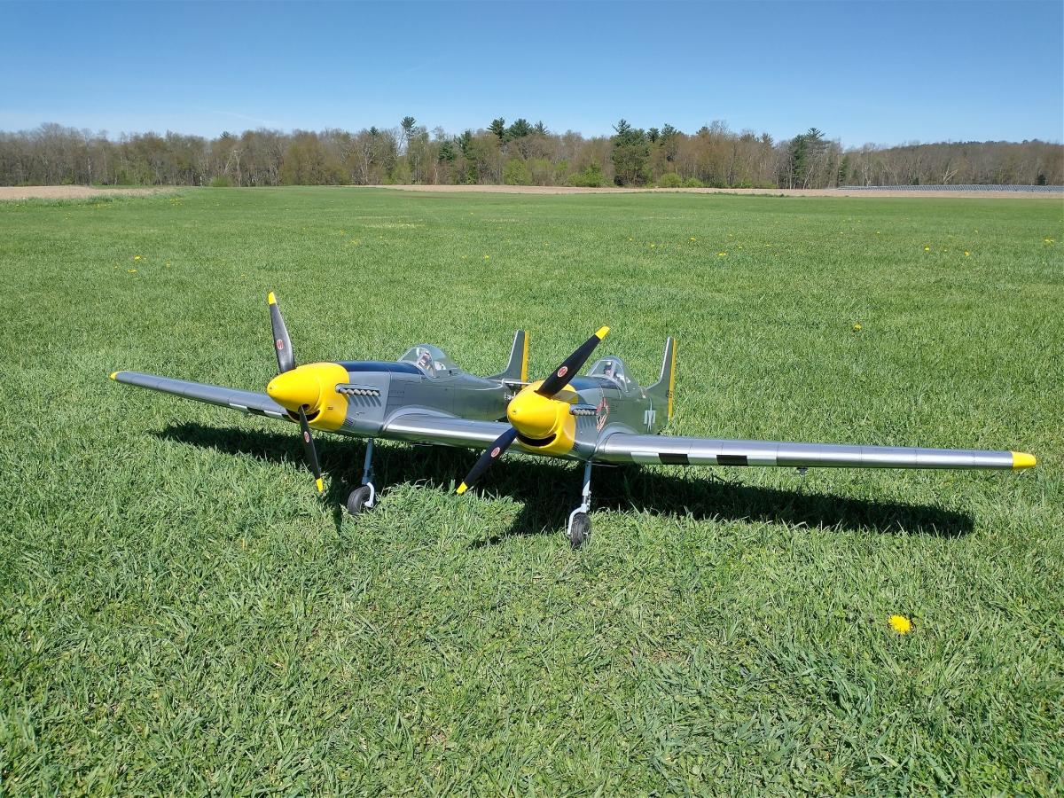

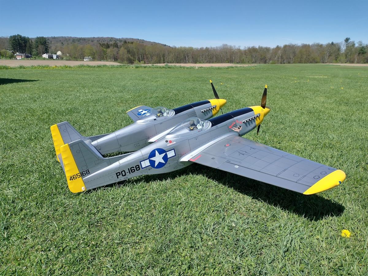

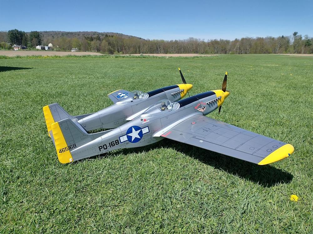

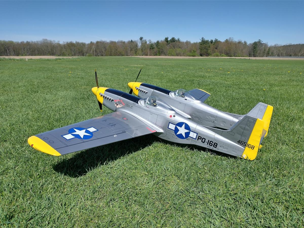

                                Got the maiden +2 done on the custom Nexa F-82 in the books. This bird flys great! Take off required a handful of right rudder, until it was on step. After that it was a joy to fly.
                                Click image for larger version  Name:	Out1a.jpg Views:	0 Size:	302.0 KB ID:	346963Click image for larger version  Name:	Out2a.jpg Views:	0 Size:	297.5 KB ID:	346964Click image for larger version  Name:	Out3a.jpg Views:	0 Size:	317.9 KB ID:	346965Click image for larger version  Name:	Out4a.jpg Views:	0 Size:	278.3 KB ID:	346966Click image for larger version  Name:	Out5a.jpg Views:	0 Size:	316.7 KB ID:	346967
