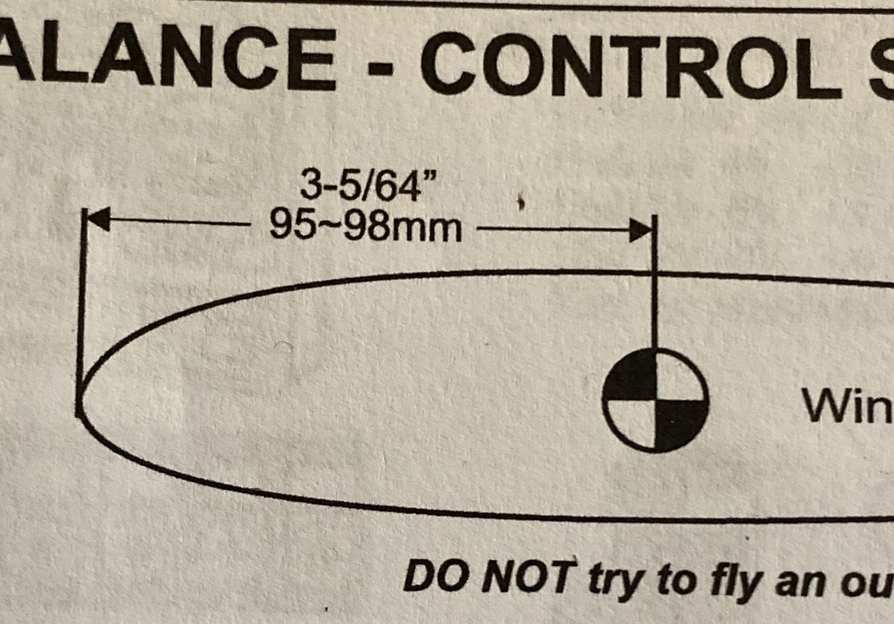

    I am currently preparing my P-82 for flight.
    Worried about that crazy mismatch of CG in the manual. Hoping somebody has flown this and can help me figure out the best match. I found one video online and the guy said he set it up to the manual and as it took off he says "oh, it is tail heavy"..

    Anybody out there with a useful CG for this? It is heavy already and my calcs show 1.125 lbs needed with 6S 4000 batteries on mine.

      Mine is balanced at 96mm with no extra weight needed. I'm using 2 ea. 6S 5000mah packs. I had to mod slightly to get them to fit. Flys great!

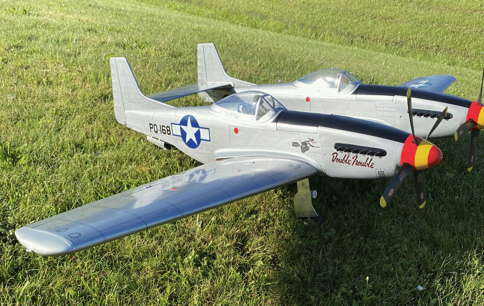

        Thank you! I really didn't want to add all that weight in the plane.
        I already added gear doors, lights, tailwheel retracts and 1.5" to the air scoop.

        Plan to maiden soon.
          #104
          With the two tail wheel retracts, you might need some nose weight to get the CG in range.

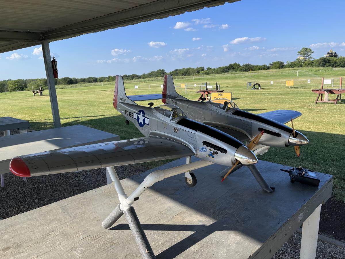

                I maidened my "Double Eagle" this evening plus two more 7minute lazy eight flights - Dual 6s set up with Aura8 stabilizer.....very smooth and docile. Lands as others report.....super smooth with flaps....Excellent model.....looks way more aggressive than it flies.....Another Happy F-82 pilot !!!

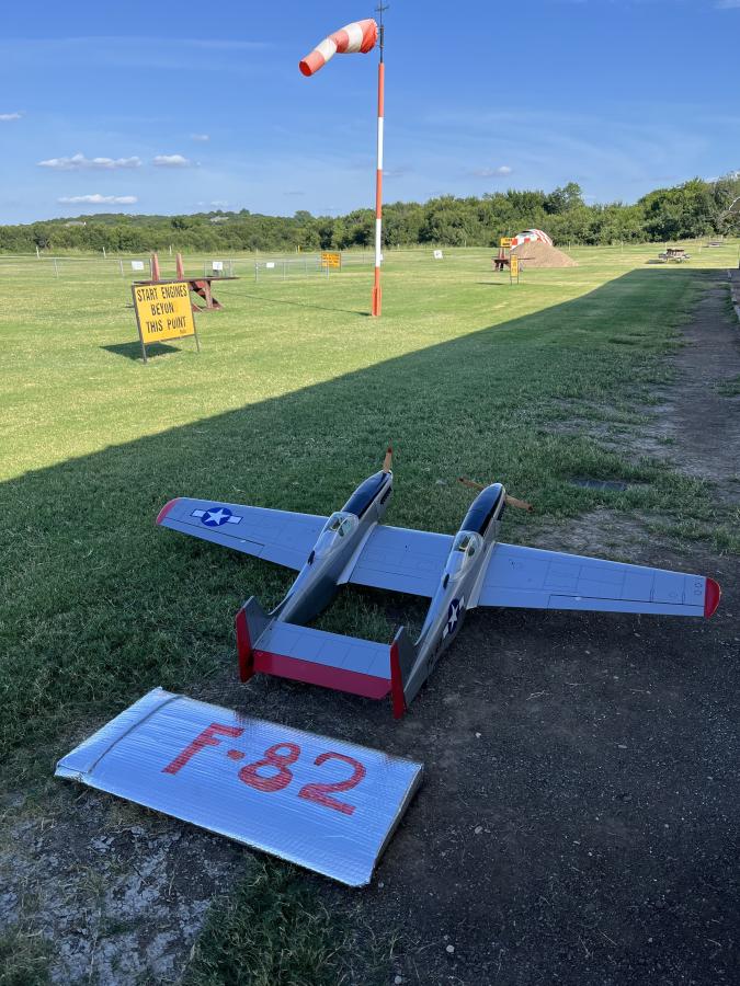

                      Wednesday 06-26-24 Left Side Pilot Captain Landon Gear was left in dismay after nosing over and breaking his port side prop - Right side Pilot Ed Propernaught maintained his composure as we await 12x8 XOAR PJA replacements
                      Having lots of fun flying this bird
