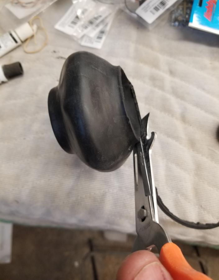

                                      #278
                                      sfcfury It's the Robart UX350 I believe. Whatever the same size of the stock ones are. And I use the stock rims. You have to modify the inner part of the tire, carefully cutting rubber, to make them fit the rim but if you take off just the flange they fit and work great. Here's a photo of how I turned the tire inside out to cut the flange. Again, be conservative with your cutting. Click image for larger version

                                        #279
                                        I'm very happy with how they perform. I did purchase the soft tires from HH but they were backordered, so once I received them I had already been flying with the Robarts and I see no reason to switch.

                                          #280
                                          me too.
                                          my robarts were old and when i took them out of the clam shell one of the rubber flanges was already worn through. so i did the same as you, i had to cut a little of the rubber that rests against the stock hub to make it fit correctly within the hub. probably because mine was 3.75 dia .25 larger than yours.
