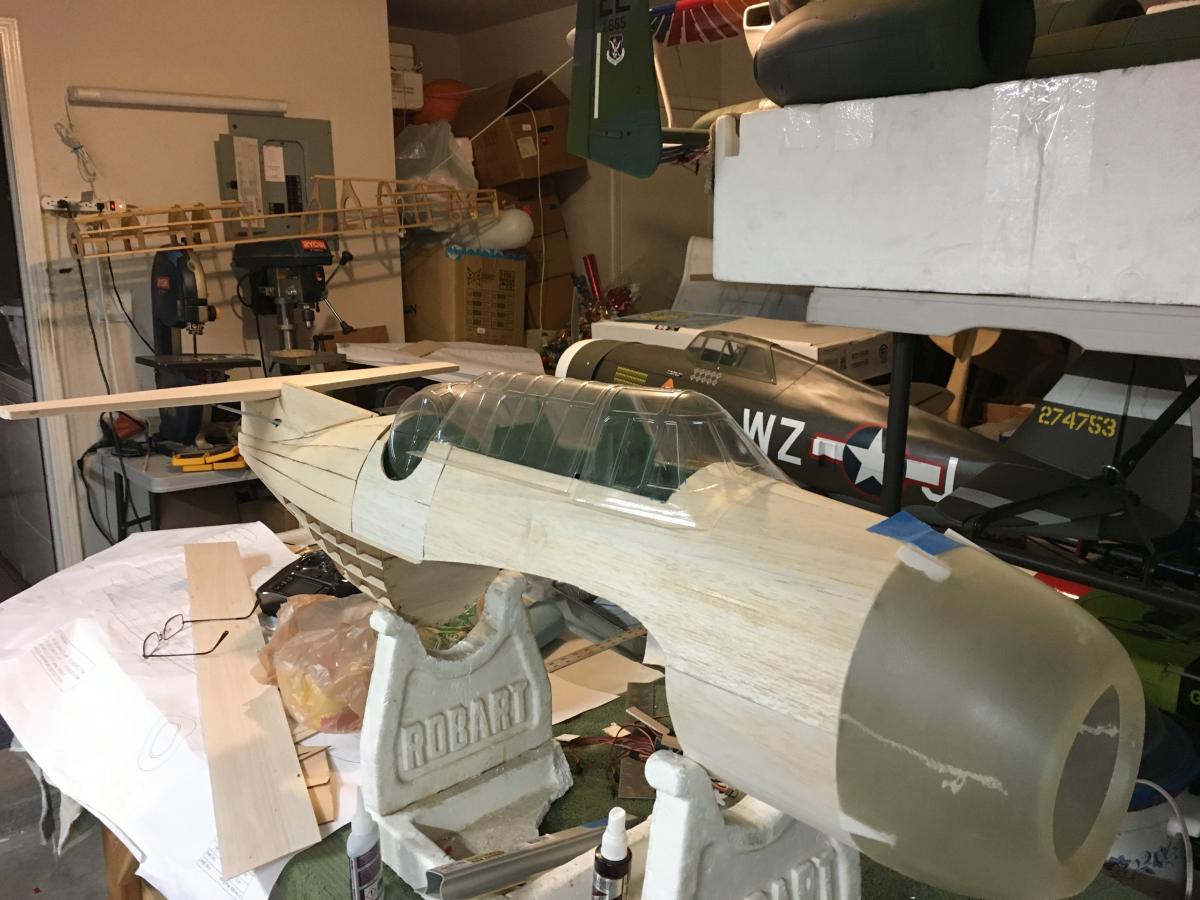

                Got the bottom rear skinned. Lots of Windex, colorful metaphors and gluing fingers to the sheeting. I filled all the "gaps" with tite- bond and started sanding this morning. I've got a bunch more sanding to do but I see the end is near as far as the fuse .Dry fitting the tail surfaces and they look pretty close. I still need to finish up the cockpit I may have found a source of 9th scale Navy WW II pilots and will have a better handle on that Monday. Weathers looking like crap for flying tomorrow so I'll spend the day in the shop.

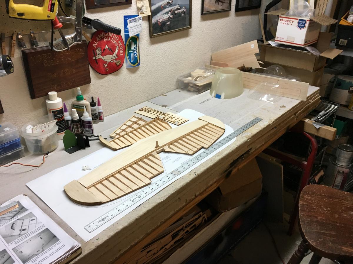

ID:	114641 Spent Thursday filling and sanding the fuse.I still have a long way to go to get it ready for glassing. Spend 2 hours "cleaning " the shop this morning. Got everything laid out for sheeting the bottom of the wing. Feels great to make progress and hopefully finish this up and get it in the air.

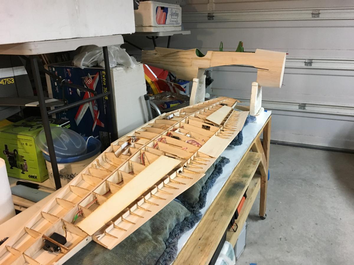

                                      Worked on the Avenger some more. Getting ready to finish sheeting the wing and fitting it to the fuse. Elevator and rudder servos are in and while I'm not a fan of nyrods I had no choice.I think I managed to get them pretty much slop free. Still a long way to go. My graphics came in from Callie and I'm waiting on a order from Balsa USA for some fabric ( for the elevator ,rudder and ailerons ) Poly tack and filler. Think I've got enough .56 glass to get the wing a fuse done.
