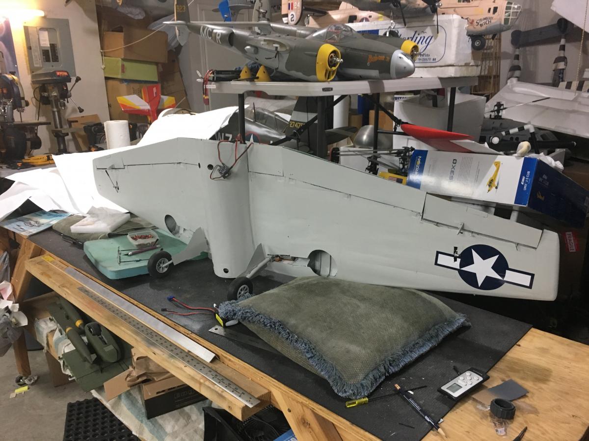

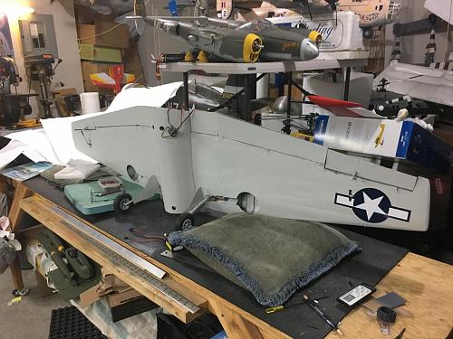

          Just finished working on the fuse. the end is in sight.
          Mike

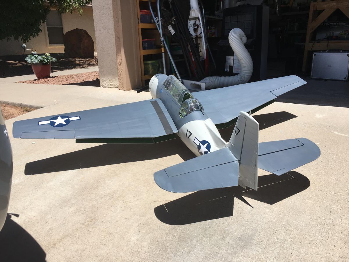

              #146

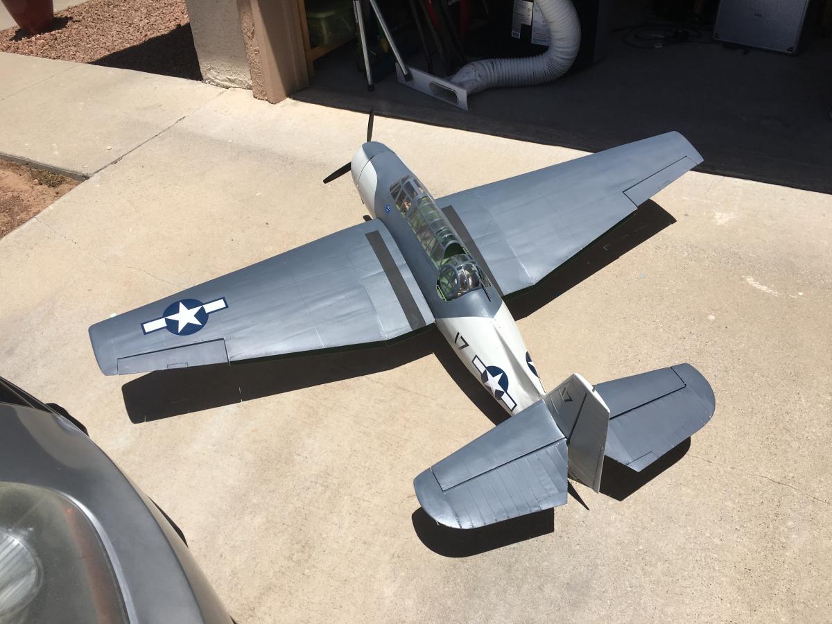

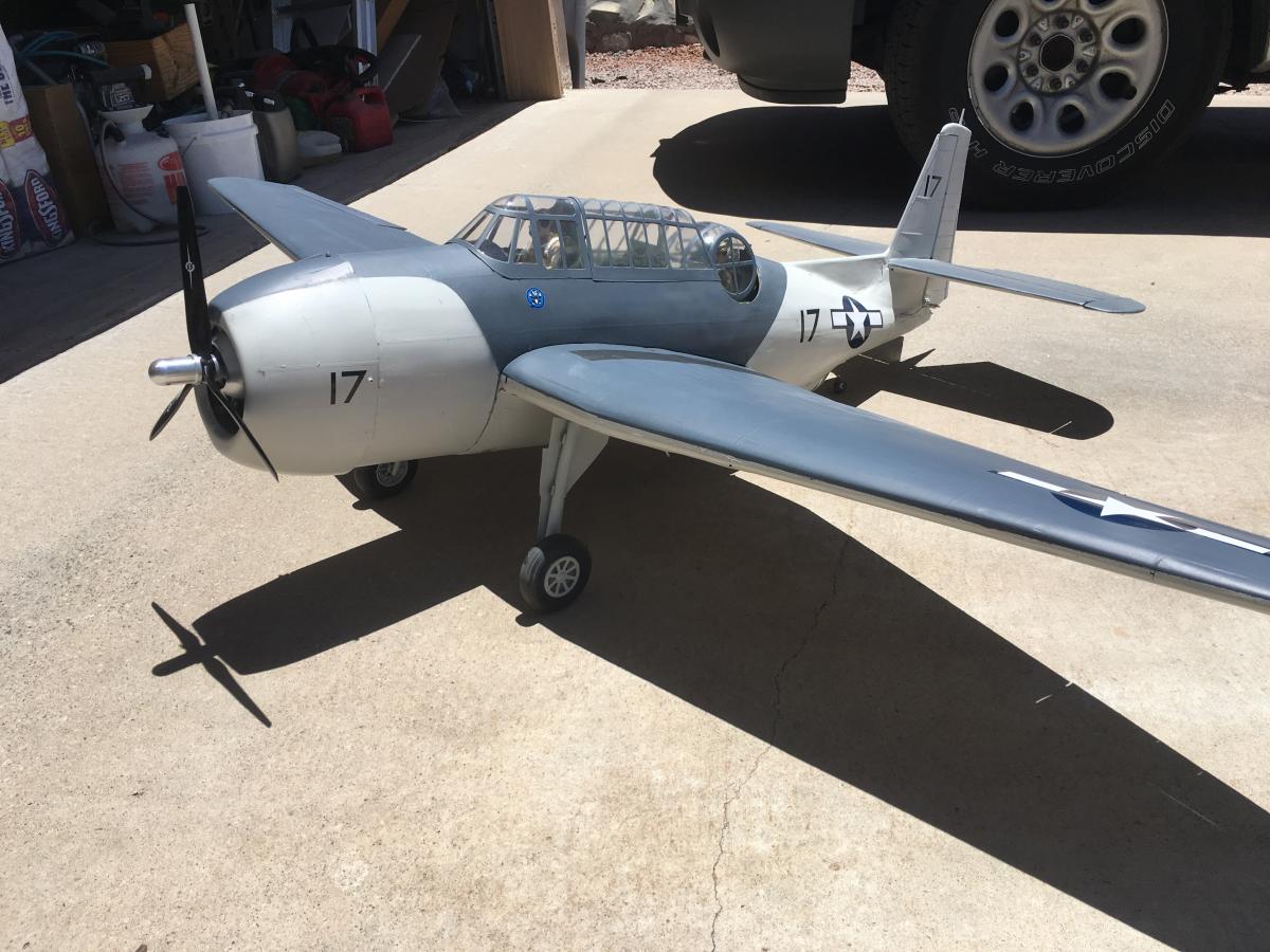

              So here it is got a couple of issues to resolve but anyone who builds knows that feeling. Pretty light and should balance. Test hops coming but the conditions will have to be right.
              Mike Click image for larger version

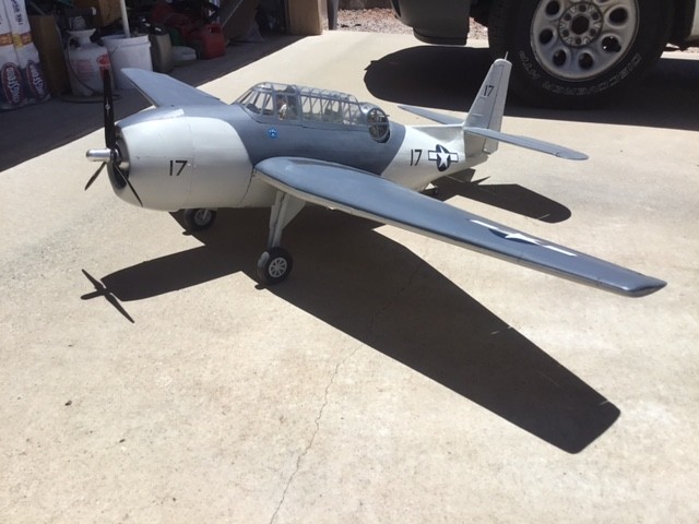

                                #155
                                I really like my Skyshark Avenger. The rights to the kits were purchased and supposed to be in the works. I'd love to do another one.
                                Mike

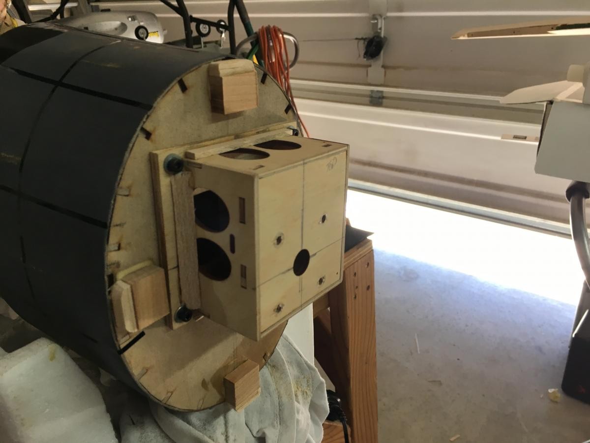

                                        #159

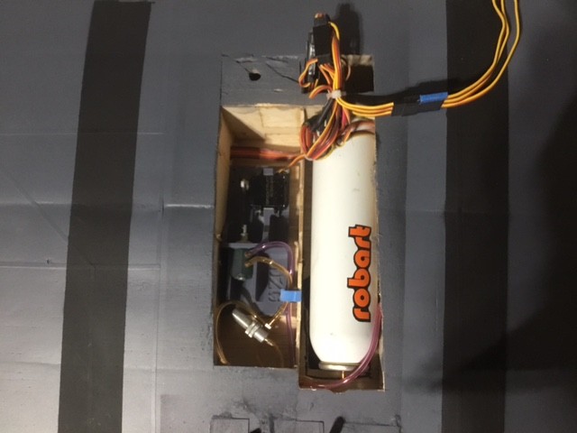

                                        I manufactured a box and cut the existing firewall to get the battery all the way forward. I have to remove the wing to access the battery. Kinda a pain in the a$$ but I didn't see cutting up the fuse for a hatch. I'll post a picture of how I handed all the retract stuff in a bit.
                                        Mike

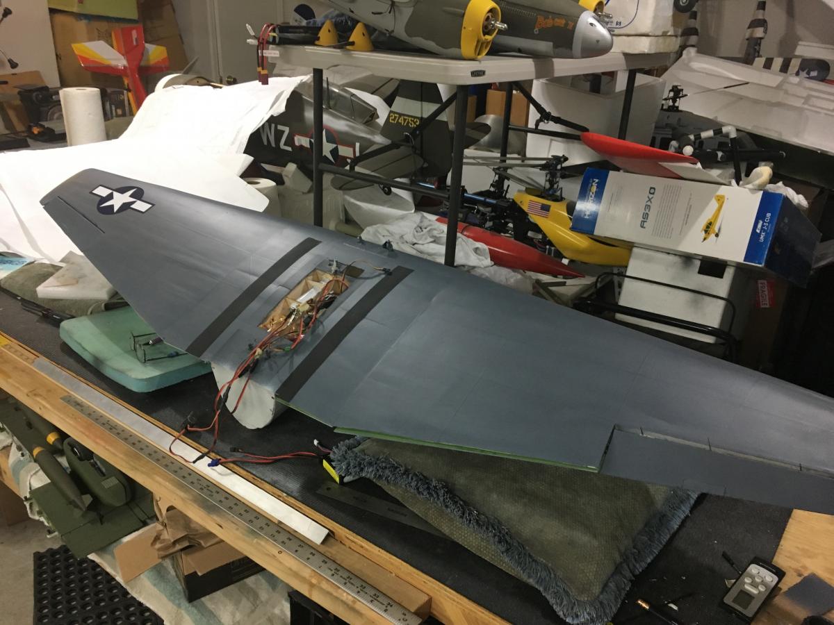

                                          One the wing everything is mounted in the center section. I use a harness to avoid having too many leads to deal with connecting to the fuse.
                                          Mike
