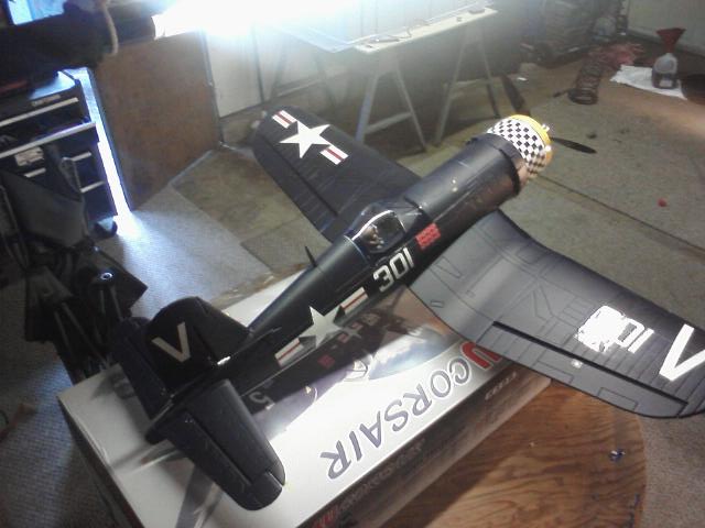

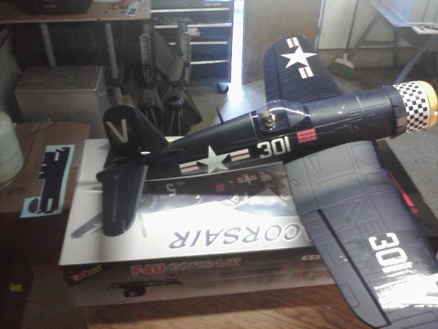

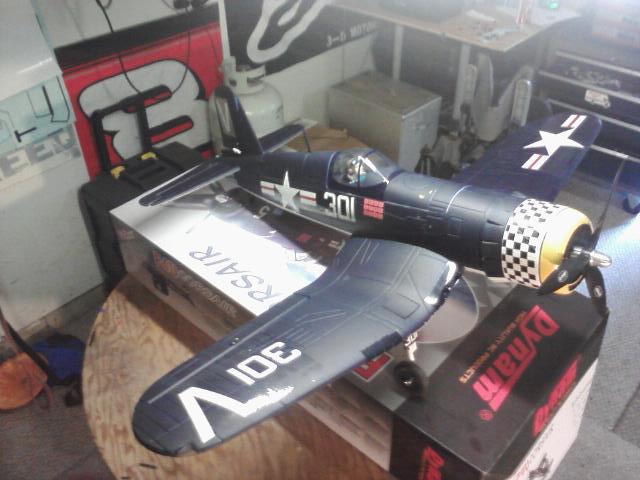

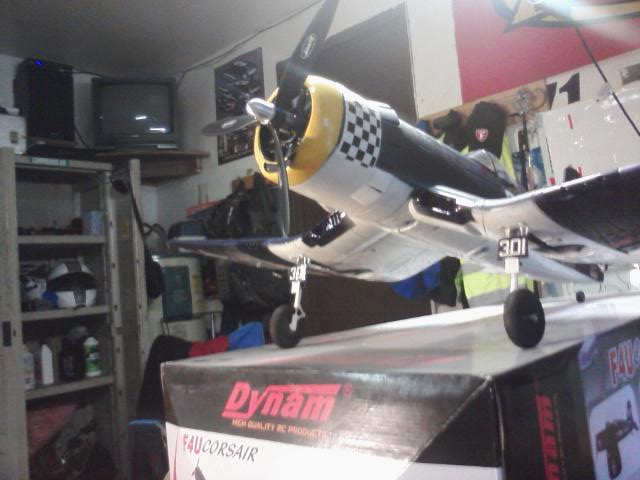

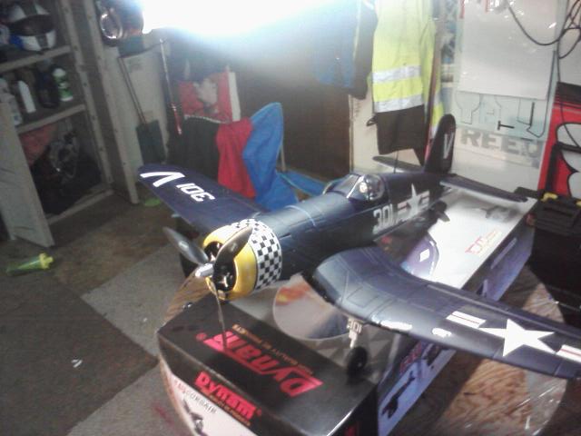

            Well a rare 2 days off in a row, and normal Pacific NW weather for this time of year. (RAIN) Gave me a chance to getter done. I'm very PLEASED  :D  The white bottom should help with orientation and its authentic.  Now all I need a a sunny day.
            I chose the Dynam Corsair over the FMS Corsair for 2 reasons. I was not impressed with the landing gear doors on the FMS plane. Every time I landed a little hard a gear door would pop out of its pivot point. I dont know if it was just me or the plain, but I was always fiddling with them. The Dynam plain dont have gear doors, I like this. Second the landing gear struts on the Dynam bird will except FMS P51 shock absorbing struts. The wire on the Dynam bird is 4 mm thick, Just cut them off leaving a stub, grind a flat spot on the stub sticking out of the retract. Then simply slide on the P51 strut and lock it down. TA DA!! Rotating shock absorbing struts and of course, 2 3/4 DAVE BROWN shock absorbing tires will top my Dynam Corsair off. At the moment this is all theory, and appears plausible. Going to try it as soon as my new dremel cut off wheel arrives. Still have the retracts from my first Dynam Corsair and will be experimenting with those ones. Will keep u informed.   :cool:

              That looks great Fly Boy!!
              You've got me leaning towards the Dynam Corsair now. Cant wait for your sunny day to get a flight report!

                RE: Dynam F4U Corsair
                The white really sets it off. Where did you get the graphics for the cowl and fuse? I'm also waiting to see the gear mod when you get done. The suspension struts would be nice.

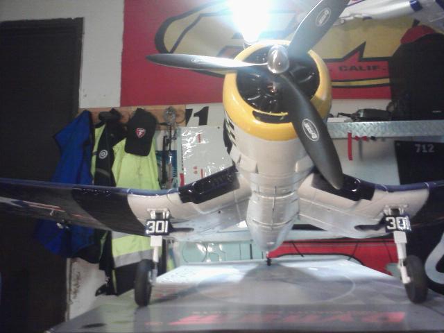

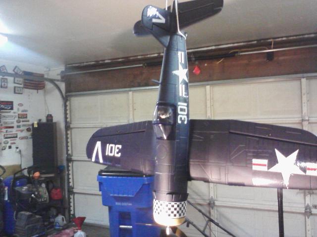

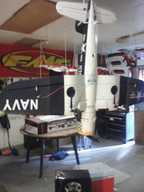

                    When I ordered the Dynam Corsair I also ordered the FMS Corsair 1400mm graphics. The FMS 301 graphic look I like much better than the number 5 graphics. There also bigger and stand out better. I did mix it up a little and applied the Dynam Navy graphic on the bottom wing.  The cowling is covered in checker board mono cote with sticky backing from your local hobby store, and the yellow trim on the cowling is testers model paint. The white paint I used is from the local auto parts store. Its called 500 degree engine enamel. It does NOT eat the foam whats so ever and leaves a HIGH GLOSS shine.
                    The retract mod failed. Only because the P51 strut in longer. :(  I could mod and cut the shock housing with a chance that it may not work either. But I dont want to wreck the shock for that because on the brighter side, I did find that the Dynam F6F Hellcat retract wire are the same length as the P51 strut. I know this because I have a set of the Dynam F6F retracts on my shelf. I had them as spares for my first Dynam Corsair. Same retract so the the wheel wire is interchangeable. So theres a way better chance the P51 strut can be made to fit on the Hellcat. In fact I'm sure of it. The Dave Brown tires are a perfect fit as well. Happy landings from the Pacific NW, Looking forward to the first sunny day with no wind so trimming will be a breeze, HA    :P

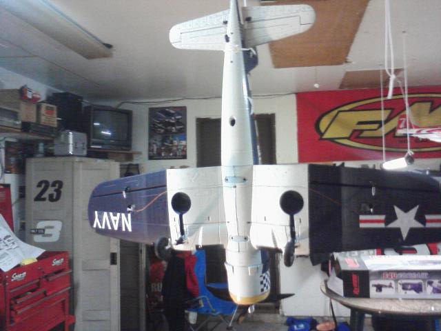

                                Greetings from the Pacific NW,   :cool:  Got my balancing issue with my Corsair taken care of. Up on inspecting my Great Plane CG balancer, found the right side pivot point binding and stiff. The ball socket had plastic debris in side. A little cleaning, and some dry powder graphite, good as new.
                                Put the Corsair on the balancer with Admiral 4 cell 4000 mah batt installed. PERFECTO!!! :D  Slightly nose heavy.
                                Then installed the Admiral 4 cell 3000 mah batt, WOW ! Tail heavy! It took exactly 3 ounces of lead to get slightly nose heavy. No wonder the 4000 mah batt worked so well.
                                Went to the airfield, Plane set up for the Admral 3000. Flew much better, But needs a prop change.  To slow and no power in a climb. When I pull up to climb, runs out of power fast, then tip stalls towards earth. In order to get a nice loop, haft to power dive first, then pull up, and smooth in to a loop. First going for a prop change to a 14x12 single blade. If its still not enough, then going to make a motor and ESC swap. Over all though I'm good with the plane. Both my P51's are very fast and would eat the Corsair for breakfast. Happy Landings from the Pacific NW   ;)

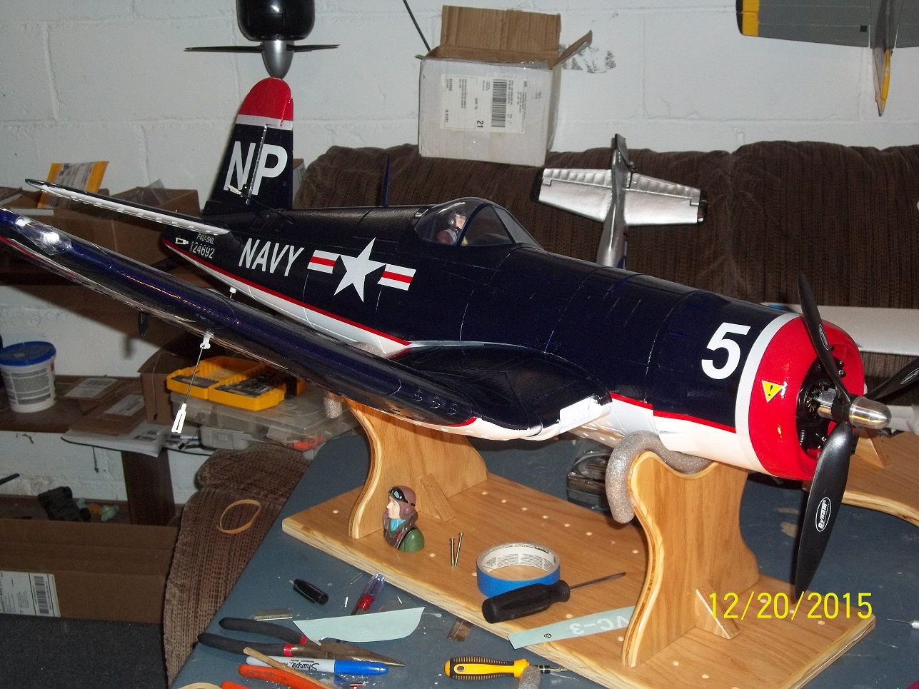

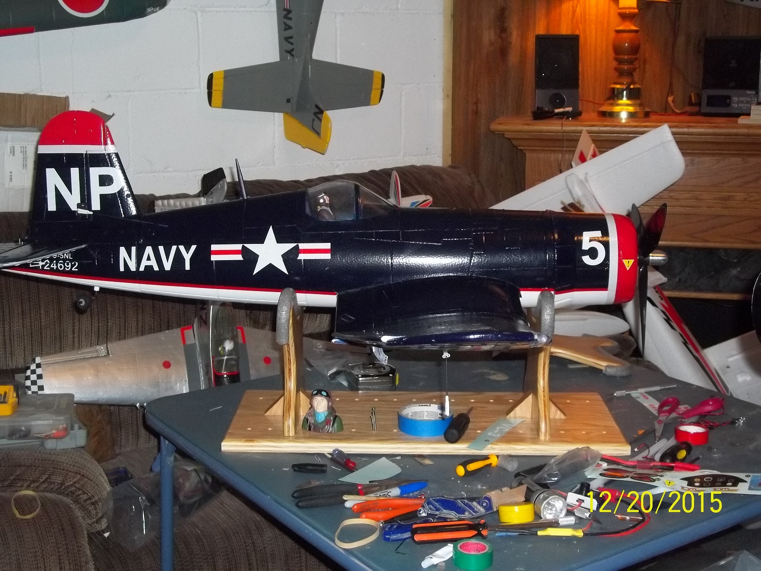

                                    Finally decided on the Dynam Corsair.
                                    Here's the build so far. I'm waiting on the retracts from the 1400 FMS Corsair. Also trying to decide if the smaller pilot looks better than the one supplied
                                      WOW!  :D Its looking really good! Really like the red trim and detail. You are so going to enjoy the white bottom when in the air. When I lose orientation, I just barrel roll and quickly regain my sight. Nice job Capt! I am currently working on my winter build as well. Dynam Spitfire. Fully modded for SPEED!, Pics on the way.   ;)
                                        This really looks good. I like the paint job. What did you use for the finish?
