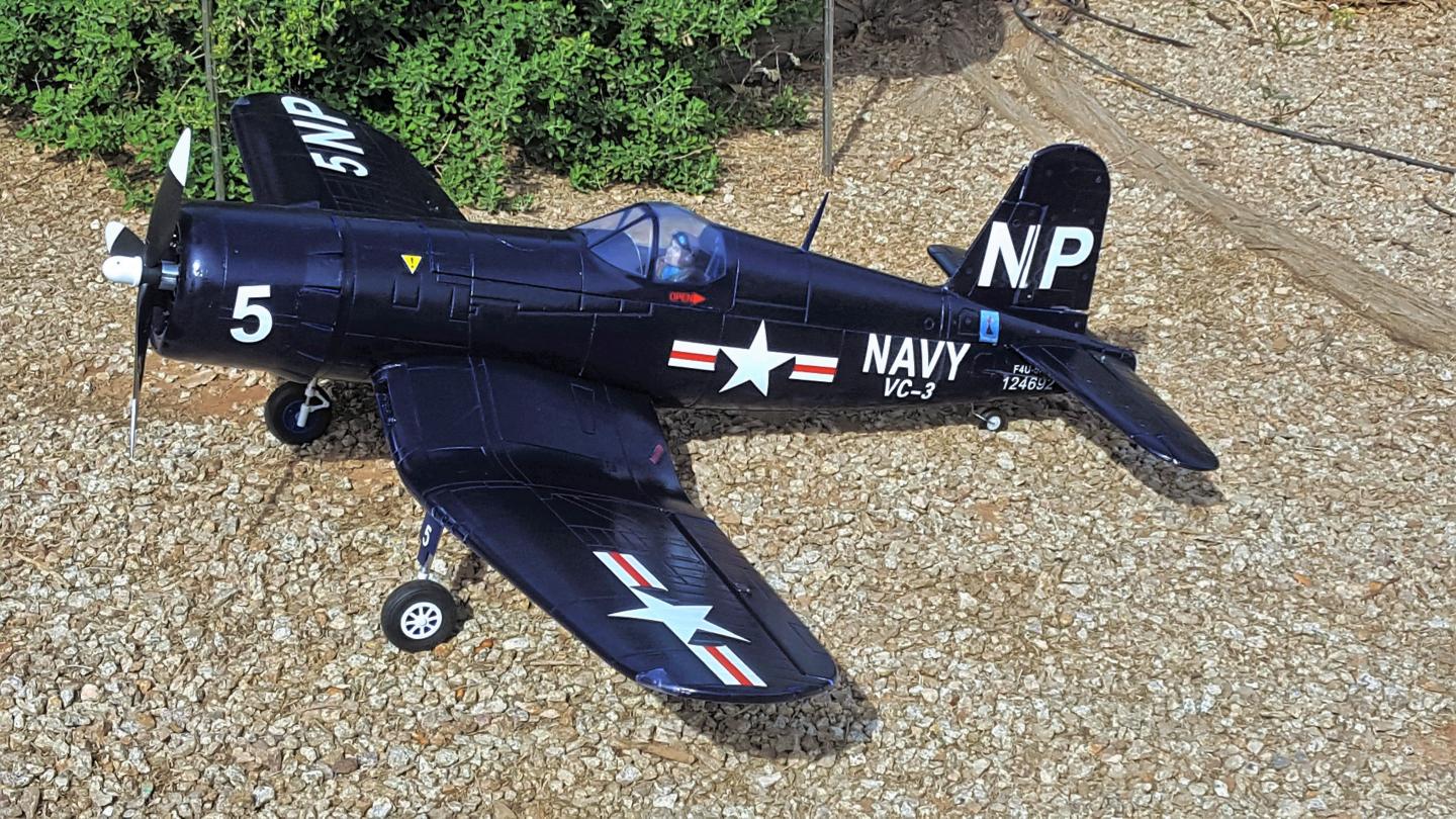

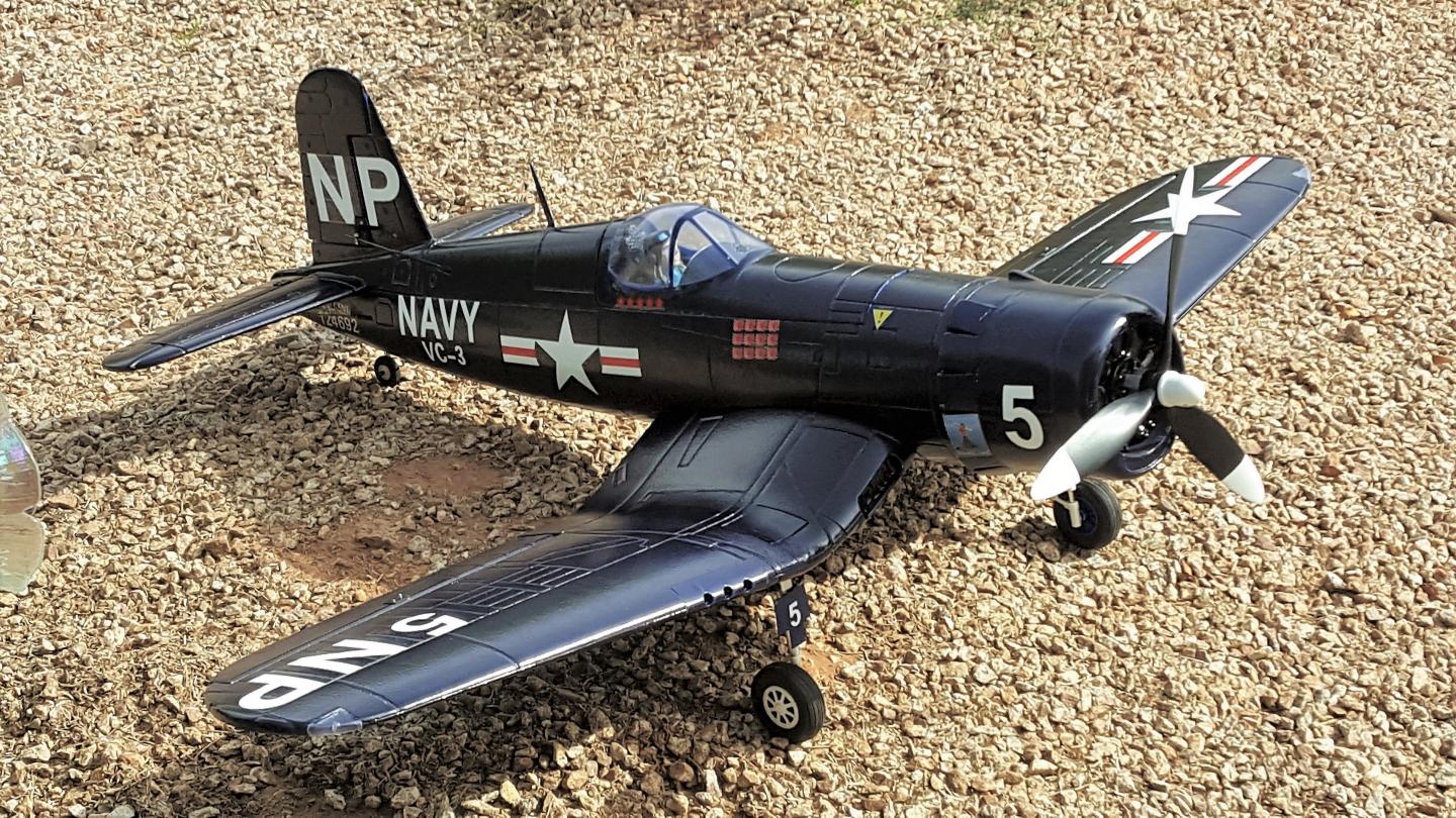

                        #111
                        Thanks Hippie 64 ! I'm more of a rattle can guy, never tried airbrushing. I'm just brushing on with the foam brush. Went with the Minwax (semi gloss) and just finished the first coat. Doesn't look bad, but I'm going more for some added protection then looks. ;)

                            #113
                            Finished the last (3rd) thin coat about 10:30 last evening. Very nice protective coat. Almost feels plastic like now... me likes! :Cool:
