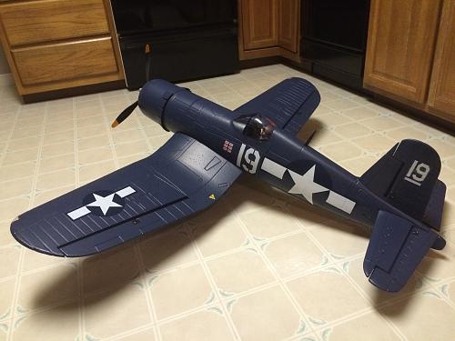

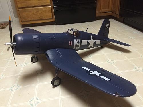

                                Originally posted by Jody Shaneyfelt View Post
                                I was wondering if the Dynam Corsair comes with the decals applied or if you put them on yourself?
                                I would like to do a Baa Baa Blacksheep copy that is just navy blue without the #5's and the navy lettering and just has the american insignia.... I'd have to paint the red stripes in the American insignia white to make it WWII correct...
                                I can't find any unboxing videos for this bird to see how it ships...
                                Thanks,

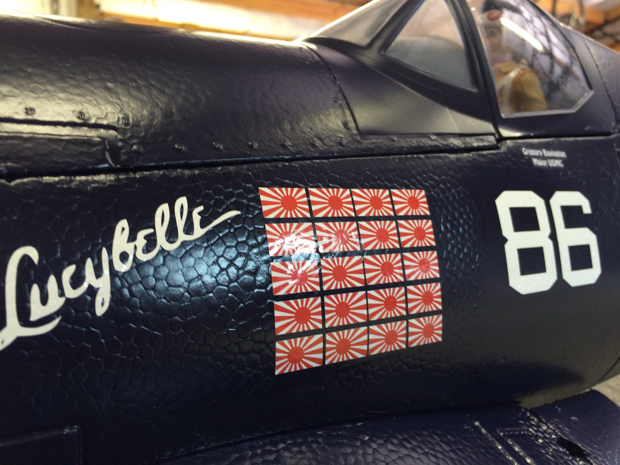

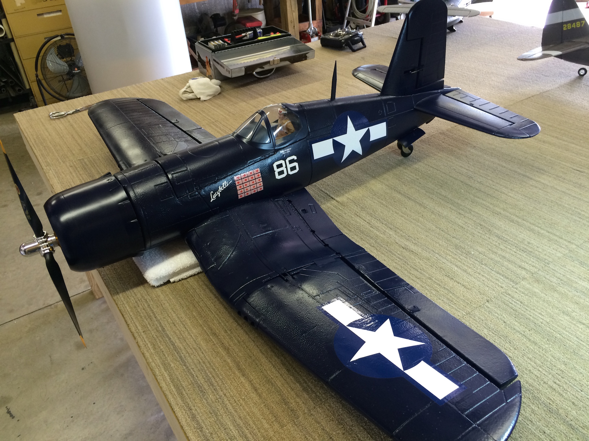

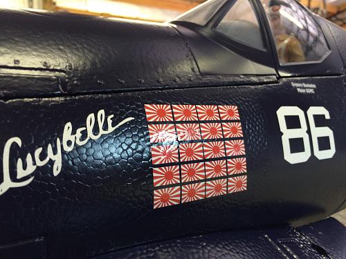

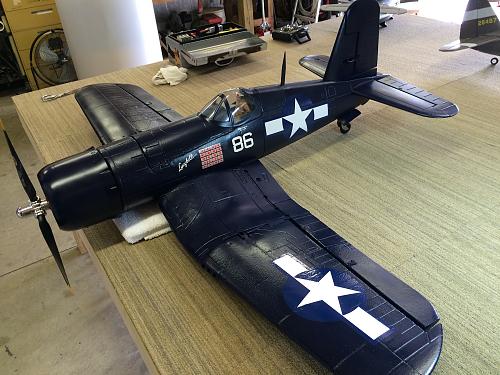

                                I did mine like this and just ordered graphics for the Dynam Hellcat.
                                On my 1600mm Corsair I used Callie for the graphics...http://www.callie-graphics.com

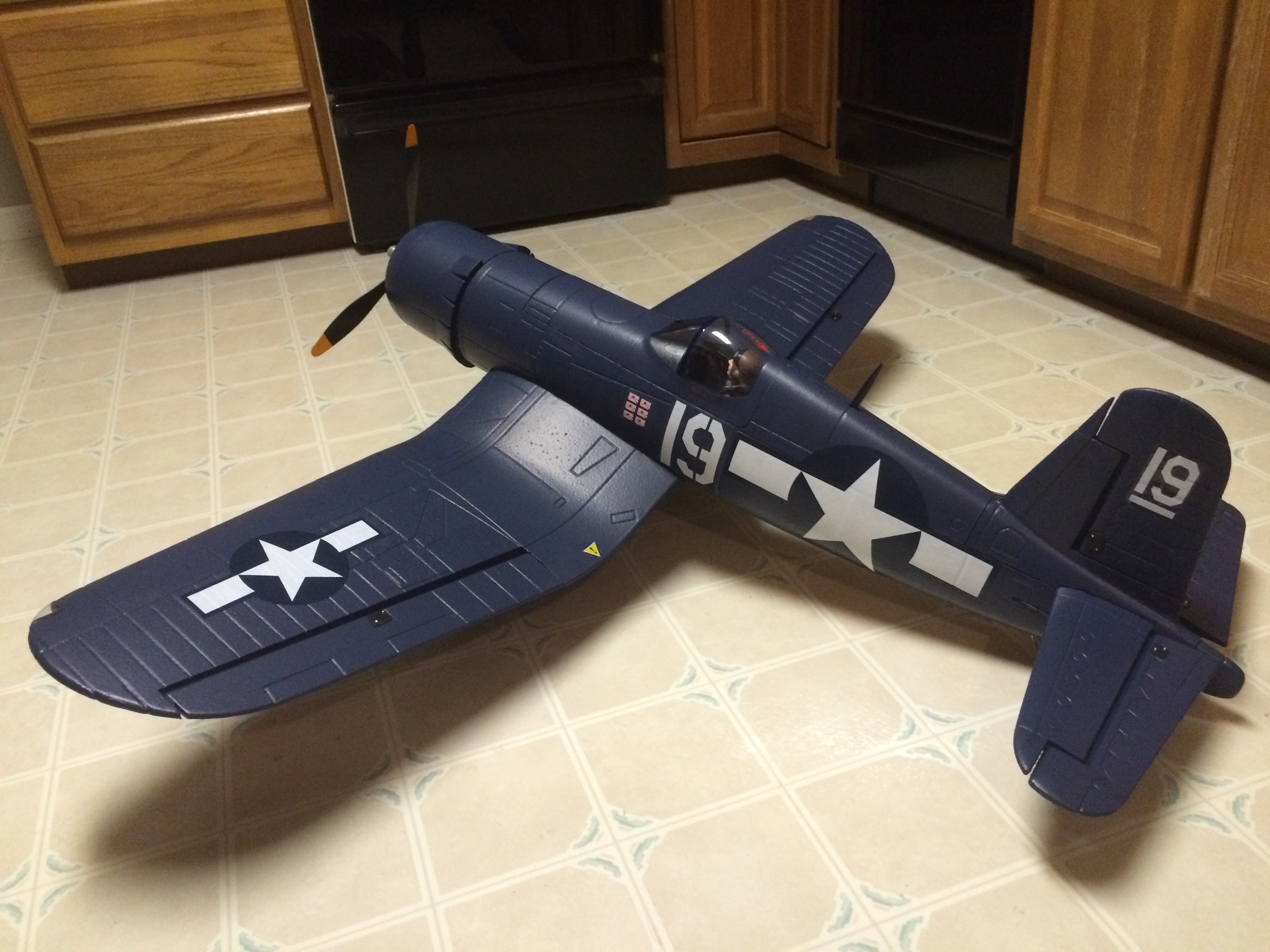

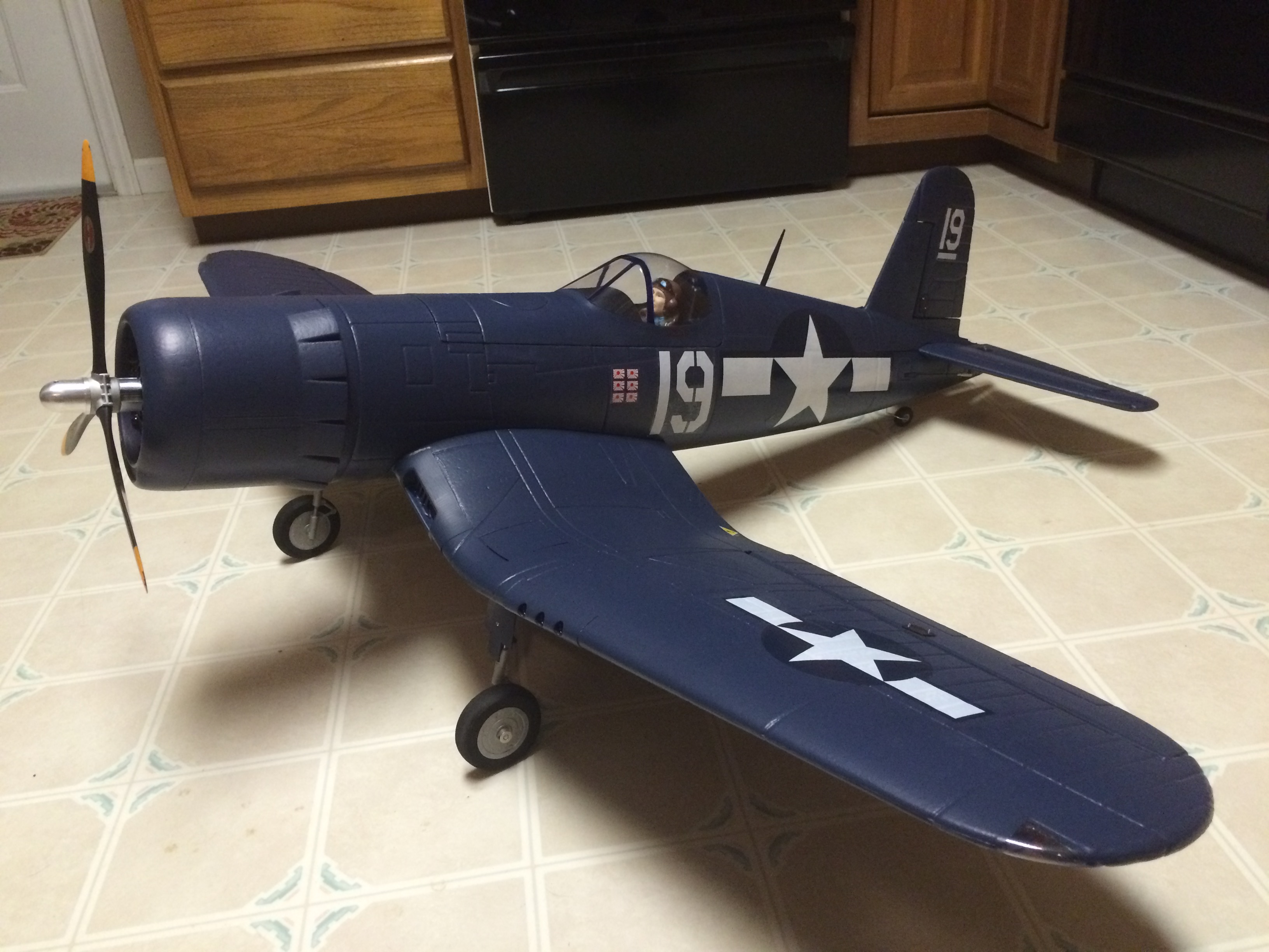

                                    These are my Dynam Corsairs. One with factory decals except for the arrow on the the right side wing. The other has the 301 decals from the FMS version. Rdd I fly at the Clark County Fair grounds. They have an AMA field there with a paved runnway. And no neither one of my Corsairs like the grass, even with over size tires.
                                    Pacific NW Flyer  :arrow:
