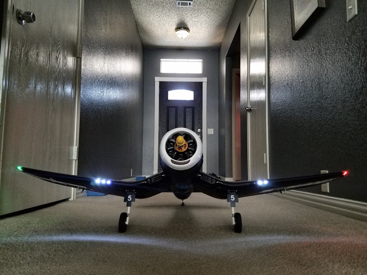

                                  • uuc328
                                    • Mar 2019
                                    • 11
                                    • So. Arlington, Texas USA
                                    #137
                                    Machine gun lights.

                                      Originally posted by uuc328
                                      Machine gun lights.
                                      Looks Awesome man! I have two of these, one still in the box.

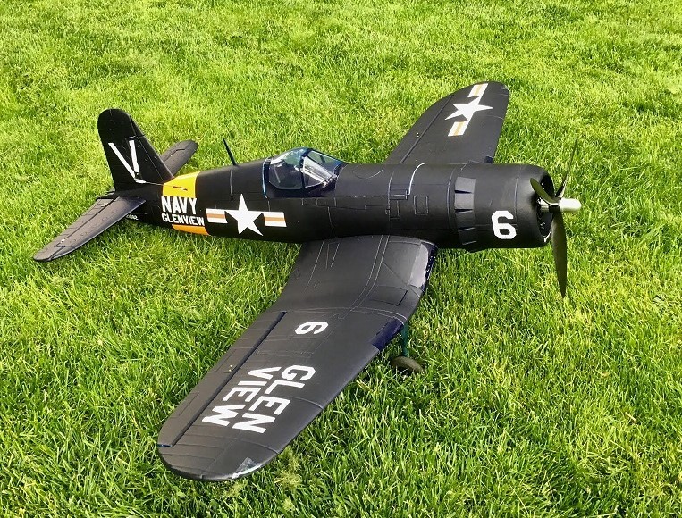

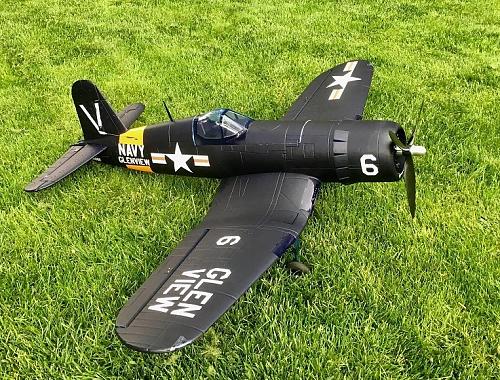

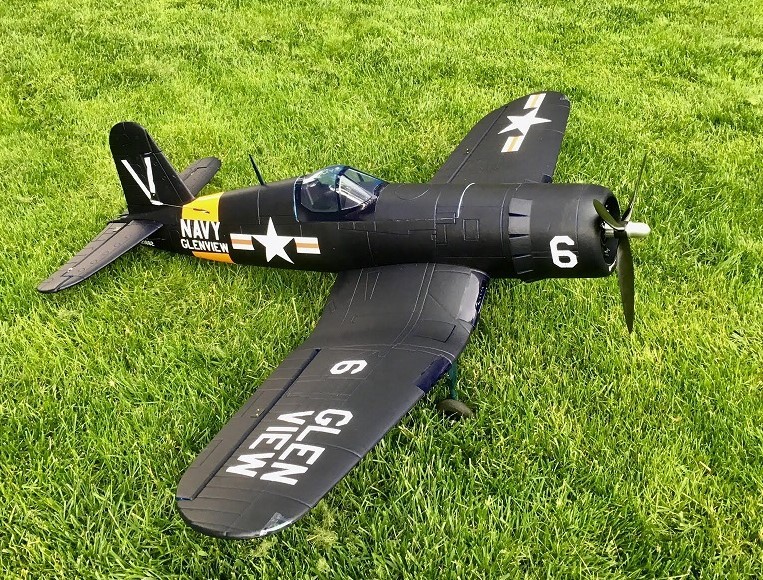

                                        I purchased the Dynam Corsair this past winter. I haven't flow it yet, when I'm working its sunny, when I'm off its windy and raining....Chicago weather.....:Crying:
                                        Callie Graphics NAS Glenview IL livery.
