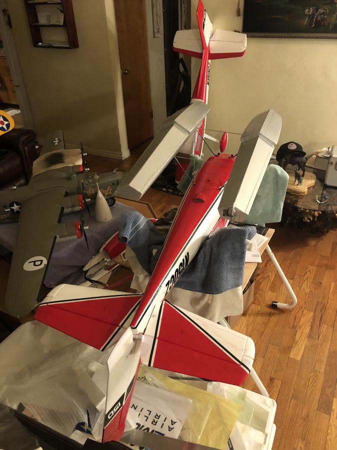

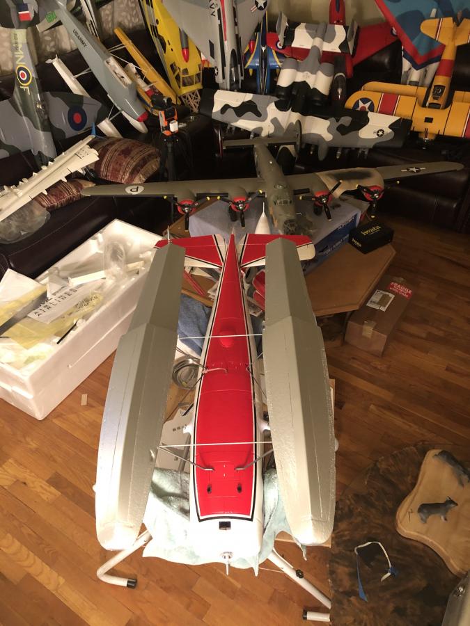

Just did some Painting and maintenance on One of my 2.1 Cessna 150's and added a little more Color on the bottom. Also glassed and painted the bottom of the Floats. Flying off snow for the past two years ass taken its toll on the Foam. The snow its like a fine sand paper. The Snow will even sand it's way through 3M packing tape after many touch and goes. This will be the third season flying this one off the lakes and Snow The other one I love doing main gear touch and goes with out ever letting the Nose wheel touch down for 2 to 300 ft on paved runways. The Cessna 150 is a blast to fly no matter what type of surface I fly it from. Snow, Water, Grass or Pavement.

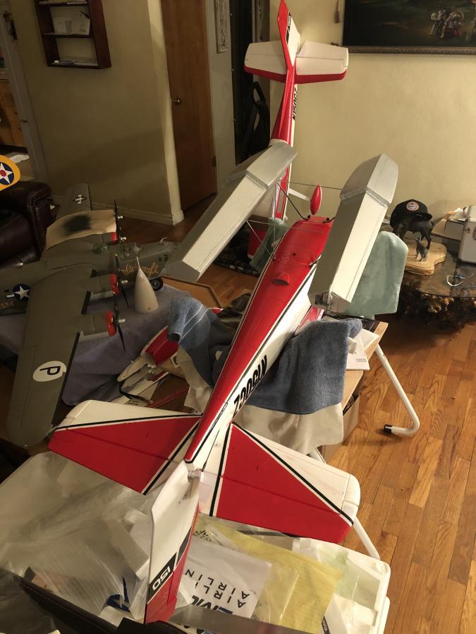

I do love painting and normally I enjoy the final product of my labor but this model was the biggest pain in the rear I have ever attempted to repaint. That stock red livery was a bear to primer accurately...The repaint looked just "okay" I suppose from several feet away but up close it was really bad. I was ashamed. LOL! Trust me, the photos don't the issues.

I know this is a much older post, but still relevant. I may have screwed the pooch when I removed the decals and then started using acetone to carefully wipe off the red paint. Some of the acetone wiped where I pulled the decals and now it is a true mess. Can't go back now. I put a coat of polyurethane in there and now waiting for it to cure. You mentioned somewhere that you use a foam filler of some kind to fill in and then sand smooth. I am foam illiterate, so what was the brand? What grit paper did you start with? I hope this project doesn't come back to bite me. lolComment
althepal88 I can remember the exact brand name that seems to be popular but it's an ultra lightweight spackle for the foam filler. And I would use 320 grit sand paper. The RCGeek has a video on YouTube on refinishing foam airplanes, actually a couple of videos that are worth the watch. Good luck!Comment
