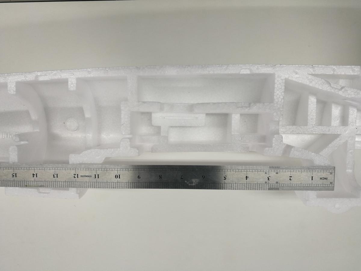

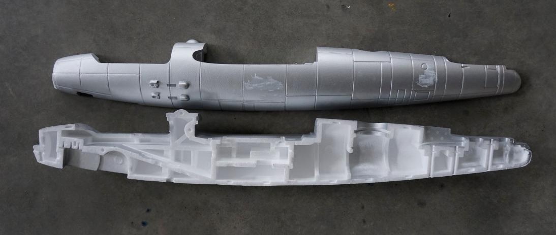

          Speaking of mods, Bob, here is a picture I took yesterday here at the factory of one of the scrap fuselages, showing the internal layout from nose to tail. It's easy to see what's necessary and what can be removed. This should helps guys like you and Adam plan your mods. You can see what's inside the fuse first instead of cutting in from the outside without a clue. Attached also is an earlier photo with a ruler as a reference.
          Who else provides this kind of [literal] insider info? ;) I can't wait to see what you come up with!

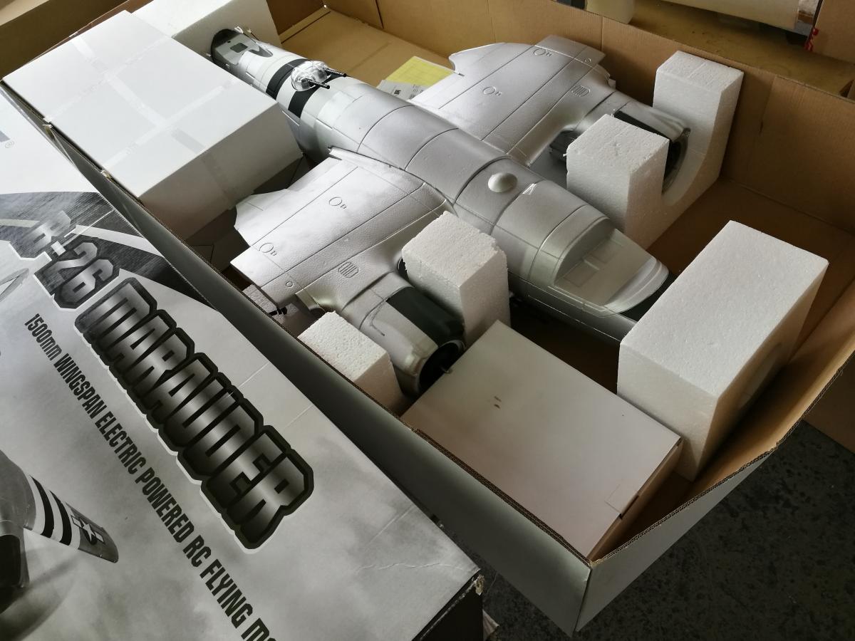

            • Another good day at the factory. Here's a photo of the box showing how the model will arrive. To simplify assembly, the nacelles arrive completely pre-assembled! The ESCs are in the nacelles, and the motor/ESC/retract/inboardflap/battery wiring is already routed into the battery bay for you. Assembly is therefore very straightforward: Remove the fuse as shown, screw on the outer wing panels, screw on the tail, and you're done with primary assembly.

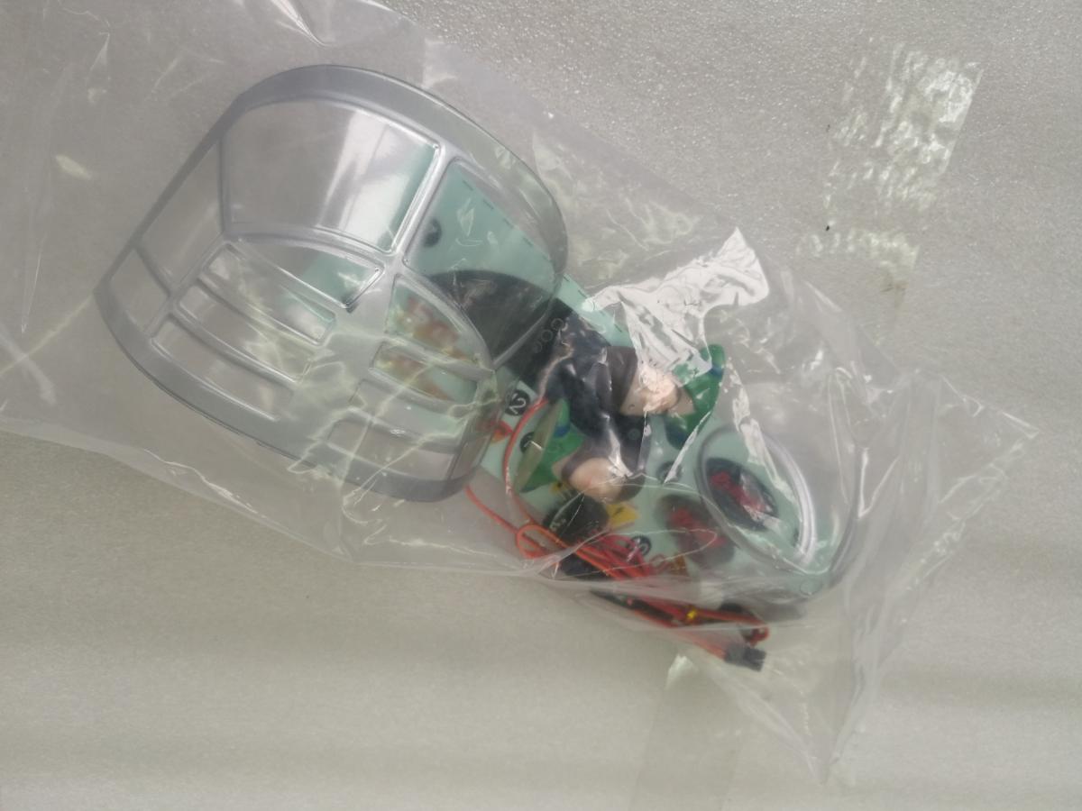

              The canopy, nose cone, and tail cone are unattached, giving pilots the option to customize/detail those areas before gluing on the plastic covering pieces. So for those of us who don't like the pilots, you don't have to glue them in. Repaint, or replace, or ditch altogether. Creating an all-new pilot mold for this aircraft was not in the cards at this pricepoint (we already did all-new motors and CR props for this bird), so Dynam is reusing existing pilot figures.

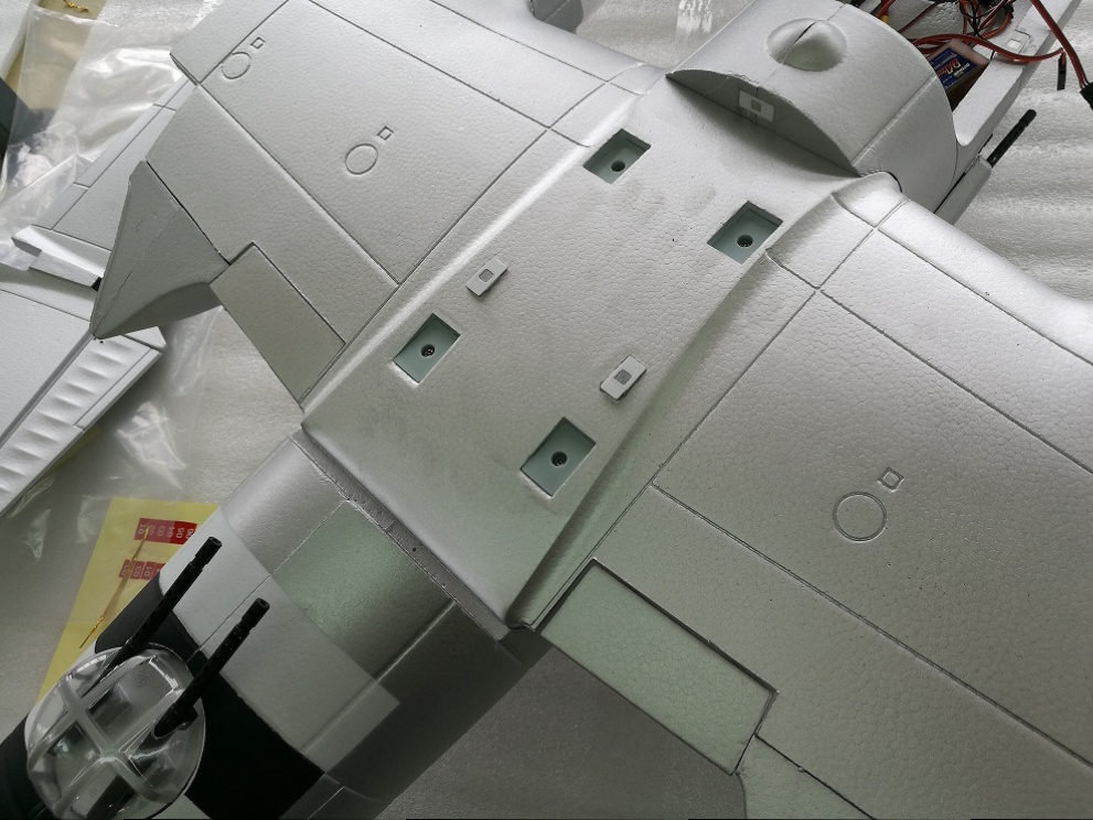

              If you ever need to remove the main wing for whatever reason, be it centering the Elev/Rudd servos or slicing in a bomb bay, etc, first remove the magnetic hatch that comprises the upper fuse over the wing:

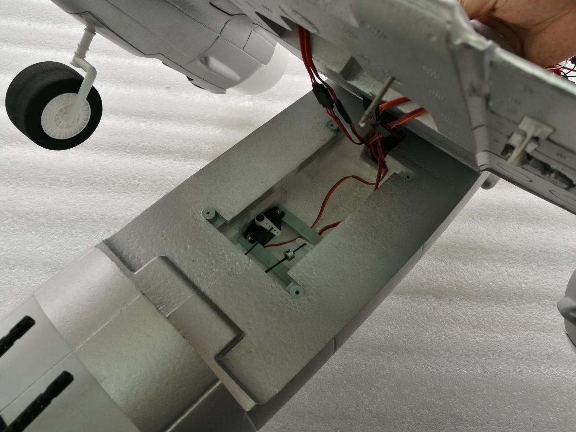

              And then unfasten the four screws, and lift up the wing assembly from the rear and you'll see this:

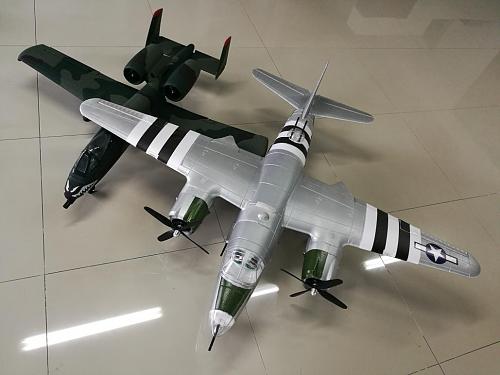

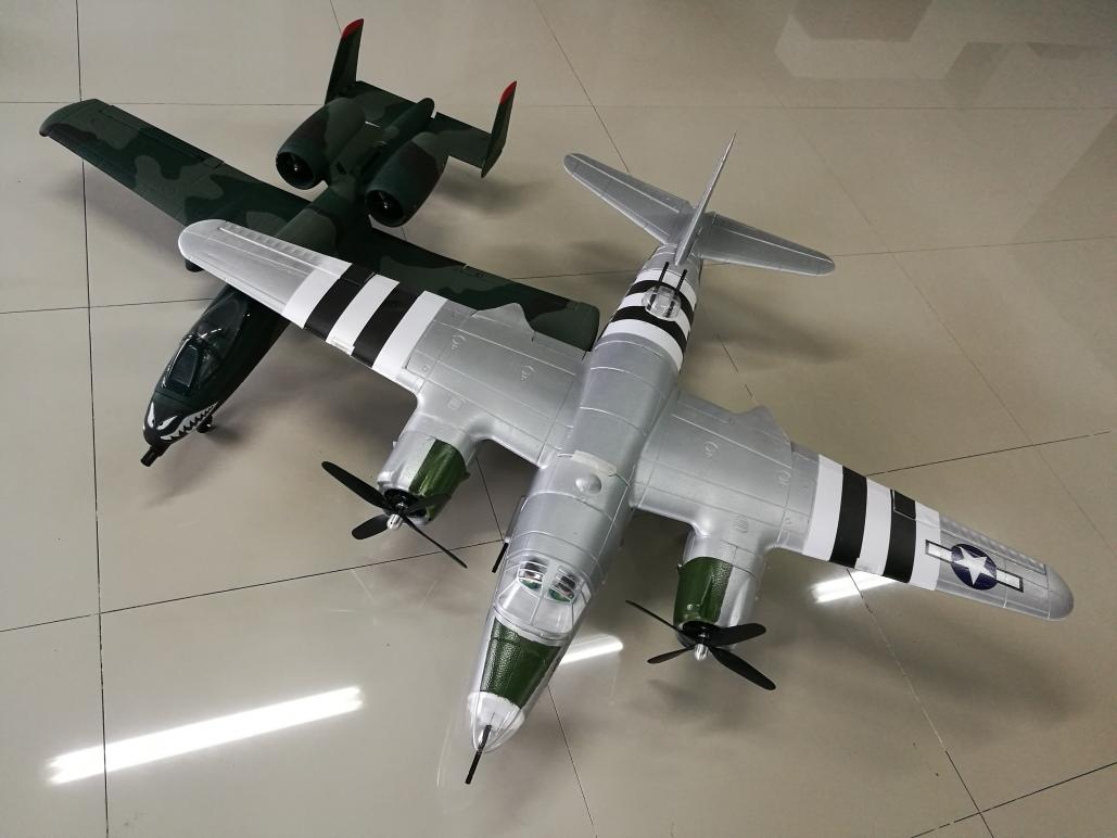

              Here's a comparison photo of another Dynam twin aircraft, the Dynam 64mm A-10, tucked under the wing of the B-26 to give you an idea of the ground clearance... the B-26's wheels are on the ground even with its wing over the A-10's fuselage. Note, this specific photo shows a hand painted test sample, not the final production paint.

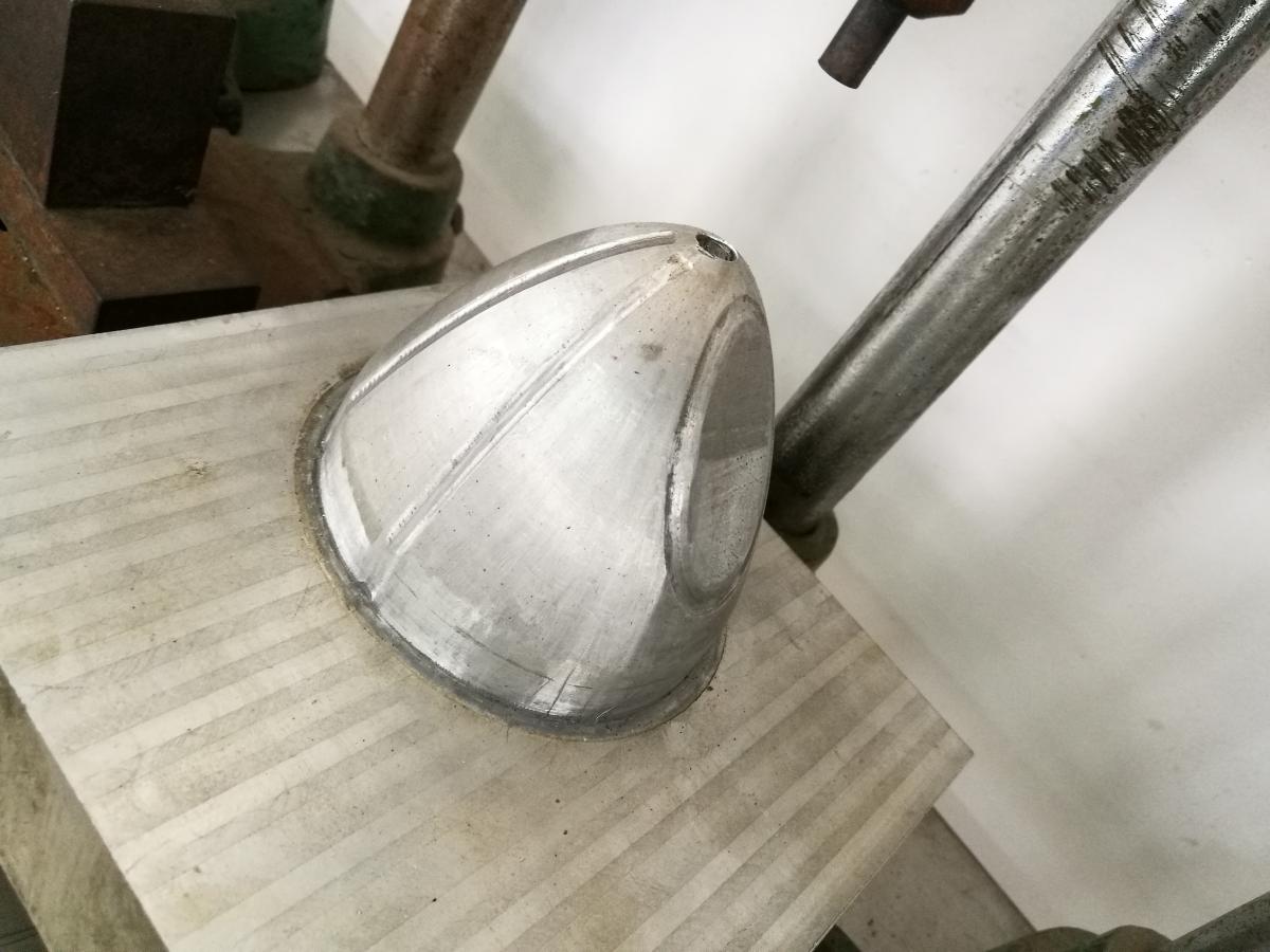

              And finally, here's a fun photo showing the die used to cut the hole in the center of the plastic nose cone, through which the forward machine gun is mounted.

                    As with some of the larger Dynam planes, the box is has big dimensions length and width but the height is short. This makes for a large area that can get punctured during shipping or bending inwards when the box is at the bottom of a tall stack of other boxes at the shipping facility. I've always thought that a thick, stiff piece of cardboard over the top (besides the box top and shipping box top) would be a good idea to add extra protection.

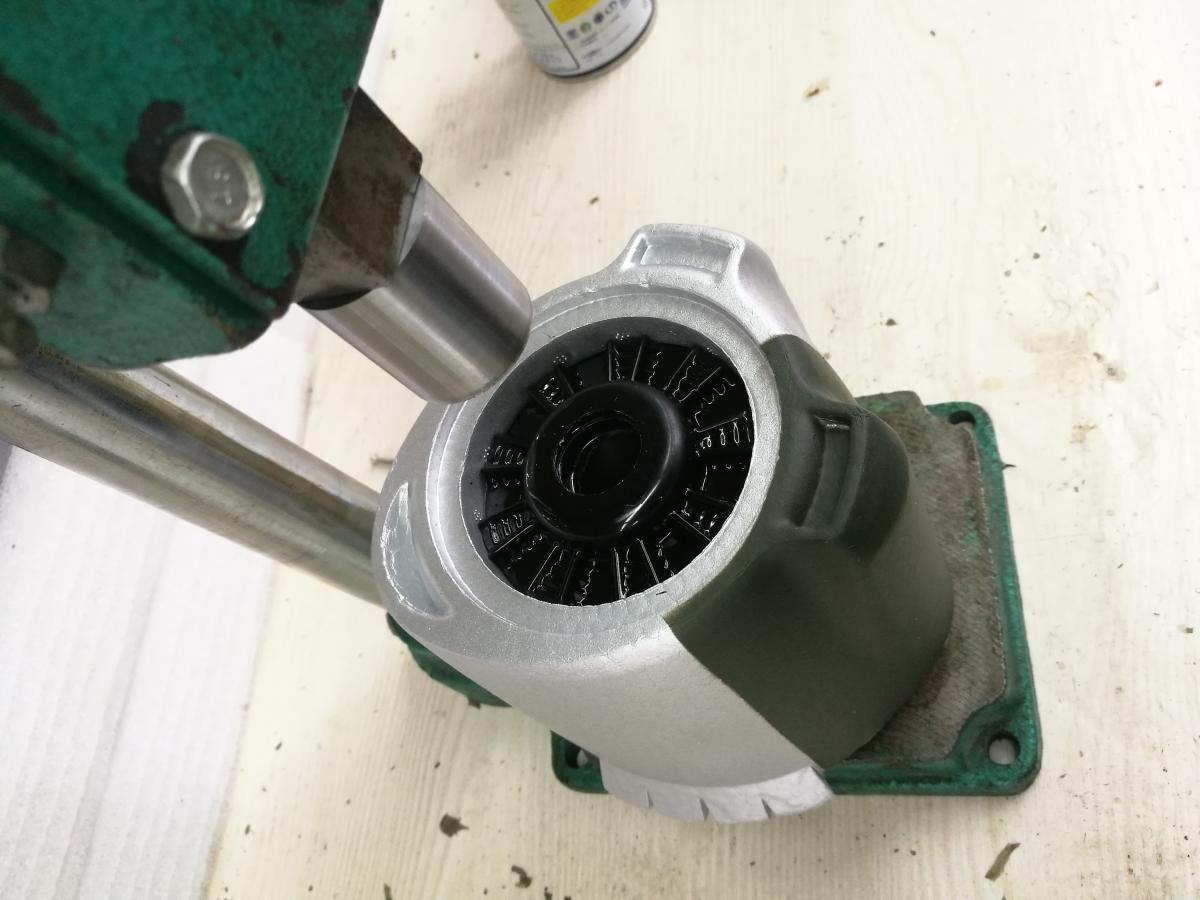

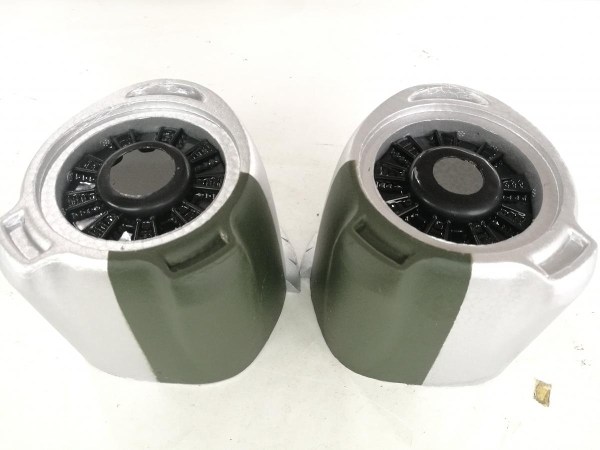

                            Attached, photos of the die I had made yesterday, 6/28/17, to enlarge the dummy engine's original hole.
                            Click image for larger version  Name:	IMG_20170629_162601.jpg Views:	1 Size:	91.2 KB ID:	83814
                            Original hole rubbed against the motor. As of 6/29/27, all B-26s in the factory today and in the future will have the new, larger hole for adequate motor clearance shown on the left. This includes all the B-26s headed to Motion RC.

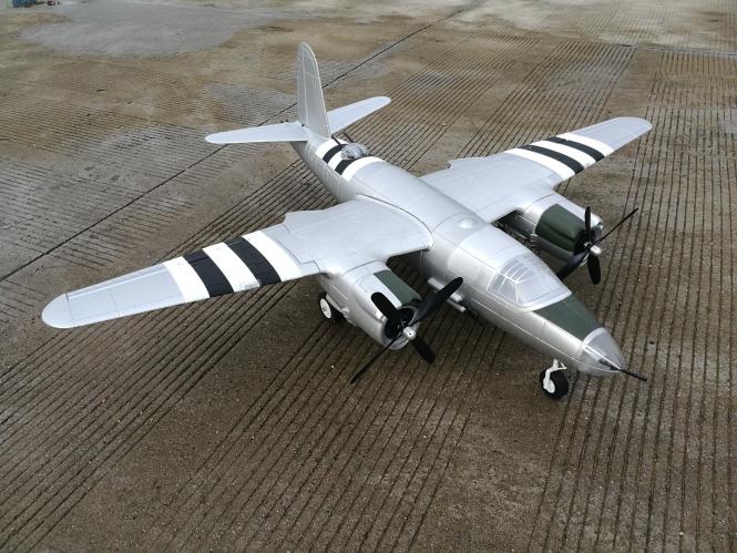

                            Evening test flight today of one of several blind samples pulled off the line here at Dynam's factories. Built and flown by myself.

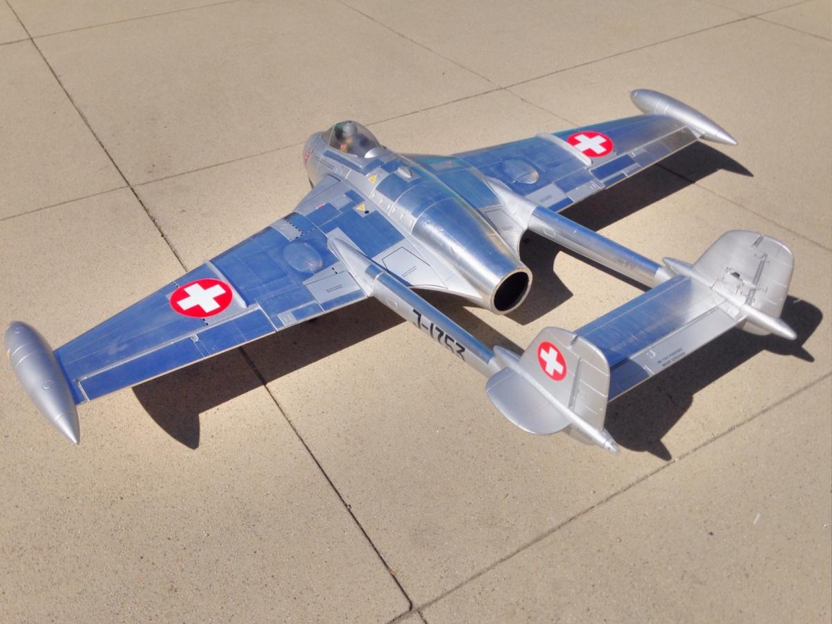

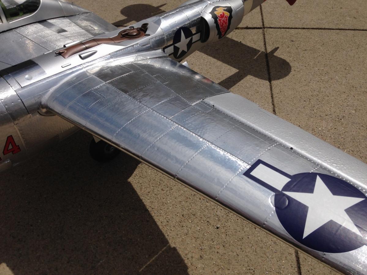

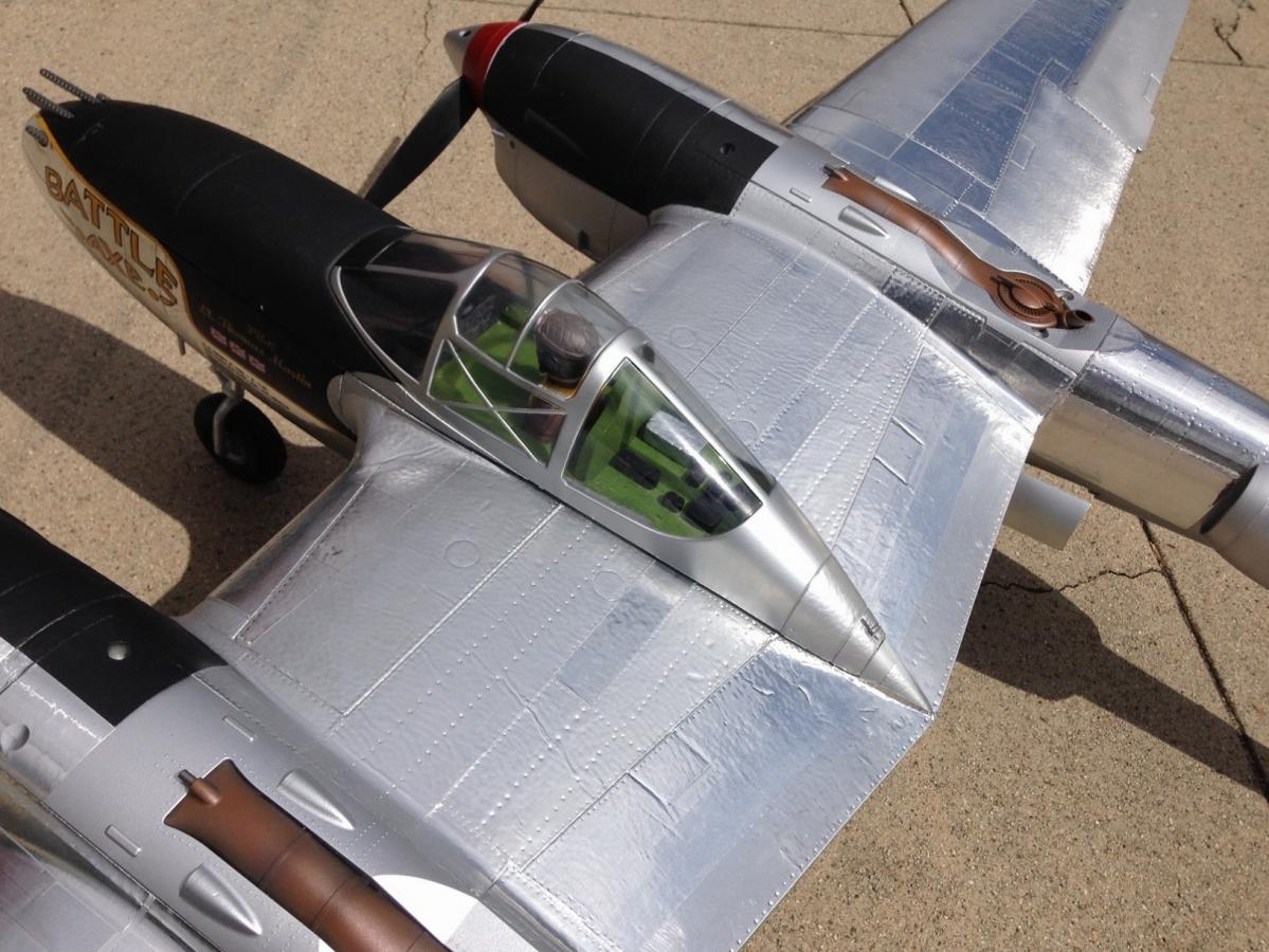

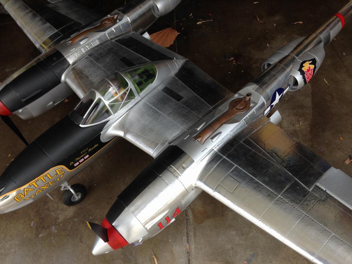

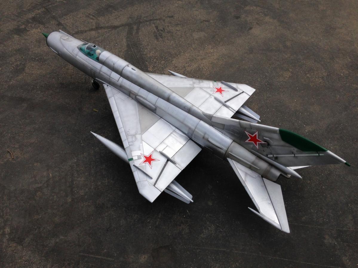

                                          Regarding Flite Metal, I would not recommend it for a foamy (Xviper2, it's an expensive sheet of super thin aluminum, used on model cars, and, in some instances, fiberglass RC aircraft. Instead, I use the thinnest gauge 3M aluminum tape I can find. There are a couple of thicknesses, so double check before buying. After applying on the model in panels, the secret is masking off panels with large Post-It notes, and using a Scotch Brite pad to burnish the exposed panel in just ONE direction with a few light passes. Then, mask off the adjacent panel, and burnish it in a perpendicular direction to the panel next to it. I learned that from Brent Hecht (Corsair Nut) and Chris Wolfe (TheRCGeek). Experiment to achieve the finish and effect you want. If you want to add rivets, lightly depress the tape with a bamboo skewer. If creases develop due to wing flexing or dents, use the back of your fingernail to buff them flat again.
                                          Here are some examples I did on one of my P-38s, Venom, and MiG-21. Notice how the sheen changes at different angles and in different light.
