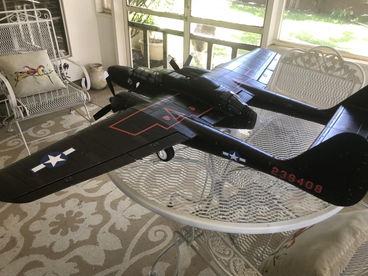

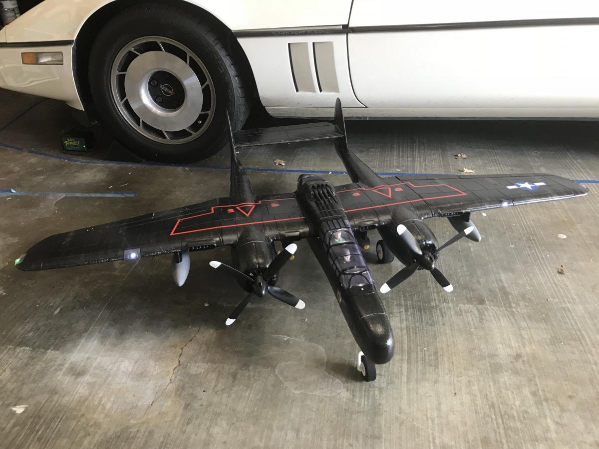

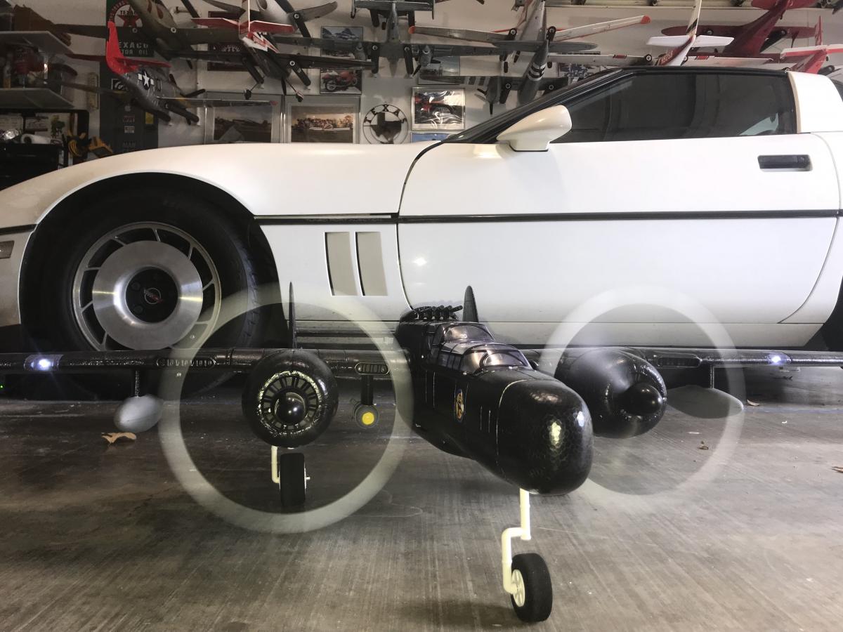

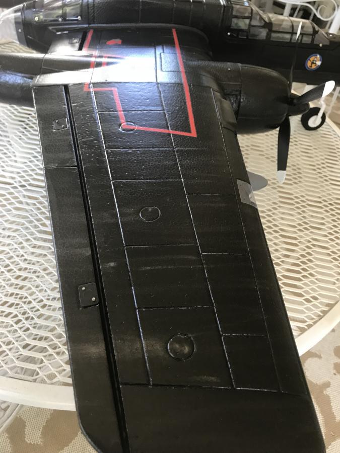

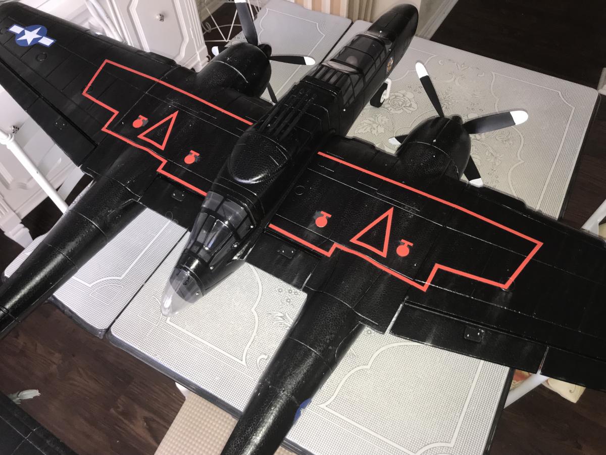

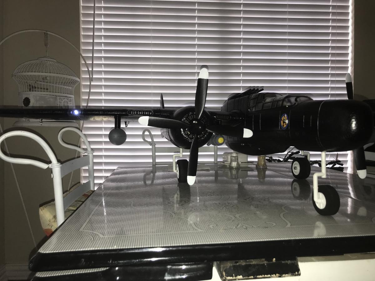

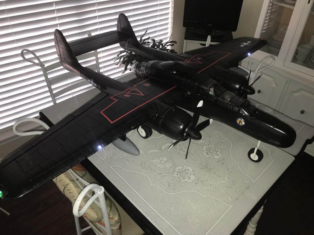

      Gents, I purchased the subject "Dynam 1500mm P-61 Black Widow from Grayson Hobby. The Airframe delivers in the usual Dynam packaging - but at least Dynam is using foam supports on this model. Dynam has moved up a little in their ARF pre-assembled state:
      The Good:
      1. Servo horns, control rods are pre-installed
      2. Wiring harness is completed in the main fuselage and now brought back to the center wing cavity with leads pulled out ready for R/X deployment
      3. LED's are wired in and functional....they even provided an LED blinker controller with an extra wiring harness as an option for deployment
      4. The Motors are supposedly a higher grade product above the standard bottom line Detrum line
      5. The ESC's are supposedly a higher grade product above the standard bottom line Detrum line
      6. There is a psuedo battery tray
      7. The wiring harness soldering looks good
      8. There is some wood ply in the long nose section for strength and support
      The Not so good:
      1. The fitment of my pre-assembled ARF was horrible.....large gaps presented multiple issues during the assembly (Other modelers reported their pre-assembled nacelles were not as bad as my photos present)
      2. The inner blocks that support the rearward boom sections are too long, thus preventing positive mating to the forward boom fuselage section.....needs about 1/2 cut off for proper fitment
      3. The elevator servo extension was backwards, I had to cut mine a solder the wires together
      4. There is no cooling what-so-ever to the motors and ESC's
      5. The servo's may or may not ever find center again
      6. The outer wing mounting points on my wings could not line up with the mating surface mounting holes
      7. Most of the magnets are applied in a manner to which they are mostly innefectivee
      8. The rudders are warped
      9. The elevator is horizontally twisted
      I can see where the "Novice" modeler will have major issues with this delivered product. The airframes pre-assembly is more of an issue than the model itself. I would have rather it deliver un-assembled at least to have a chance at getting an acceptable over-all fitment. The patient, knowledgeable, parts bin savvy, ready handed tool ladened experience modeler will be able to address all the deficits of the delivered product. But the novice builder will not have a positive experience.
      As for the airframes final completion......once all of the issues are addressed by any method or level of the builder......it still manages to be an excellent aircraft. Different, unusual, menacing.
      I can readily understand Motion choosing not to offer this particular airframe. If only The pre-assembled components of the fuselage Nacelles alone were addressed, Motion might be in a better position to offer this bird.
      IMHO -
      A. This particular Dynam airframes flaws are NOT the components, hardwares, nor the quality of the foam or the details......its failure is in fact the - shoddy QC of the factory pre-assembly.
      B. If you know up front about the flaws and understand how to deal and address them to your level of satisfaction....the end product is very good!
      C. The other Dynam models are an excellent value for the price point....and fortunately for the most part...their respective pre-assembled components are acceptable for the novice builder...these models pose no potential hardship for the retailer answering questions and servicing a low percentage of component failure
      I don't think Motion should dump the other Dynam line of products....due to the present state of this model.....nor for any mis-alignment of manufacture-distributor relationship related solely from this model. This model is unique in many ways ...good and bad. It's good that a distributor can choose the models they wish to market....therefore it appears it's not an all or none container purchase of inventory.
      Yes this model appears to be a builders beware.....actual delivered pre-assembly QC is lacking....over-all airframe fitment accuracy will vary....thus the level of corrective measures and fiddley will vary.
      I do hope Flightline offers this model someday......it's a super good looking R/C when completed nicely.

                            She looks beautiful mate.
