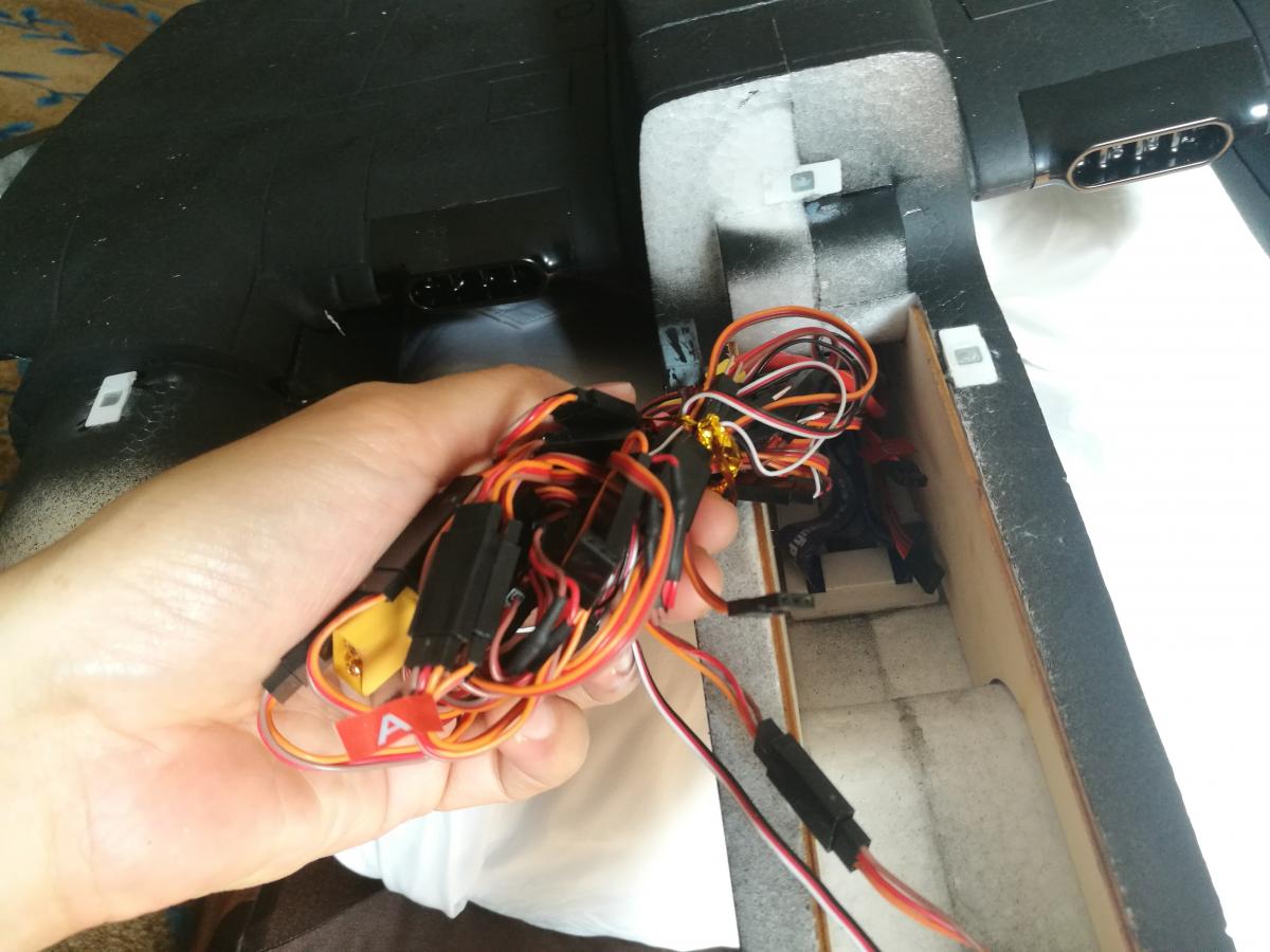

                          4. Lucky Number 14. This one is important! The wiring was a sizeable rat's nest. Understandable, since there are so many servos and lighting wires, crammed into a narrow fuselage. Dynam doesn't use central circuit boards like Freewing/FlightLine models. Some people prefer using Y-connectors instead, but in Dynam's case, that makes for lots of Y-connectors and an unavoidable mass of wiring. Here is the solution I proposed for Dynam to execute with the final production version. Of all the things above, this one will actually give you a model in which you can fit the battery (i.e. essential), so I'd count this mod as Necessary and Important for all you early adopters.
                          The sample had wiring that looked like this:

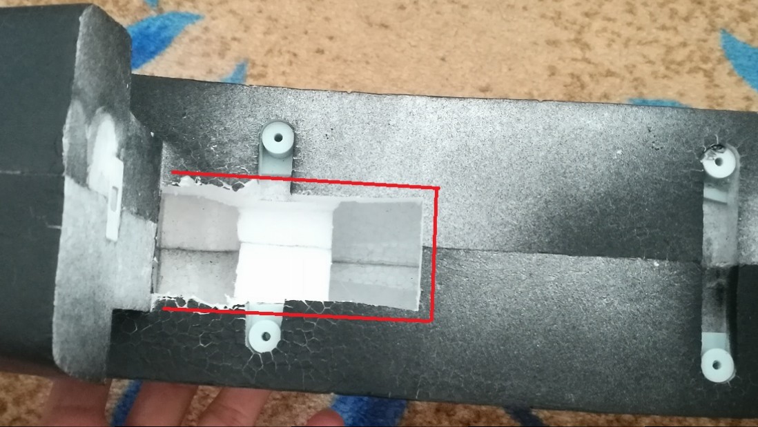

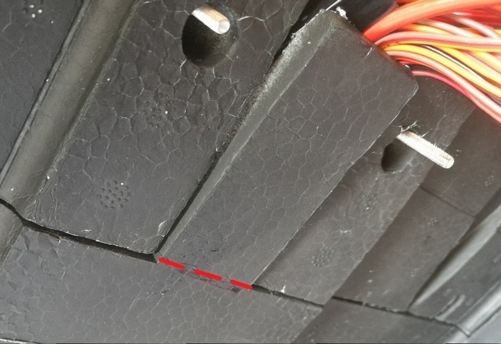

                          I instructed Dynam to modify the mold to remove foam in the main fuse, and by cutting the red line on the underside of the main wing saddle and removing that extraneous cover. You want the wires to exit the wing at the red dashed line, not ahead of those forward wing screws.
                          Click image for larger version  Name:	IMG_20170916_165326.jpg Views:	2 Size:	156.7 KB ID:	103120Click image for larger version  Name:	IMG_20170916_141750.jpg Views:	1 Size:	135.9 KB ID:	103118

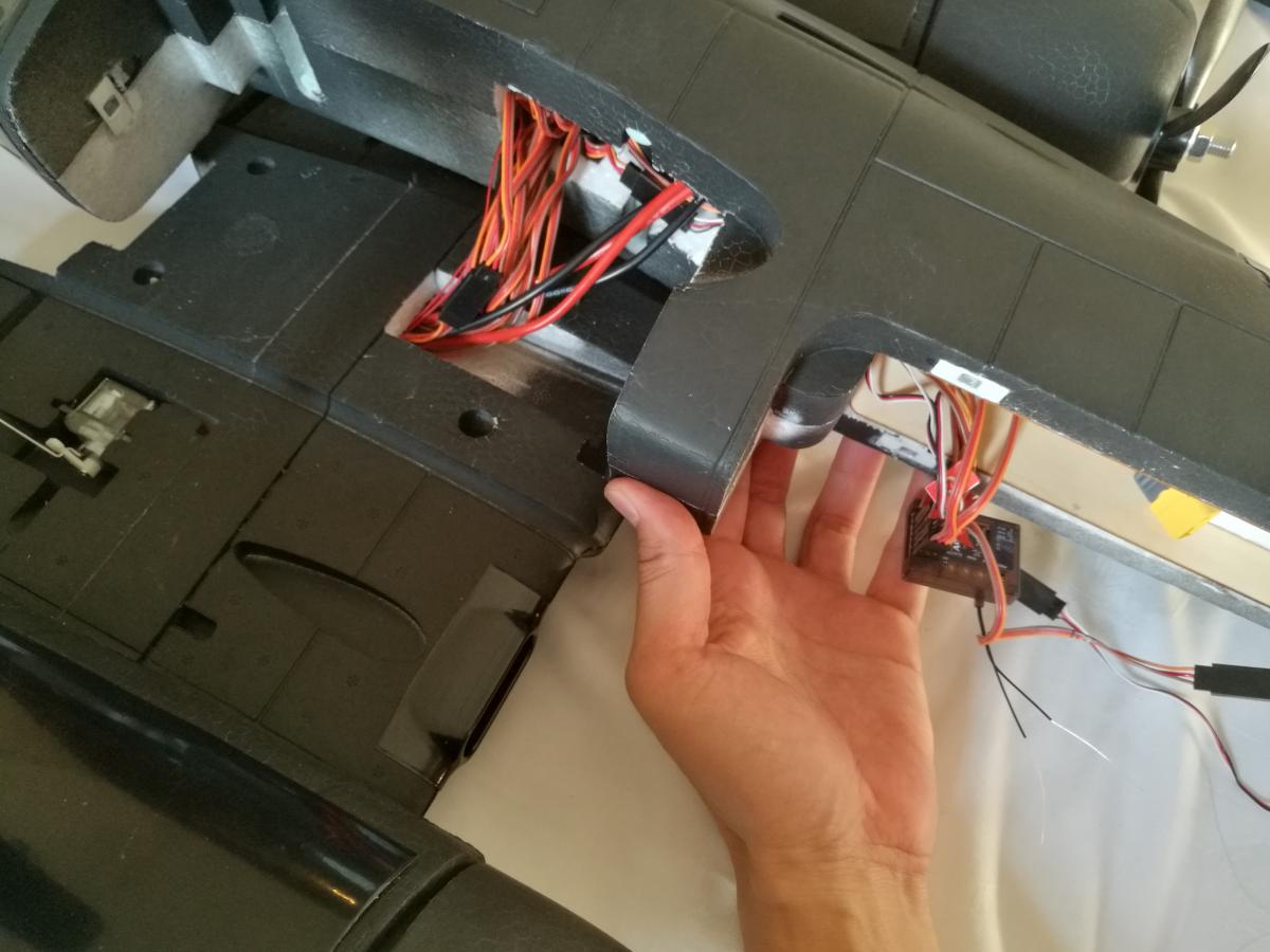

                          Doing the above cuts, which takes a matter of seconds, now allows most of the wires' Y-connectors to be stuffed into the hollow fuselage near the CG:
                          Click image for larger version  Name:	IMG_20170916_171911.jpg Views:	1 Size:	96.0 KB ID:	103121

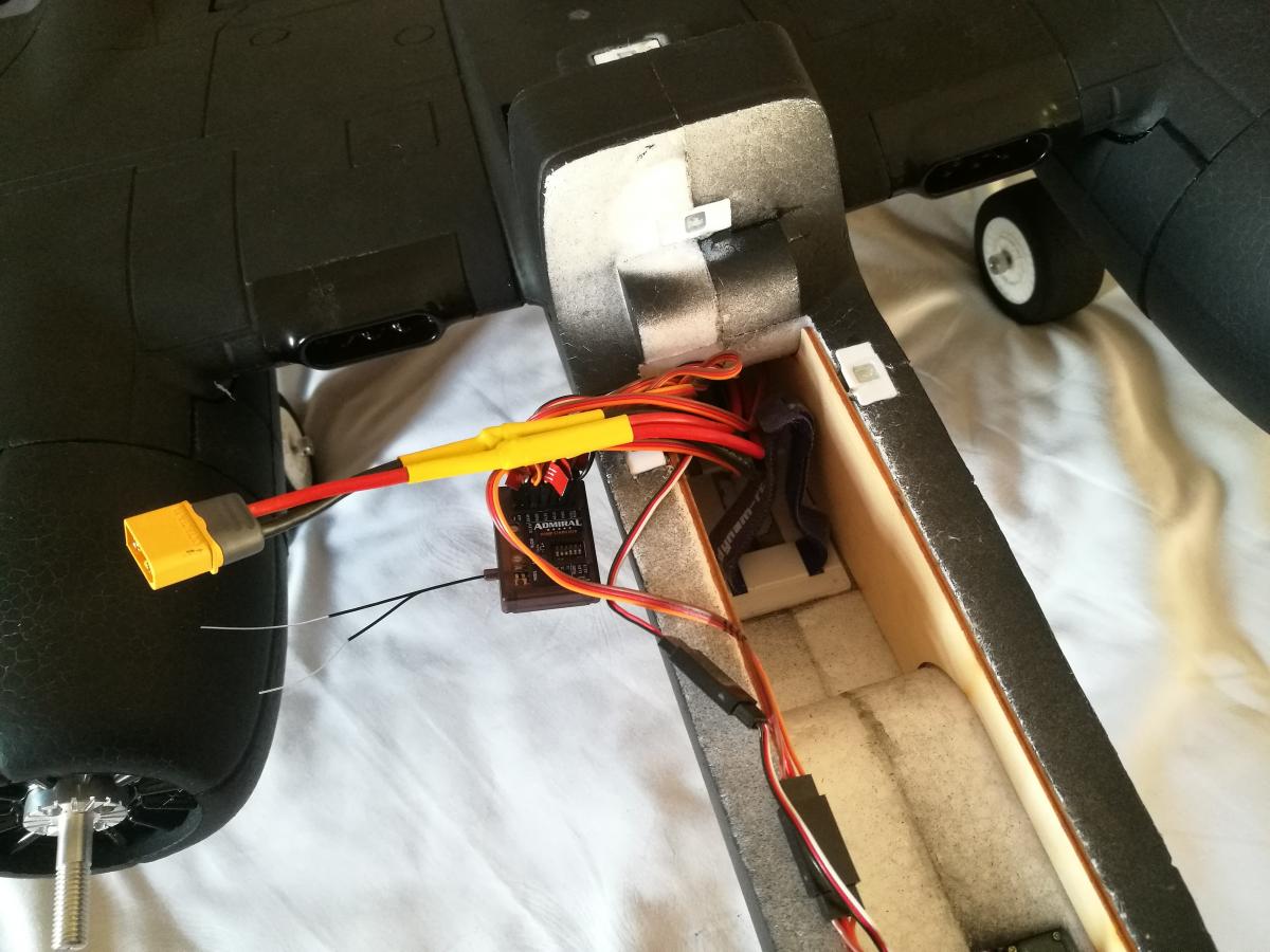

                          In doing so, greatly reducing the wires in the battery bay. Much better!
                          Click image for larger version  Name:	IMG_20170916_172246.jpg Views:	1 Size:	117.5 KB ID:	103122
