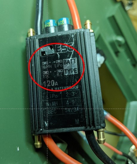

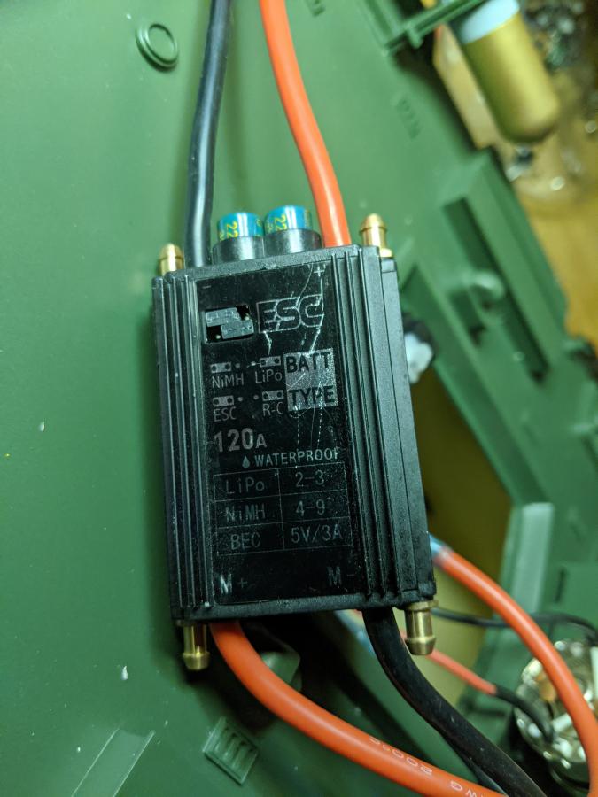

    I pulled the speed control out of the PT to get a look at it.
    Looking at the jumpers it looks like they are in the wrong positions! (At least to me!)
    Click image for larger version  Name:	PT ESC.jpg Views:	0 Size:	61.8 KB ID:	276054
    The top jumper is set to the right. The diagram shows that it should be the left for LiPo batteries.
    I am correct on that?
    The bottom one is to the right in the "RC" position.
    The left position is for "ESC"
    I'm not sure which is correct for the bottom one.
    If I was setting this up from scratch I would have picked the ESC position.
    Can someone check this for me?
    Thanks

                Hey Rascal. Ever get an answer on that speed control? Do I need to pull that thing out before running this rig?
                • Rascal76
                  • Sep 2020
                  • 32
                  #48
                  I have talked with Motion. They don't have the manual for this speed control. I was told to set it to LiPo but I have no input on that as the ESC was already damaged.
                  We are running LiPos, I have to believe that the jumper should be set to LiPo.
                  The other one is still a mystery to me. I can say that except for the speed control frying out the boat controlled property while it ran.
                  Alpha are you out there. Any input on this one?
                  All that being said I would advise all of you to pull out the ECS and check and report the way yours is set up out of the box.
                  The ESC is held in with a wire tie and Velcro. Just cut the wire tie and pull it out. the Velcro is plenty to hold it in there.

                    Good afternoon Rascal,
                    Just checked my boat and the ESC is in the position you noted,appearing in the nicad position. How do you actually change the position, how do you move the jumper. Also do I need to notify the company of this for warranty or the like. Thanks very much for your advice

                      I also checked the ESC and it set the same way. It seems to me they are set opposite of what they should be. I am new to the RC so don't really know.
                      The jumpers pull straight off the pins.

                        Thanks Paulh,
                        Switched my ESC over and ran just fine, hopefully avoided some problems. Also thanks for the jumper insight. The battery took close to 3 hrs to charge for me on the initial charge.

                                      About the only thing the jumper is doing is setting up an LVC for the lipo.
