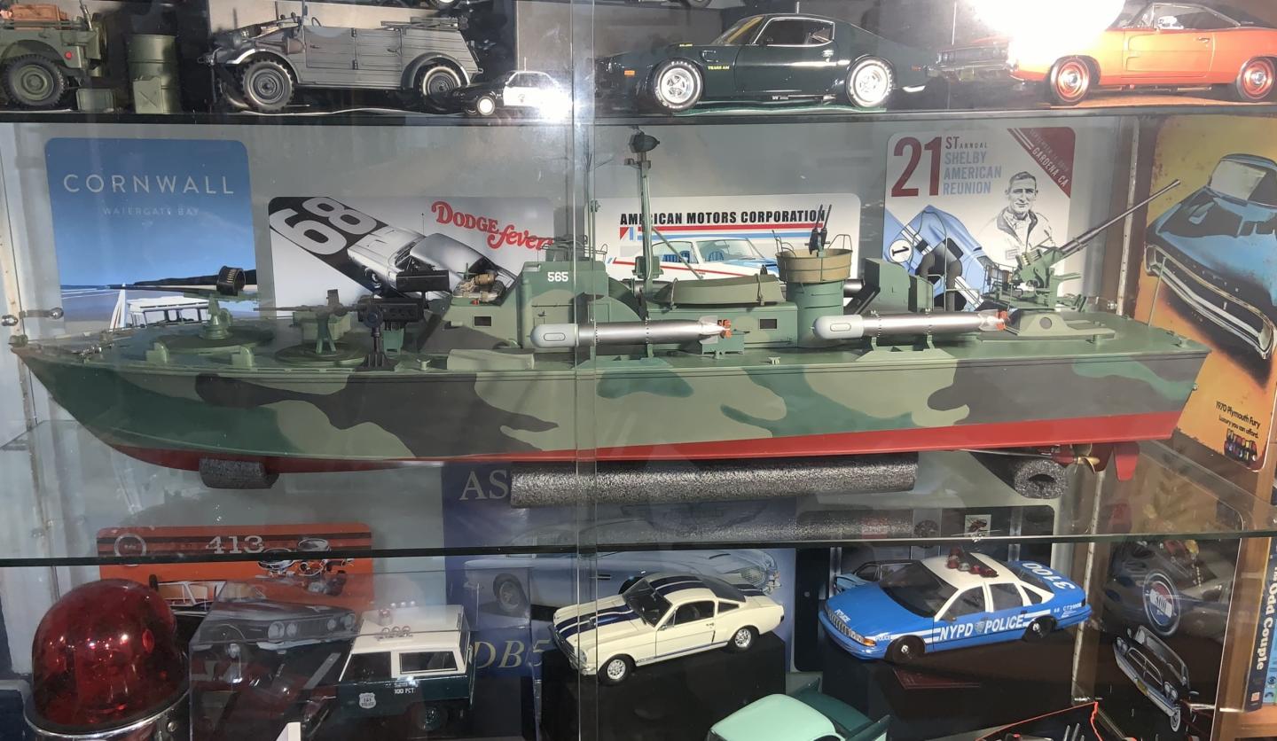

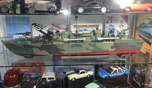

                      #170
ID:	292918 Improvised location and temporary stand for my recently updated boat.
