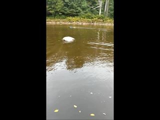

                                Here's a short video of the one and only test run. The next time around it quit.
                                Rascal76
