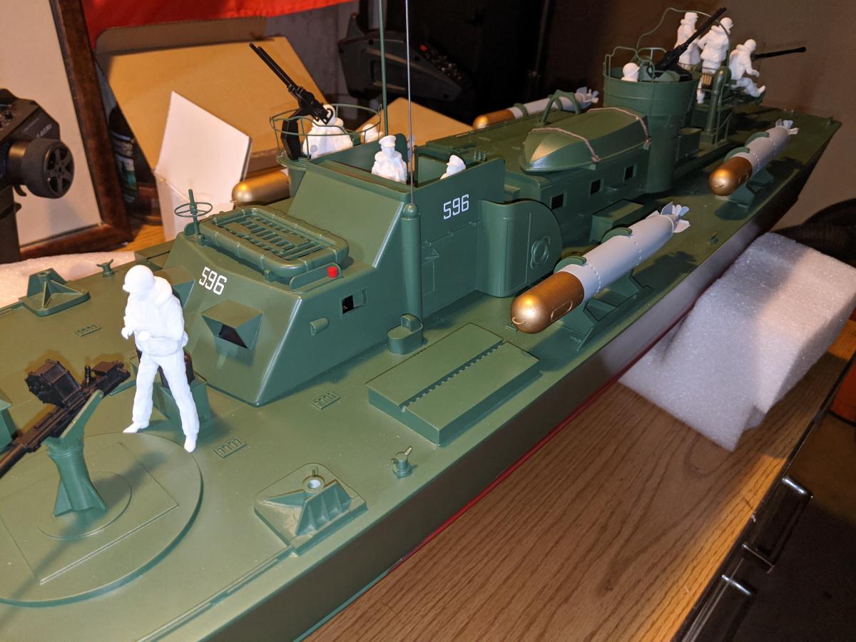

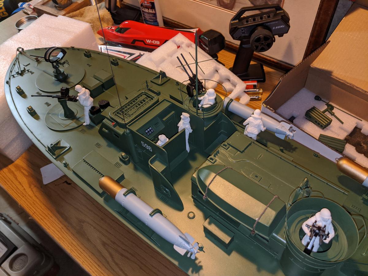

ID:	277453On a happier note the crew arrived today. It's going to be a lot of work fitting and painting. I think they'll look great!
