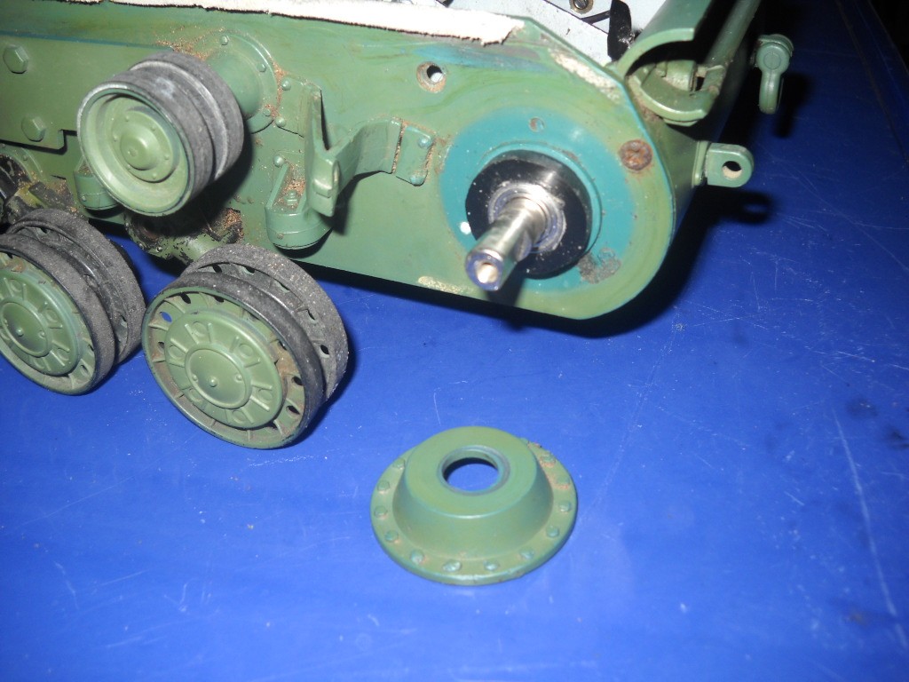

          Originally posted by Woohoo\o/
          I think I found the size bearings needed.
          od 14mm
          id 8mm
          w 4mm

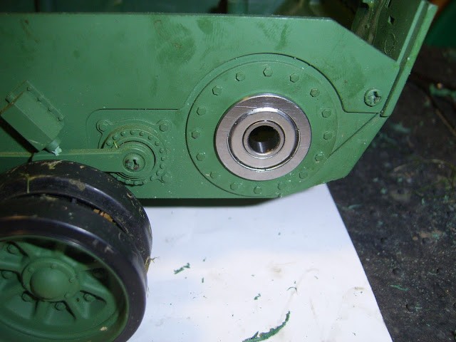

          This one was pulled right from the HL bearing support housing.

            #65
            This is the bearing that supports the 8mm shaft correct? Or is this bearing installed onto the gearbox itself?
            I'm trying to support this area in the pic below

                #67
                Yeah lol I'm just using it as an example sorry. So the bearing you are showing came from here right? Minus the collar shown in photo.

                  #68
                  I know this isn't the Abrams but this is where I place the bearing to support the shaft correct? Normally there's a brass bushing?

                    #69

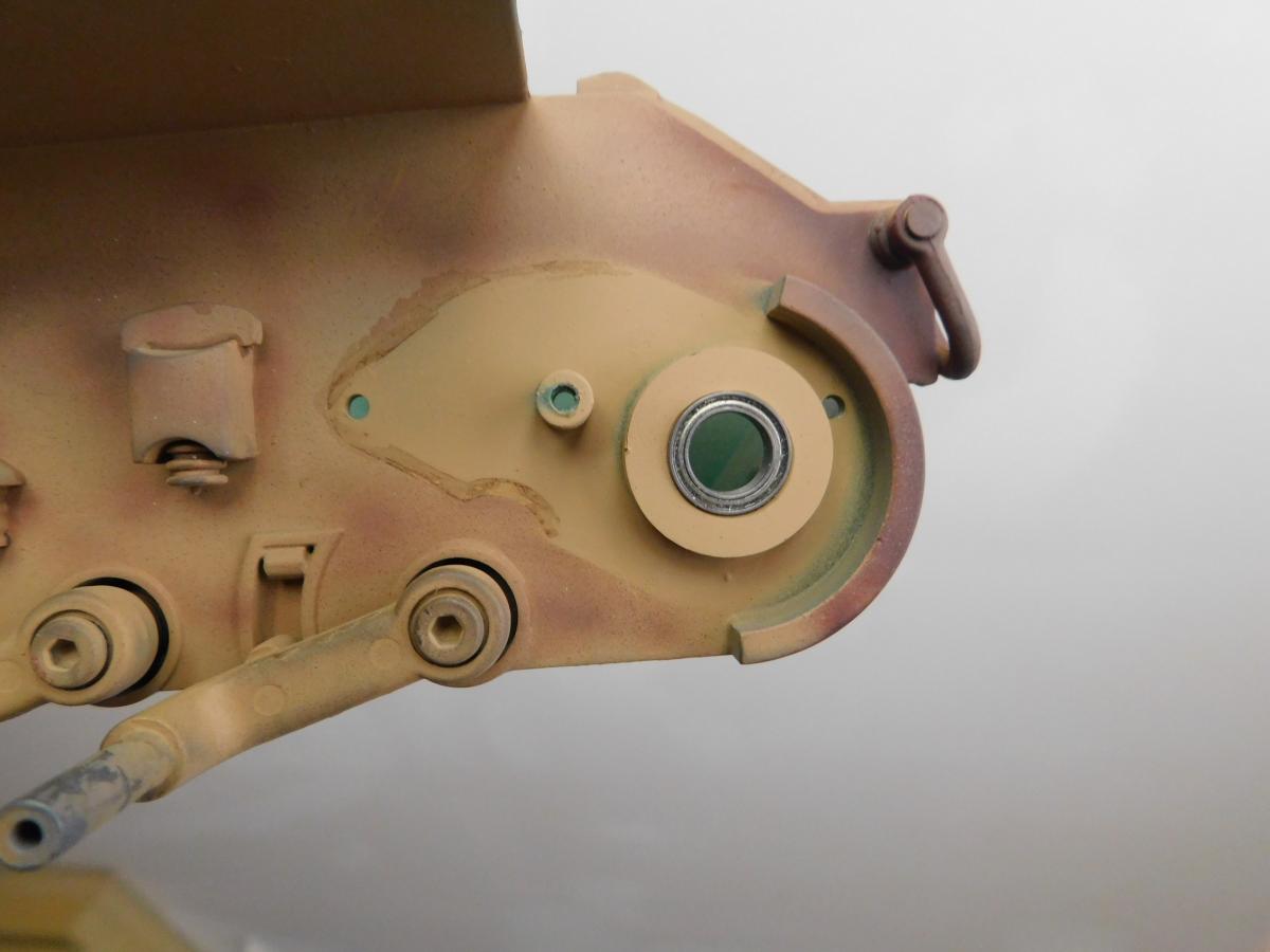

                    Yes that is an older bearing mount before the one made specifically for the Abrams became available. The Abrams one is of the same style but about 1/2” longer, both use the same bearing size. The one shown is from a T90/72 and is shown installed in one of my older Abrams hulls (posted on RCU.com)
                    I still use the T90/72 bearing mounts on my older HL Abrams, M41s and M26 (not a direct fit on the M41 or M26). The new Abrams specific mounts offer a little more support for heavier metal/rubber padded track paired with higher torque motors and all metal road wheels which was a welcome sight when they first came out and only made an already tough tank even tougher.

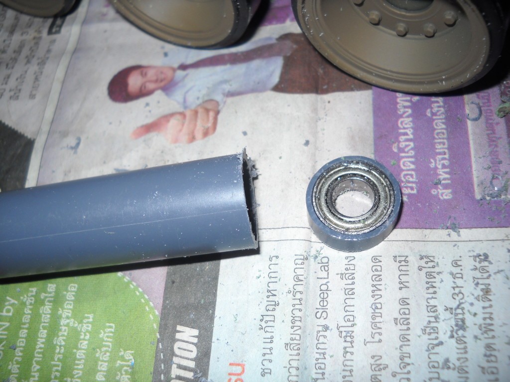

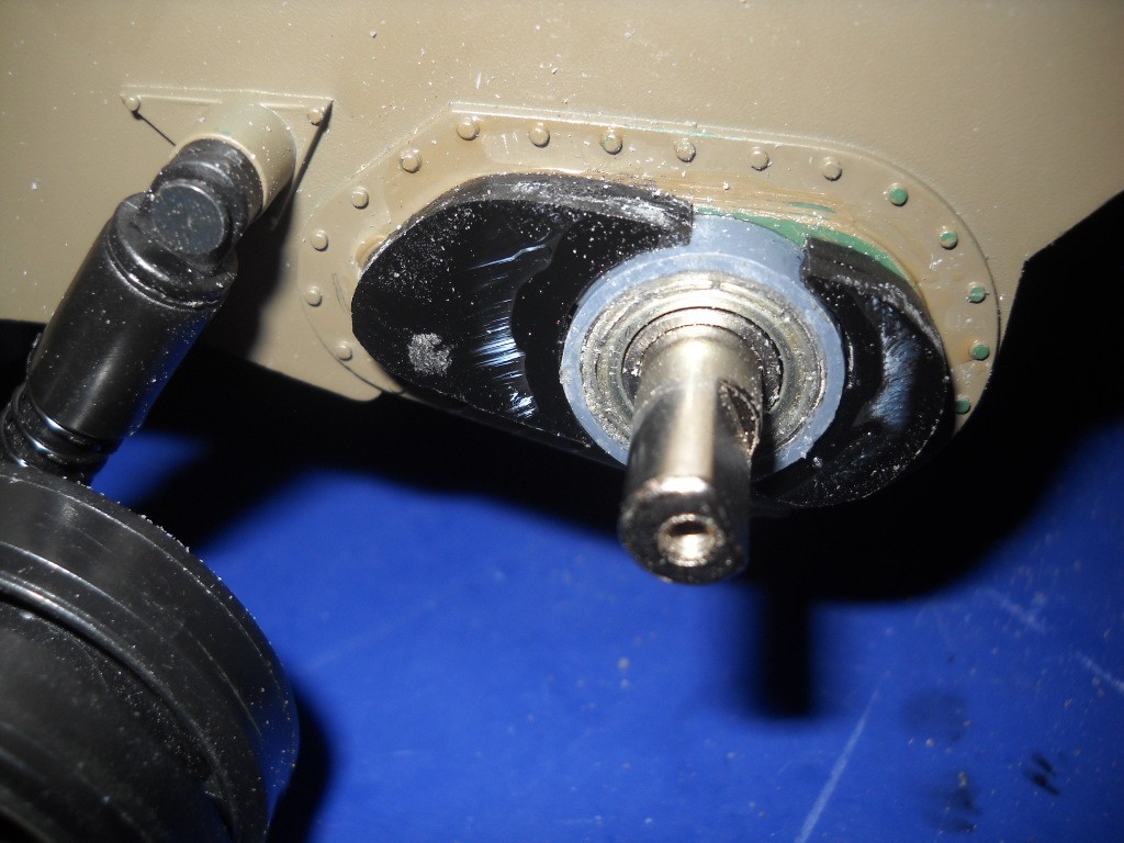

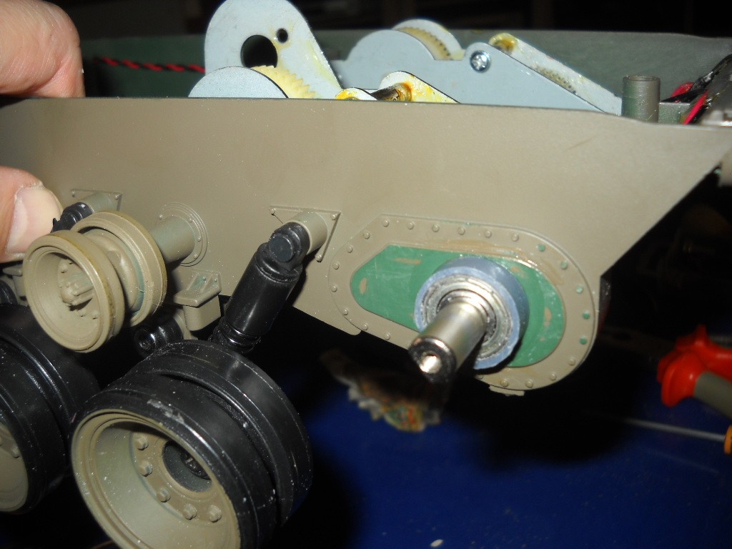

                        #71

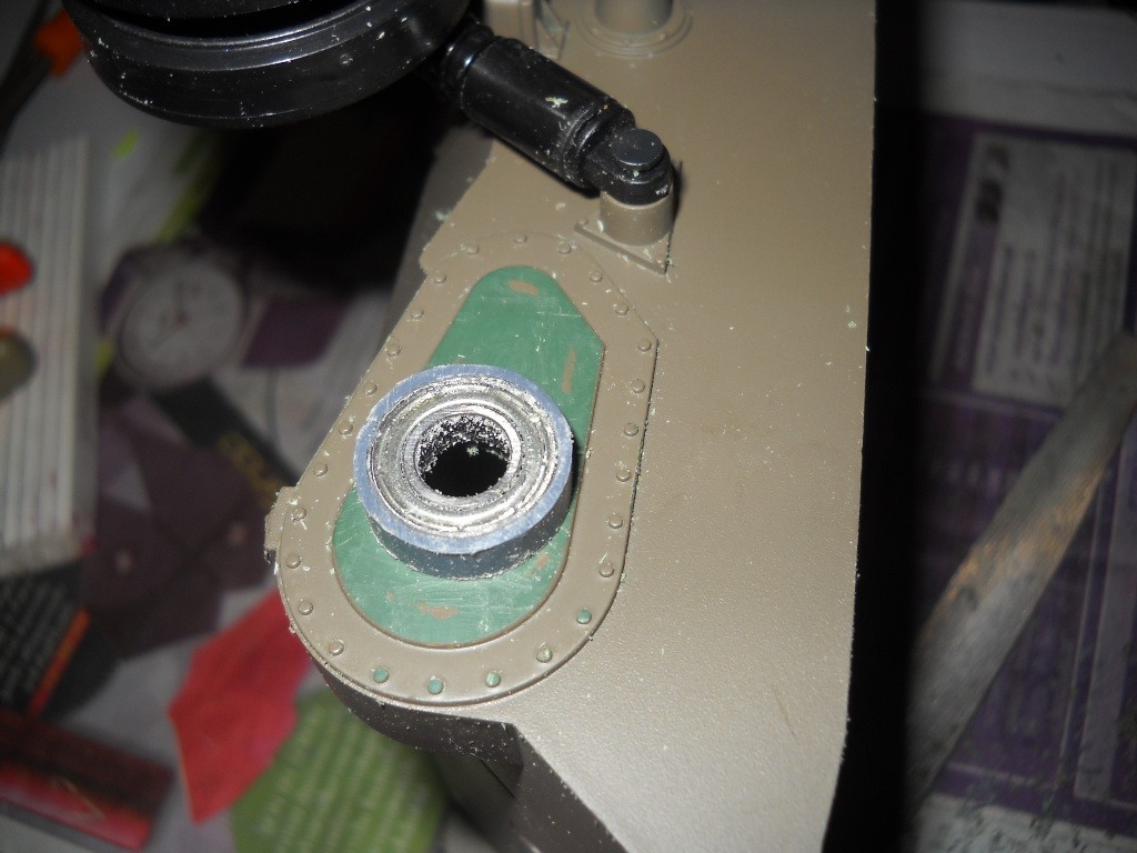

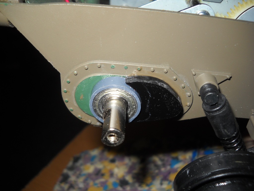

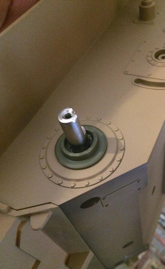

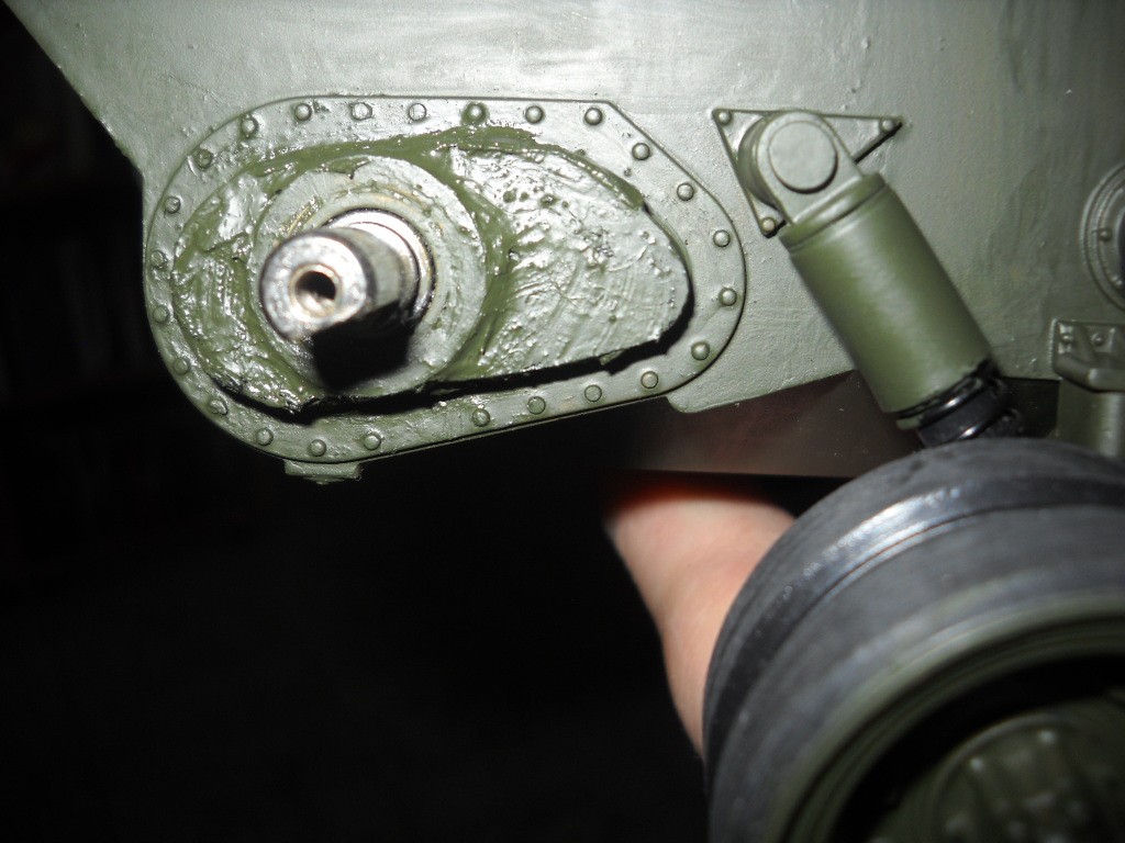

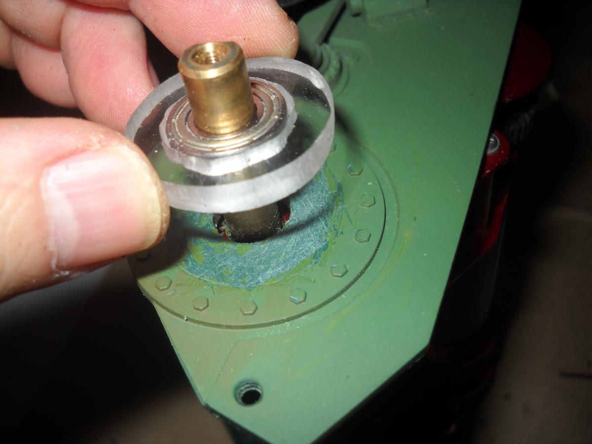

                        I made bearing supporter for my many tanks.This's my M 41 A3.
                        • Rdex2
                          • 40

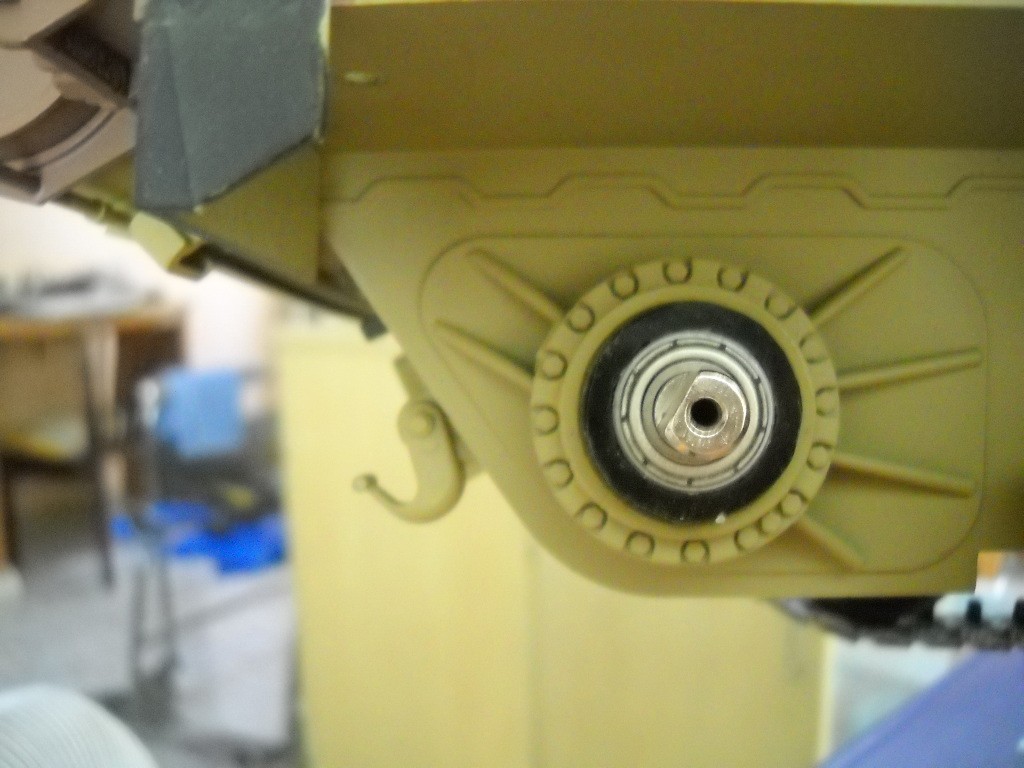

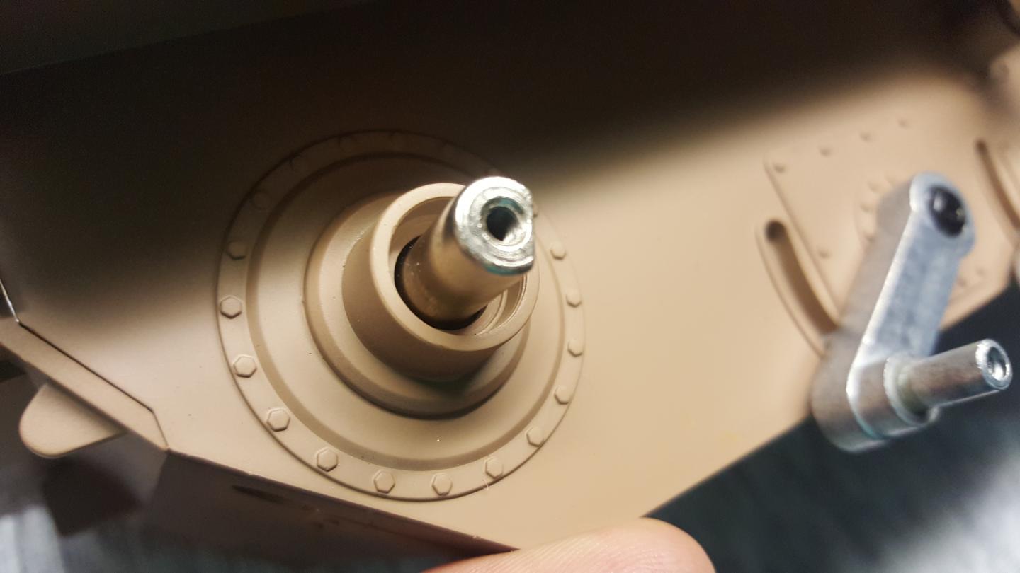

                          #72

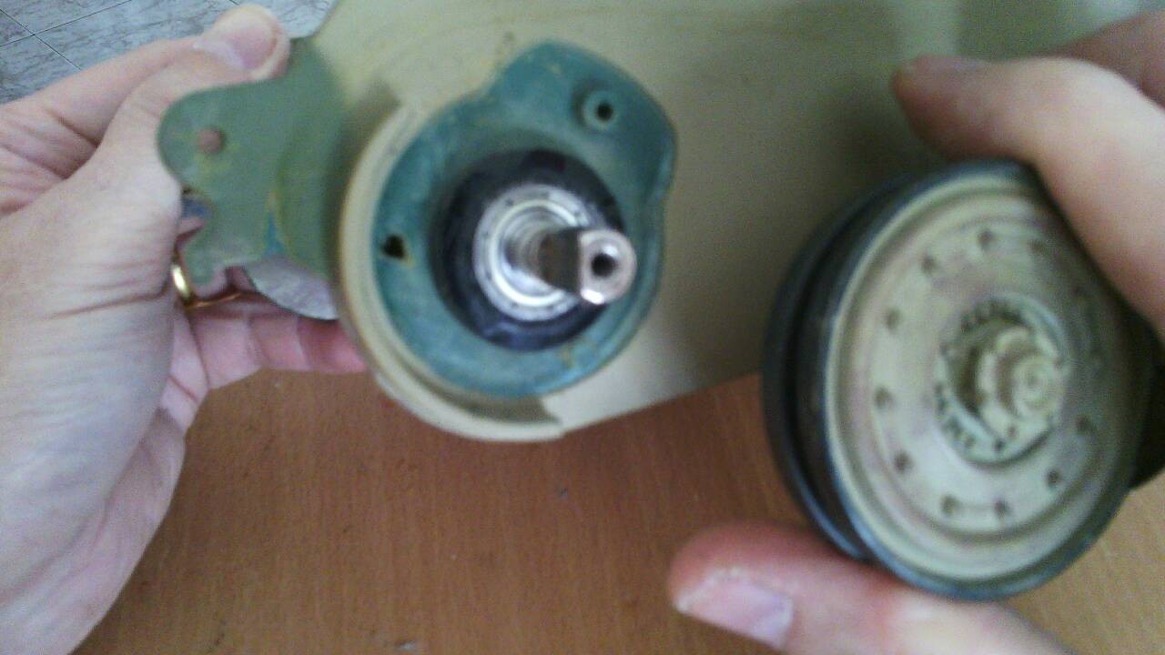

                          Some of mine.Bearing size recommend 8x14x4 mm. and 8x16x5 mm.

                            #73
                            Thanks a ton rubicon.
                            rdex2, what glue did you use? Looks fairly simple.

                              #74
                              Update: yeah I've been over thinking this. I received my Abrams, did the 2 minute test all was great (great sound btw) and began taking her apart. The paint is waay too dark. Gonna paint her up.
                              Rubicon I see where the bearing goes now. Sorry for run around. I just don't understand why wouldn't they add some bearings? I would gladly pay an extra $15-20 for the added feature.

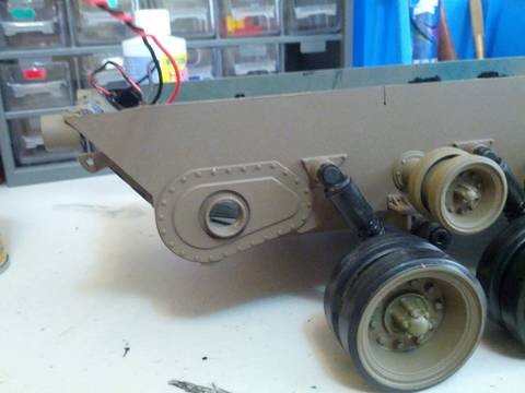

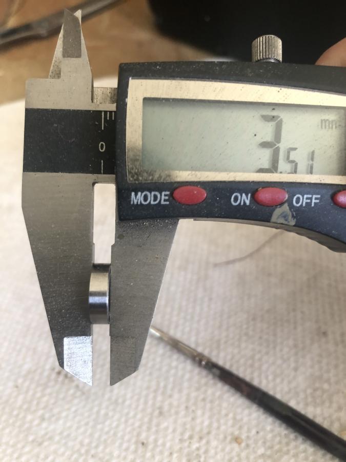

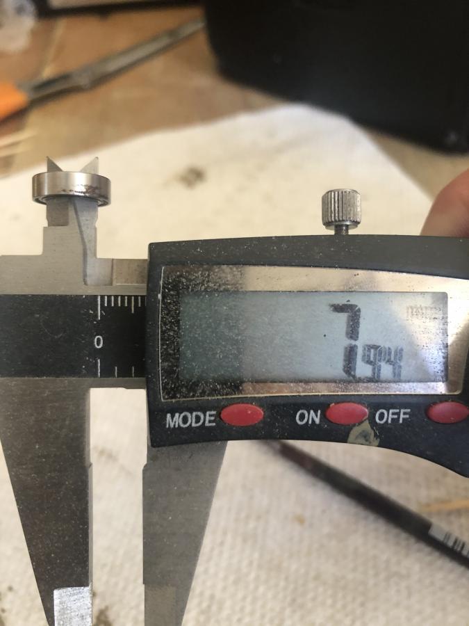

                              I use 5 mm acrylic sheet to made a holder and fix with hot glue. And flange bearing size is 8X12X2.5 mm. may be use without any holder. In this clip 2.35 min show how he easy put it into a hole(see comment below).https://www.youtube.com/watch?v=8qdKRZmD62Q

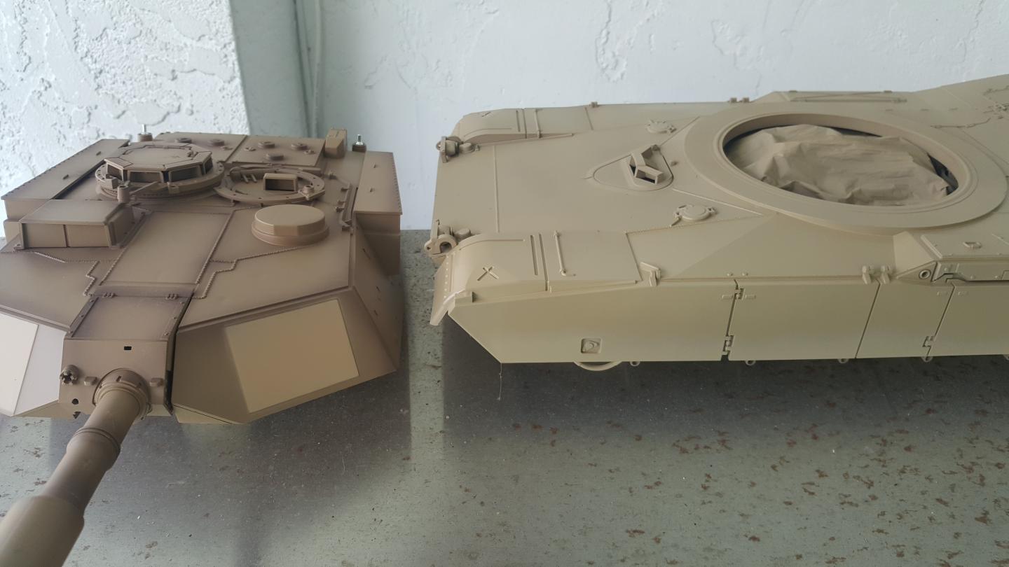

                                  Here is my Abrams without decals and weathering. Just bare paint. Not exactly accurate paint as the real life Abrams but $4 camo paint sand color and 30 minutes of work and it's better than the coffee brown color.

                                    Can I use 8x12x3.5 flange? The 2.5 cost $20 each 😣

                                      The problem of 8x12x2.5 mm or 8x12x3.5 mm is real inner hole 7.9 mm and a little bit sanding shaft is necessary.
